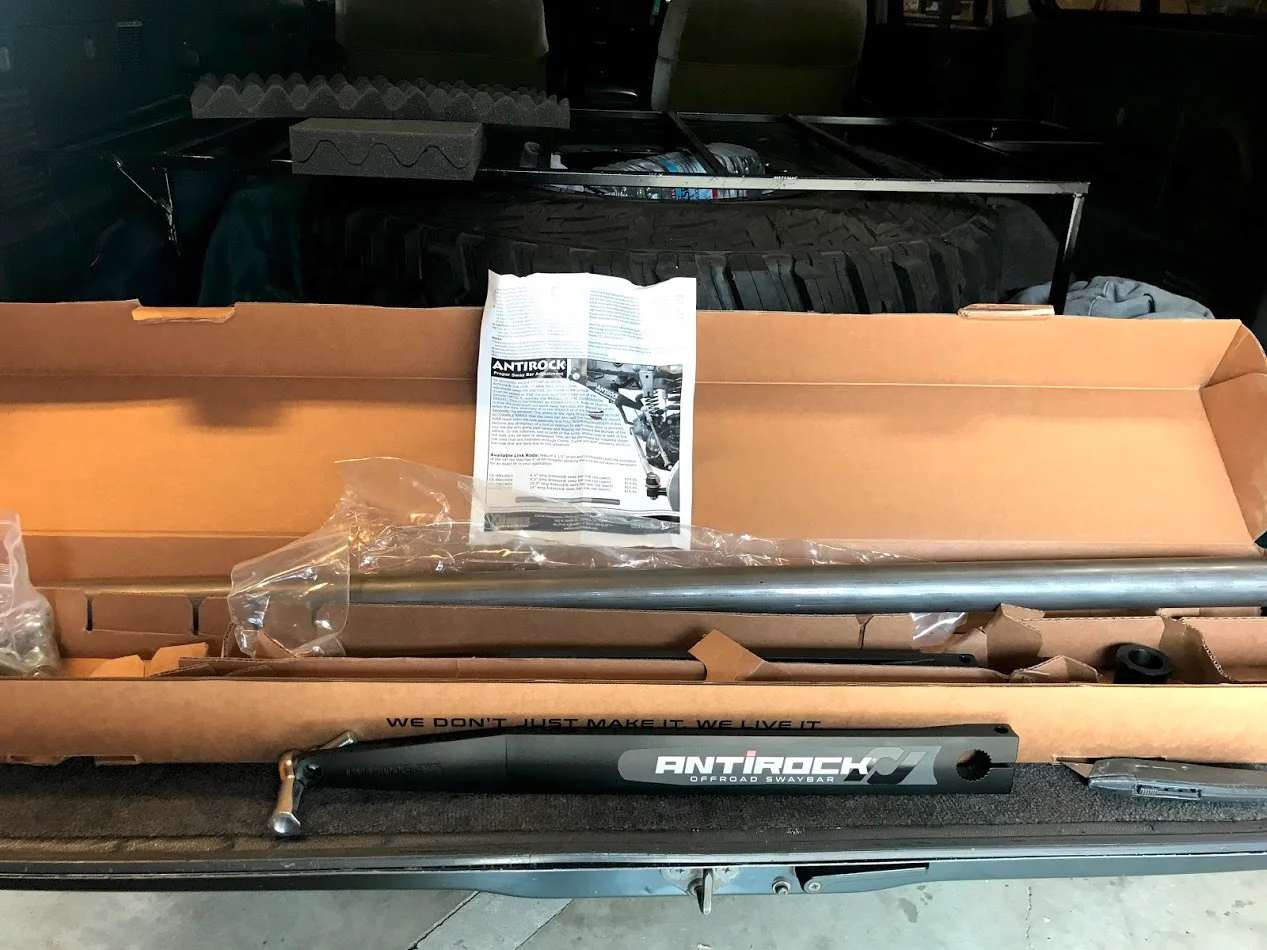

I ordered this Antirock sway bar
and started to get it mounted, My plan was to run it through the frame for the strength and a factory & clean look.

The sway bar comes in a box complete all you have to do is straighten the arms and nach for the bung I did mine first and Broskie saw the idea and like it so he did his that way so yes it’s straight out of the box

I believe what he meant is the links have been chopped to about 1/3 of their original shipped length

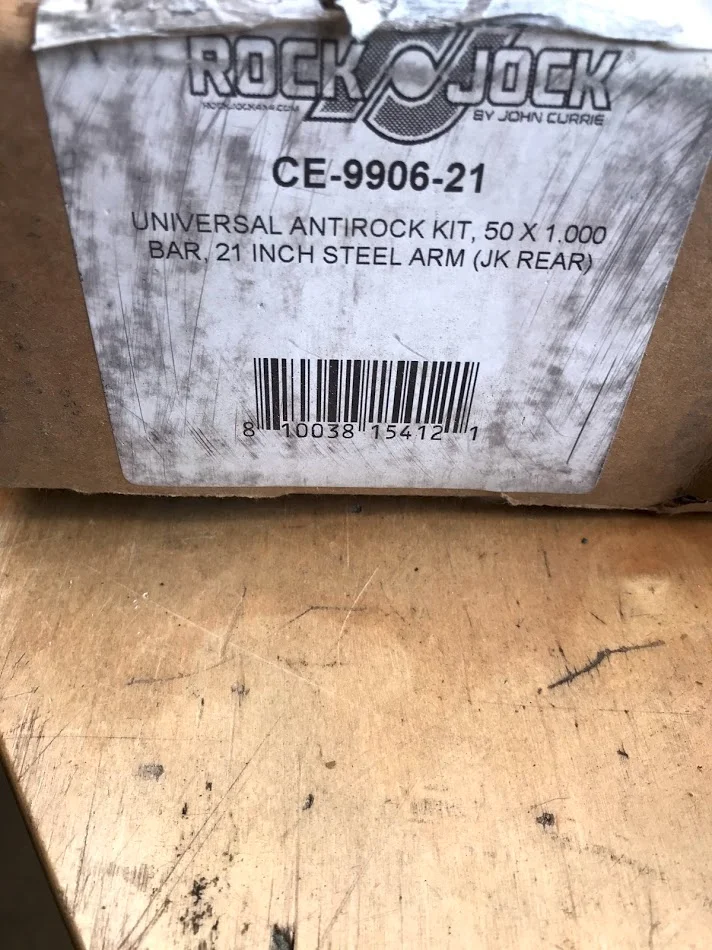

Kit number please if you would & pics of @pvhobo 's install if okay with @Broski since it's his build thread.
As always sterile install from the LC surgeon.
That rig is the most used cleanest 80 I've seen.
