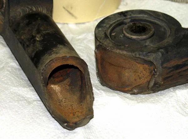

Broken front lower control arm mount on axle hoise
glad the front held on. I was able to drive out to the shop slowly.

You weren't in any danger as long as the other side was intact. Many people pull one of the bolts offroad, it's known as a 'poor man's three link'. I run full time without the front bolt in the passenger side. Tools R Us built himself custom arms, one of which has no front bolt mount, so technically it's not a radius arm, it's a simple control arm, which I believe is what he was referring to when he said he 'got rid of one of them'.
With one bolt removed, the axle doesn't have torsional force applied when one side is higher than the other. It's counterintuitive, but but there is less stress on the axle tube and mounts, as well as more freedom of motion without the binding. It does handle differently, the side with one bolt tends to dive more on stops. It's a compromise between street and offroad manners.

In addition to Tools R Us's comment, and what you may have found in the other thread, another limitation is the width of the arms, especially the bushing cups. When the axle articulates, the arms are twisted in the mounts, so if you remove a bolt the arm will bend the mounts apart. Tools' arms are narrower, I took a grinder to mine. As with most things, there's a lot going on and changing one aspect tends to have effects in places you may not have expected.
wow that was a real break!! Mine was just breaking away from the axle at the weld line. that broke the bracket in half and tore from the axle!! I agree, get those poly bushings out of there.
