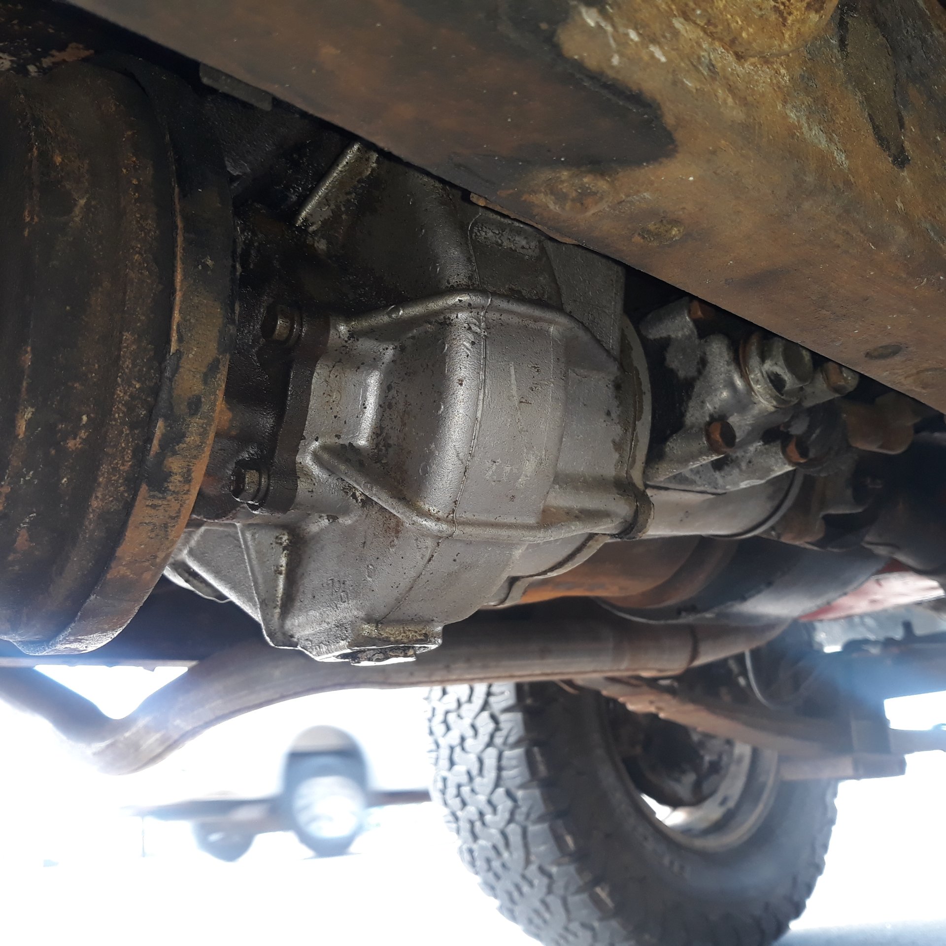

Driving home, started hearing a clank, clank, clank. Sudden looks of power, pulled over, shut the engine off and looked underneath. This part was smoking. What is this part and what have I done? I'm a noob so fo easy ok n me. 1972 FJ40.
im gonna take a @3_puppies WAG here ....... :D
- Your Transfer case DID not blow up , it's fine ........
- still check the oil level , but i dont see any huge leaks ?
- what we have is a failure
to mechanically communicate between your Clutch Disc and the Fly wheel , your smoke was a dead clutch hence the LOSS of power .........
- we can speculate all day , but focus on the obvious first , is there oil leaks ?
- then look for lack of lubrications ,,,,,,,,,
a clutch will DIE suddenly and SMOKE up badly too
that's my WAG ........
So you are saying if it's only lack of oil, I might be able to salvage it?
without more diagnosis, it is hard to say
did you feel the transfer case?
another WAG would be the transfer case has no oil in it as it is all in the transmision.
I've seen it before.
if it was run long enough dry and now is making noise, a rebuild is most likely not an option as there will be chipped teeth and worse.
if it is the transfer case, find a replacement.
again without more info it is just speculation
I believe this scenario is the most likely.
All the OP needs to do to verify is to remove the drain & fill plugs and check oil levels.

I'm with most of the others re lack of gear oil in the transfer. Just because you don't see any leaks - looks pretty dry on the outside in your photo - doesn't mean it has gear oil inside. Remove the drain plug and see if anything comes out. While you're under there take a look at the transmission. Is it covered in stinky sticky messy 90wt? If so you've experienced the notorious leak of gear oil from the transfer into the transmission where it is expelled through the transmission breather(s). My '71 experienced this getting noisier and noisier until it would no longer move under it's own power. Pulled the transfer case (not easy but can be done) and began to take it apart. Dry as a bone inside. I replaced the bearings and the main shaft with an SOR used one as the original was pretty scored. Gears were undamaged. Drove it several more years without problem. This was in the days when the internet had barely been invented and I'd never heard of ih8mud, if it even existed. Years later I heard about the bypass hose that connects the transfer to the transmission and equalizes the oil level in both or at least keeps the transfer from running dry and 3 Cruisers I've owned since all have the bypass.

Talked with a local lc shop today, they want to start at the ebrake before tackling the tcase. Ideas?
that sounds like a very Vague Diagnostic approach ?
the E-BRAKE assy is part of your Transfer-Case assy........
are there any LAND Cruiser or at least a VINTAGE old skool 4WD service and Repairs shop in any practical towing range from your trucks Current location ?
- did they test drive your truck yet in any way ?
- your feedback on my detailed tech. line by line status of events items above would be a better start and won't cost u a dime
- this shop's lets take it apart and see how it works first approach will absolutely hit you in the pocket much harder then you may realize or understand at the moment ...
just saying , those are some real world facts u should consider .........
