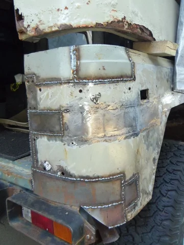

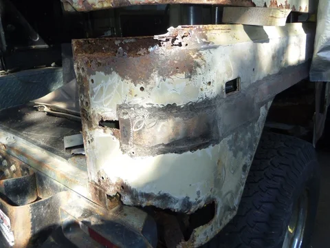

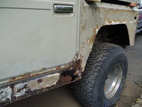

I finished the driver's side and then removed the checker plate on the rocker panels to find this mess. I was going to buy new panels from EBI but they are not in stock yet so i will make up new ones.

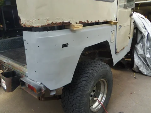

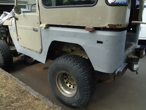

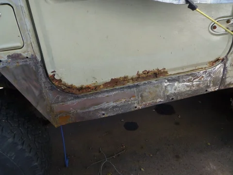

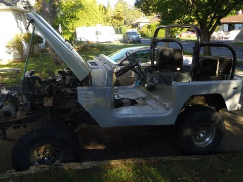

I have done very little this summer so busy with other things but i did get the right rocker done and most of the right side. My plan is to finish the r/r off tomorrow so i can start on the left side. IMGP1740.webp IMGP1739.webp
I have done very little this summer so busy with other things but i did get the right rocker done and most of the right side. My plan is to finish the r/r off tomorrow so i can start on the left side.View attachment 1113742 View attachment 1113746
Glad you haven't abandoned it, and it's just that you've been busy. Nice work on that rocker man; I'm always impressed by your work. I'll have to get some pointers from you some day.

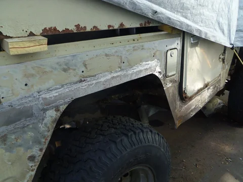

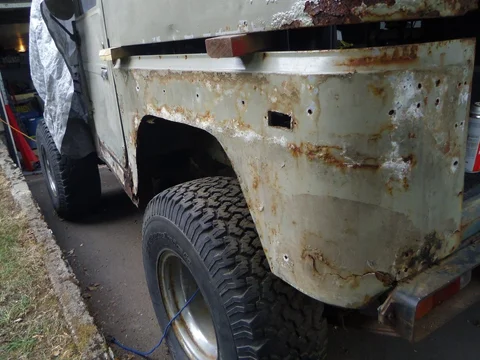

Speaking of creating something from nothing i started work on the r/r yesterday. I was doing great until my daughter showed up and needed a complete brake job on her Vibe/Matrix. I know some think i should be buying new panels but sheet metal and wire and gas and my labor is cheap compared to the price of new. And don't forget this is not a show car, this is a bush basher that is going to be covered again with alum checker plate which is great protection in the woods.IMGP1744.webp

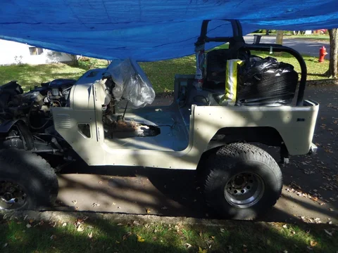

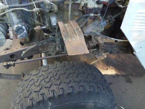

The last few days i have spent some time scraping, wire wheeling and pressure washing the frame and undercarrage and all the power train and suspension in prepperation for painting.IMGP1925.webp IMGP1924.webp
Nice work Vern! Serious transformation. Weather is good....get that painting done while you can.
