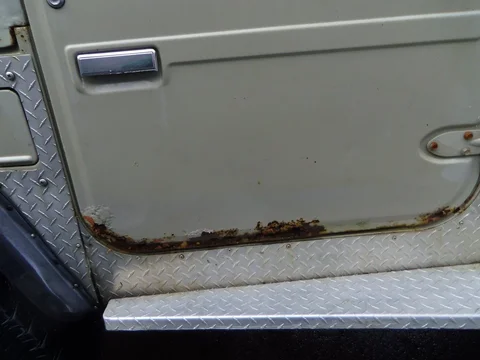

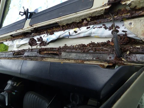

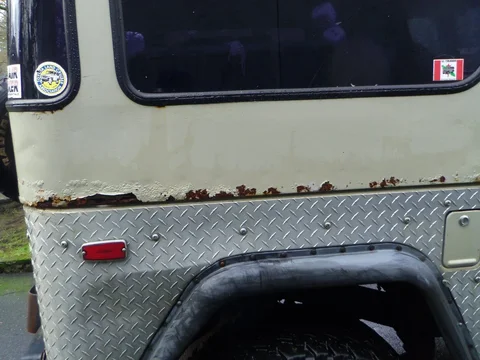

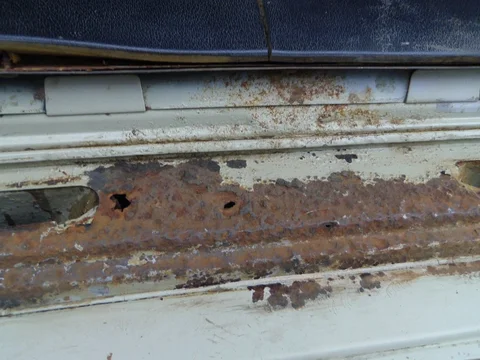

Now that the 42 is gone i can start working on the 40 again. I brought it back from the dead about 14 years ago and like all 40's it is rusting at all the usual places. When i first restored it i didn't have a welder and i did most body work with bondo and fiberglass mat and cloth and it has come back to haunt me. This time i will try to do it right. The only thing i wont have to touch is the inside of the tub as this was done with thick checker plate steel by a co-worker with good welding skills. The hood was done last year as the old one was not repairable and the first job will be to replace the windshield and probably repair rust in the cowl. On my list will be new front floorboards and the pan below the gas tank that is under the pass seat. Also front bib repair or replace and repair body damage to both front Aqualu fenders. All 4 door bottoms and the side bottoms are badly rusted and i will remove these items to work on at a later date as a soft top will be installed for now. Here are some pics after i hit the green slime with a pressure washer. IMGP1329.webpIMGP1330.webpIMGP1331.webp

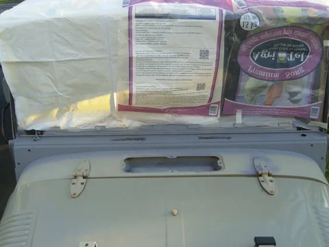

Today i am going to loosen the top so i can flop the windshield down and remove it and get at the rust on the cowl. Here is a pic of the new windshield that i found about 10 years ago and just last year restored and painted it dune beige.

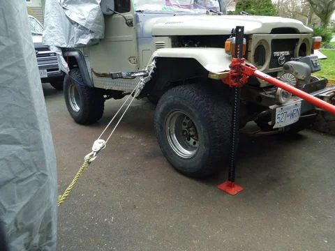

And now for some red neck body work. First you wait til the wife goes shopping then attach one end of a come-along to the brand new travel trailer and the other to the R/F fender. This action causes the front of said fender to dive downwards so you counter act this with a Jack-All and a jeesus big hammer.And now after lots of pulling ,grunting and jacking the lines line up and the fender seems to be back in it's original position.

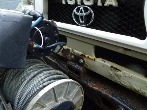

The last few days i have been working on the bib. The reason that they all rust out at the bottom is Mr. T spot welded a channel iron behind the bib for support and to mount the hinge. Because it is not sealed in any way moisture gets behind there and starts to rust so i used a spot weld cutter and removed the channel piece so i can weld in new metal. The channel iron is 2x thicker than the bib and i was able to clean it down to bare metal and will reuse it. See the before and after.
