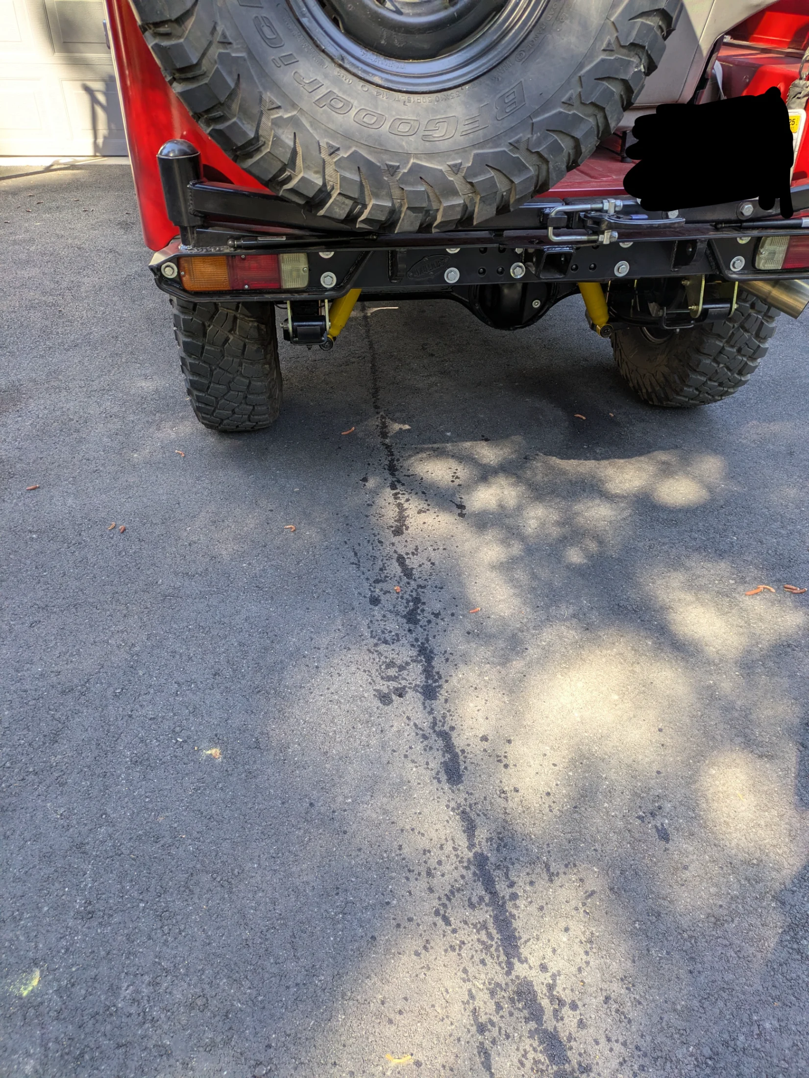

Came home today from an errand, smelled bit of burning oil while driving but didn't think much of it as it passed.

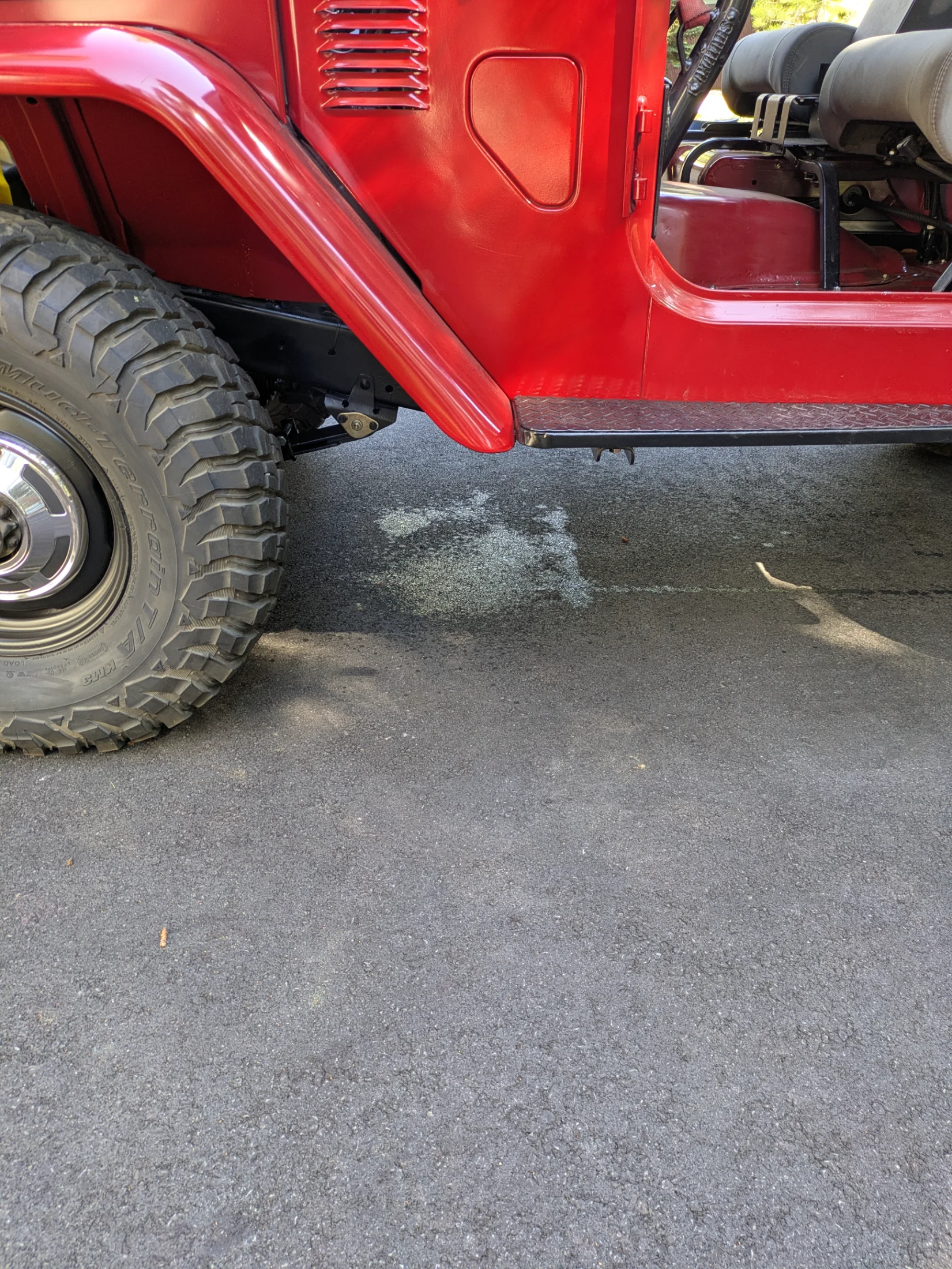

Got home and parked on my brand spanking new asphalt driveway, wife came out to me later and said hey there's a puddle under the 40.
Fuuu

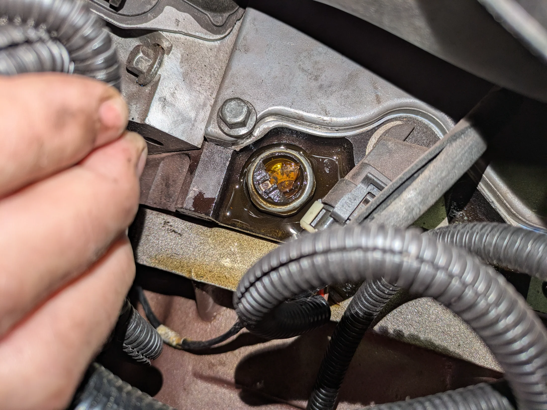

Take a quick look at it, there's oil coming from the top rear of the engine.
I know exactly what it is.
Idiot.

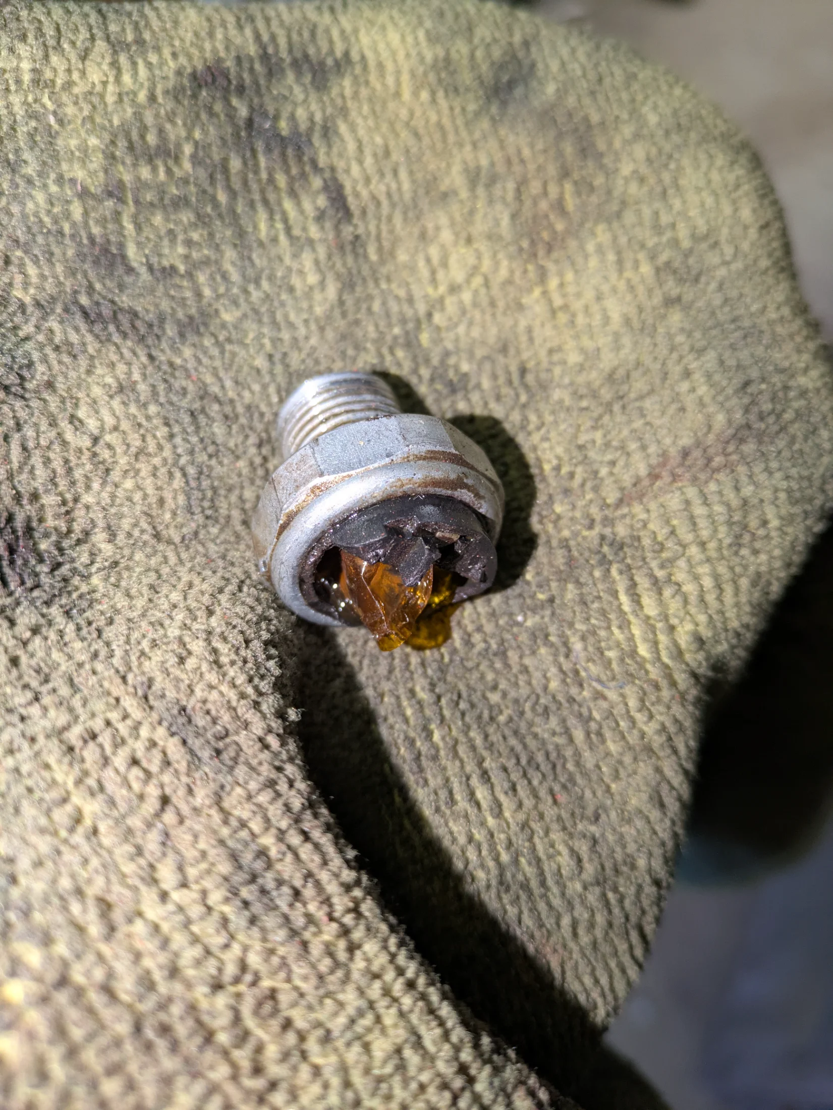

The stock LS truck oil pressure sender had the plastic connector section at the top broken off when I got the engine, I figured it was sealed and just lost the electronic portion so I installed it even though I wasn't going to use it.
Turns out it blew apart and oil is coming up through the body of it and soaked some oil down the sides of the engine and the bellhousing.
Cleaned up the oil, pulled the sender, luckily it was steel, so I just welded the inlet passage closed and reinstalled it. No more leak.
Why I didn't do that when I installed it, I don't know.
Lost .5 L of oil and made a small mess
