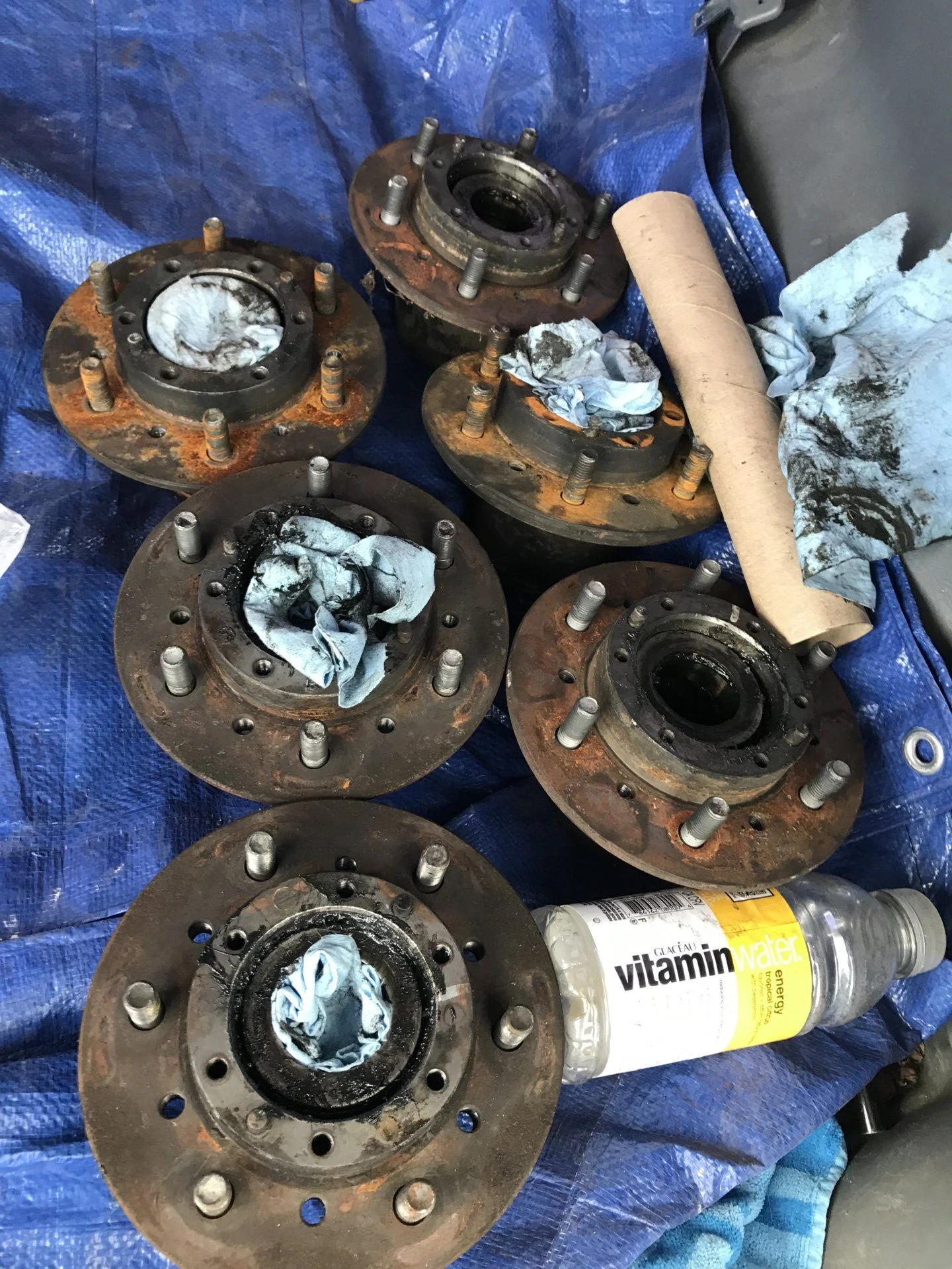

13WL casting, perfect. Got a source on those for cheap. Now for IFS hubs at the junk yard this weekend. If I see any spare sets I will grab them all. We get tons of 2nd gen 4runners in the parts yard every few months.
Not sure what the issue is with hubs. They are all over the yard I went to. I didn’t have time to pull the last set.
1901134
I’ll see how the first set goes at work on the lathe and go from there.
