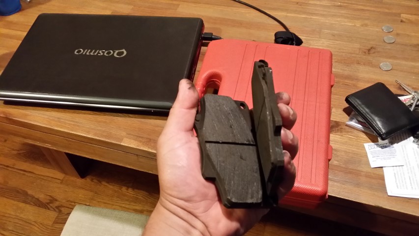

So 12k miles on the fronts? seems pretty low unless you do a ton of city driving maybe...
I could've went twice that if I let them go down to the wear sensors, but I wanted to change them out early cause I won't have access to my shop until January :meh:

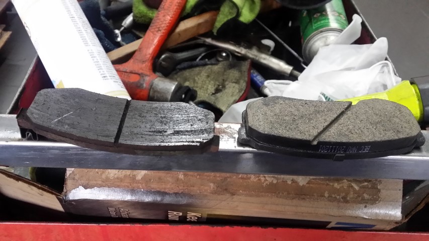

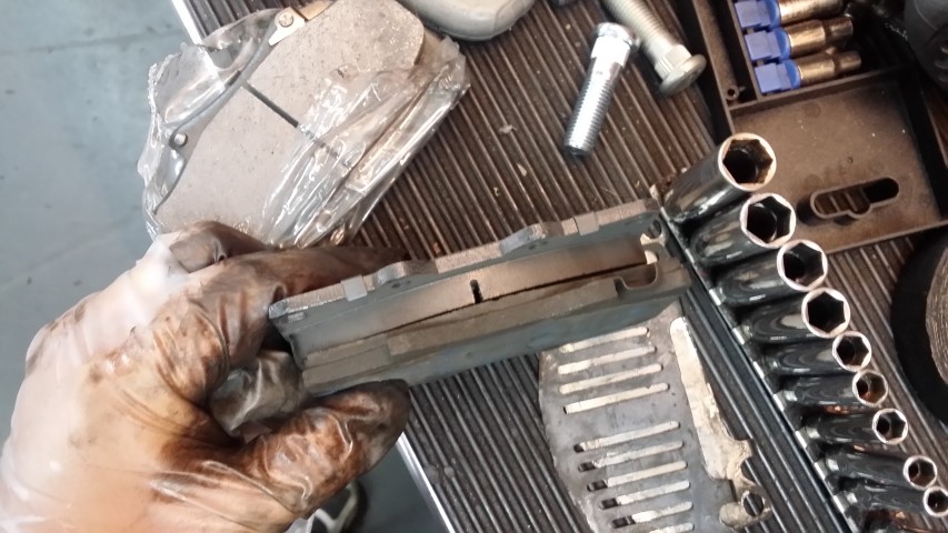

Replaced the rear pads again at 389,400 (23,850)
Also decided to replace the original rear rotors even though they were still smooth as glass, but just looked way too thin :oops:
Dial calipers read 14.39mm (I think the minimum is 16mm lol)
Also fixed a rattle I've had for a few months now (sway bar bushings)

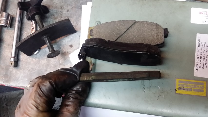

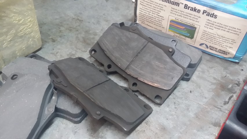

I took him up on this and ordered up the cheapest organic pads I could find for both front and rear :oops:
Beck/Arnley at $14.99 per set shipped :eek:
Both sets still had a bit of meat left on them, but pads are cheaper than rotors and I didn't want to chance digging into them while waiting for another chance of getting on one of the lifts :redface:
This was actually a couple weeks back at 408,555 miles
19,155 miles on the rears
13,055 miles on the fronts
Anyways, after a couple weeks of driving on the el'cheapo pads, I can honestly say I can't tell a lick of difference between them and the OEM's :confused:
Pedal feel and stopping distance all seem the same and there's even less dusting on the wheels :hmm:
Had a few panic stops and they seem to hold up fine :meh:
I'll post up the mileage results on the next change, but so far, it looks as though I'm buying the shop lunch :bang:

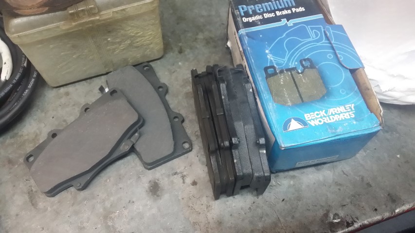

OK, recently replaced the pads in front with another set of Beck/Arnley @ 415,450 miles (only 6895 miles)
Didn't last nearly as long as the OEM's and they dust up like a muthaF'r after a few thousand miles :bang:
Thing is, as cheap as they are and as easy as they are to replace, it seems worth it to just replace them at every oil change and tire rotation :meh: (which I do every 5k miles)
