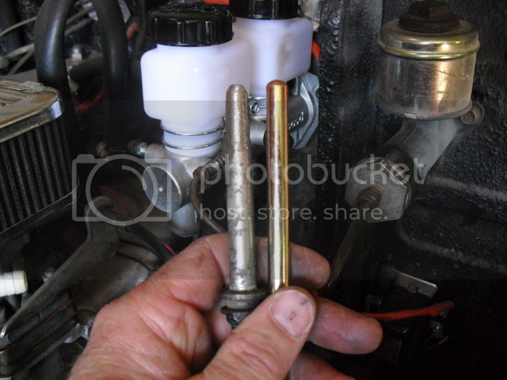

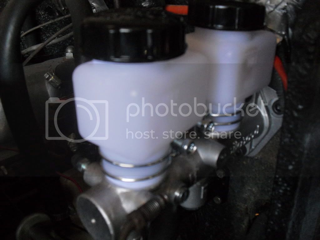

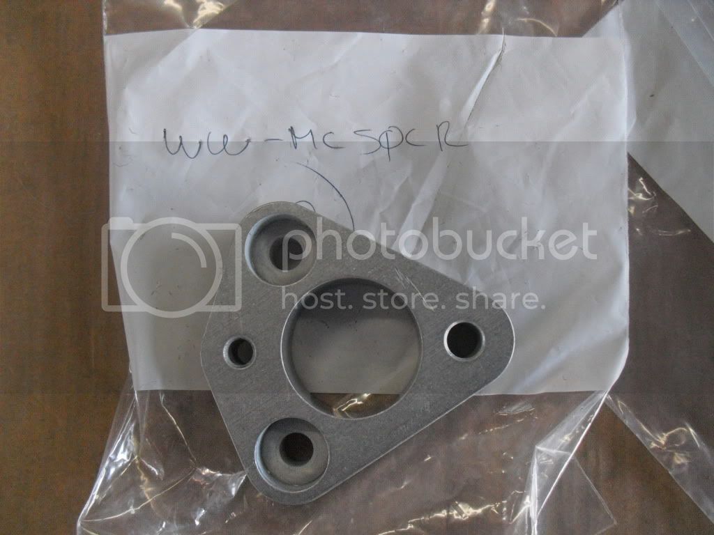

Poser clued me in on this and I thought I'd pass it on. For folks with the single circuit, unboosted Master Cylinder that want to upgrade to a dual circuit (I'm starting a 4 wheel disc conversion) without the added expense of sourcing a booster:
Man A Fre sells a Wilwood master with an adapter. It isn't listed on their website and is pretty close to a bolt on conversion. I don't have the invoice with me but the same master is available from Jegs.
I had to modify the original plunger rod to fit.
The master clears the firewall without cutting the vertical support (?) and also clears my Weber 32/36.
