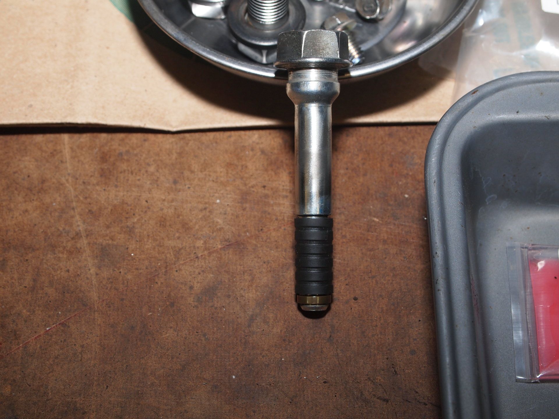

So I'm rebuilding the brakes on my 07. SS brake lines, OEM rotors, pad, shims, etc. Also pick up caliper rebuild kits. While looking at the rear caliper in the FSM, I notice it states the bushing for the lower slide pin is not reusable. Bushing is only sold with the slide pin. Now usually I replace slides because of rust, but this are ok.
Edited: In some pictures you'll see Slee SS brake lines which I did use. In some you'll see StopTech, which I did NOT use as they leak.

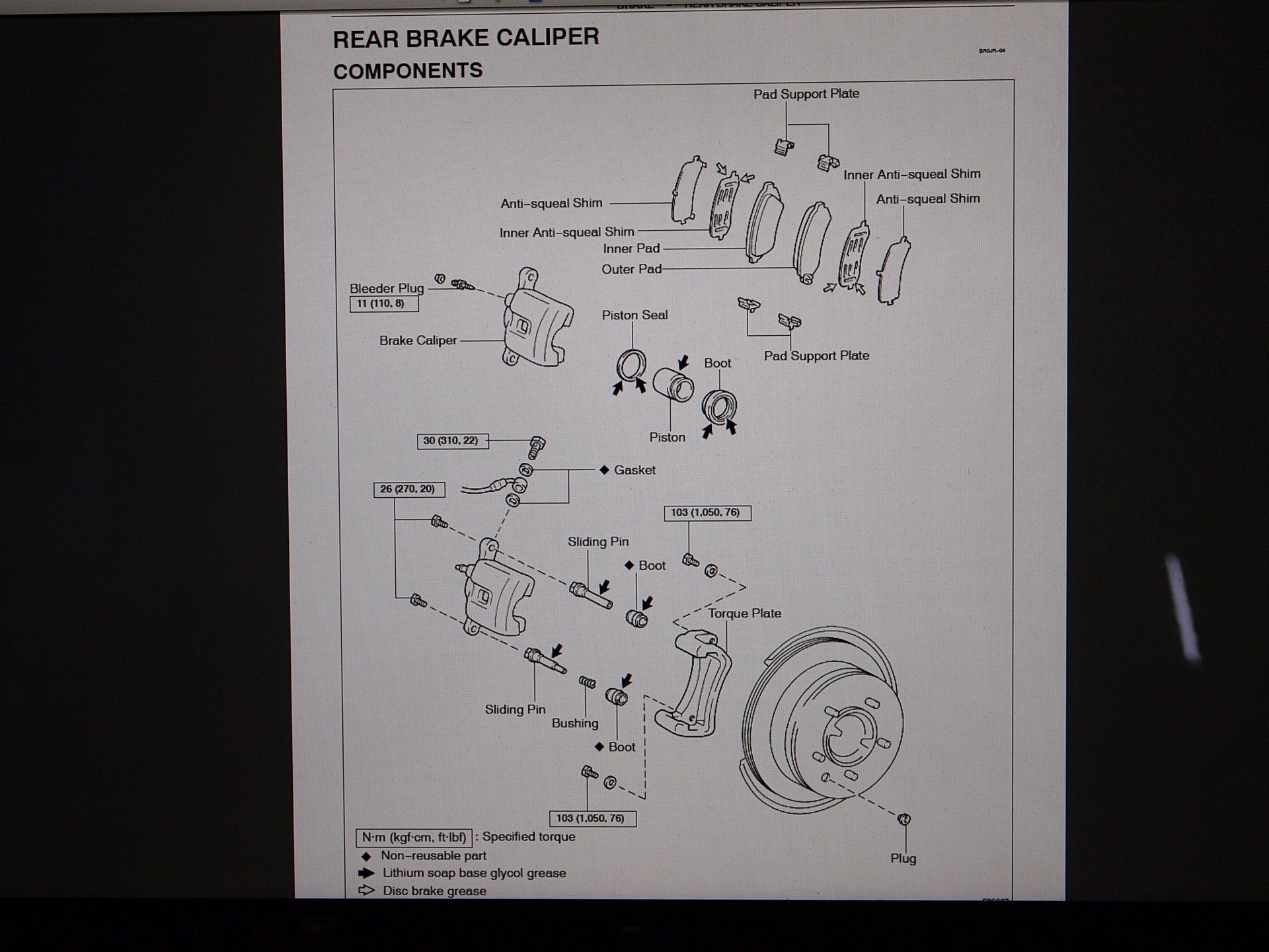

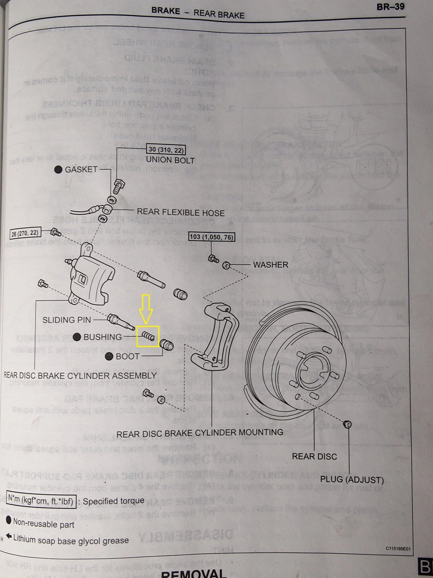

So now looking at the FSM, I'm wonder if it just means; if busing is removed from slide pin?
That if slide pin is just pulled out of caliper and bushing not removed from it, we need not replace or do we.
What do you think the FSM mean?

I too have just reused the glide pins if looked good and admittedly never notice the brass bushing or keep on the end.
The rubber bushing as @NoVaGator said "didn't seem interested in coming off"
But what I'm after is the intent of the FSM.
Example:
I had interpreted the FSM wrong for years on "wheel bearings" with two issues. One being "bearing & races" as non reusable (which I always reused). Then someone pointed out to me "That's if race removed" DUH!
In this case FSM shows rubber bushing separated from glide pin, as it does with most all component break downs. Interestingly Toyota does not sell rubber bushing separate from glide pin, nore do they include in caliper kit which you'd think they would if they recommend replacement for just going in there.
I'm sure I could pull off the rubber bushing easily, as it looks today (used). I'm picking up new OEM glide pins and I'll compare.
What that indicator means is that every time you go in there, those parts (per Toyota) have to be replaced.
Of course, you can do whatever you want.
This is what I'm after! Thanks @beno for your opinion, or is this more than opinion?

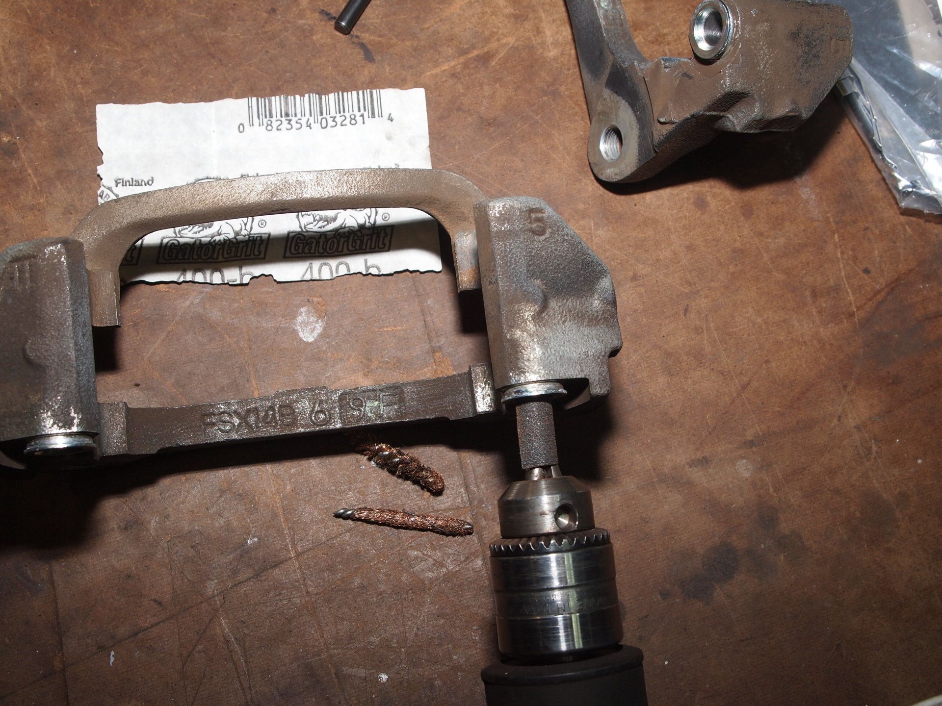

@2001LC if you're not reusing the old pin/bushing, please try to get the old bushing off of the old pin (out of pure curiosity)
It seemed to me like I would need to cut it off with a razor.... it certainly wouldn't slide off easily.
On the used ones I've pictured above, they move easily and I'm sure I can just pull off!

My rubbers were much more worn than what is pictured above here, and would rather come off than stay on. It was fiddly to get them inside the bore without getting pinched on the edge, but still they seem to hold up fine. Should have been changed of course, in that state.

The last sentence brings the question, are the pins not re-useable because of wear over the life of the pads, or because the bushings are worn into a shape once installed?

you can take them off easily, all you need is a small pocket screwdriver if the grease is all cruddy or if the grease is still good you can just pull it off with some effort

The PO probably used a mineral oil based grease resulting in the swelling, i.e. it is probably a silicone sleeve (not rubber). Silicone based greases are compatible with rubber, EPDM and silicone rubbers and are always best to use when in doubt.
I think they are only to create some drag and prevent rattling. The 'brass ring' is probably a bronze material, which is the actual gliding surface.
