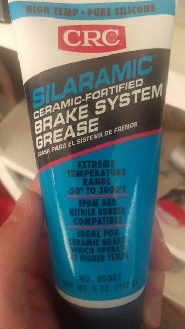

I used this stuff recently to lube the pins and moving parts. Glad I did as the pins looked like they had not been lubed in 10 years.
It does say it meets Japanese rubber standards on the back.
