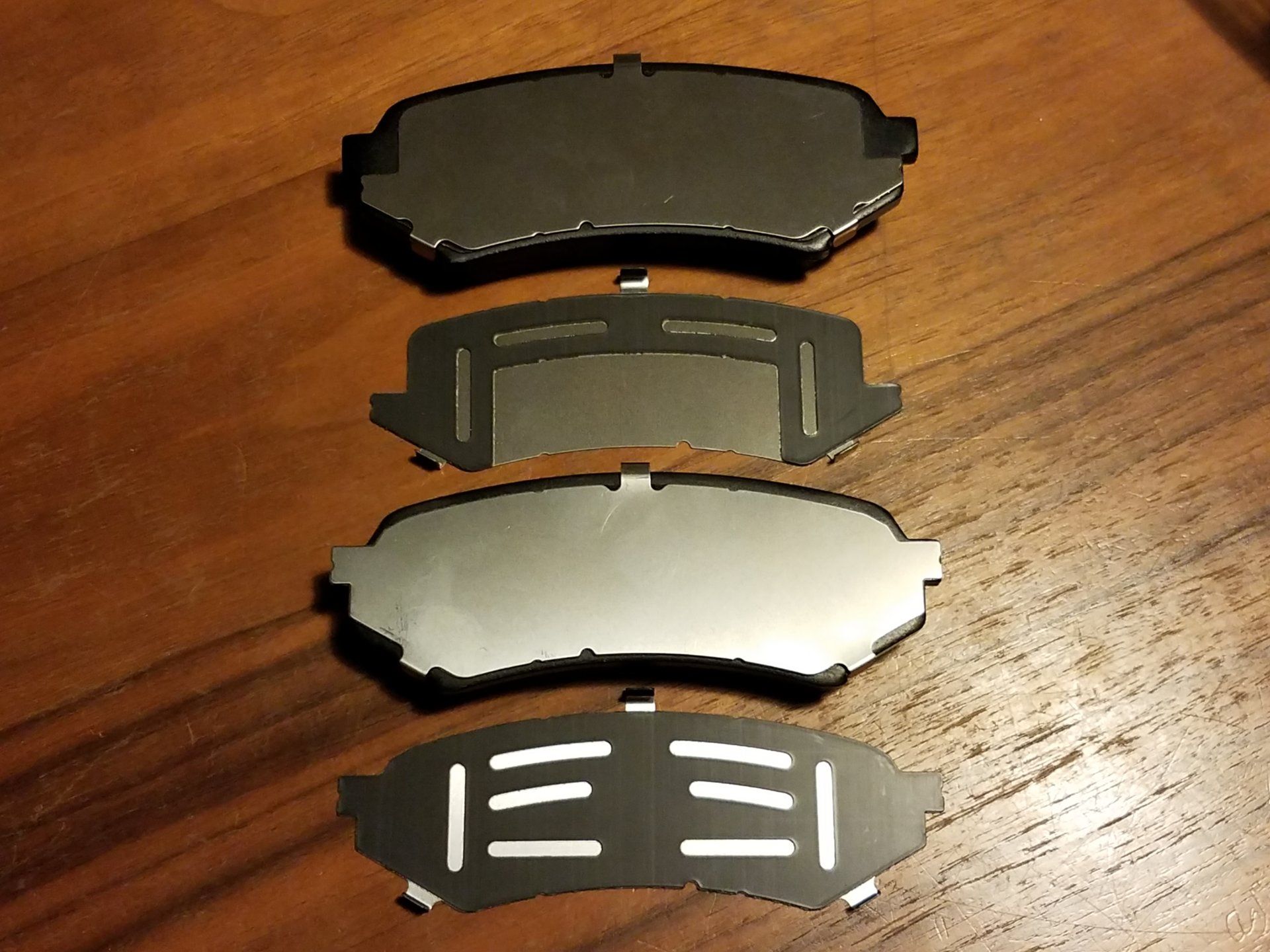

Hey guys, planning on getting into my rear brakes soon, with parts now on hand. Rotors, pads, shims, boots, pins, all of it new Toyota parts. But I've never been in there so now I do my homework first. Maybe it would be apparent once I get in there, but it might wrong as well.
The FSM shows an inner and outer shim. The shim kit 04946-60031 comes with four shims. It looks like the inner (die cut slots with a slight rubberized coating) and outer (flat with no coating) have been attached by Toyota, is that correct or am I missing some parts?
Next question: which shim goes on the inner pad, and which on the outer pad? Does it matter?
Finally, I'm guessing the wear indicator goes with the shims that are on the top?

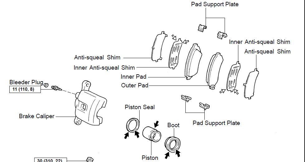

Put the shim with the rubber coating in the middle (bottom shim in pic) on the side with the piston. Check the diagram in post #20 of the thread - you can see it specifically states "inner anti-squeal shim" with the same design as in your pic. The piston basically locks its shape into the shim (metal/rubber) to get a good bite on the pad and reduce vibration.

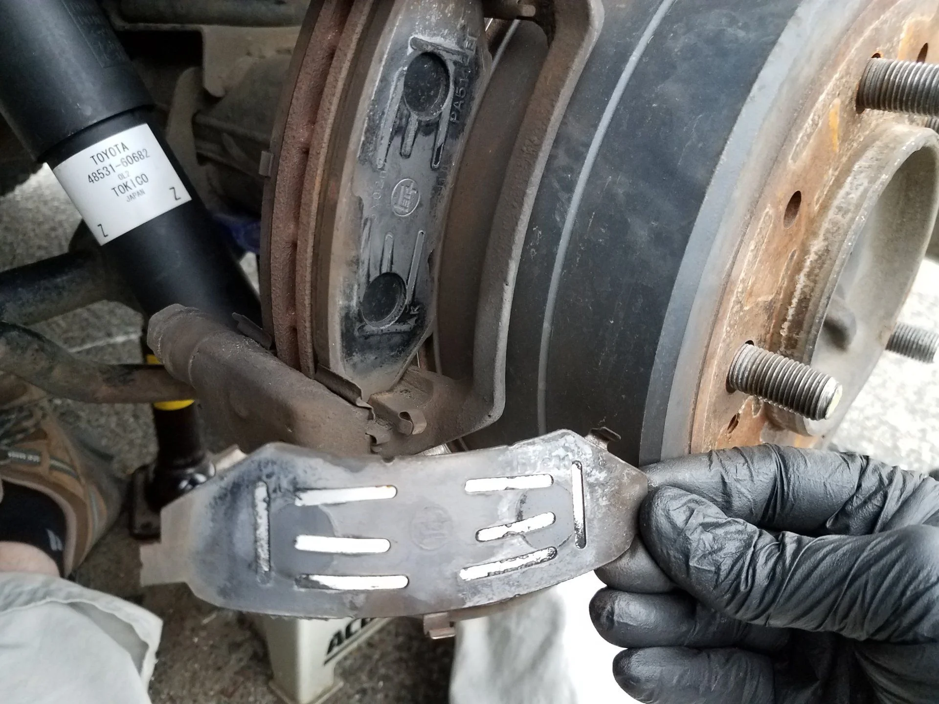

I too have put the shim with full rubber coating on side with piston (inside). Which you'll see in pictures on page 2. This insures full and even contract between pad and squeal shim from piston. This puts other (horse shoe shape rubber) on outside, which matches shape of torque plate. This then means wear indicator goes on out side, as it does not clip over squeal shim.
But in looking at brakes that have no records ever being removed. They have wear indicator inside and are set up with full shim that covers tabs of pads on outside.

Here is the picture from the FSM, it shows the two "inner anti squeal shims" in between the flat outer shims. it also appears to show the wear "squealer" on the outer pad.

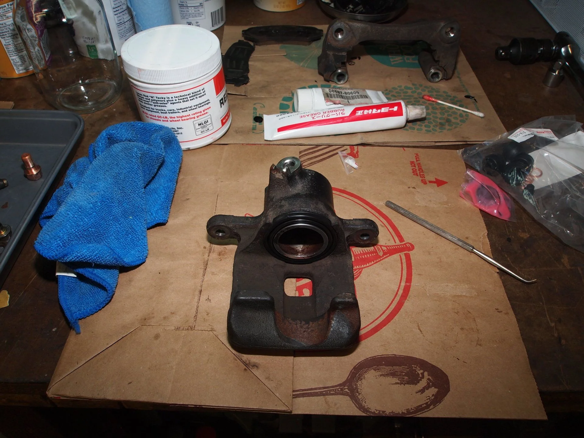

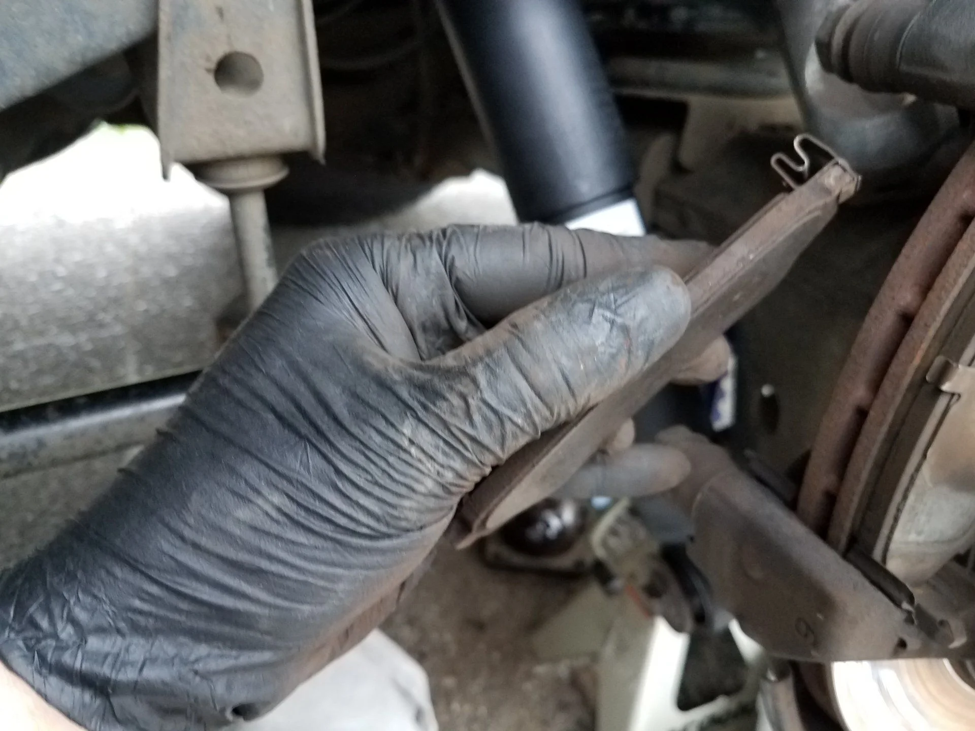

Some observations. Brakes were last done at a dealer with new rotors, reman calipers. They installed shims with more full coverage shim on outside pad, and the wear indicator on the inside pad, as mentioned by 2001LC. Both sides were the same. Mentioning here to add to our knowledge base. I installed the new parts the same way they came off. Both of the inner pads were thinner than the outer pads. Used CRC Silaramic caliper grease for the job, really like it. The second picture shows inner pad and location of wear indicator. Noticed the new guide pin with rubber bushing was pretty dang tight going in, even lightly lubed, considered reusing the old one but nah, went with new one.

Wear indicator inside is what I'm seeing on low mile rigs. Which I believe to be factory install.

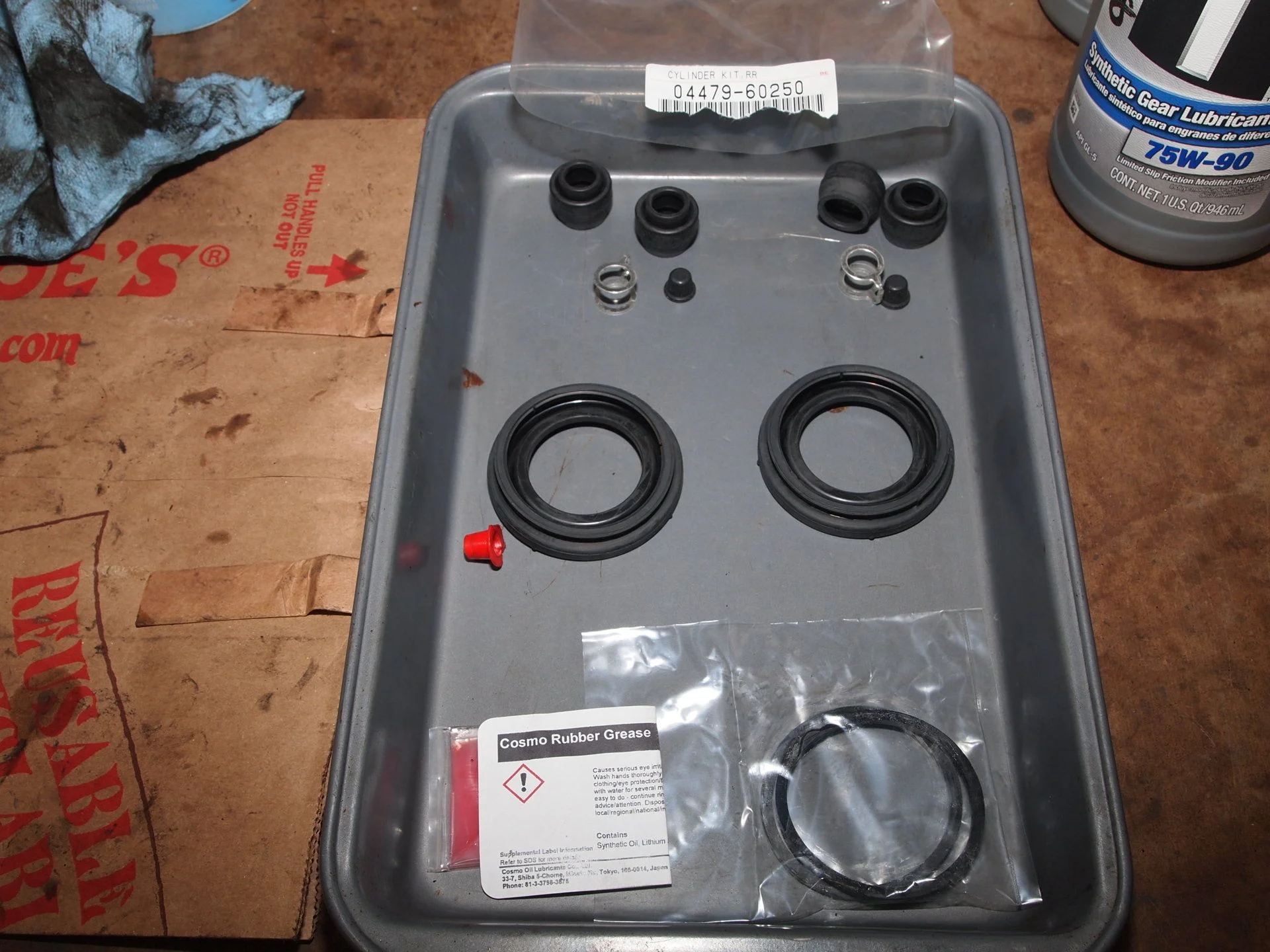

So replacing my rear pads on my '99 cruiser and want to replace the rubber boots on the slide pins, was wondering if this is the correct part number for the kit that comes with the boots I need
04479-60250 Toyota Cylinder kit, disc brake, rear ?
Can anyone confirm

parts.toyota.com says 04479-60060
The part number you referenced 04479-60250 is for the 2003-2007 rears.
So 04479-60060 is for 1998-2002
04479-60250 is for 2003-2007
