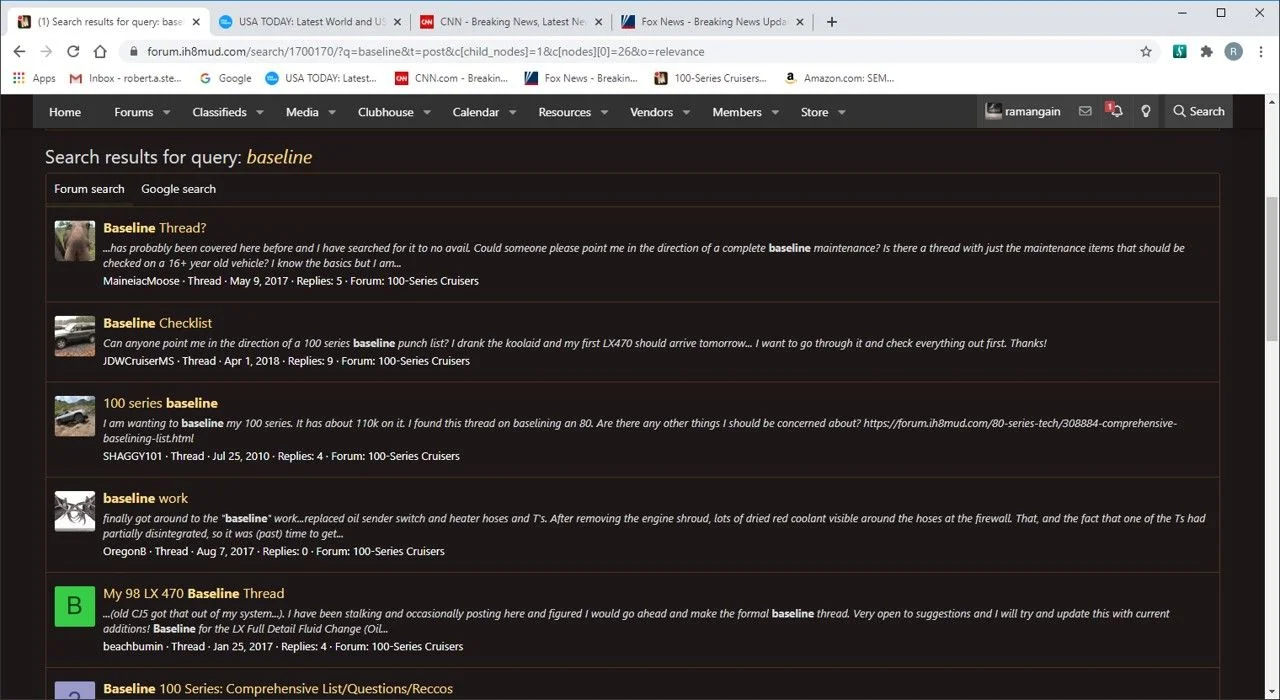

Sky is the limit with the almighty search function ...
We're not trying to be rude ... just point you in the right direction so you can get up to speed efficiently. We all started somewhere ...
I wouldn't be super concerned about the t-belt, peeps go waaaay past the service interval all the time, but it sounds like you're already having it done. Brakes are easy to check for pad thickness. Then, like has been mentioned, start your own baseline. Someone will also mention the heater-t's. Again, not a critical priority, but one of the few things on these trucks that can strand you.
