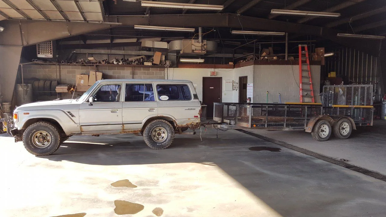

BOSSKLLA DJ60

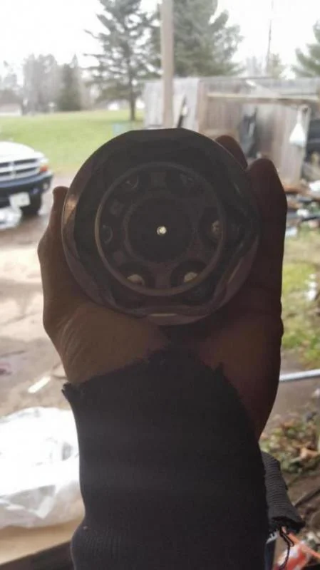

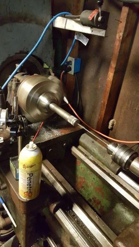

To add a little more, I recently rebuilt my front axle with some kit on ebay from New Zealand. Came with new cv joints or "birfields" as some choose to call them. I also bought a 7/32" gun drill which is just a fancy super long drill bit with one cutting edge.
Chucked the joints in my lathe and got to work. VERY SLOWLY. I did not want to break the fancy tool that was going to make my dreams come true

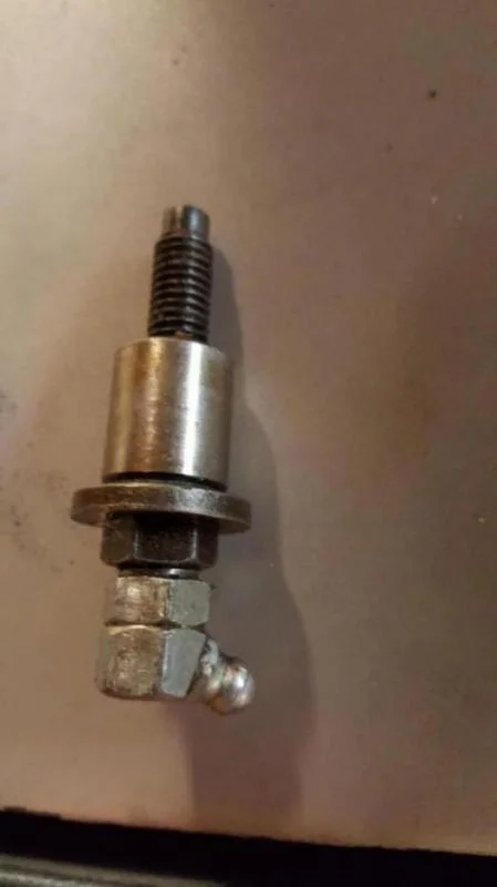

Instead of tapping each joint for a zerk I drilled out a bolt and put a zerk in said bolt which screws into the joints.
Voila! Greasable cv joints! No need for some fancy machinist!

Can you explain the point of greasable birfield? I've never pulled one out that was dry.
I love your "Go for it" attitude. I think you're doing some great work and gaining great experience. Well done.
To be honest I have zero experience with the Toyota solid axle. But the time came where I had to learn it. Even though I am a school bus mechanic now, I come from an industrial maintenance background. That means I'm a maintenance nazi!
So beneficial or not I wanted to do this. I already had the lathe and a gun drill was 20 bucks shipped to my door.

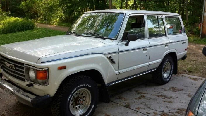

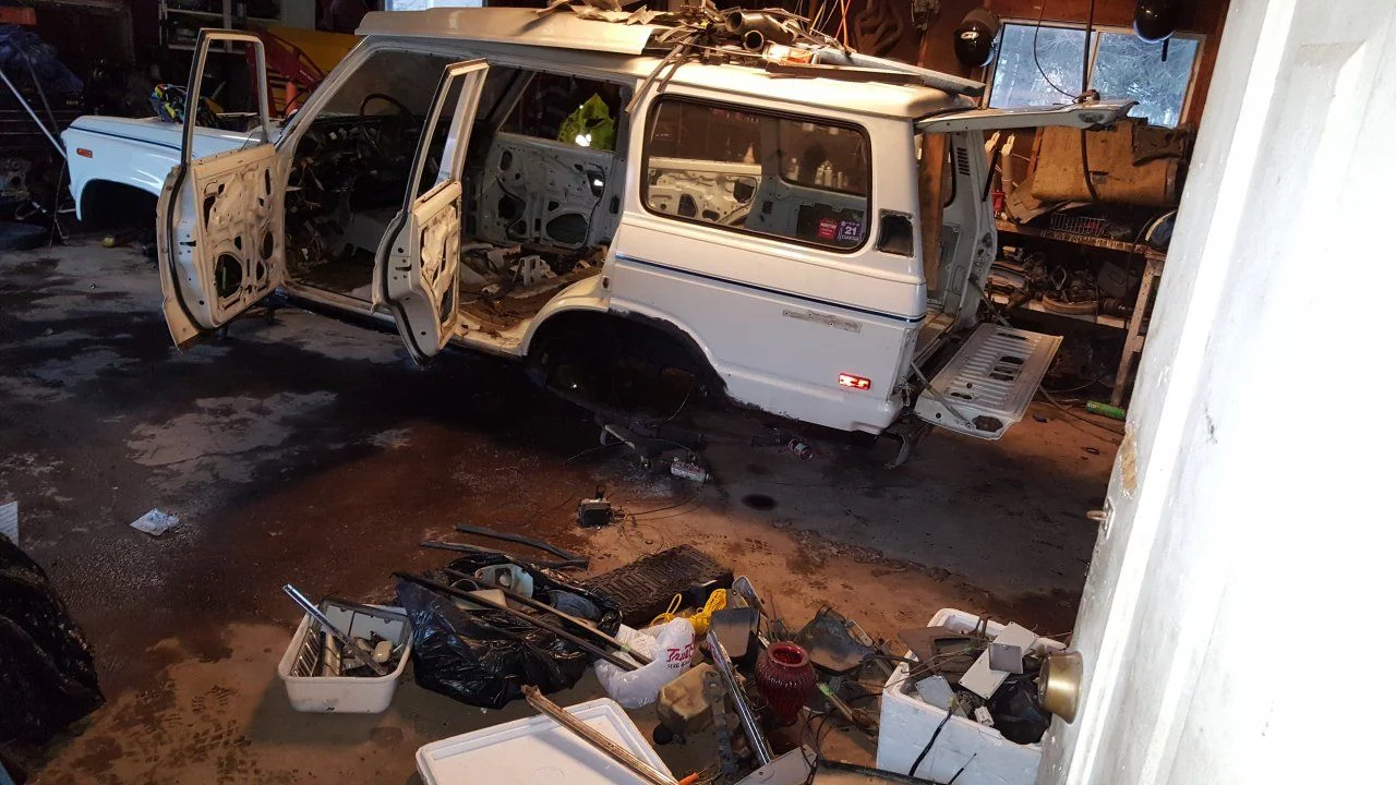

Here's the new shell

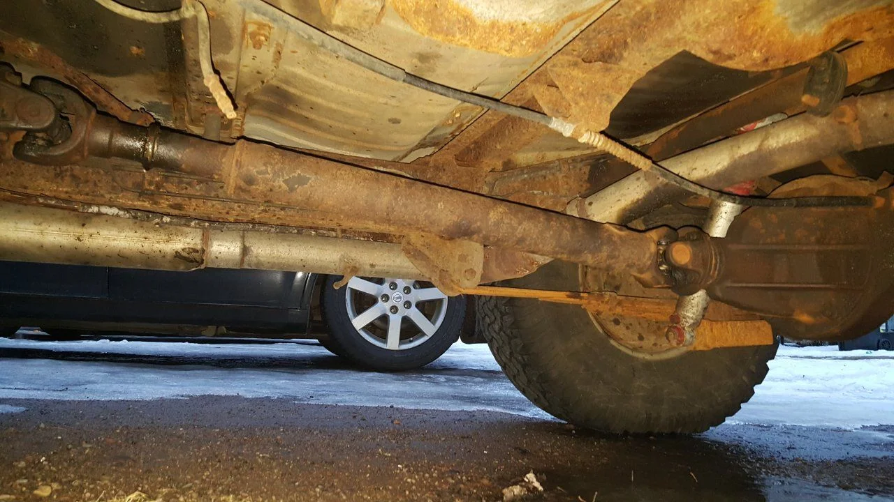

Here's how it looked before the previous owner ripped it apart to restore his cherry cruiser

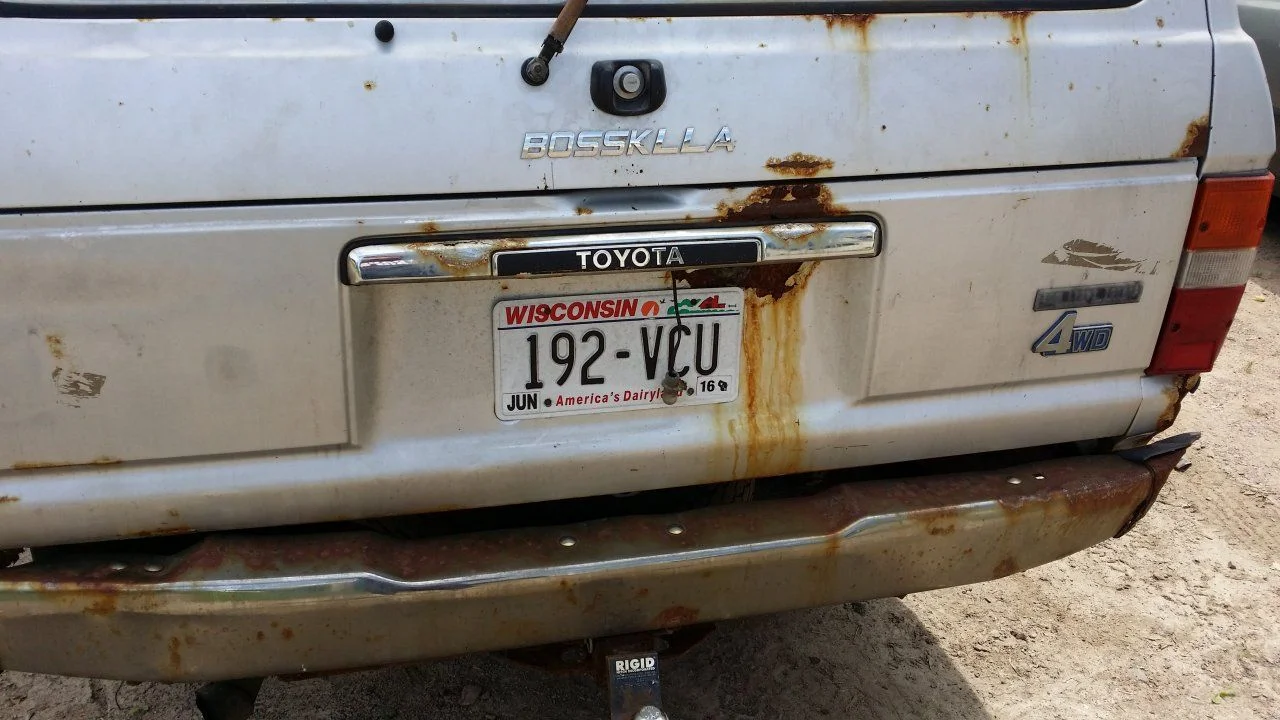

Rust is not nearly as bad as my silver body
I've got a long road ahead of me...

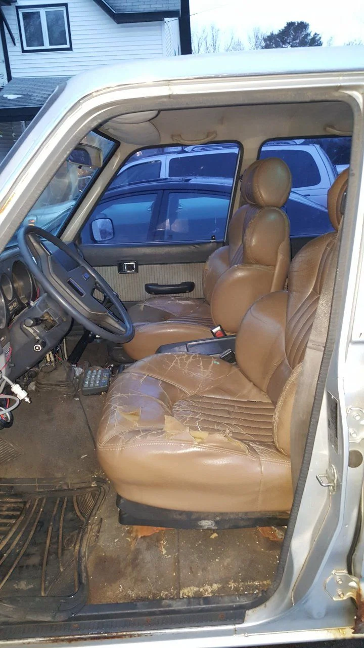

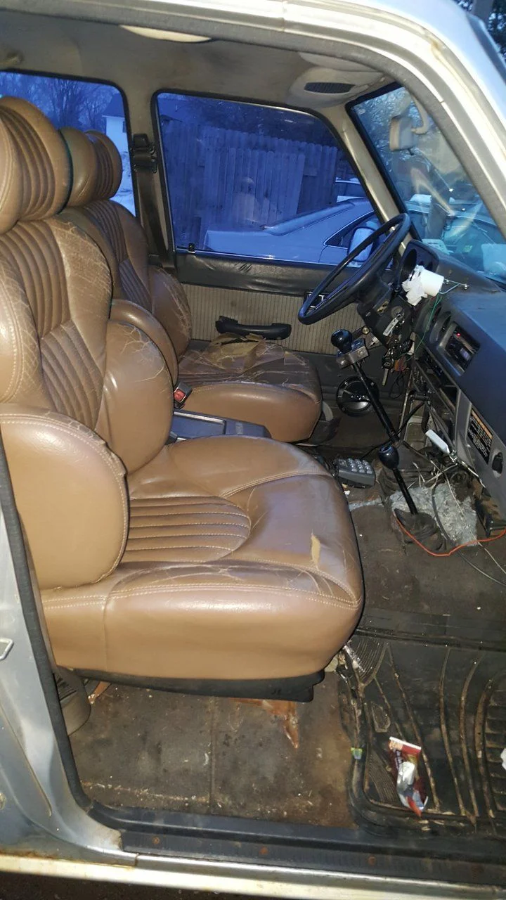

Bonneville ssei seats.
Yes I realize the brown is majorly clashing with the blue. They were next to free

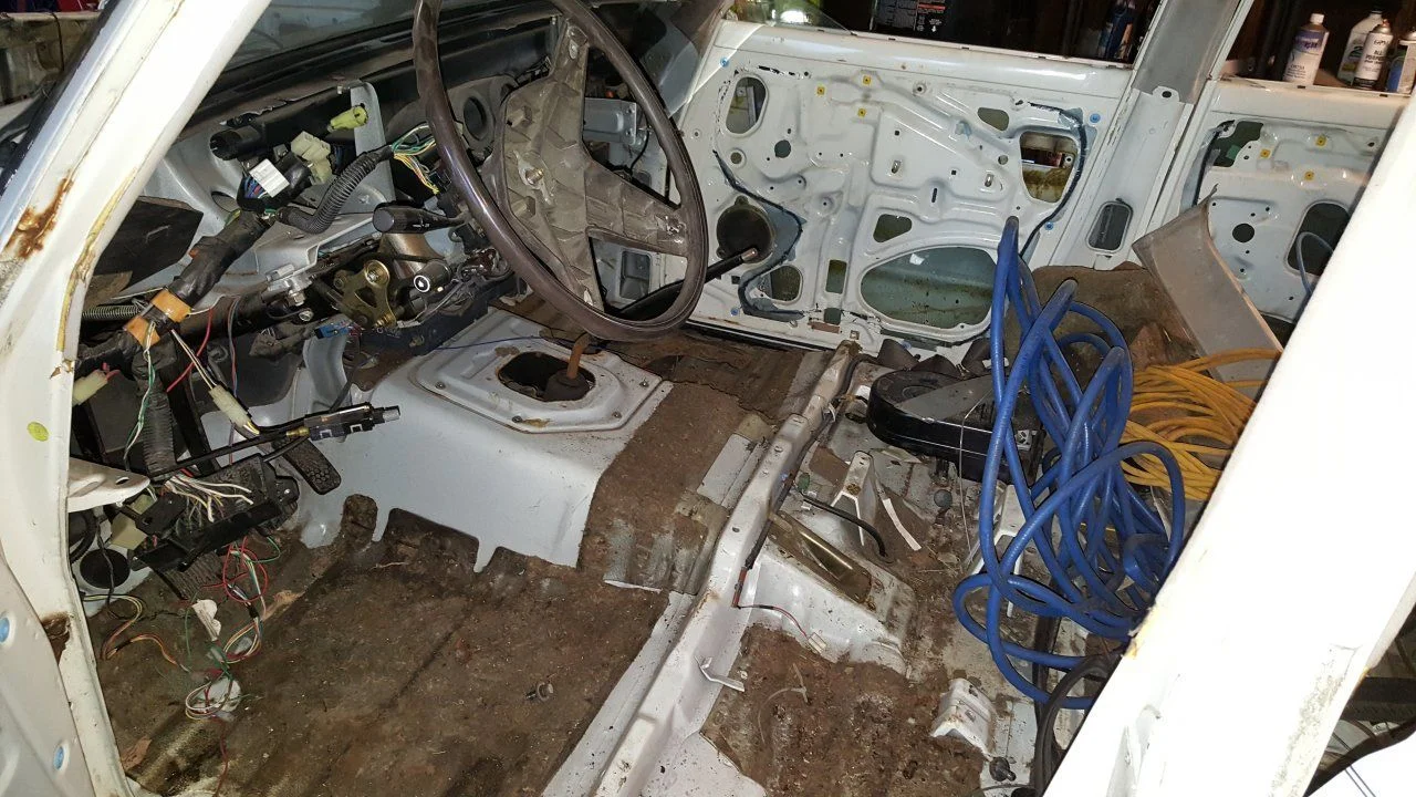

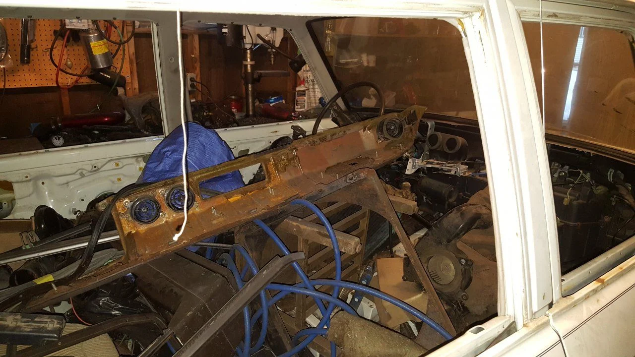

Thanks a lot fellow mudders. Ive finally looked at enough threads of guys restoring their cruisers, that I got in the garage and cleared everything out of the new body.

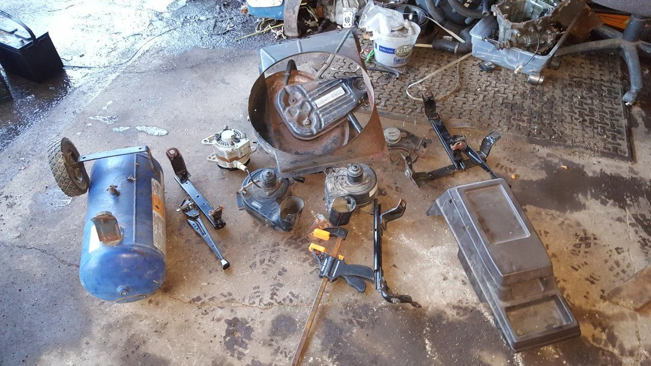

I got this high tech method of organization see...
The pile that stays
And the pile that goes

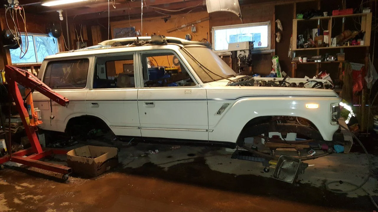

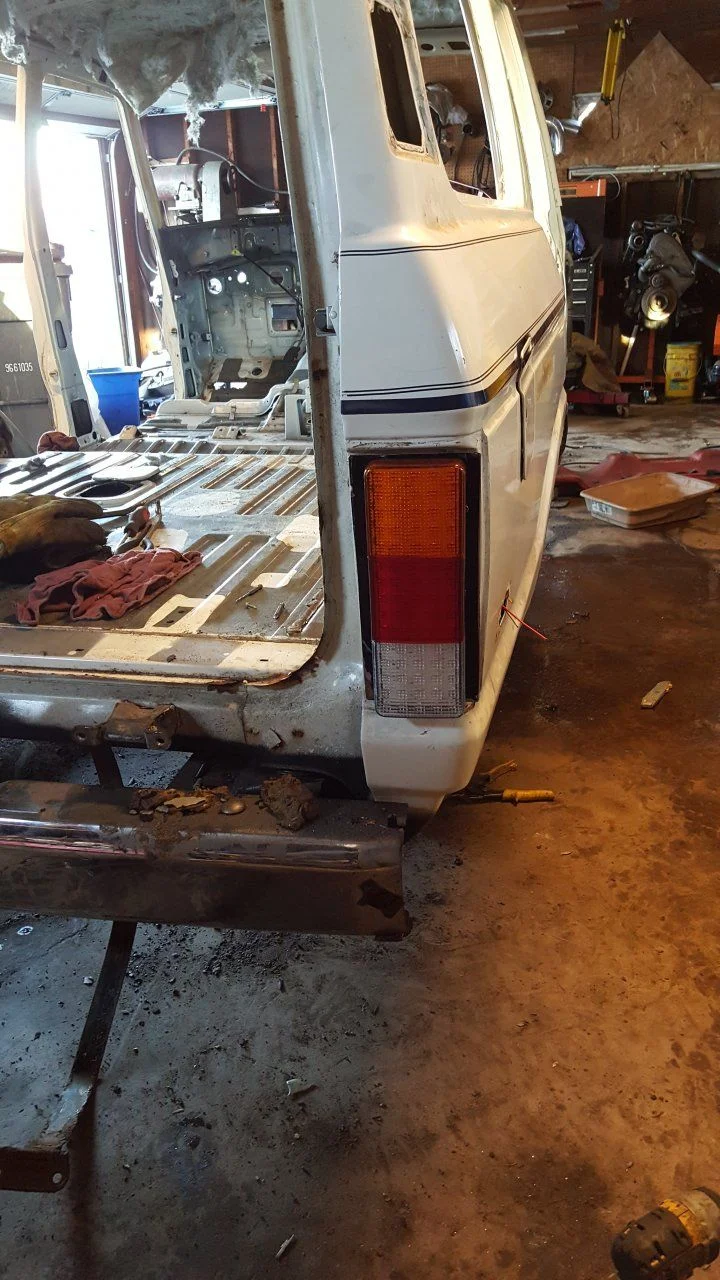

Gotten a little more done lately.

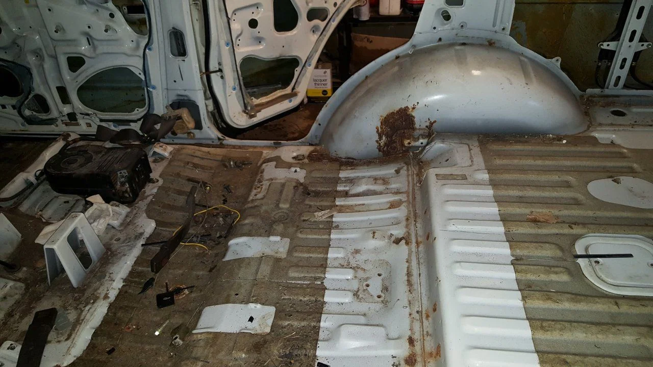

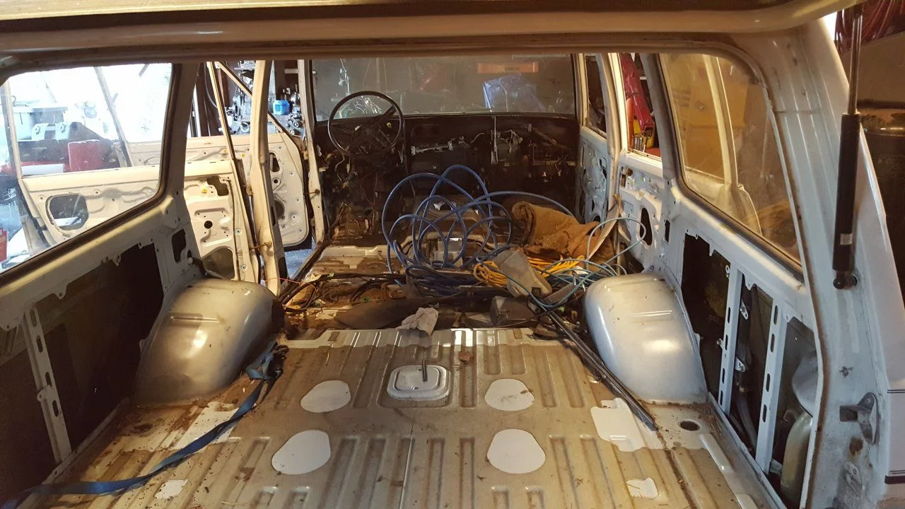

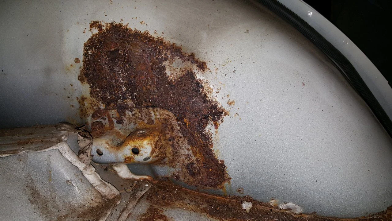

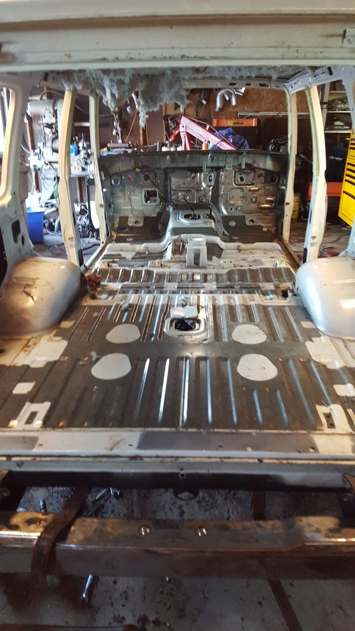

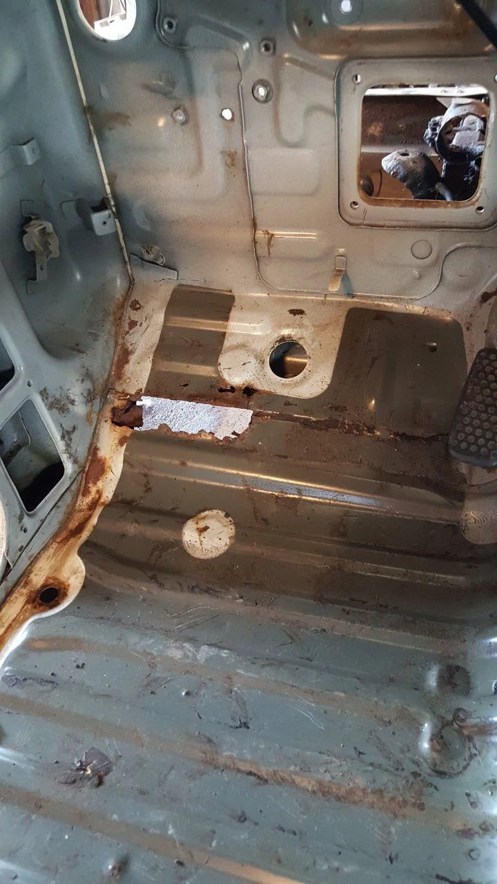

All glass removed, hung the doors from the ceiling, removed the tar compound on the floor, removed the head liner in 2 pieces and removed the coc#sucker POS ******* gas tank after draining the 18 gallons of old gas from it! That was a surprise, scrambling to find drain pans fast enough.
Got some metal work to do. I would like to do monstaliner like bluehawk did. EVERYWHERE.

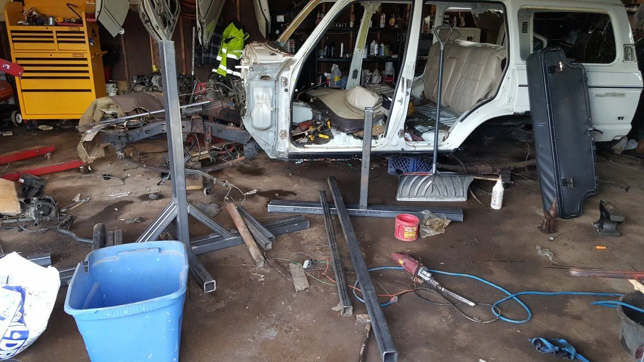

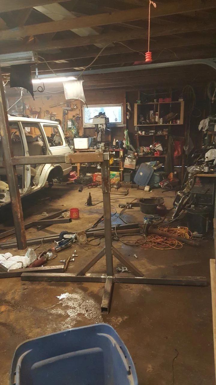

Also plan to build a rotisserie after checking out bluehawk's build. That is the way to go! Found some free plans from redwing steel on the Web.

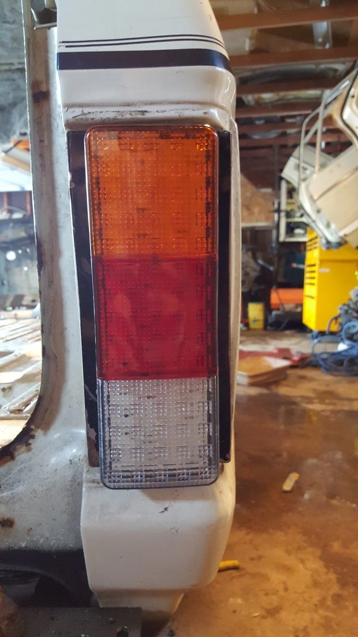

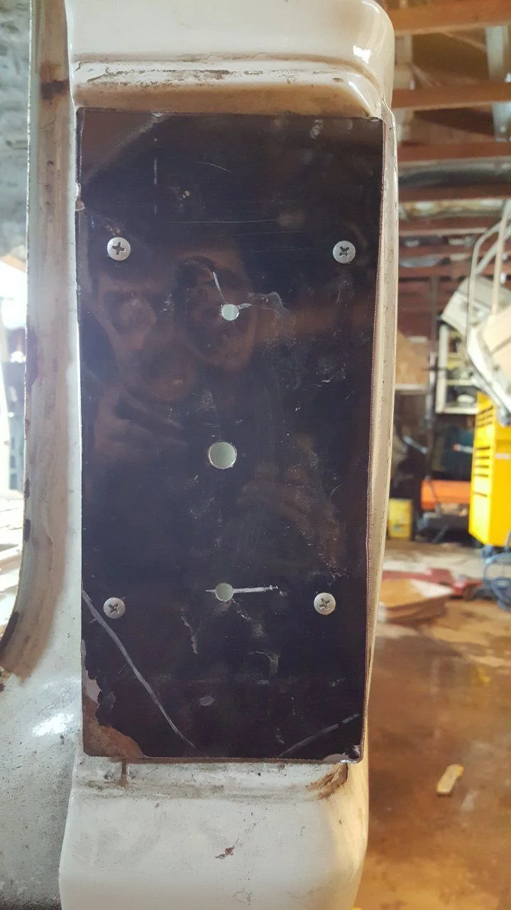

I sorta test fitted one of my new led taillights. I whipped this up in about 10 minutes because I just really wanted to see what this would look like. And I think I'll like them. I don't however like how far they stick out so I'll come up with a way later to recess them into the body.

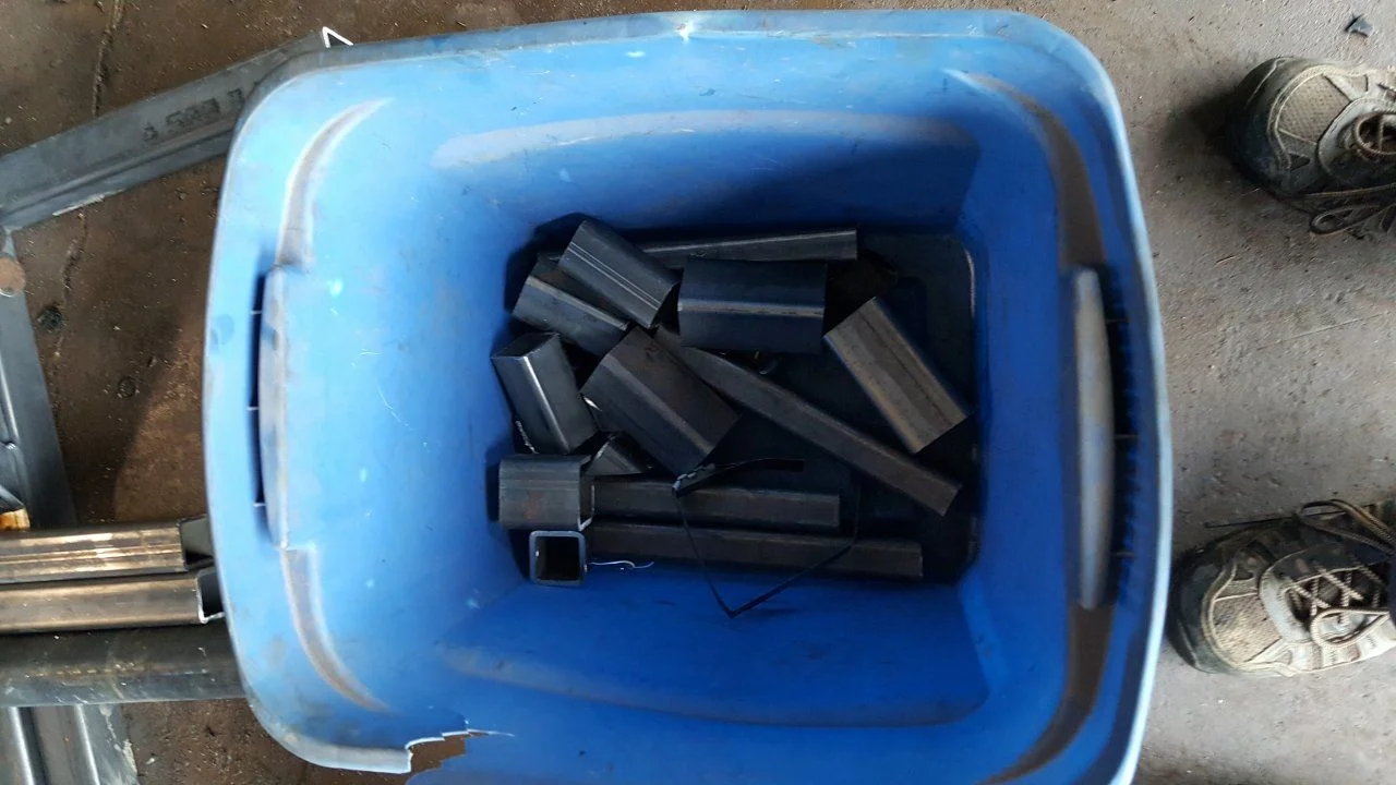

Got most of the steel to build my rotisserie. I think it's gonna come in right around $350.

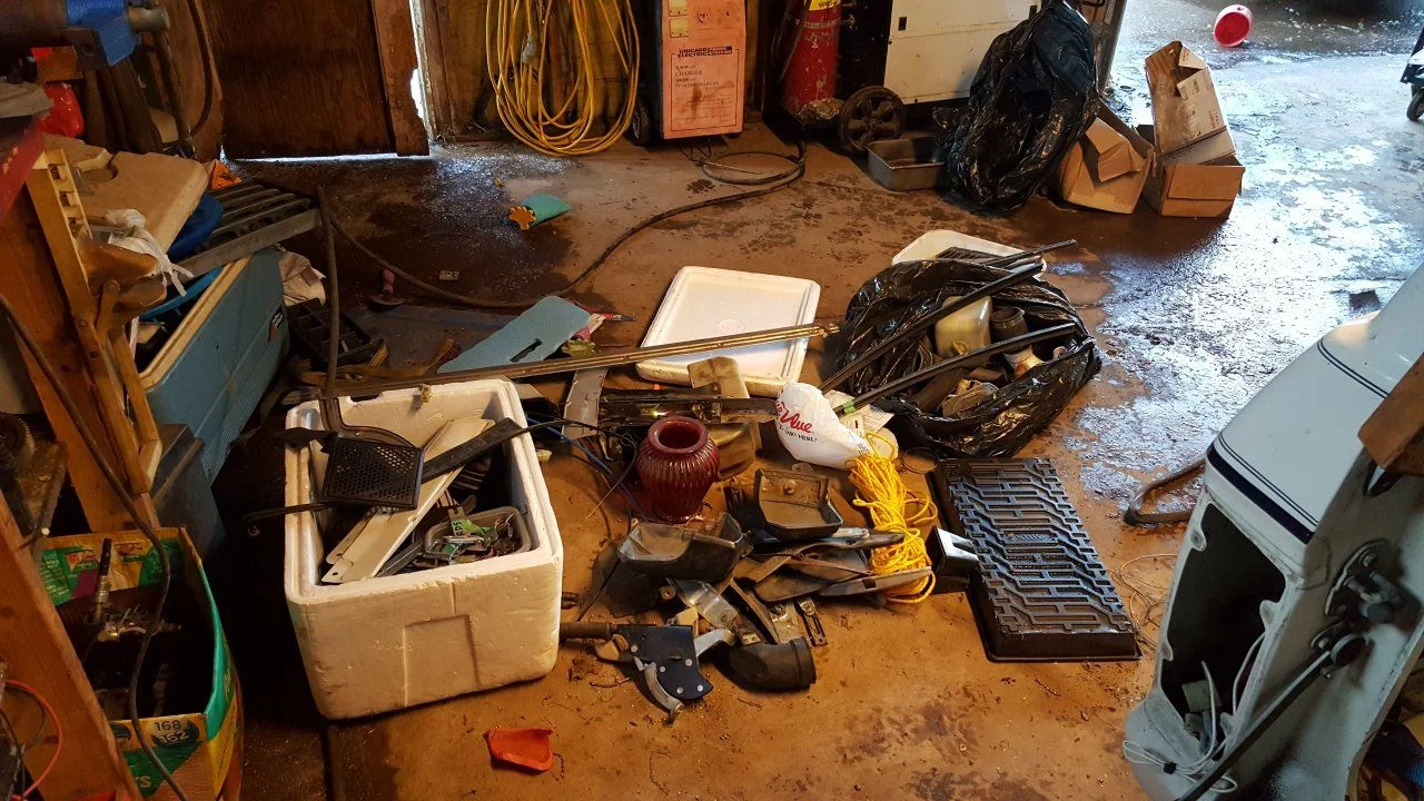

Got to clean up my garage!
Nothing to be envious of here, the first pics are of where I work. That last pic is in my garage which is just a 2.5 car garage with many various engines transmissions and junk.

Got some more done on my rotisserie. I made one about perfect then got going too fast on the second one. I think I'll have to make a whole new pivot point because this irks the s*** out of me!
