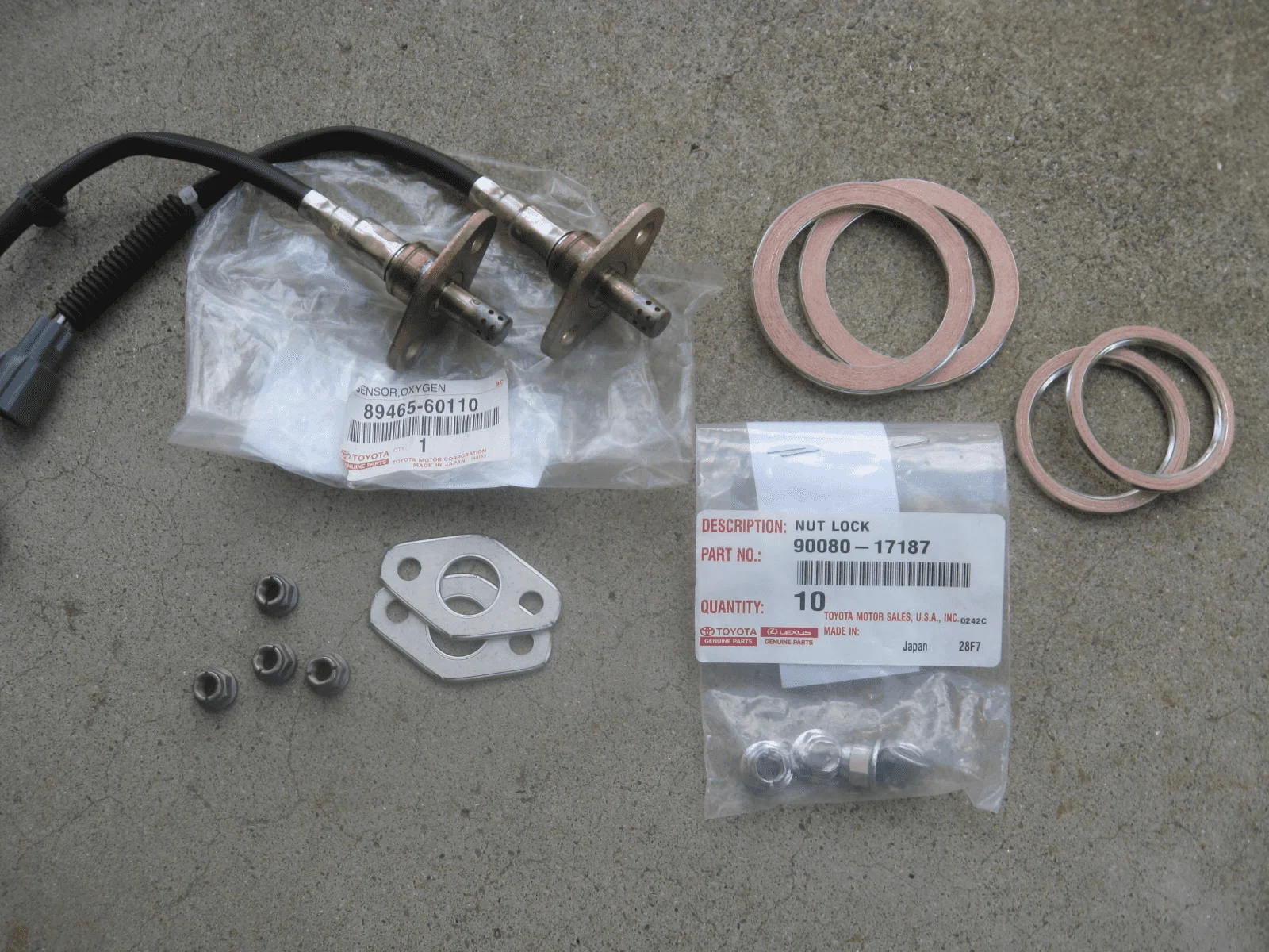

Here is a photo of what comes in the factory kit, less the 4, round gaskets, and head pipe lock nuts, those are extra cost items. In my case i needed those extra items to replace my O2 sensors. That's because i had to remove my cats from the truck to install my O2 sensors.
