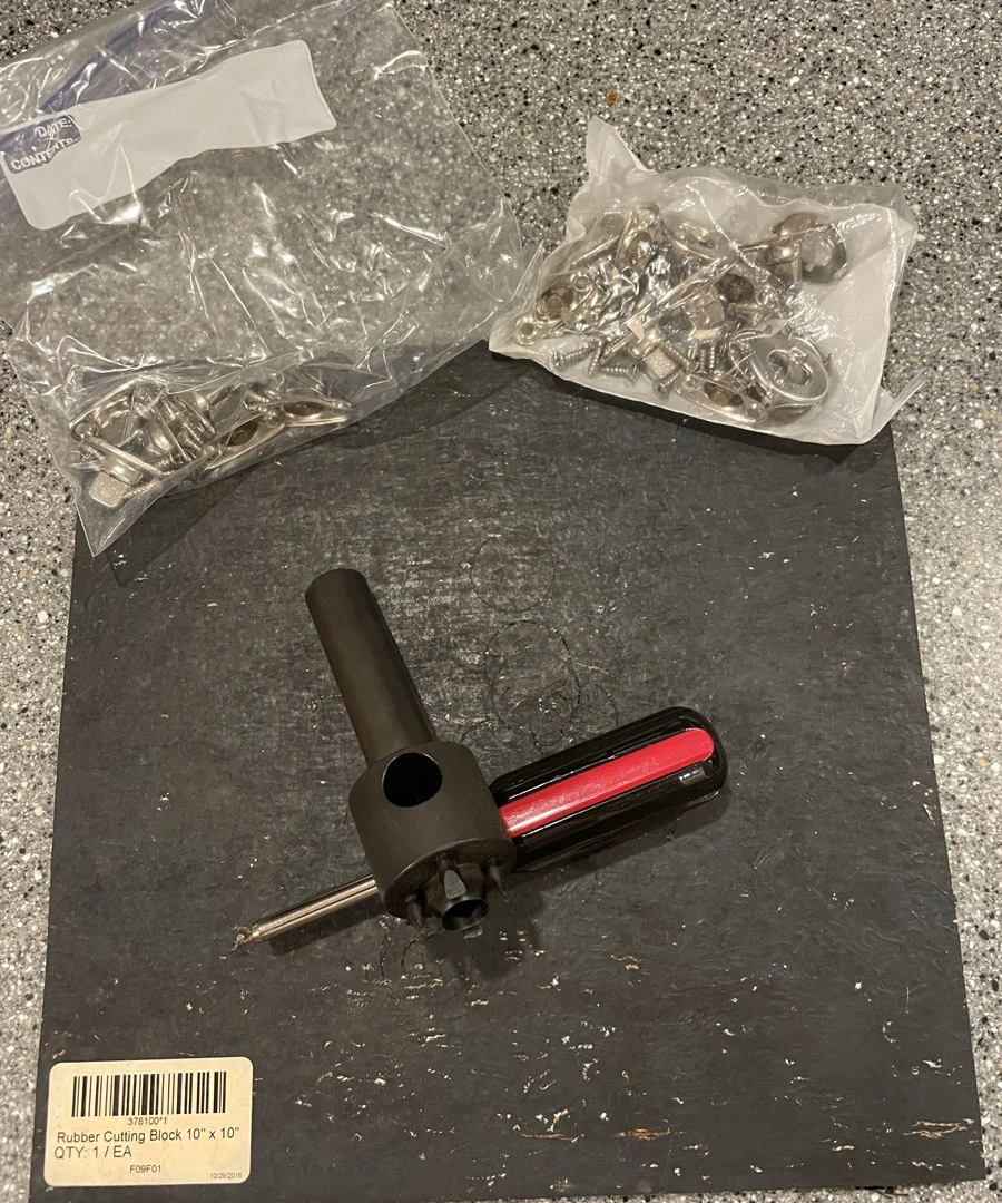

Anyway, I haven’t seen it mentioned yet so I will. When using this tool, it’s important to use a rubber cutting block to protect the tool. If it’s used by backing it up with wood, a kitchen type cutting board, or some sort of plastic, damage will probably occur. Mine doesn’t get a lot of use but with the rubber cutting block, it stays sharp and looks like new. I just saw they have another style cutting block also. I get my stuff from Sailrite.
“Hole Tool” “Prong Tool” "Cutting Block #1" "Cutting Block #2" Both cutting blocks have videos.
