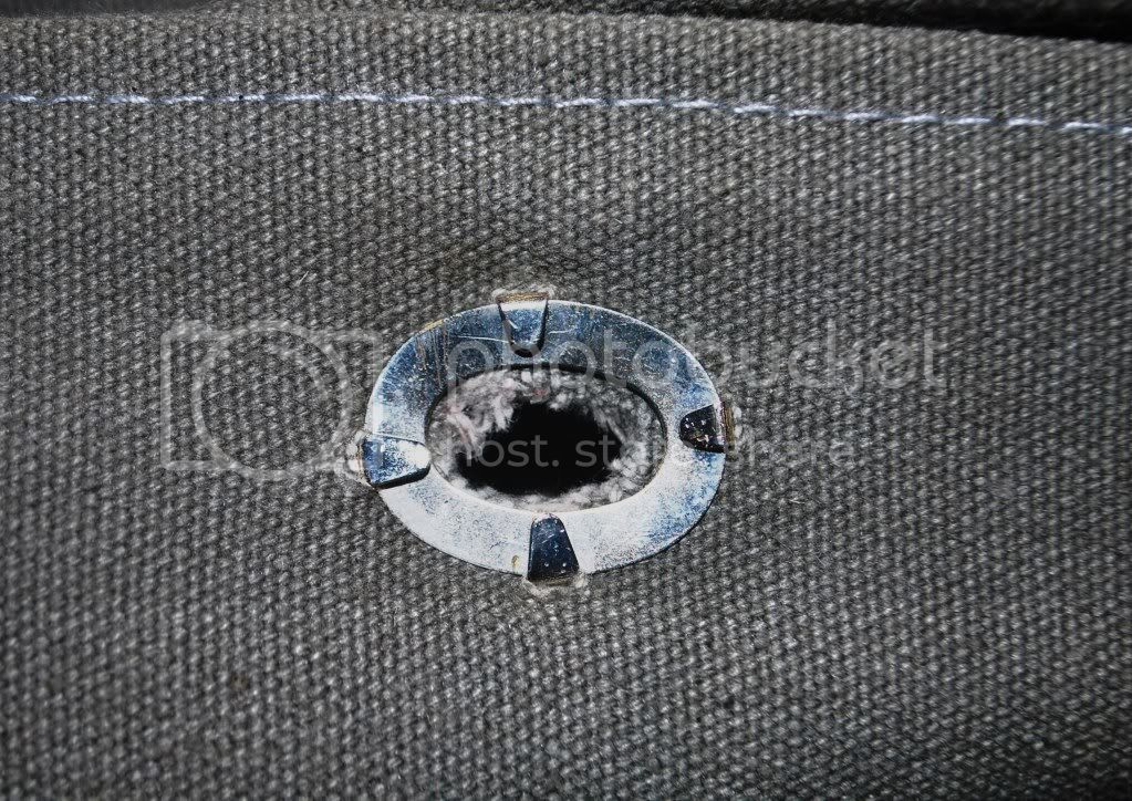

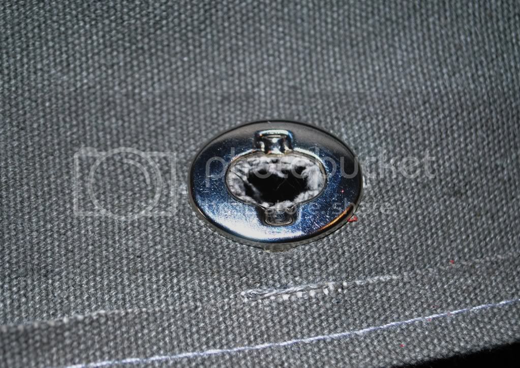

For cleanly installing these. A grommet tool was not used here.
Sent from my iPad using IH8MUD
Spike Strip said:
That was all done by hand, without any dies ? You just folded the tabs over and tapped 'em tight ?
Yes. Install the outer ring first by forcing the four tabs thru the fabric, then put the rear flat washer piece on and fold over the tabs. Then slice the fabric with an exacto knife.
