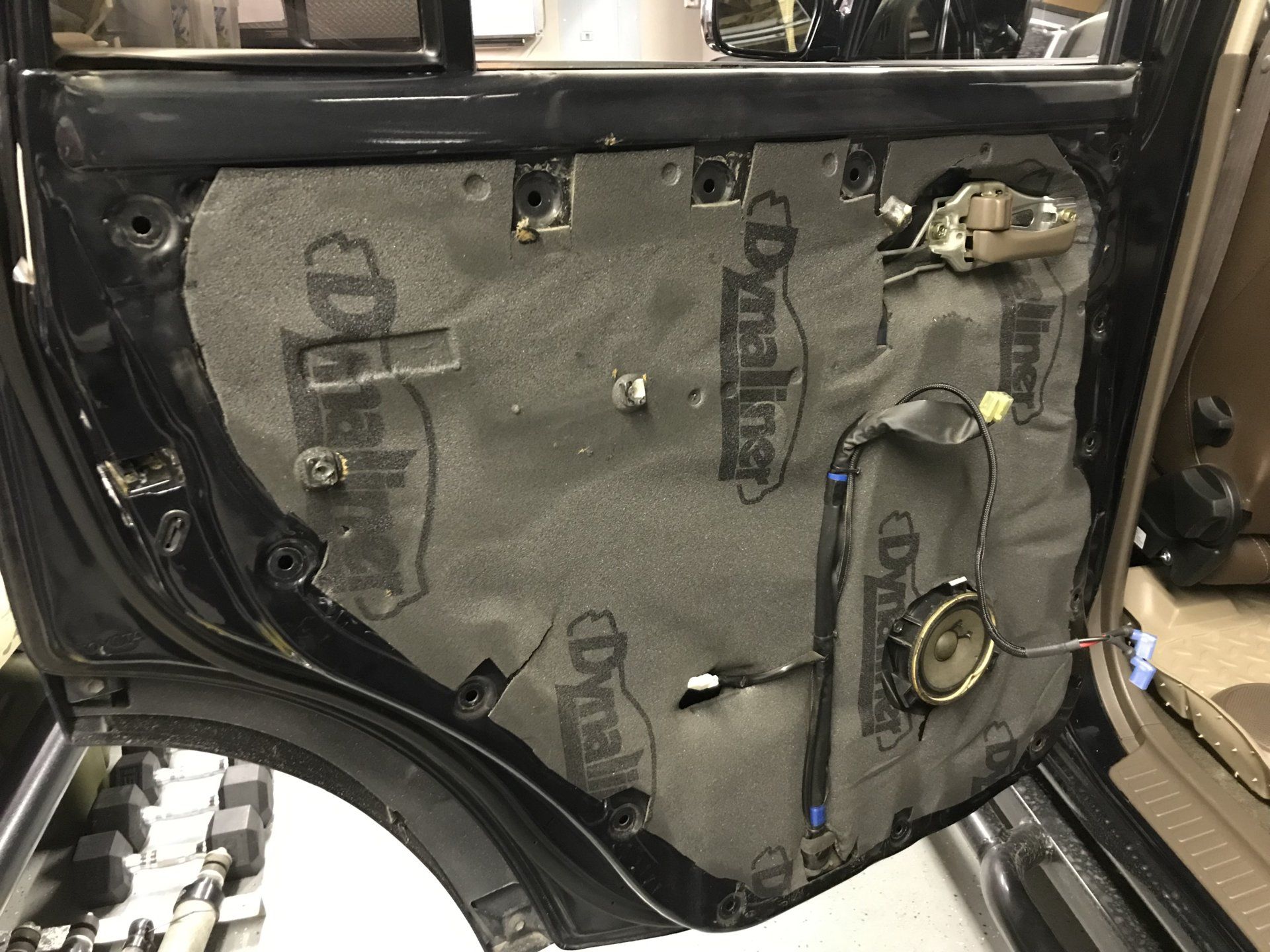

Ok. one of those situations where having a long standing relationship with your agent probably helps.

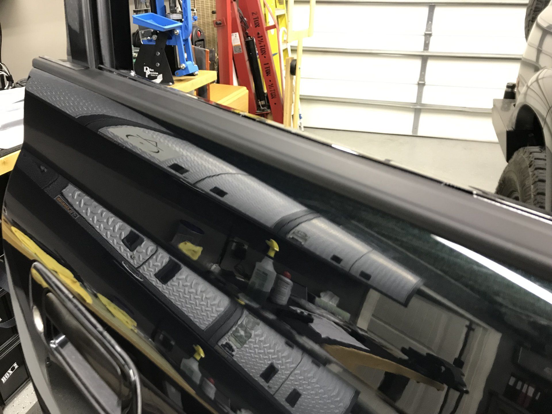

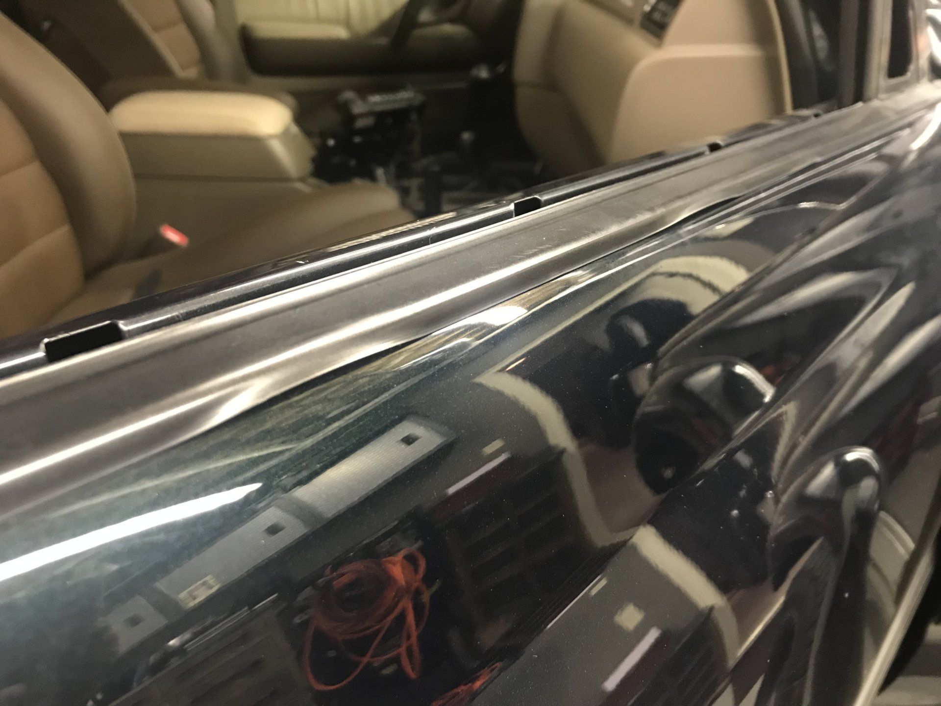

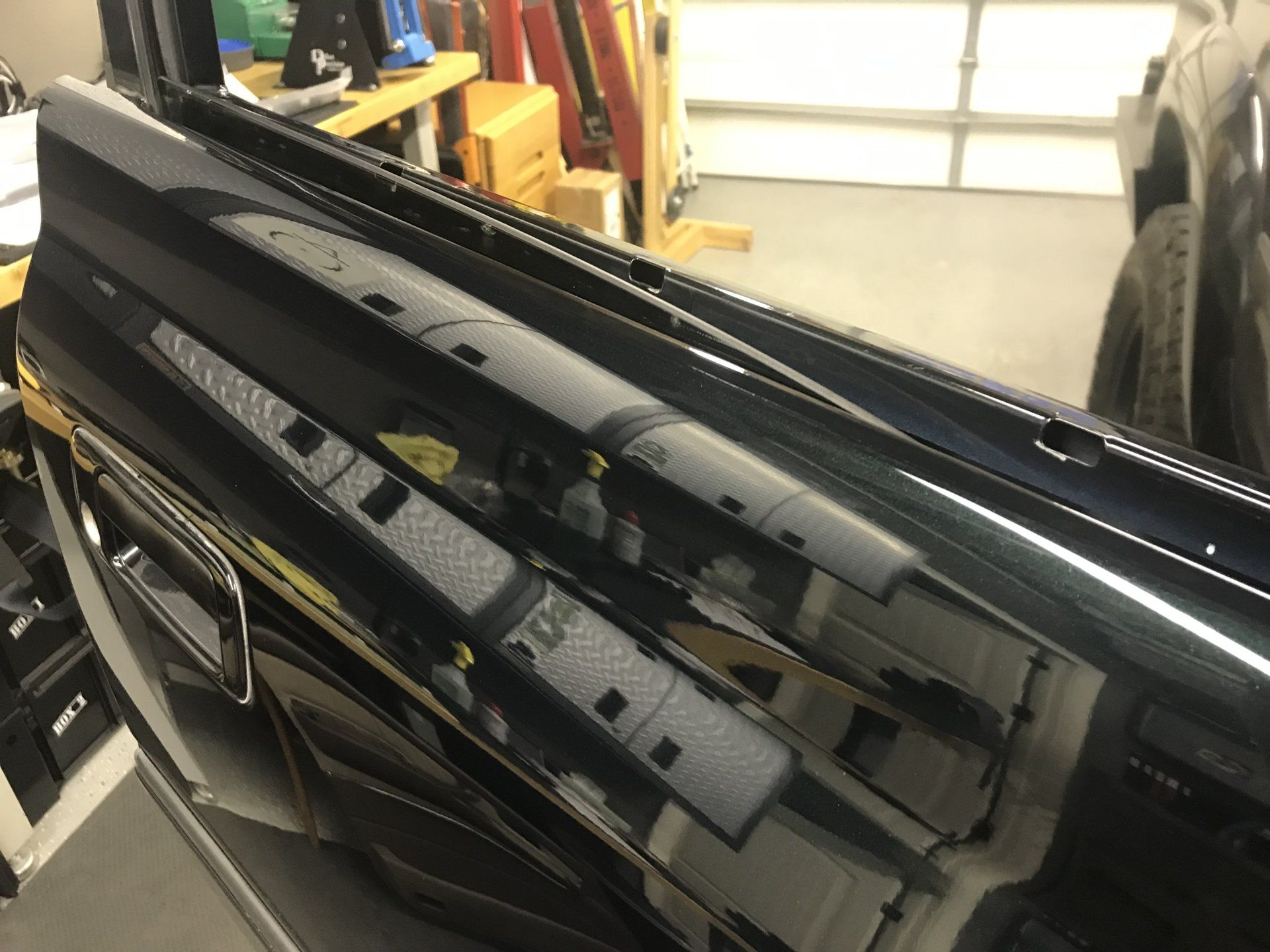

Used this weekend to replace all the Belt Moulding on the exterior windows. Had one start to curl, so I figured it was time to replace them all.

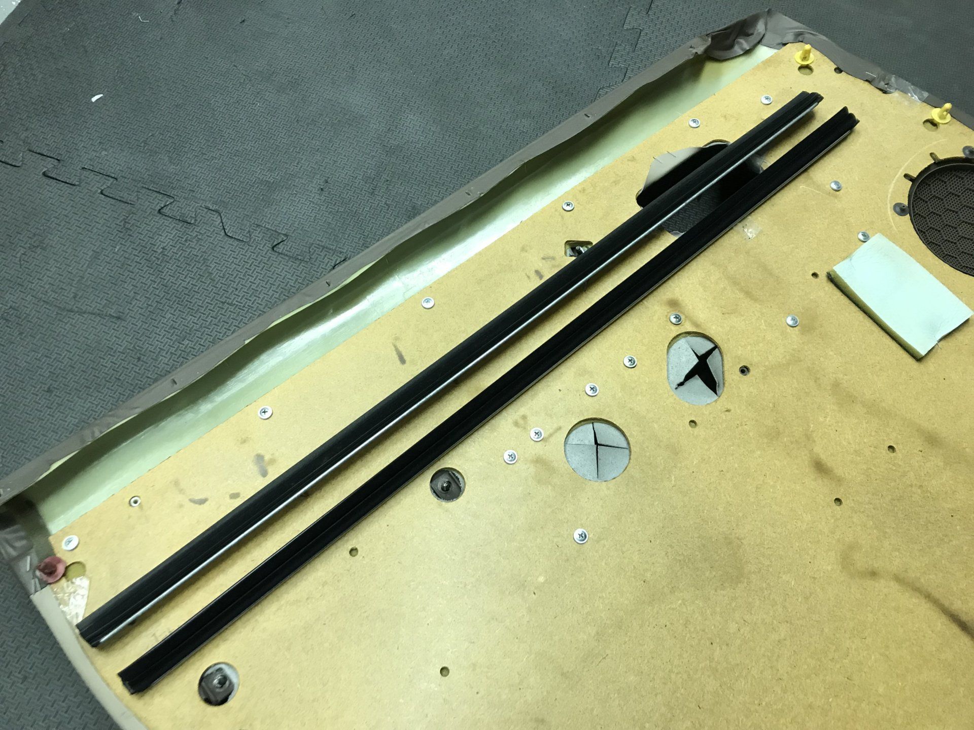

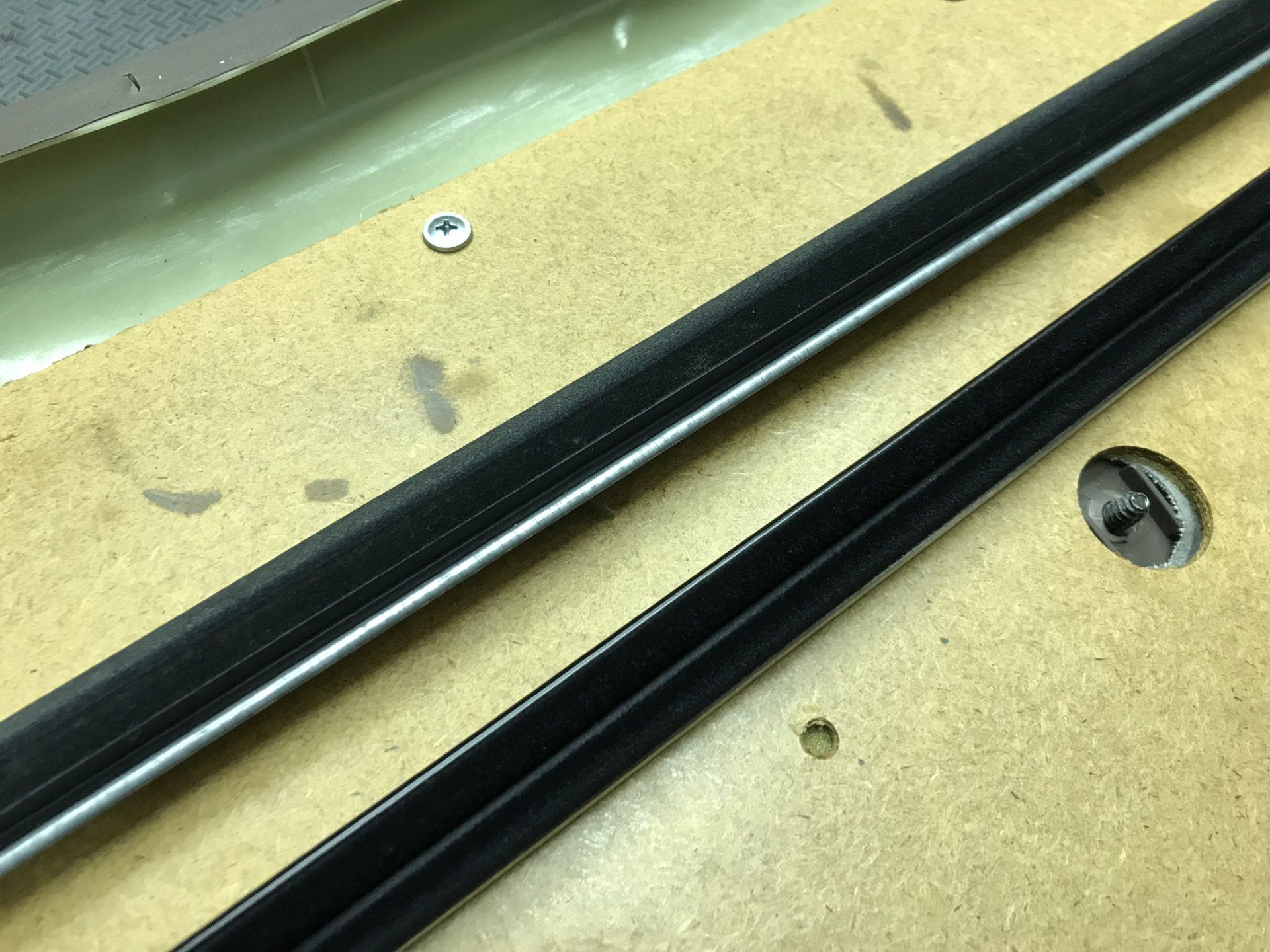

Also took the time to replace all the interior door wipers as well.
Cheers -

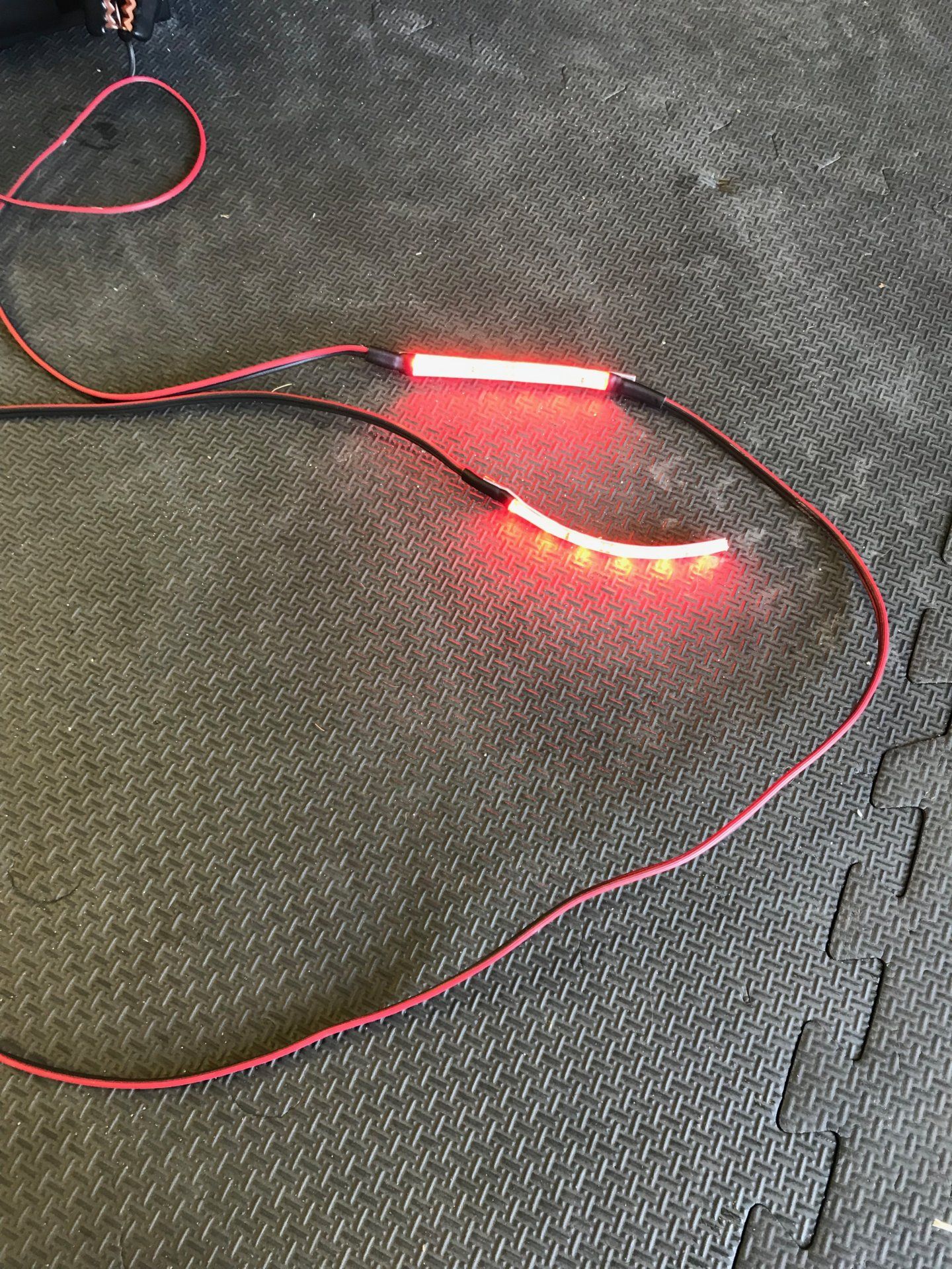

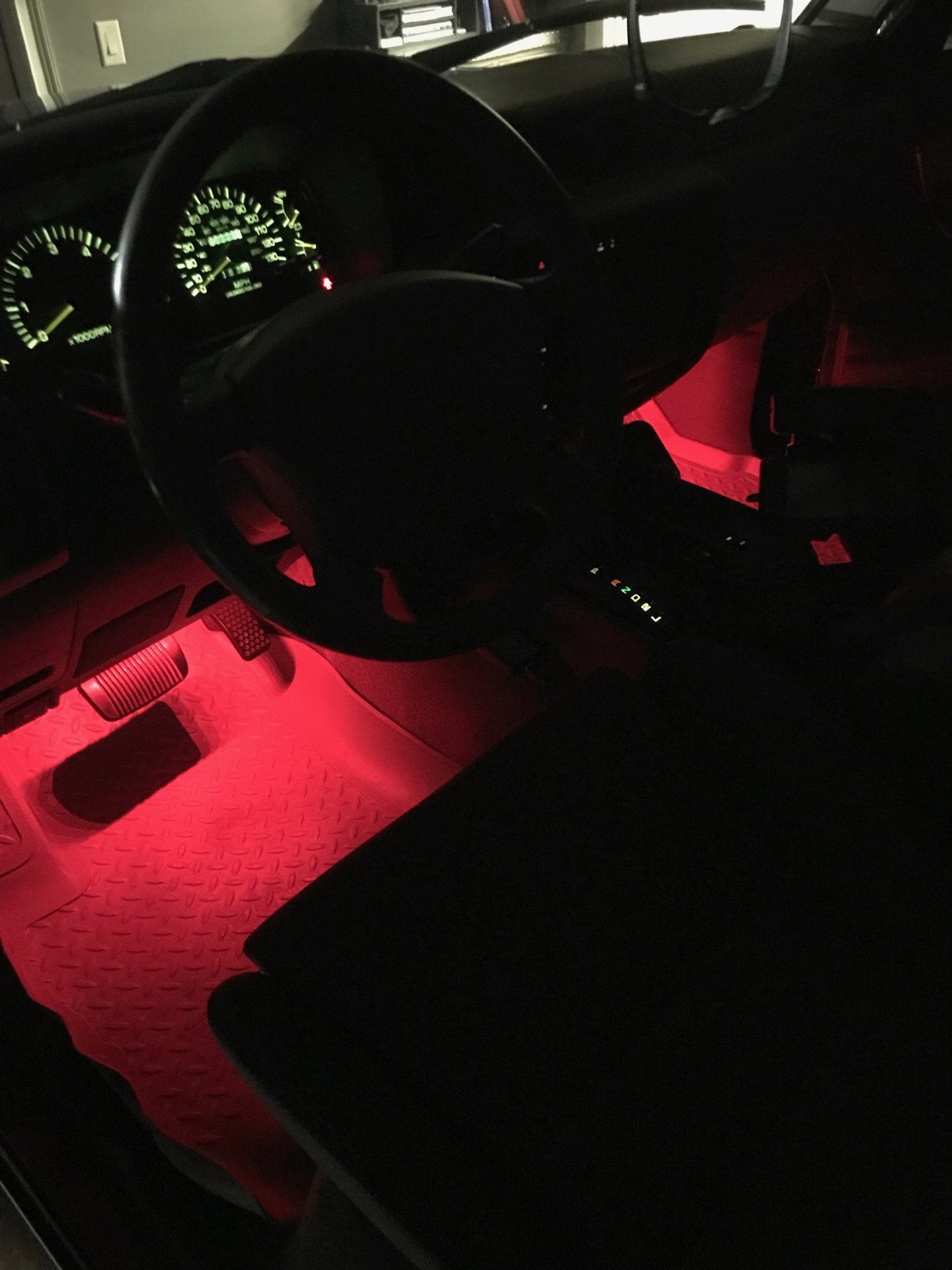

The wife's 200 has some great floor lighting and I wanted to add some to the 80 Series. I had some LED strip rolls in the garage in white blue and red.. Decided on Red to protect night vision.
I've seen some 12" strips and they are blinding, so I cut these at 6".... Might go to 4", but so far I like the additional light.
Cheers-
That's awesome. Are the lights on full time, or only when door is open?
@Bisonthecruiser I have them on the Parking Light Circuit, so only when the lights are on... Thanks ~
Awesome! Thanks man!
Do you mind sharing what you mounted the strips to under the dash? I've Got strips I installed in my taco and some waiting to be installed in my 80. I hate not being able to see what is on the floor at night.
@clx16 Driver os mounted to the plastic AC duct, passenger is mounted on base of the fan housing.
I used 3M VHB Tape as the stock sticky strip is junk on these LED's.
Rears are mounted on the Scheel-Mann Seat Bases.
Hope that helps.
Cheers -
Definitely helps and agree 100% on the stock sticky strip. thanks for the info on the 3M VHB.
I have step sliders and will be installing some under them for when the doors open the ground will light up for the person getting out. I've been trying to figure out what will stick and I bet that 3M stuff will do just fine there also.
