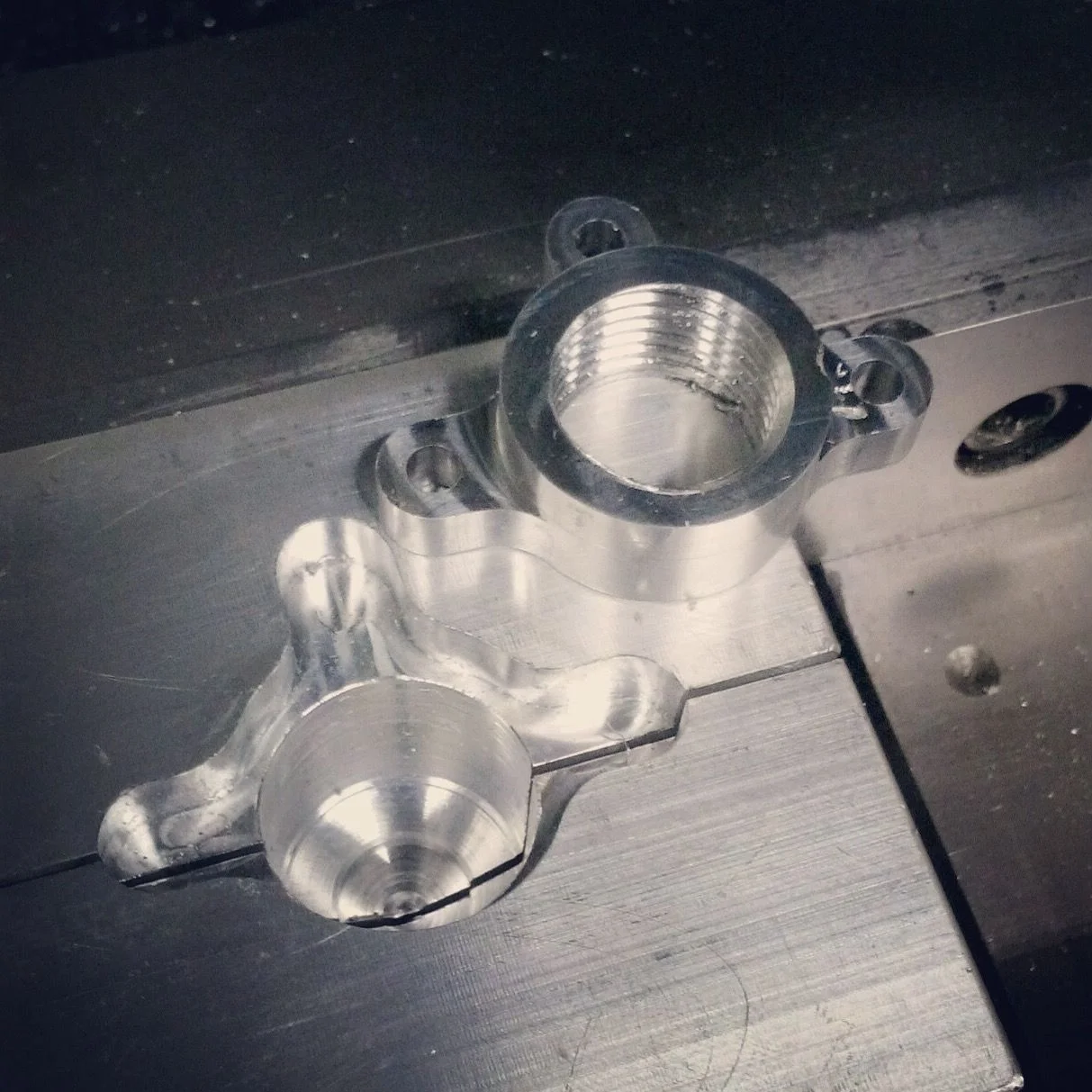

Started the oil drain fittings and made a jig for the production run of the 1FZTurbo parts. This will ensure perfectly perpendicular tapped holes for the turbo’s oil drain fitting.

Although instructions will be made for #80series #LandCruiser #1fzturbo I figured I’d go into a little more detail about the oil drain fitting. The oil drain is gravity fed back into oil pan but MUST be above the oil line...or else it’s dumb.
Since the 1FZ motor has two oil pans, we are going to be tapping into the upper aluminum pan. Once the center hole is marked and drilled then we need to make sure that the oil drain fitting is absolutely straight on with the hole AND the mount doesn’t shift when trying to mark the mounting hole locations for drilling and tapping. I will be supplying everything needed INCLUDING the Teflon dowel used to indicate the fitting...because I <3 U!
View attachment 1632021 View attachment 1632022 View attachment 1632023 View attachment 1632024
Because it is a gravity drain there is no pump, trying to return the oil up hill to the valve cover would result in a big backup of oil in the turbo and lots of smoke.
