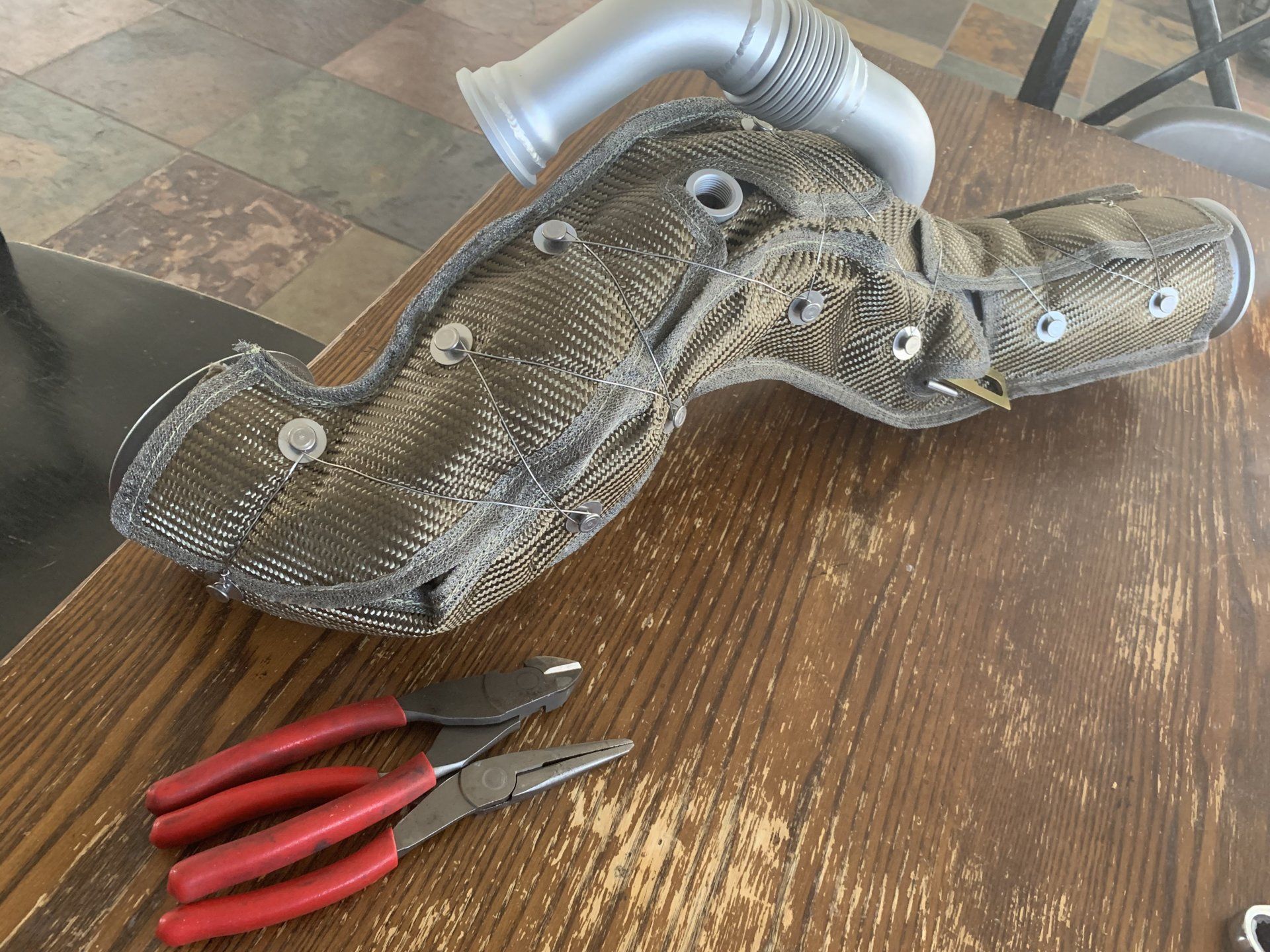

Been making good progress on my install. Did a ton of maintenance while the front end was apart. All new cooling system, all the typical oil seals replaced, new vacuum everything, new trans cooler lines, full tune up etc.
Now have the new manifolds on, J-pipe on, Oil peace pipe in place, oil drain in upper pan, vacuum tee and brake booster check valve installed, AC line relocated & heat wrapped and the downpipe wrapped in a fancy blanket.
Next step is to get the Turbo Oil fittings installed and then drop the turbo and downpipe into place.

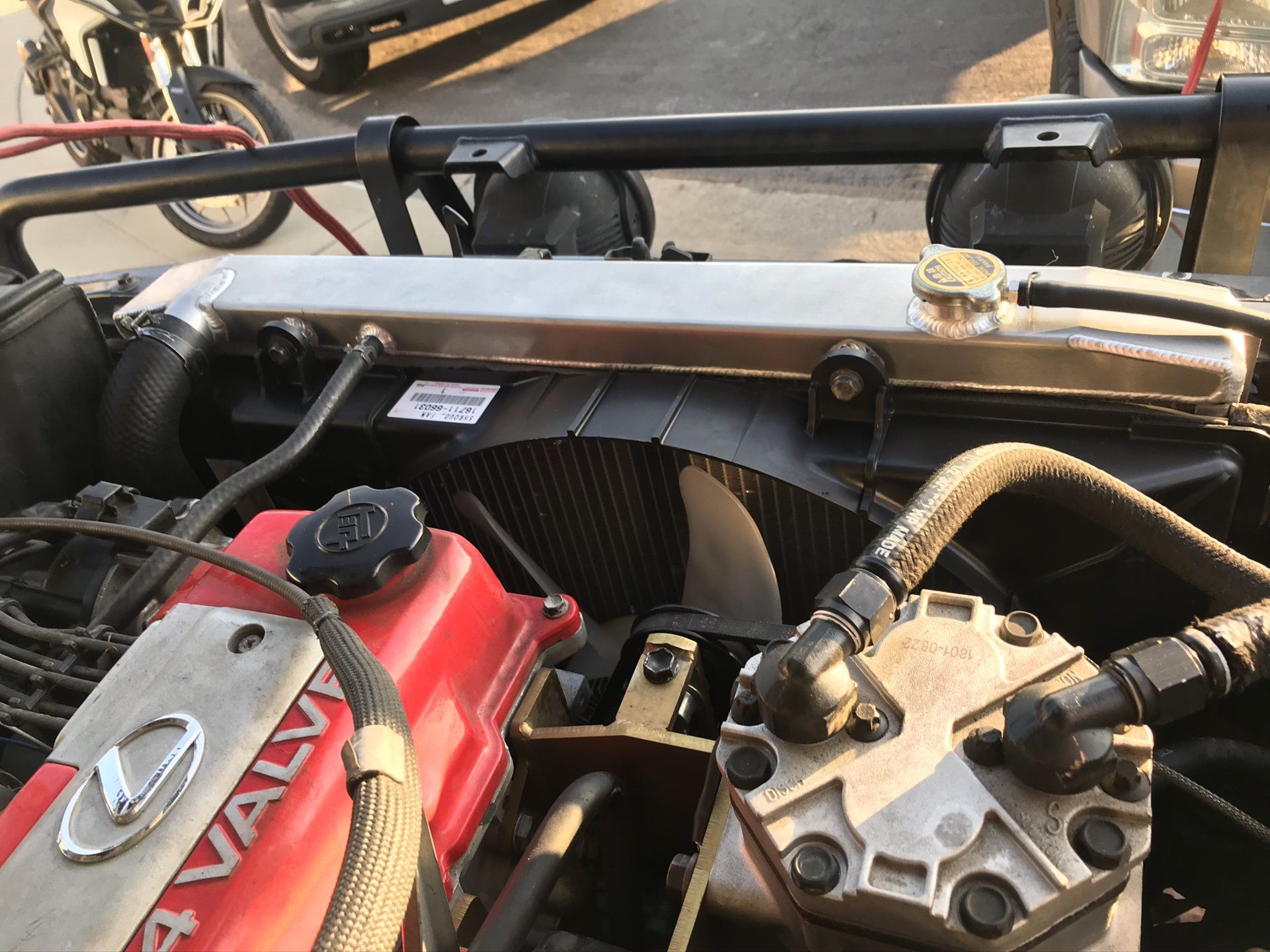

Would you mind sharing some info on the aluminum radiator you have?
Thanks,
Mike
Thanks,
Mike
Ron Davis Radiator...dessert racing pedigree. Not inexpensive, but pretty awesome.
