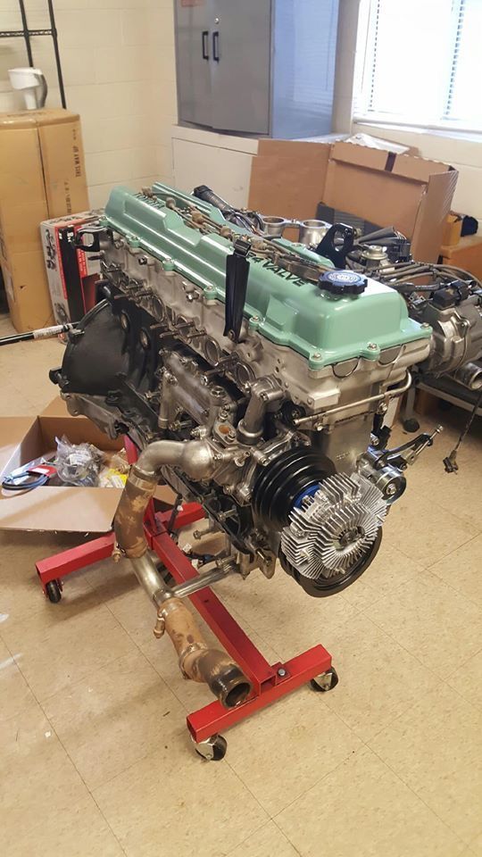

I need to get this in first then the turbo before posting videos.
