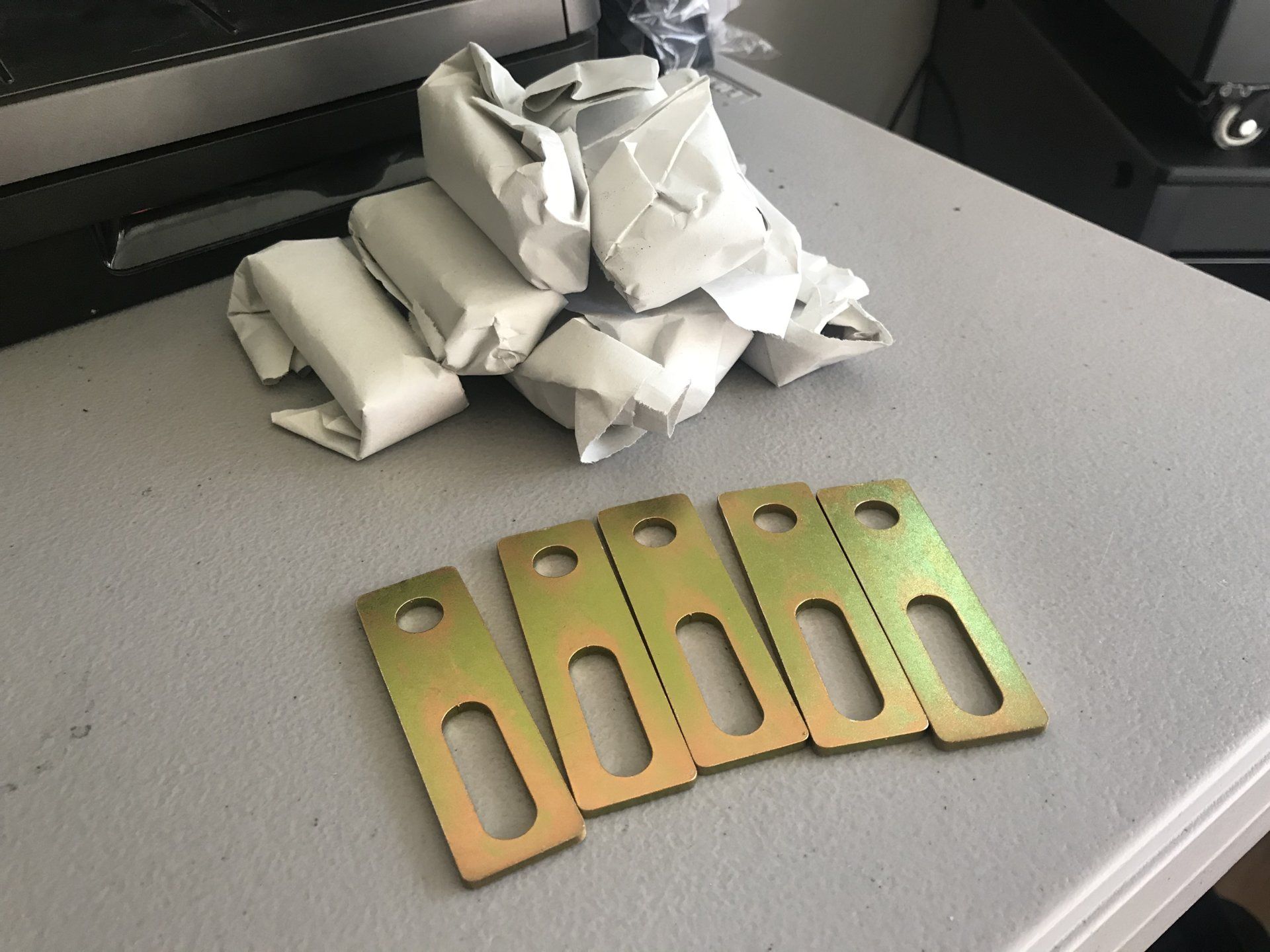

Nothing super exciting but I just got in the little exhaust plates in that connect the downpipe to the bellhousing. It’s progress.

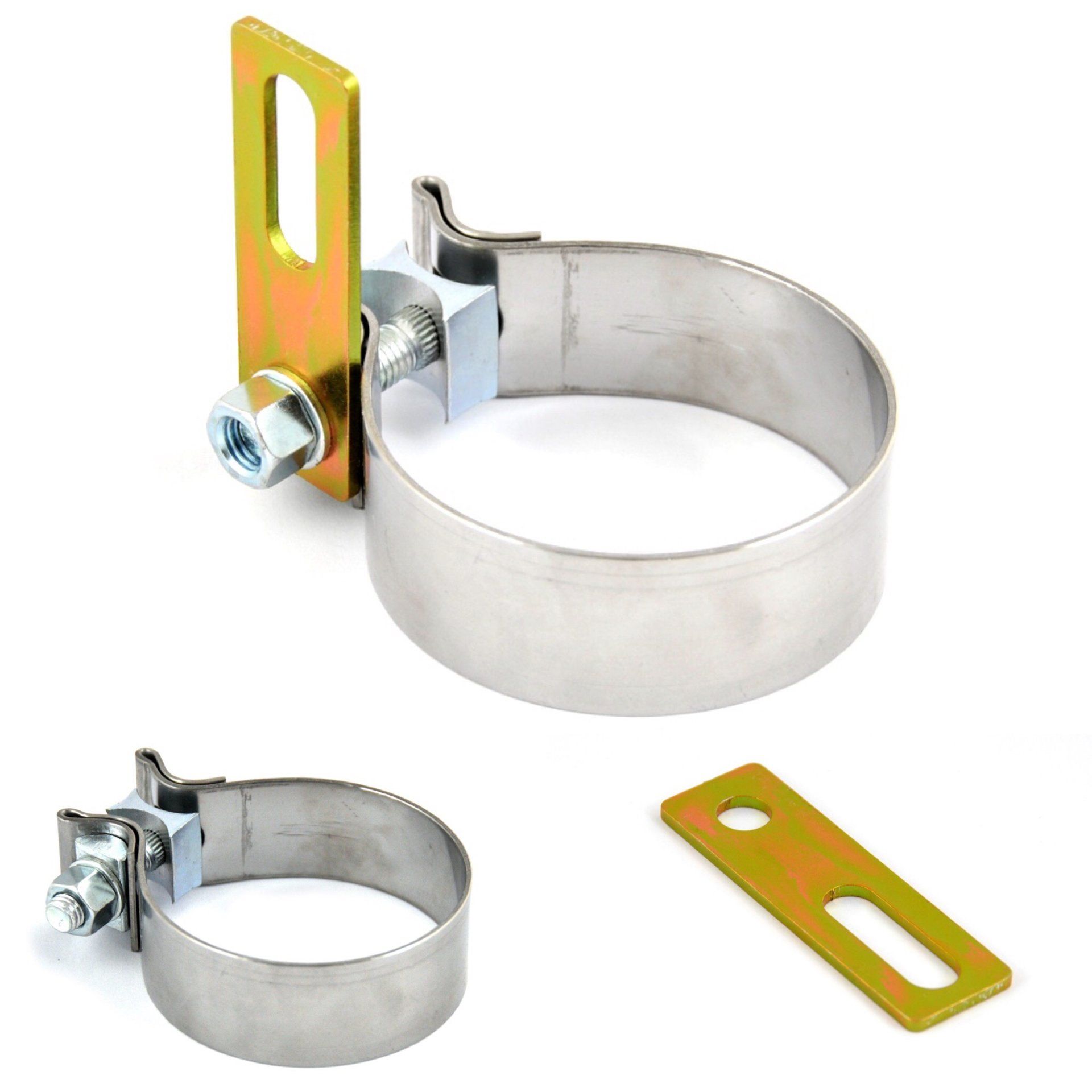

Ok granted, it’s not very exciting. But with the 1FZ downpipe needed to be secured to the bellhousing. This clamp was perfect because the only thing needed was a new slotted bracket. There is new hardware supplied and the act of tightening it down will form the slight angle needed to secure the
Downpipe.
All of the clamps arrived today. Hardware tomorrow. Again, small step but a step nonetheless.
I’m guessing nylocks are less effective with the temperatures this will see. I expect it will push the 300° limit on regular locktite, but will the EGT’s be enough to heat it past the 450° of red locktite?
