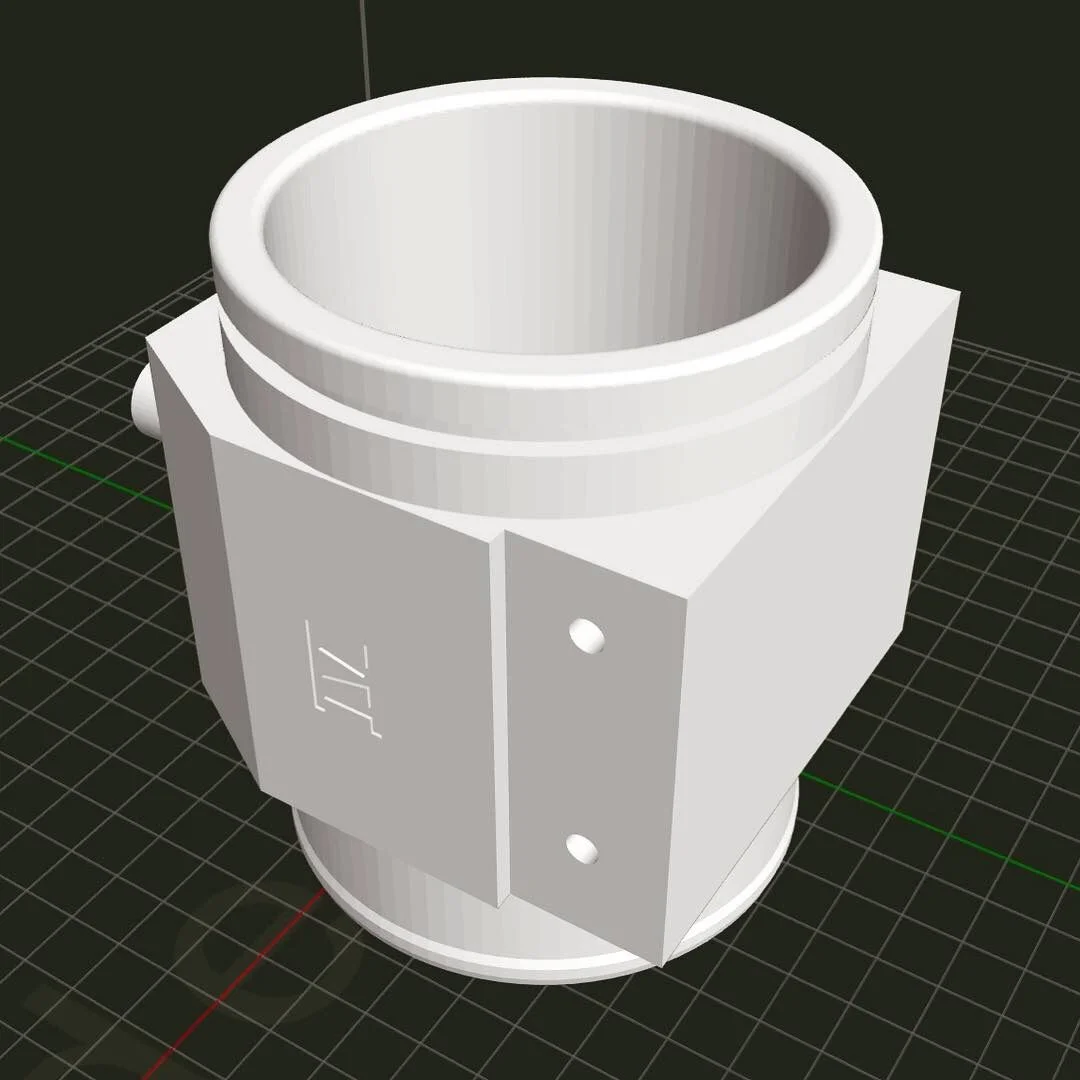

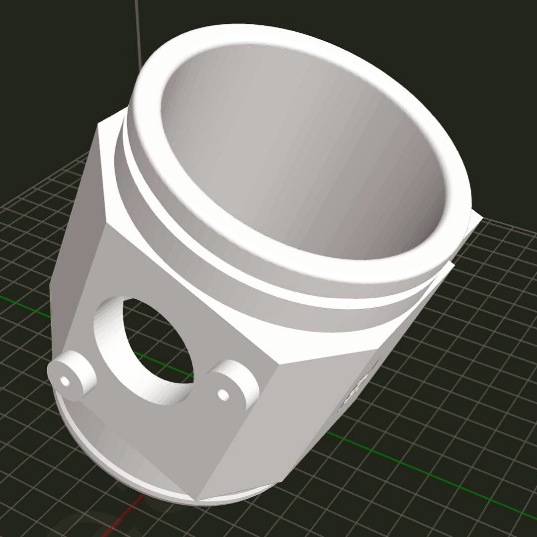

Just got the word from LT that the GenIV MAFs are done with machining and anodizing. There is a new straightener and sensor coming in as well so the new CNC machined MAFs will be ready to ship out fairly soon. Don’t have a price yet so keep an eye out and I’ll update.
This replaces the stock MAF housing that may have a crack in it and is NLA from Toyota.
For you folks jonesing for the turbo, this is an upgrade to consider since there is more heat in the area of the MAF now. The plastic original one, which is now at least 21 years old, could see higher temps and thus potentially cracking.
View attachment 1937026View attachment 1937027
MAF is not NLA. Close, but not just yet. :)
