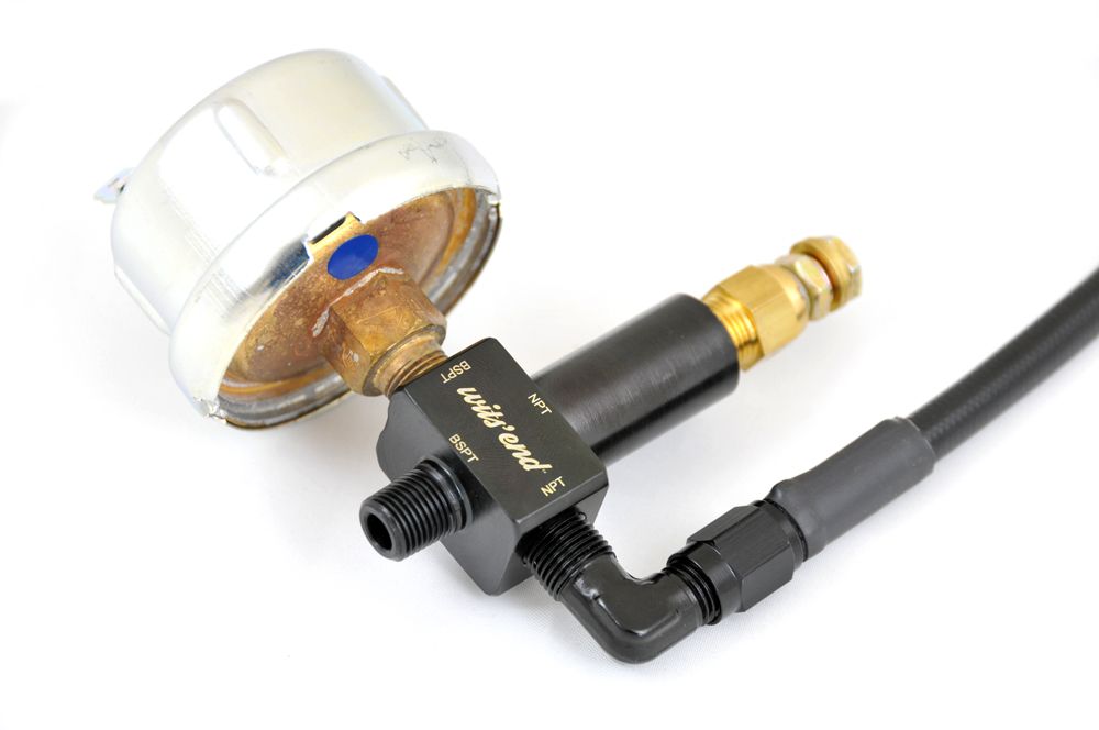

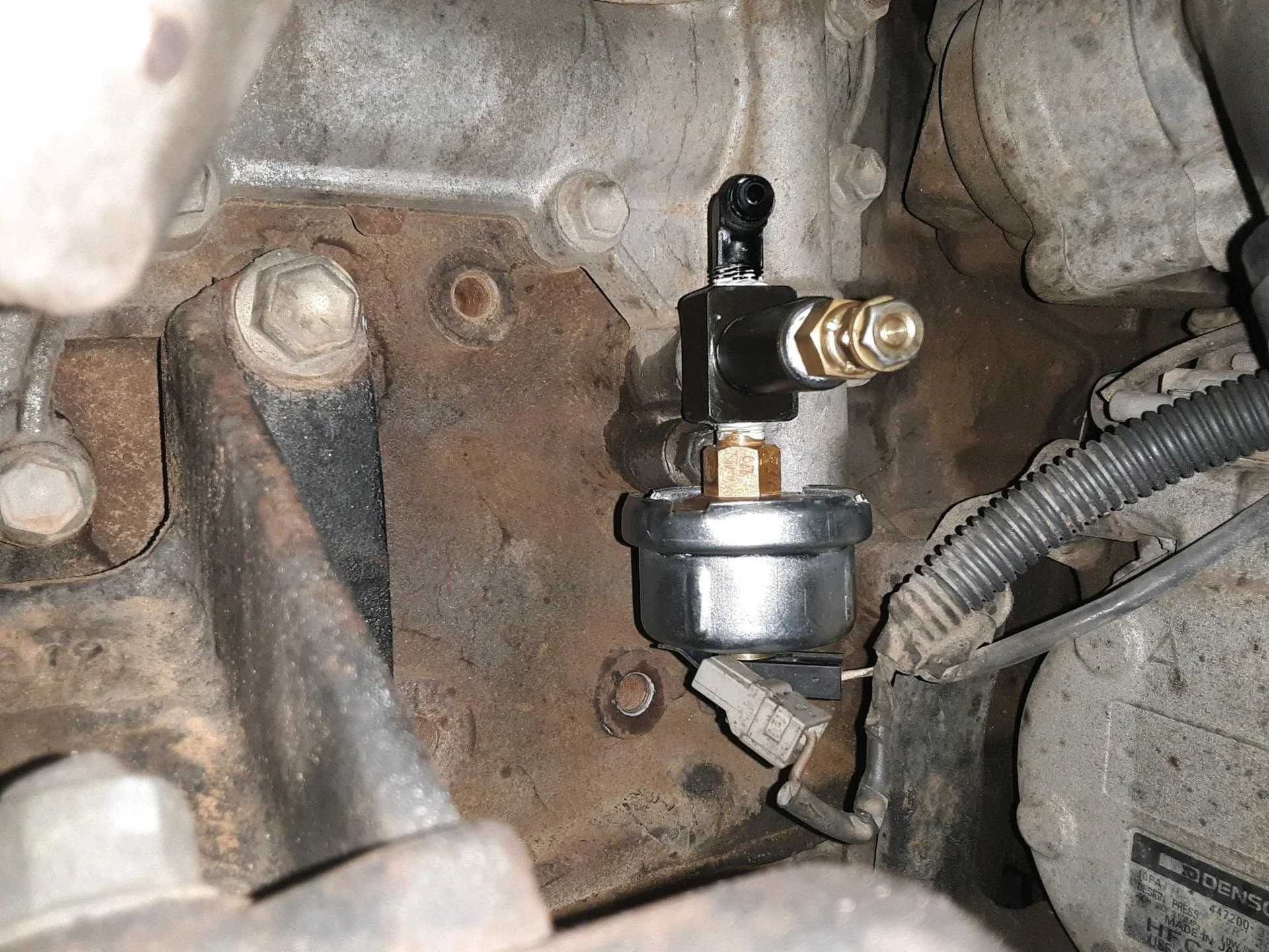

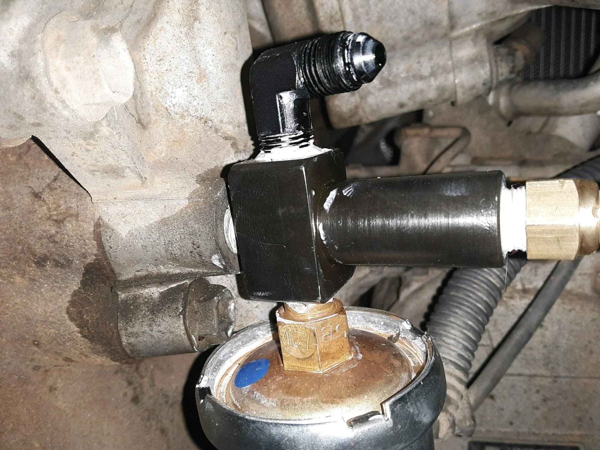

The PeacePipe final resting place. This is the adapter manifold that replaces the 1FZ Oil Sender and makes a new home for the new OEM pressure sender(which I include), an aftermarket oil temp sender (which I include), and the oil pressure turbo feed line. There it is in all its glory. The oil feed hose would be on it but I decided to shorten it 2” because I wanted a cleaner looking sweep. I can’t leave good enough alone
View attachment 1892760View attachment 1892761View attachment 1892762
Is the Peace for sale on Wits End as it's own part?
I am interested in it as I want to add a mechanical oil pressure gauge to my truck.
I cannot find it on the site.

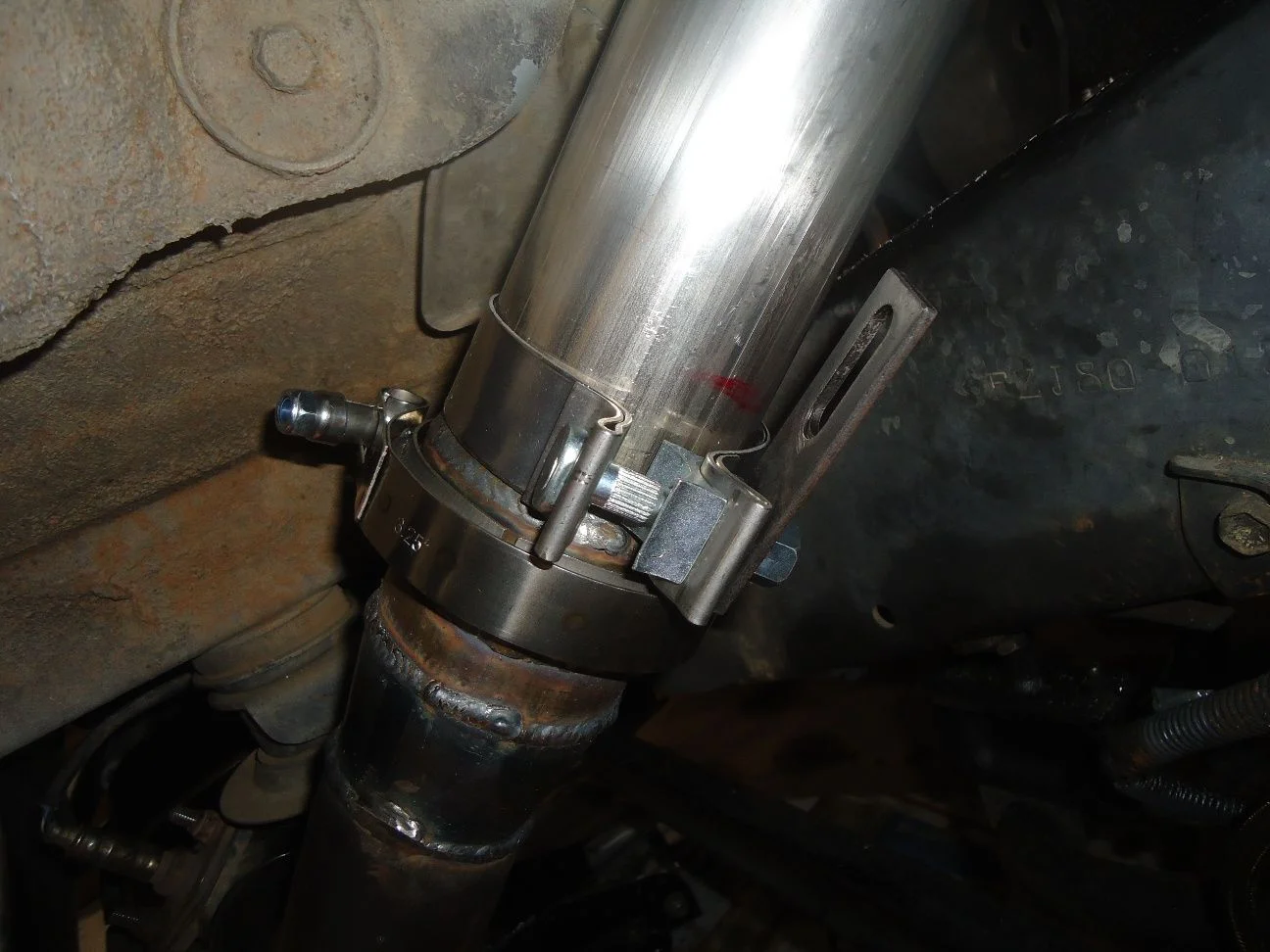

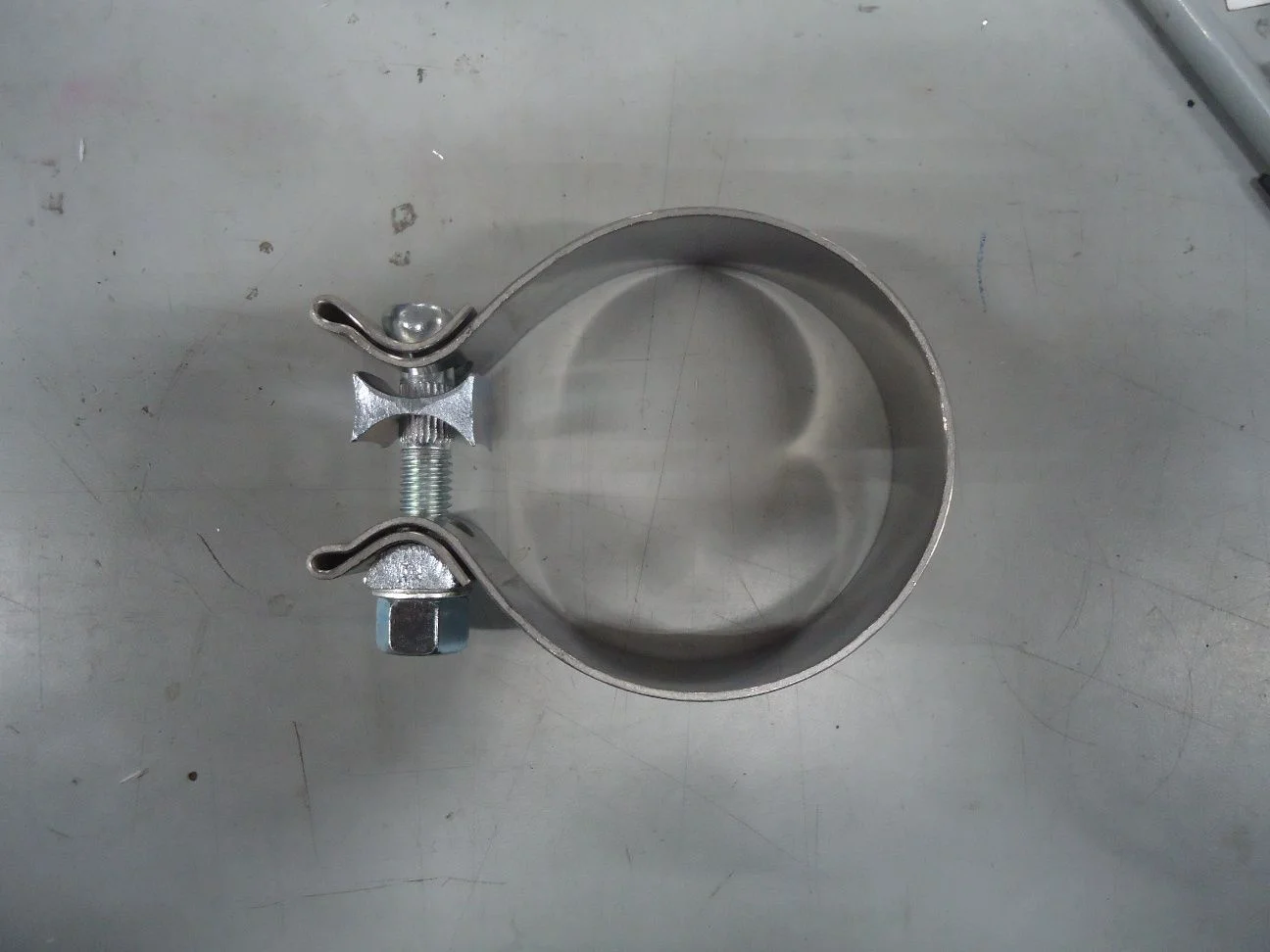

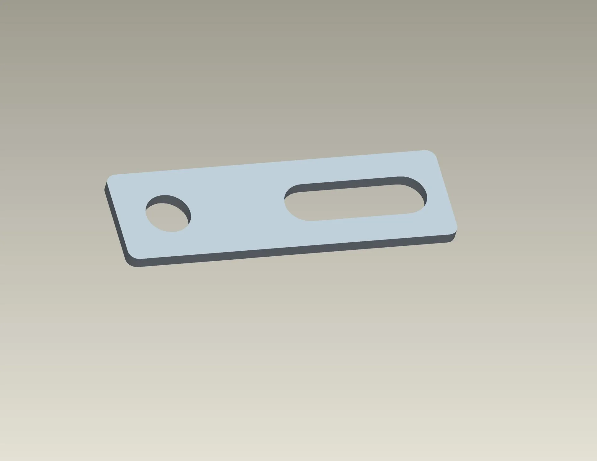

The fully welded downpipe is back and tested for leaks all good for testing. Making a new bracket that attaches to the downpipe and secures it to the bellhousing. Using an off the shelf stainless clamp and a flat bracket.
