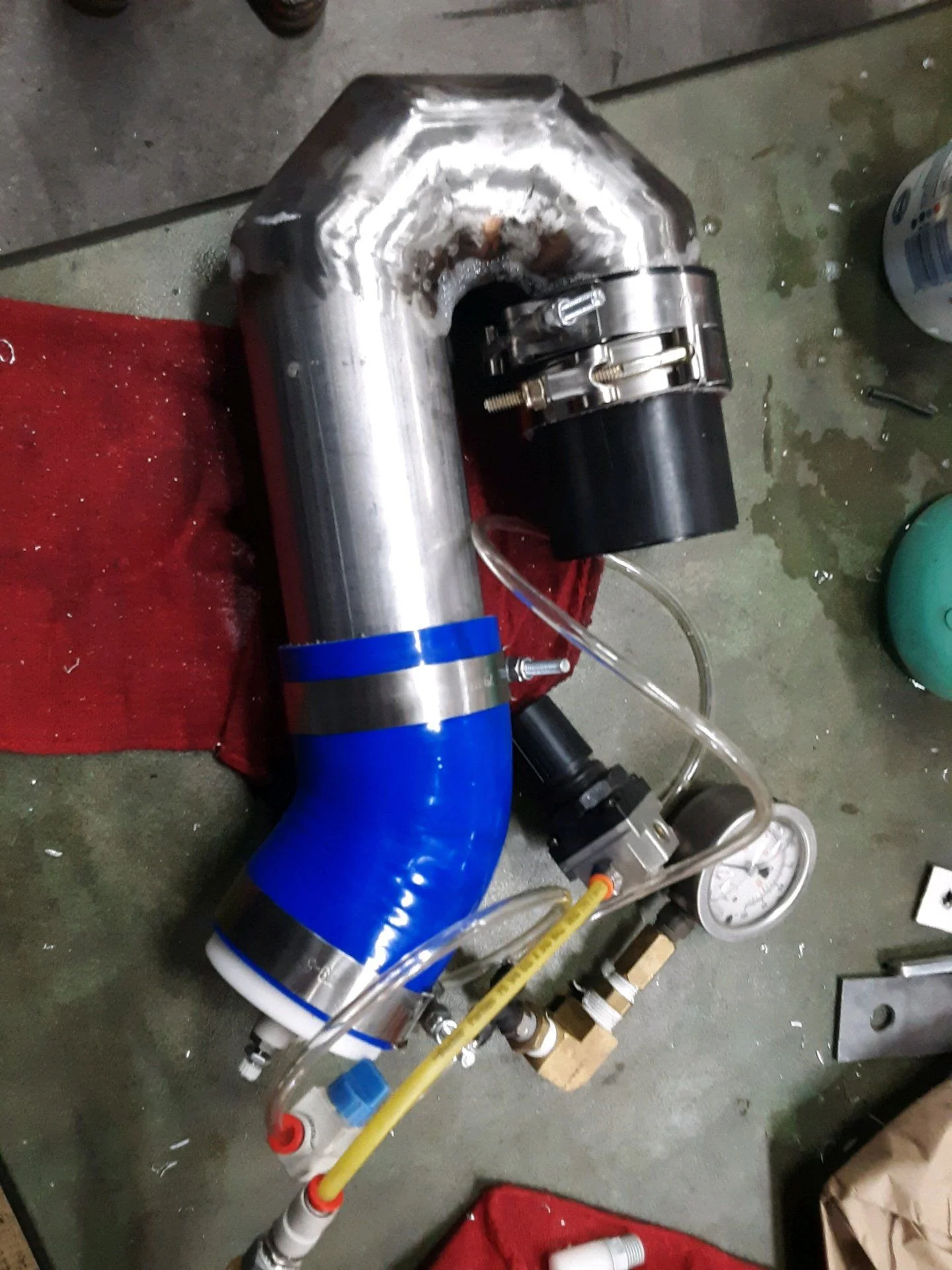

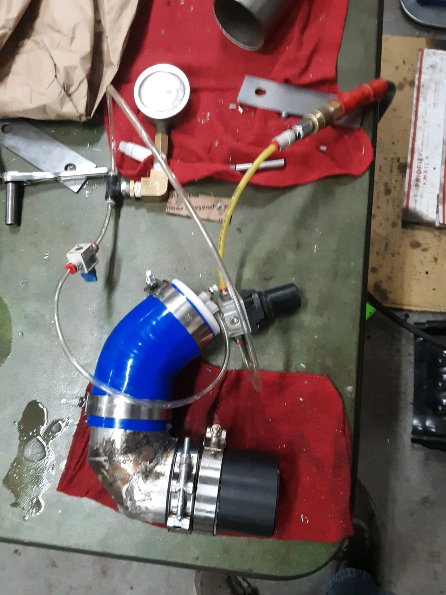

Ok don’t judge. This is JUST to get the truck driveable until the pipe shop can make the official pieces. Since I will taking the train out to Flagstaff next week with the intention of driving the turbo’d truck back here, needed to make sure the temp pieces were welded properly. How do you make sure the downpipe and both intake pipes don’t leak? Pressure them all and spray soapy water to see if there are any leaks. All good.
These should also be good enough for final CARB testing as well. But once I get back home, and everything works well, all of these pieces will go to have the jigs made and official components made.

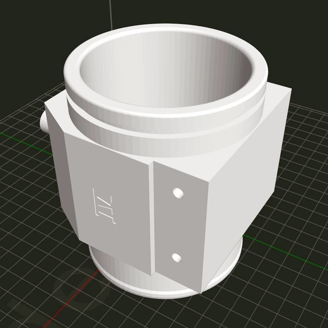

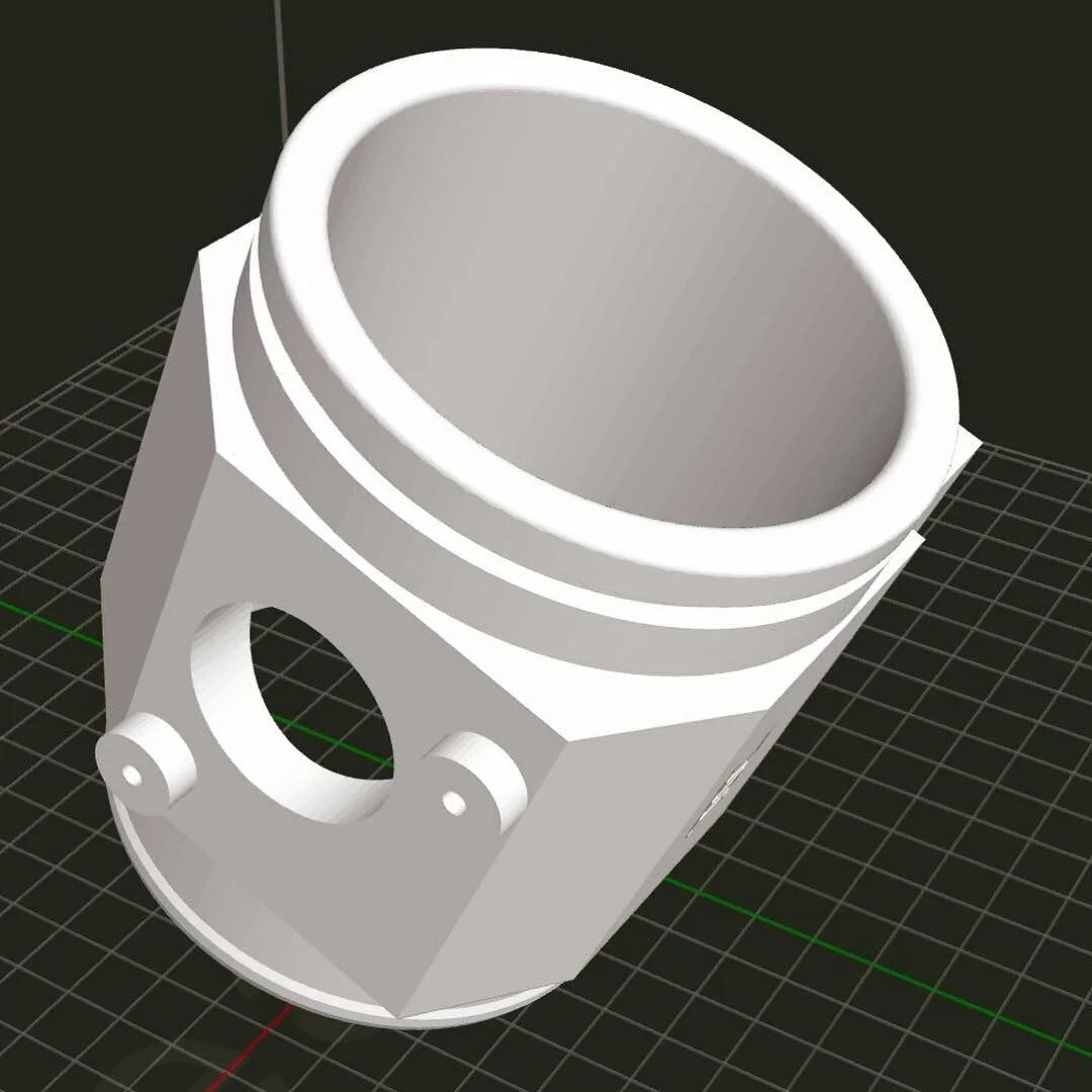

Just got the word from LT that the GenIV MAFs are done with machining and anodizing. There is a new straightener and sensor coming in as well so the new CNC machined MAFs will be ready to ship out fairly soon. Don’t have a price yet so keep an eye out and I’ll update.
This replaces the stock MAF housing that may have a crack in it and is NLA from Toyota.
For you folks jonesing for the turbo, this is an upgrade to consider since there is more heat in the area of the MAF now. The plastic original one, which is now at least 21 years old, could see higher temps and thus potentially cracking.
