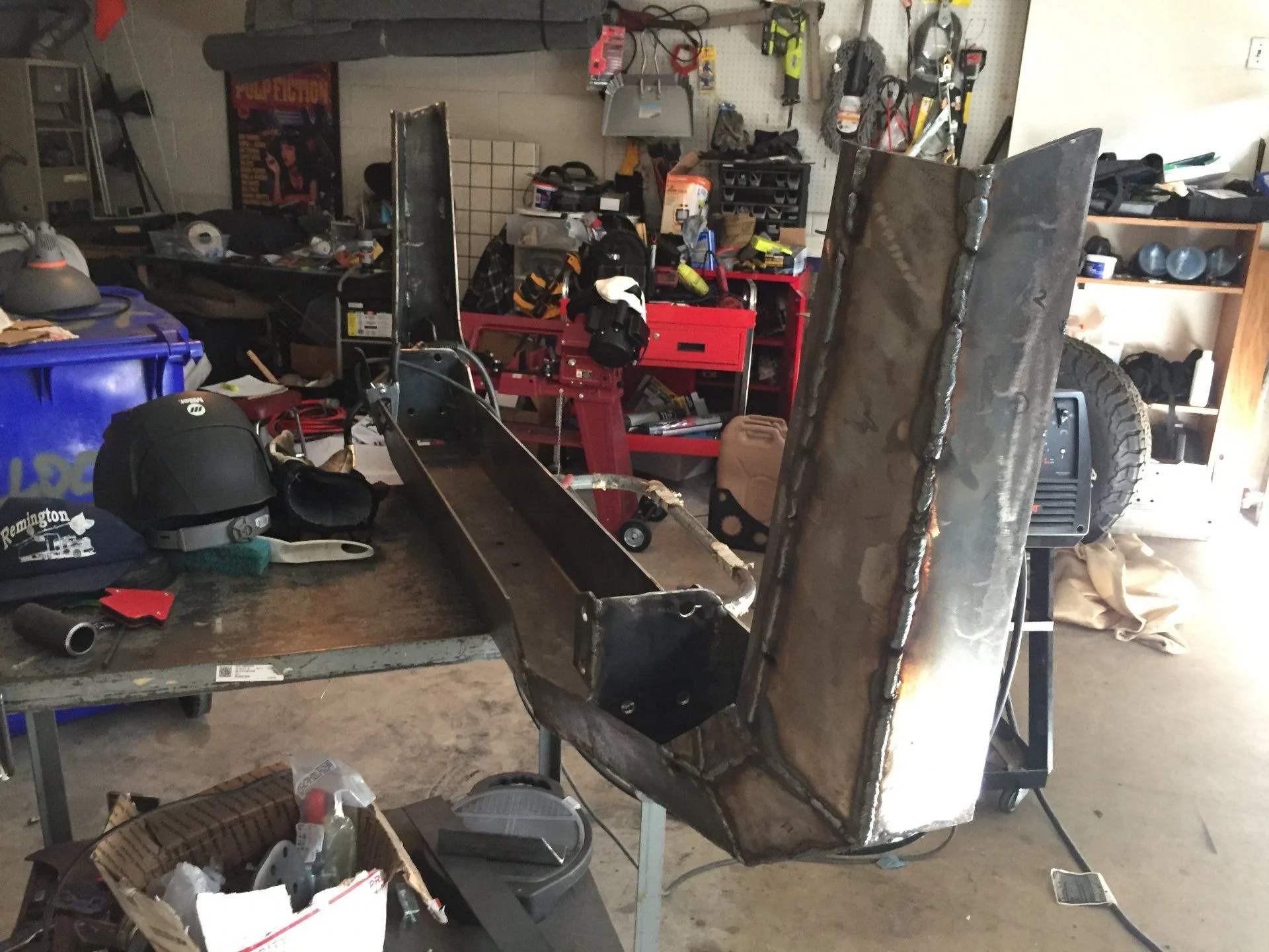

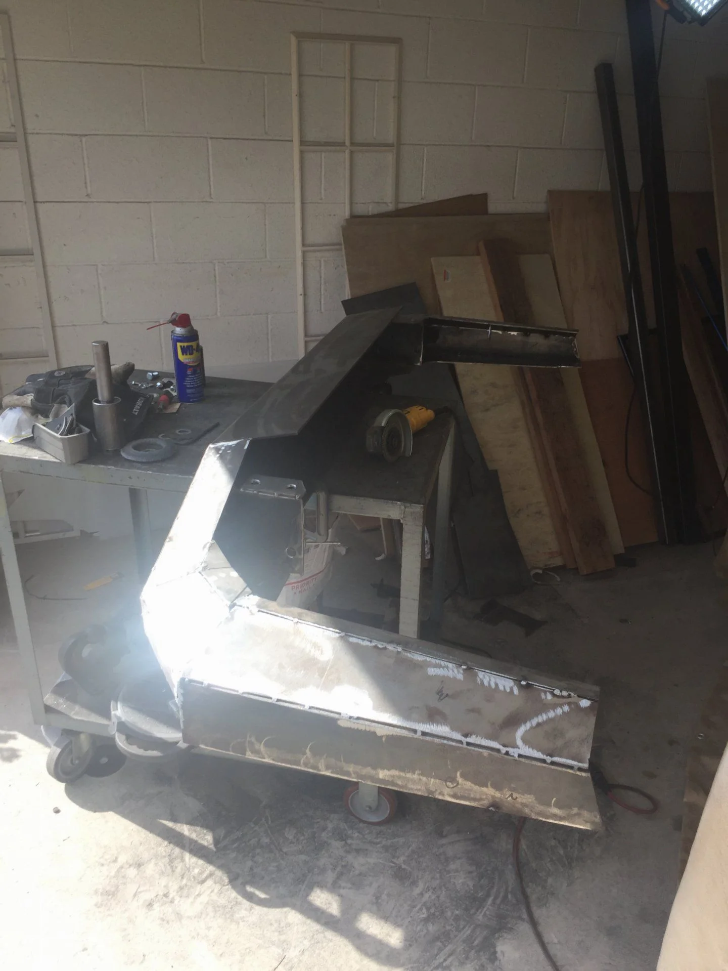

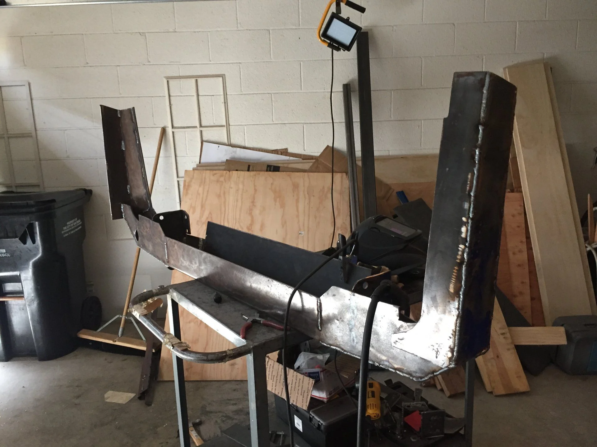

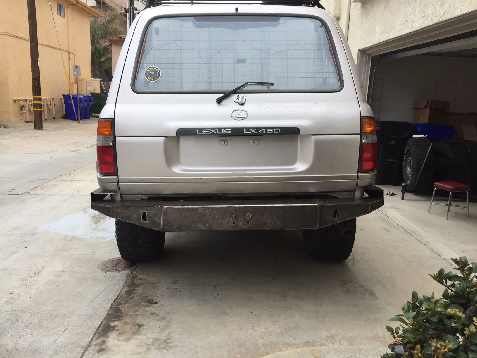

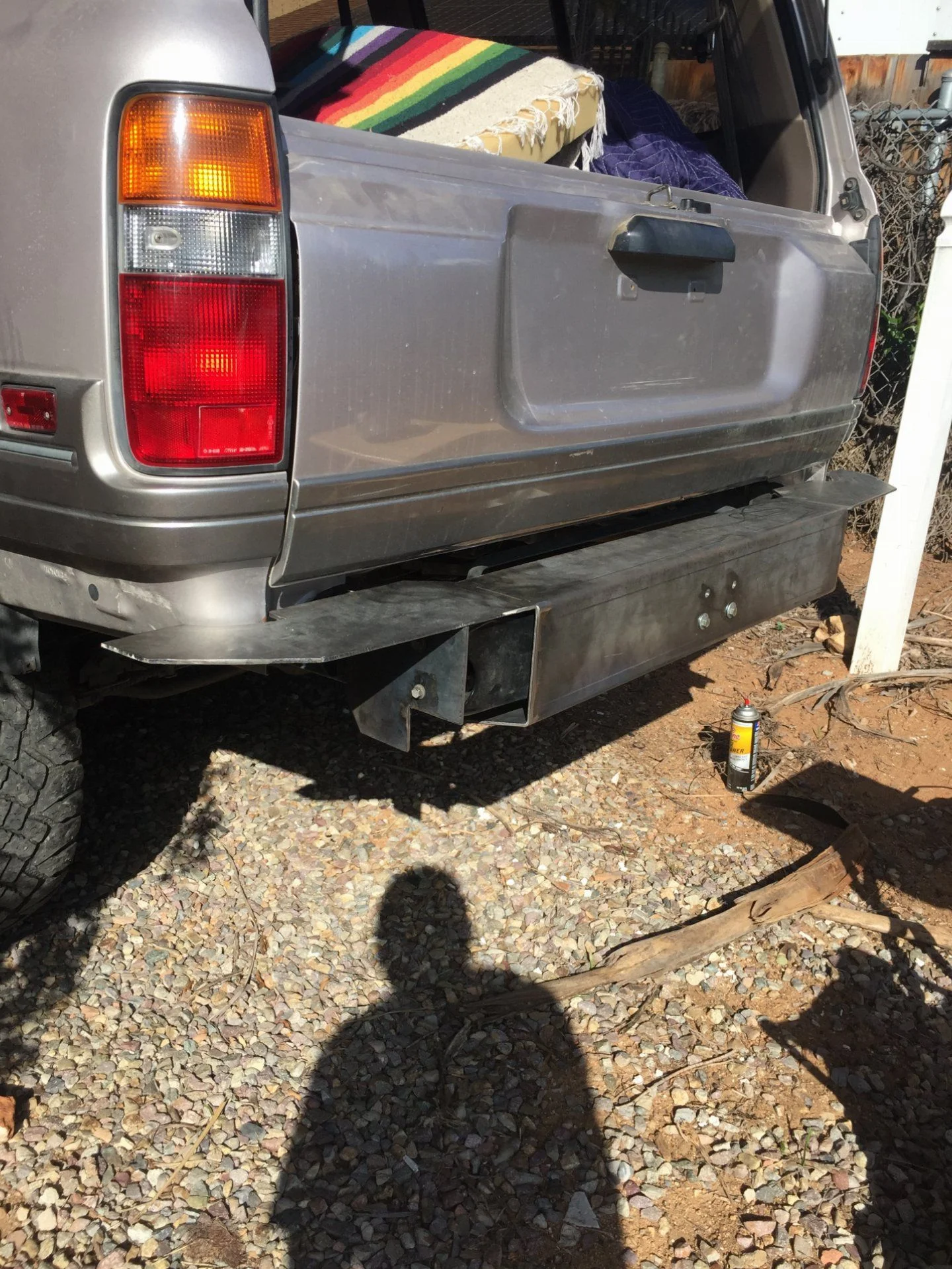

Thread to post photos of my LX450 Rear Bumper build. The design is evolving as the project progresses.
I like where you're going with this.......
Will there be more bolts than the 4 on the face?

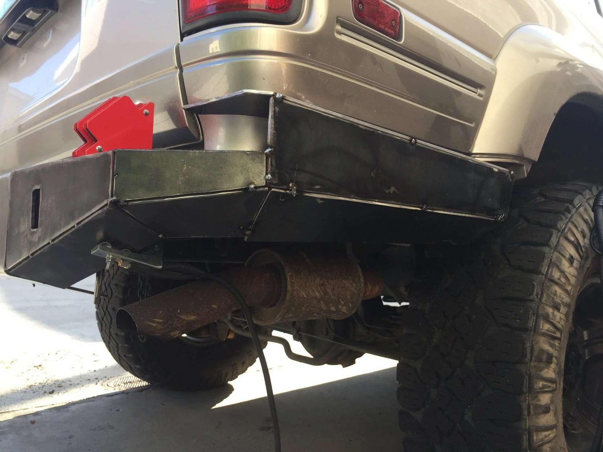

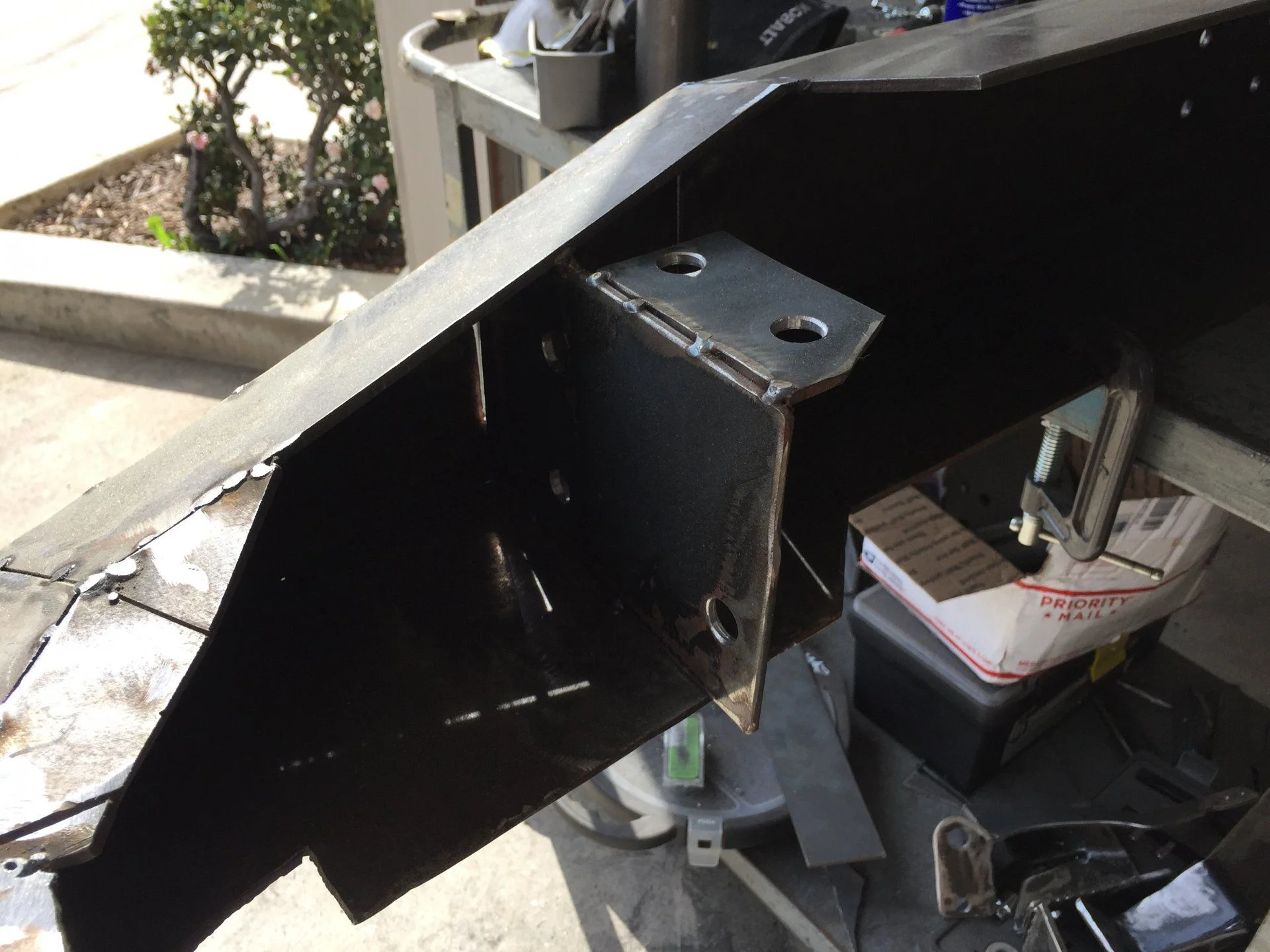

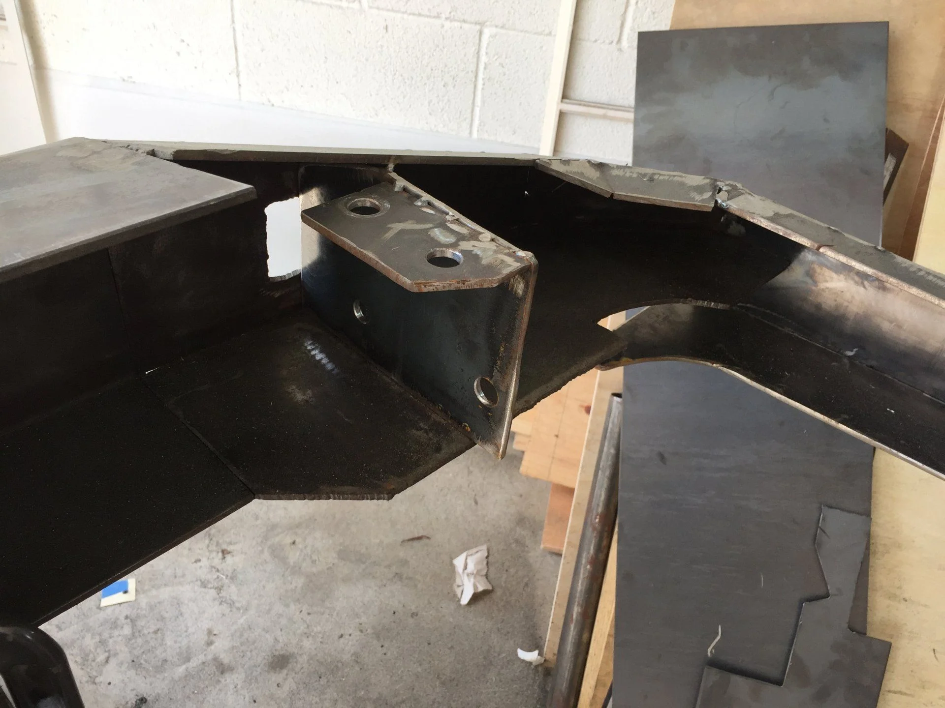

Hi, thanks bolt4me! In addition to the 4 bolts on the face, there will be a bracket and 4 bolts on each side to the frame where the recovery points attach, and also wing brackets between the sides and frame that bolt on for extra support.

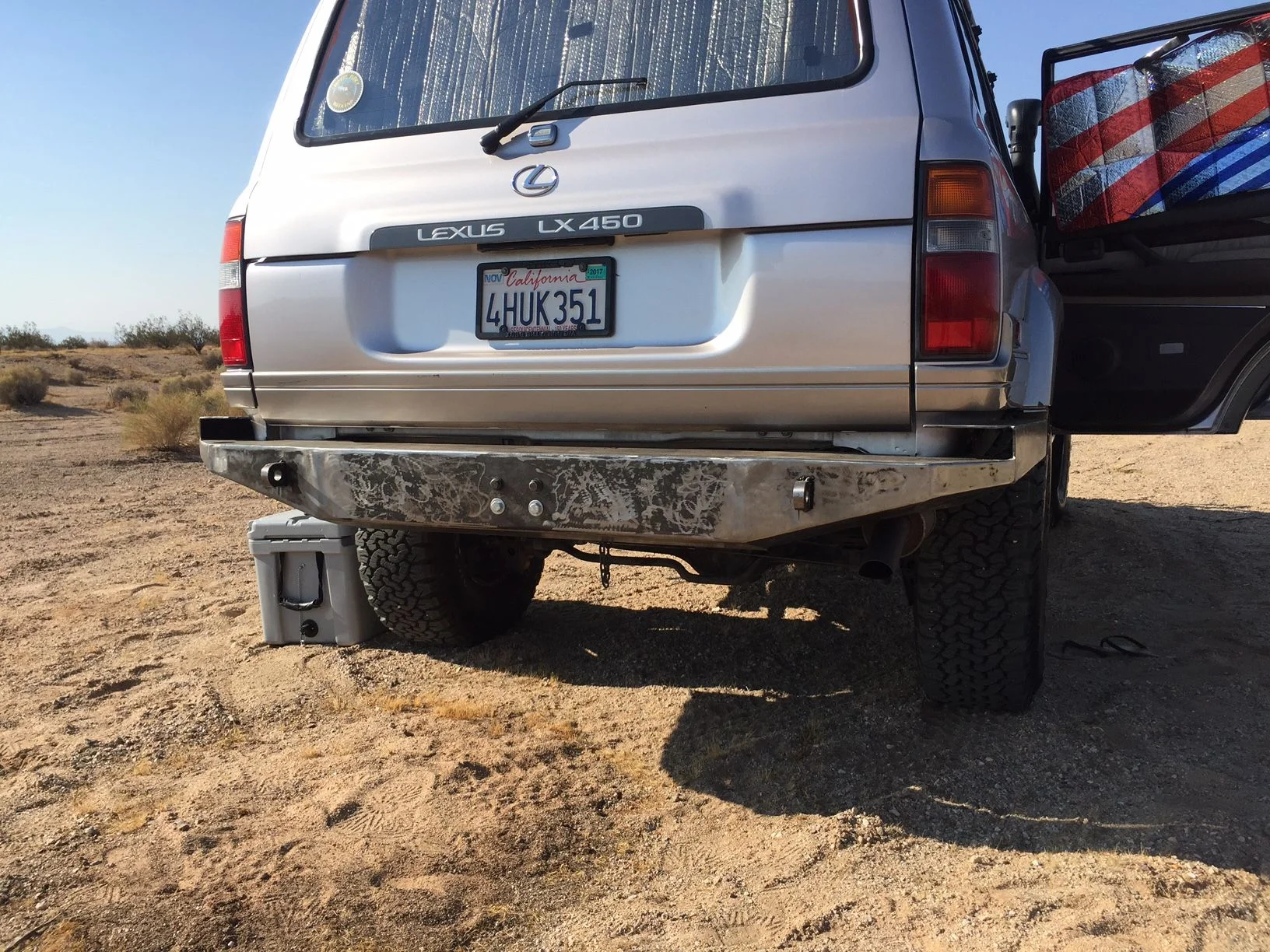

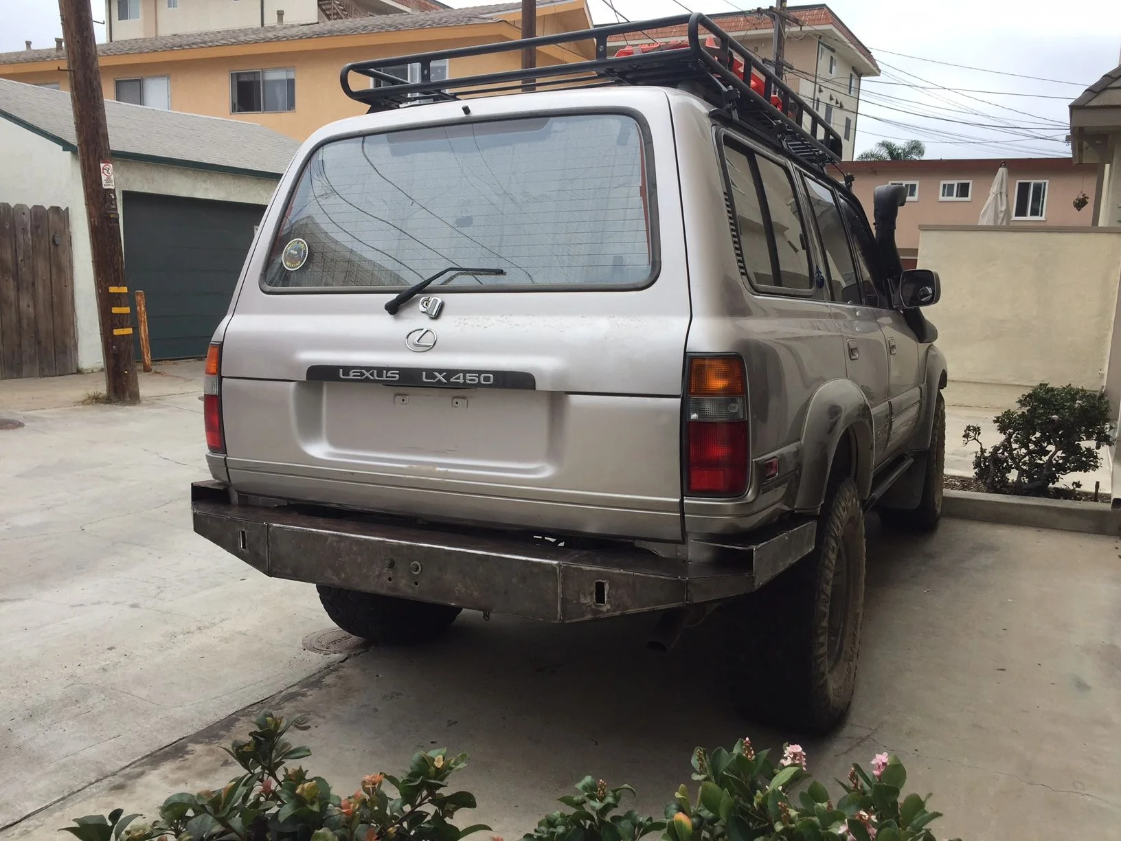

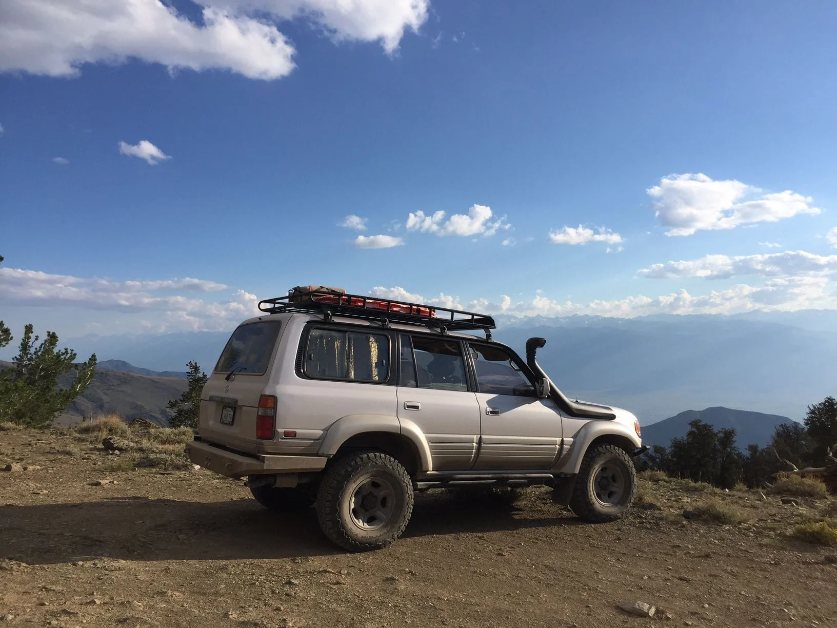

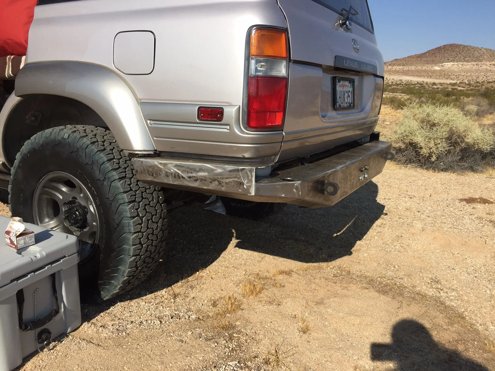

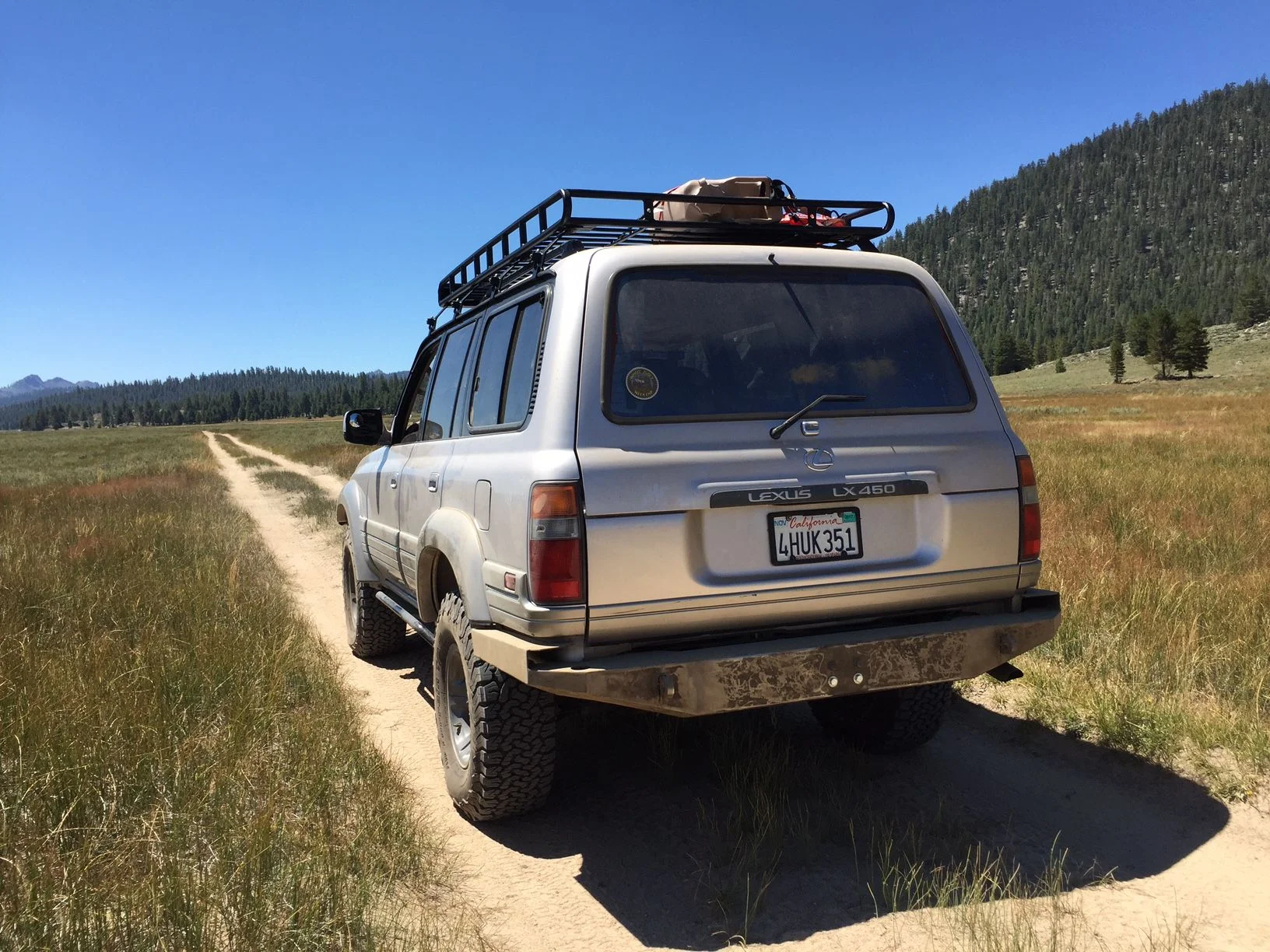

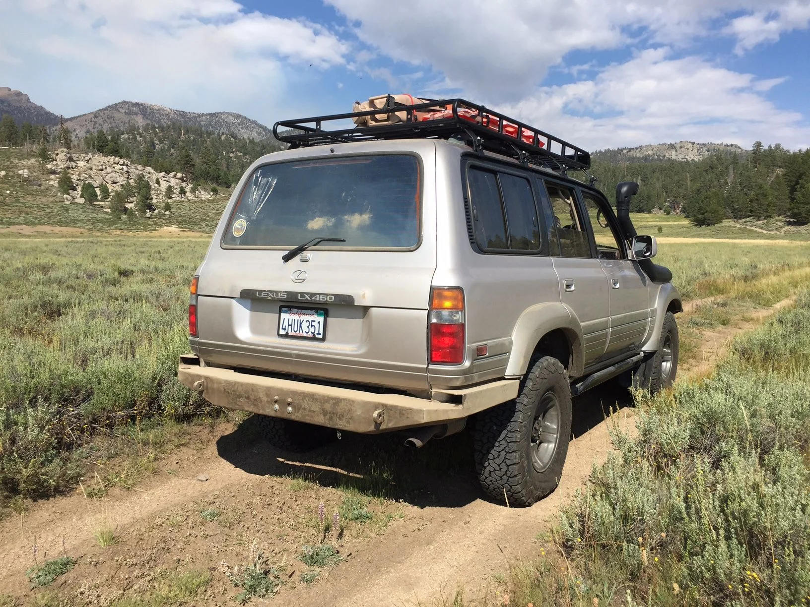

Just got back from 5 days wheeling and camping and its so nice to hear positive feedback on the styling of the rear bumper.
Wanted to run the bumper on the truck for the trip so I applied a couple coats of MavGuard and hit the road with it as-is. Here are some photos of the bumper enjoying the Eastern Sierras and White Mountains.

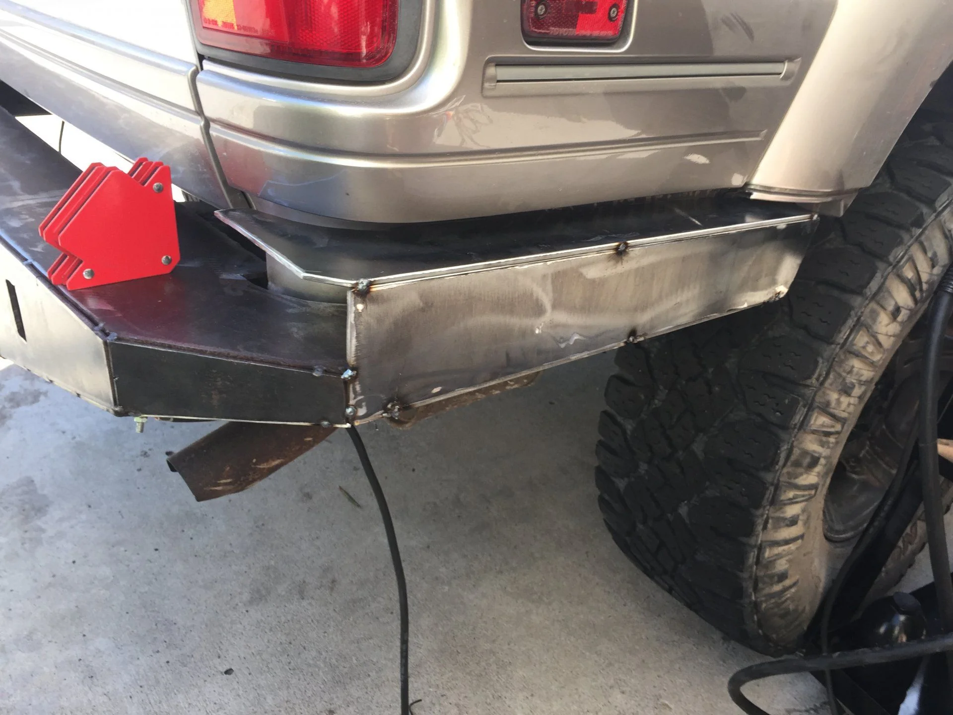

Next steps are boxing in the corners, trimming any excess, adding the spindle, swing out tire/jerry carrier, etc.
In the not too distant future, this bumper will be offered (in small batches) to others who are looking for a rear tire carrier/bumper that costs less than the current major offerings and is unique and stylish, strong, 100% bolt-on, and not excessive in weight.
