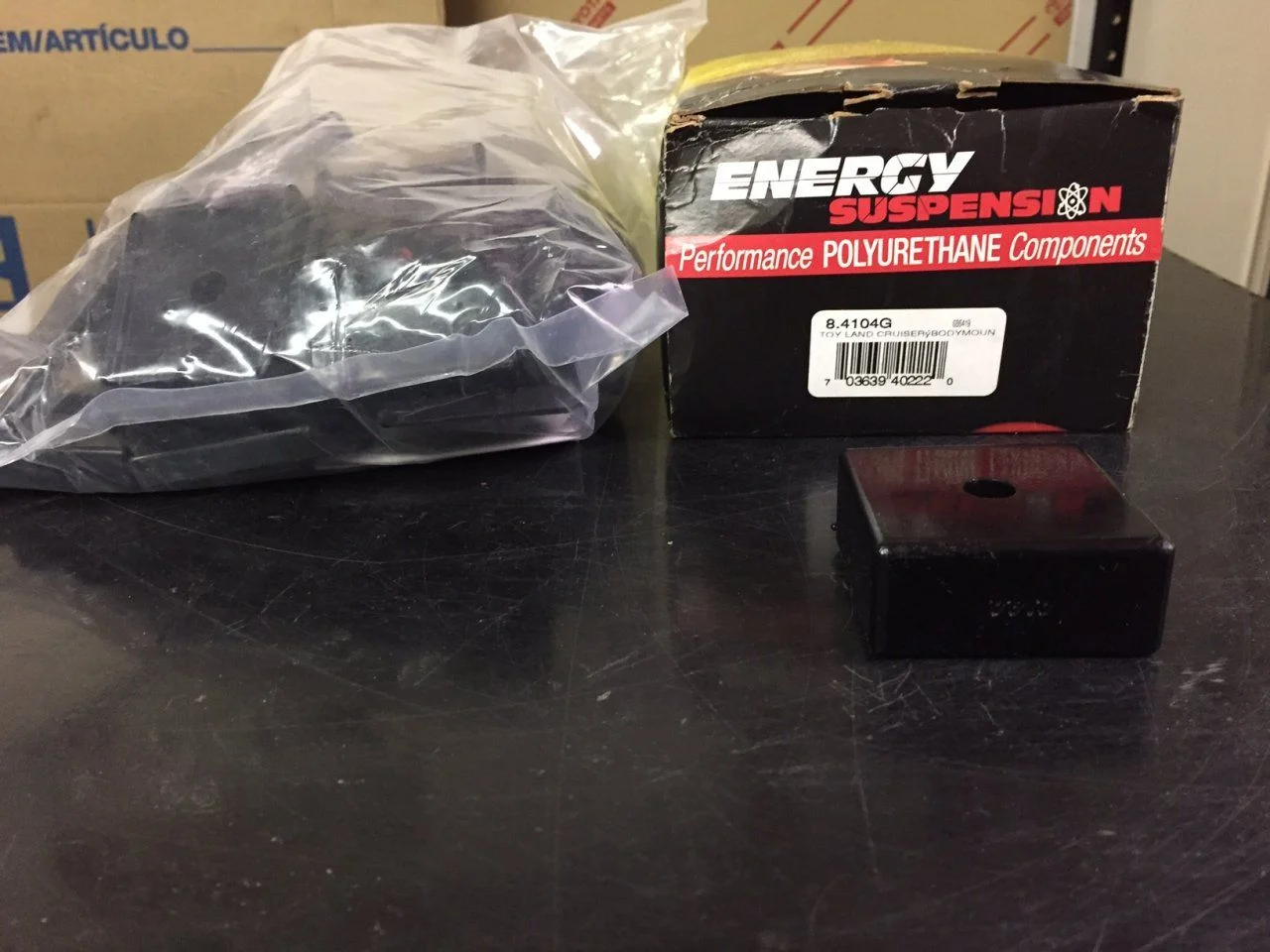

Post some pics when you get it... I'd be interested if it is OE'ish type mounts or aftermarket ES/Daystar style. The latter poly is great stuff and really better for use/install but I'm leaning towards something rubber/OE looking. I'll have to give Georg a call and see what he has :cool:
Kurt,
Here is the picture of what I purchased from Georg. They are the poly mounts. I bought 2 kits to have enough for my 45 LPB.
Michael <><
Kurt,
Gotcha, those are the standard ES FJ40 body mount kit. We stock them so that is an easy option but I'd love to find something a little closer to stock.

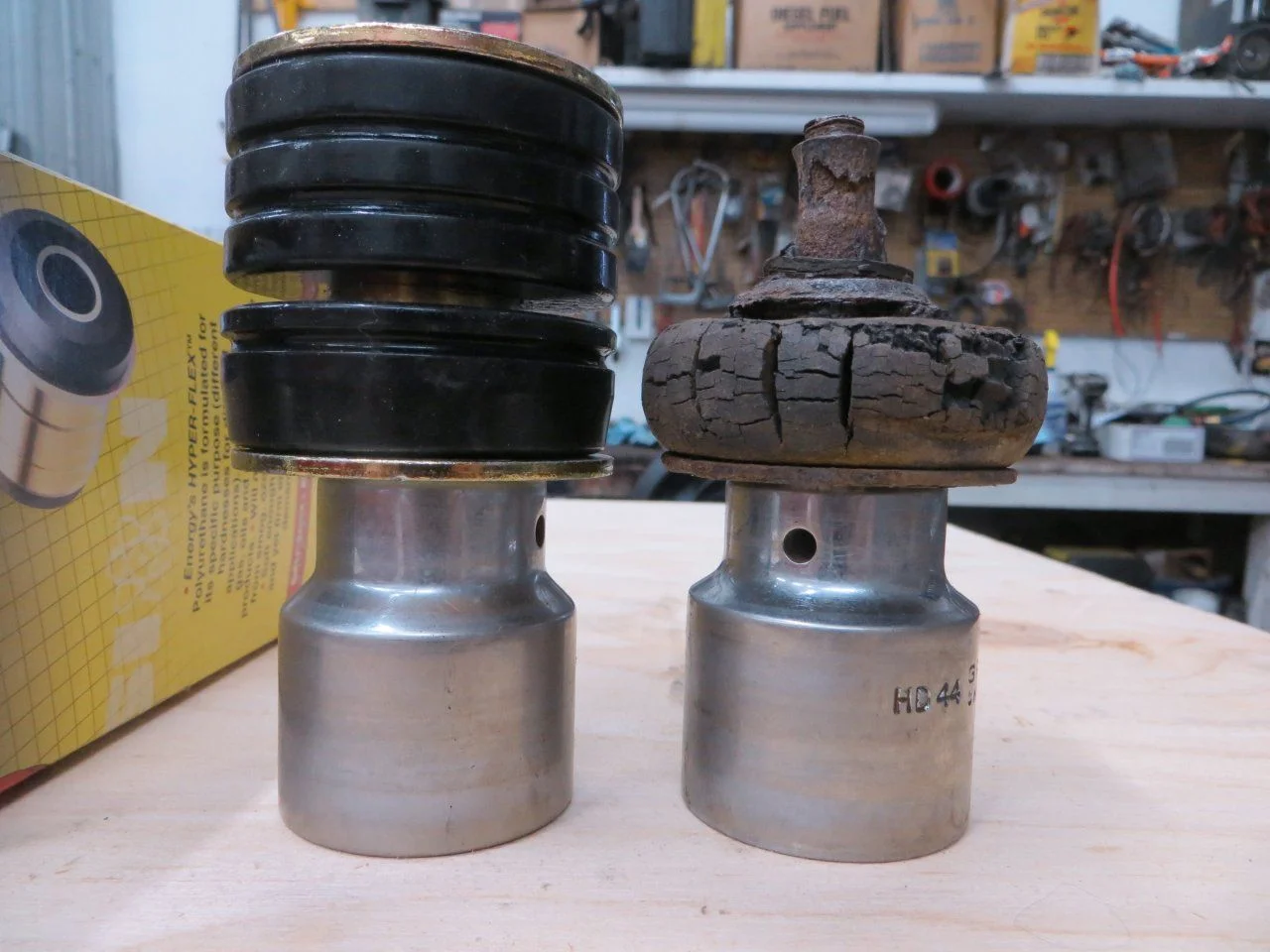

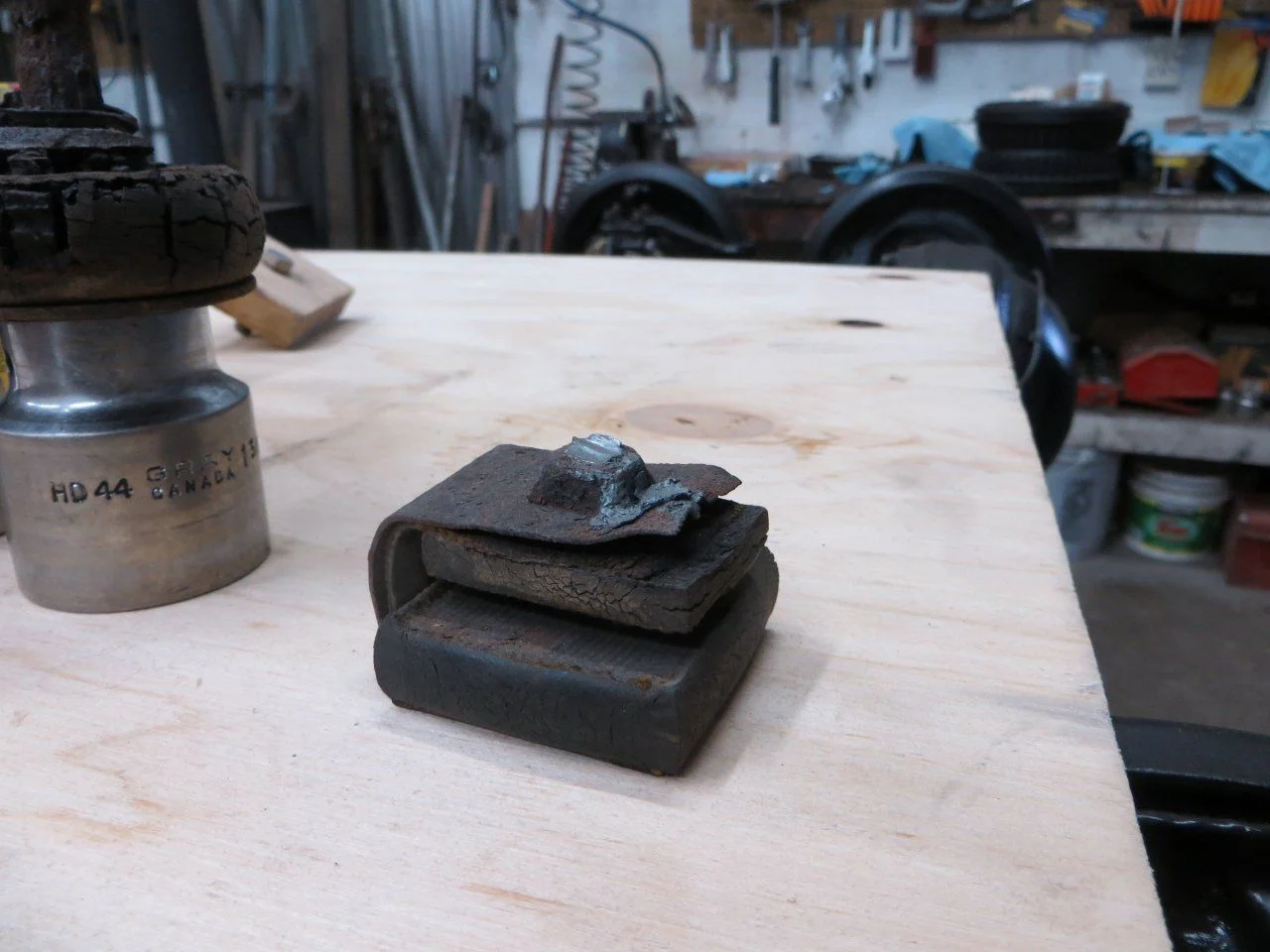

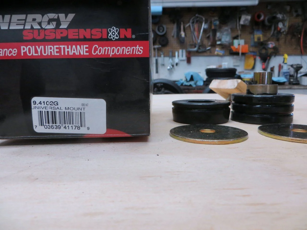

What about the cab mounts they are round
I am not ready to mount my cab yet so haven't tried these but this what I got
for the rear cab mounts. The old one is pretty deteriorated so not exactly sure on the hieight but a few shims would get it where it should be if needed. I'm still not sure what I'm going to use for front cab mounts yet though. For the box it looked like conveyor belting cut into squares which I have lots of.
