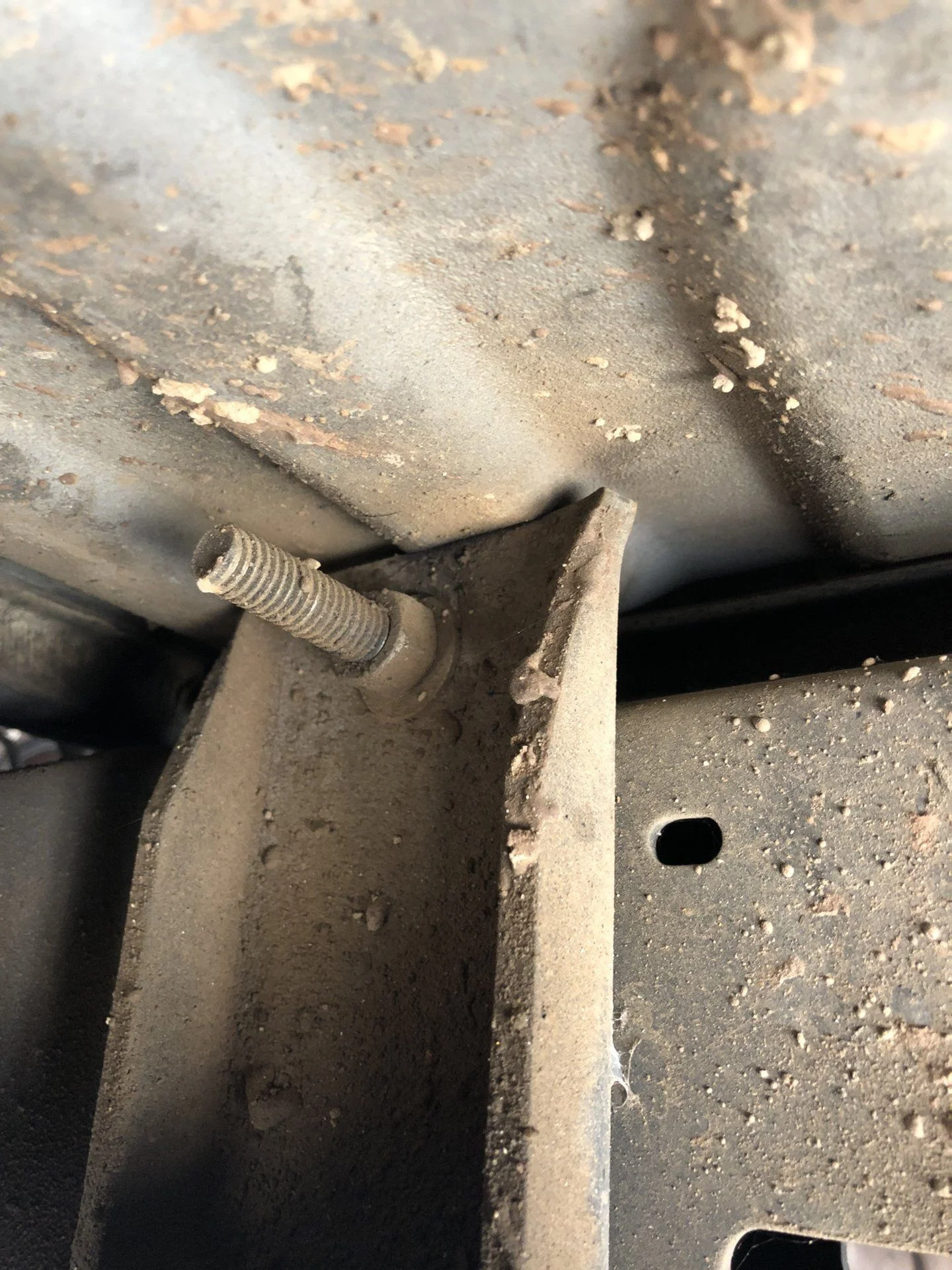

I think @hoser was right! At the exhaust shop and had a chance to inspect the truck. Looks like my driver side slider, front mount is hitting the body.
Forgot to attach image
see if you can jam a piece of old bike innertube in there.
