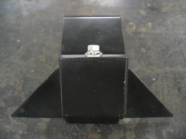

I would go with the JCR if you want to buy the mounts, but if you are planning on making the rack, why not just make the mounts based off the JCR ones. It's just plate and a nut welded to the inside plate.
I would not want the quick-n-easys as I just wouldn't want to trust that cam lock versus a bolted system...especially wheeling through dense bush where a branch might catch the cam lock and open it up.
I take it you mean to use 0.063 wall ERW ;) as that 0.63 wall tube would actually be solid bar :D
Now that rack mount is a game changer!

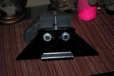

Finally completed the roof rack and got the RTT on.
Looks awesome and works great.
The diamond clamps really distribute the weight well. I cannot imagine there being any issue with weight distribution..
The new 4" (IIRC) so lift clamps are about perfect for a 60. There is additional lift available. The clamps are as far down as they can go.
And, 3 Darth Vaders on each side will help keep the Zombies at bay ;)
You can see the available room under the rack in the second pic.
Looks sweet man! Glad the clamps worked well for you......long live Darth Vader! :)
Thank you amigo. Not having to make my own roof clamps saved me a ton of time. It really was appreciated! And, I'd highly suggest using those 4" (or so) risers for any 60 roof rack sales. They really are about the perfect height.
