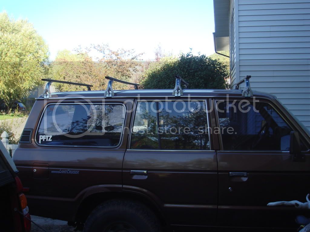

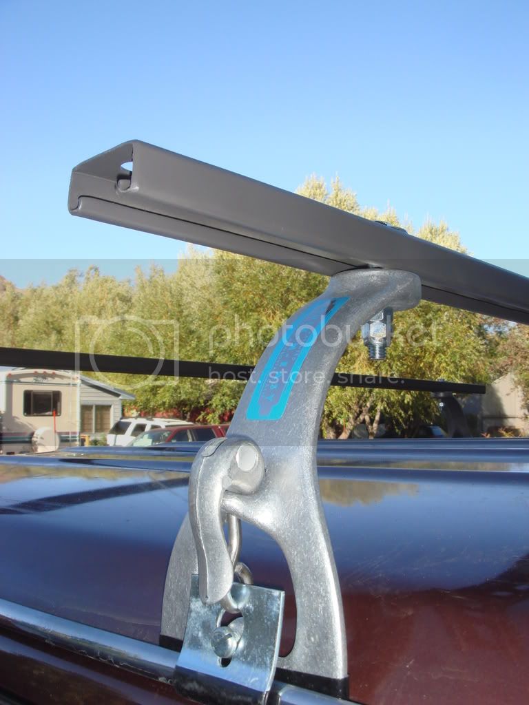

I have the quick-n-easys as I got a bunch, used, for a deal. They do stick up a bit above the roof, if that's an issue.
They actually make two different varieties of quick n easy's. A 4" tall one and a 6" tall one. It looks like you have the 6" tall ones.

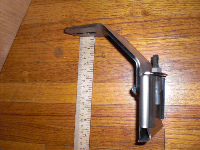

Those are essentially the old conferr design. Really awesome, but $180 bucks for six clamps is over budget :)
Ya know, Mace, Mark Algazy sells some HD ones he has made, and I think they're based on the confer design, for around $25, *I think* ... They're not on his website... Call him.
Or search in classifieds - I think he listed them once.
I found it:
The pic does not do the above justice. These are BEEFY! Very strong gutter clamps. A bargain at twice the price. :clap:
I found it:
Do you have his web site?
Absolutely, those are super beefy, but also 6" tall (taller that I need for a 60) and $170 for a set of 6.
Yes, waaay beeeefy. And he's sold a bunch to some folks going into the roof rack business. Mark just doesn't advertise his goods, much, so people don't know about his little treasures.
$150 for 6 + shipping ... Yes, they are tall.
marksoffroad.net -- but better to call him 818-953-9230 1-6pm M-F ... He not an email kinda guy.
calling mark is typically the best route
Based on the patina, I suspect those are the stock Confer brackets from back in the day.
Not a huge difference because that is what he patterned his after but...
Yeah, you may be right -- I thought he put that rack on after he got the rig, but :meh:
Anyway, peoples get the idea :) And he's better at making rack feet than he is at uploading pictures to mud :D:rolleyes:
