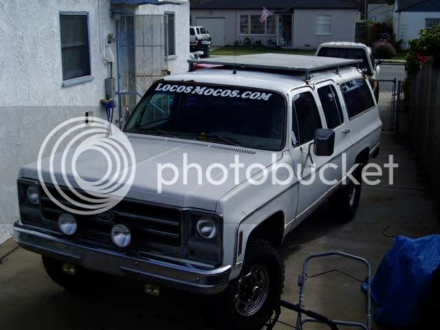

I am just completeing a rack of my own. I used the old Yakima 1A towers I had around. Beefy suckers, never failed me even when I (perhaps foolishly) had a 240-pound length of steel on the roof. I bolted them directly to the rack. They seem to be available on Flea Bay regularly but do tend to be pricey. They have just the right amount of rise to keep the rack from hitting the roof and still keep the profile low.
At some point in the future I'll be cutting down this Machine Genesis rack to fit the 60:
Using the mounts from the rack that came with the truck:
I like that the MG rack is only 1.125" tall. I've never missed having rails above the deck, actually the flat deck has been a bonus more than once.

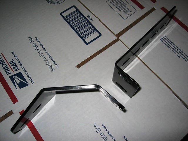

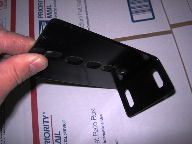

Here are the brackets we're producing to keep the racks lower to the roof on certain vehicle. They use the same bulldog clamp (Groucho's, Mark's, Con-ferr's) and bolt right up:

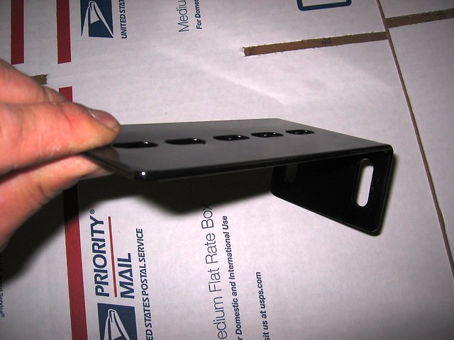

Here's a pic of the new bracket back-to-back with the standard bracket showing the height difference:

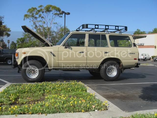

The Mark brackets are fantastic. They're tough and hold a lot of weight. Prior to installing the brackets I covered the clamping portion with bed liner (Rhino liner) in order to keep the metal to metal on the roof to a limit. The RR if home built and was built without the side rails so that the rig would fit in the garage without the RRT. The awning attaches to the mini receiver hitches mounted on the Mark brackets.
