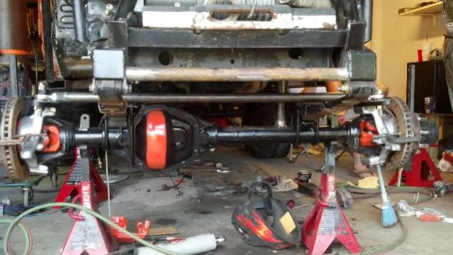

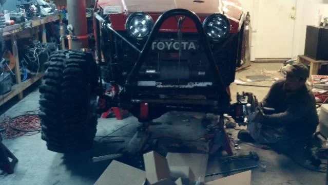

1.) Making sure the new wheels fit
2,3.) New wheels and tires mounted. It is a good bit wider than it was.

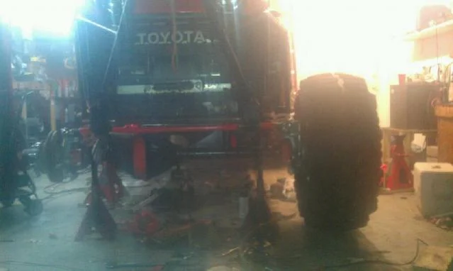

1.) Slowly but surely
2,3.) Gonna be WIDE!

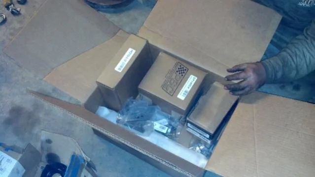

4.) Box of goodies.

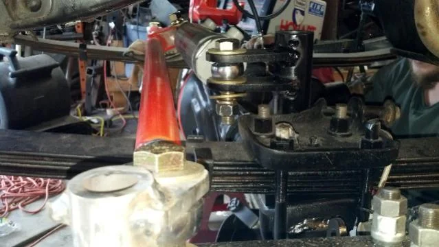

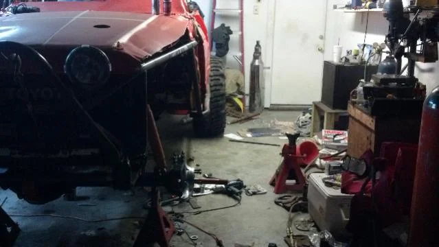

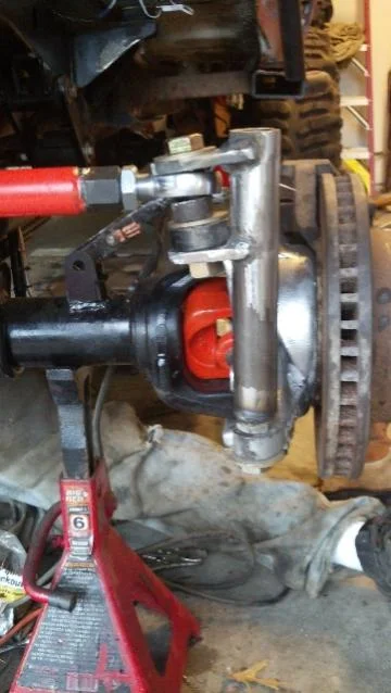

Mounted the psc supplied saginaw pump and made the stock pulley work on it by running it backwards and opening it up some to press onto the shaft.

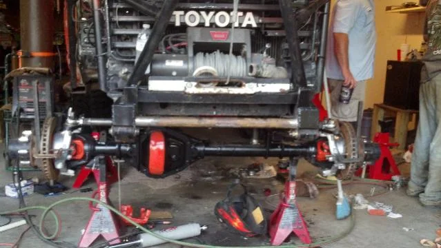

Also got the 1.5" x .250" wall D.O.M. tubing cut and burned in the 7/8" heim joint bungs. Steering ram kinda beat our heads for a while as it is an 8" throw and it seemed to work. Short story is we had to drill an extra hole in my 3/4" thick high steer arm (other was doubled drilled already as i thought i was gonna run cross over and ram assist still) and it was perfect. Full throw of the ram and u-joints were not binding or jumping over each other and a nice steering throw to boot!
Looks like it is coming together. That tie rod sure looks spendy :P
Hopefully I can get mine driving by the time yours is back driving. That front axle should hold up for a bit...

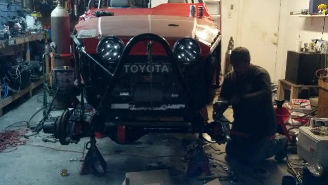

Steering gusseted on one side and tied to stock location for more strength.
Headin there here soon to help out and get some more done.

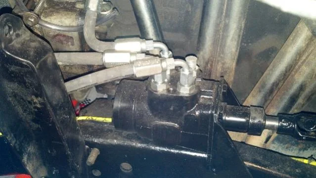

Some shots of the steering
And of the steering fluid holder thingy majig....

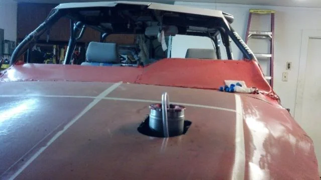

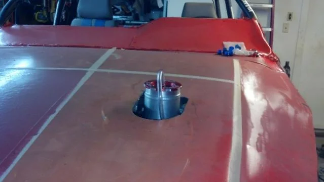

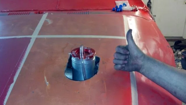

Now really ideal, but the way we had to mount the pump we were sorta screwed without redoing the belt system and what not. Being a remote res and gravity feed to my $$$$ pump and stuff we really needed it as high as possible. And even now it still isnt ideal. Luckily someone else had already cut a hole. ;-) so i just made it larger.
Speed hole... Adds 20 mph :D
Looks bad ass ...tons was all she was missing ... I miss her even more now keep ip the good work
Lol, well good cause i could use the speed. Maybe that fixed 3rd gear!

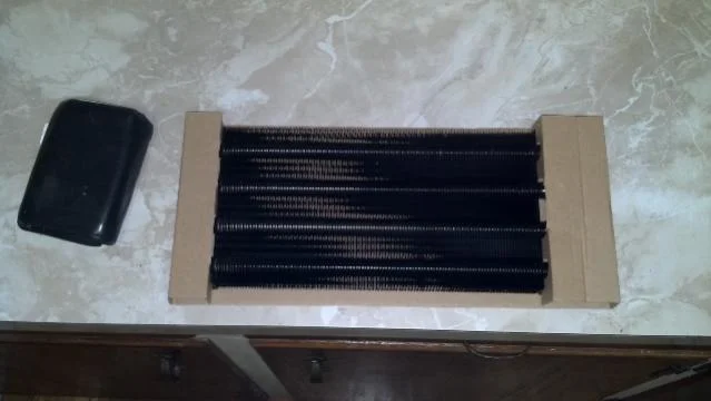

Got my new steering cooler the other day so hit it hard again till midnight last night and got a lot finished. Front drive line is made and in place, steering is all plumbed and finished up and bled, other knuckle is gusseted and in place, brake lines are run bled and good to go also. So we started it and checked for leaks and clearances!

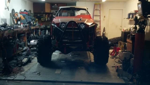

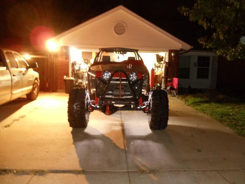

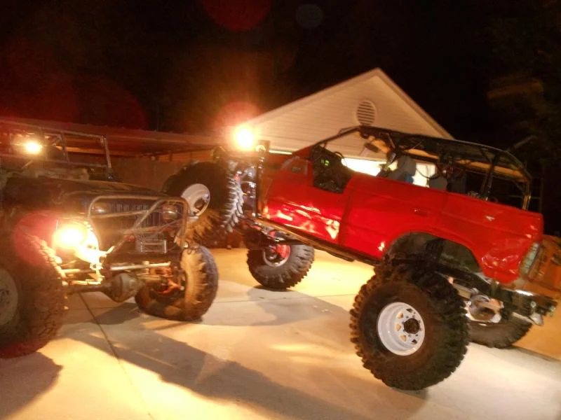

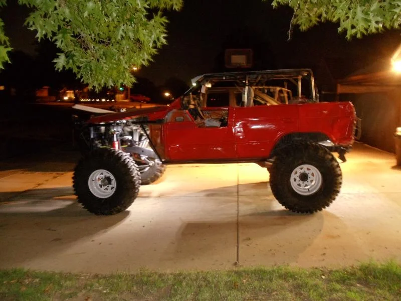

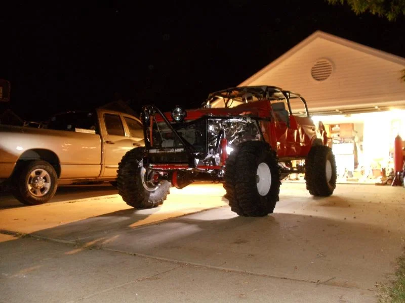

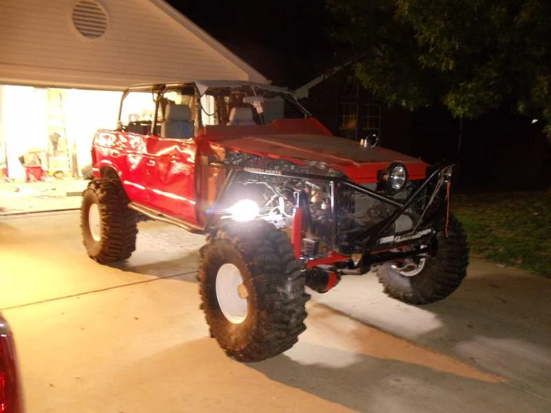

90 inches wide!
out of the garage on its own power!

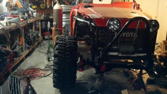

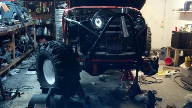

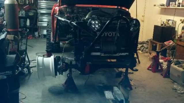

1.) so wide! But i kinda dig it.
2.) checking clearance
3.) same
