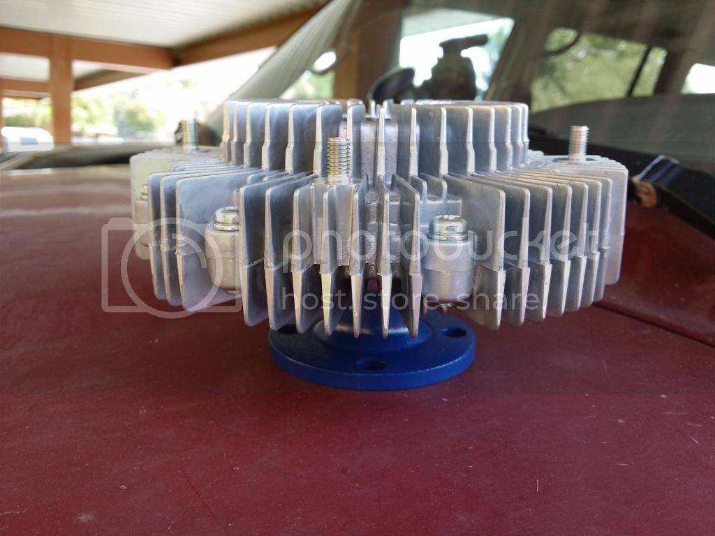

Ordered one of the Amazon clutches. I don't know if it's been mentioned in the thread yet but they look to be sending actual blue hub versions. I was curious of the variances in start/adjustments that are possible. Opened mine up and the factory setting was damn close looking to where the pix show LX. So after seeing the pix LX posted and reading that surf pig ended up with the same start / finish I just eye balled it lol. Total time. From unbox to (start of) drain. Six min.

I didn't read the whole thread, but page 1 referenced the amount of adjustment needed not being documented, so I went ahead and scribed the screws per your recommendation and took a pic for reference. Hope it helps someone.
As it turns out I had 5 clutches to mod today and did a little more checking on them. What I've seen is that the clutches don't always need the same amount of adjustment. To check my method I switched from the thermometer to an IR gun last year as the consistency of the thermometer was questioned in this thread.
To further check my method, after adjusting the 5 clutches I then placed them in a 170* oven for 15 minutes. I wanted to compare their positions at an elevated temp and confirm that they were similarly responding to the higher temp. From what I could determine the positions were all the same.
I'll actually start adjusting them using the higher temp as I think it will yield a more consistent result if there is some deviation in the springs response through natural variations in manufacturing.
