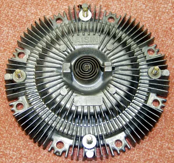

What exactly is early or late blue models? What am I looking for when looking for a "early clutch"?
To a large extent it dosen't matter, they are no longer available, the only way is used. The new one is a good clutch, just requires higher viscosity fluid to have the same performance.
The first pic is the new style, notice the sheet metal thermostat spring holder and cooling fins don't go all of the way around.
The second pic is the early blue and black hub. The fins go all of the way around and has a cast spring holder.
The third is the Eaton. Has a ring around the fins, cast spring holder and has 4 torx head screws.
Thanks.. I'll have to look and see what's on my 95. What years were the early blues out?
If it's original, my guess is Eaton, they are the most common. Some '93-94s had the black hub. The early blue is a dealer replacement from the late '90's, very rare.
