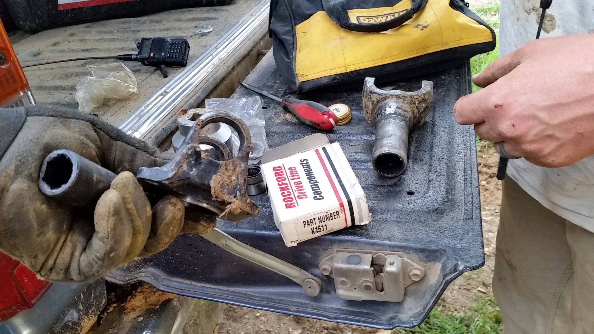

Awesome! that's why I carry not only a spare u-joint but also a whole slip yoke assembly. so if the yoke side joint breaks it's a five minute fix.
