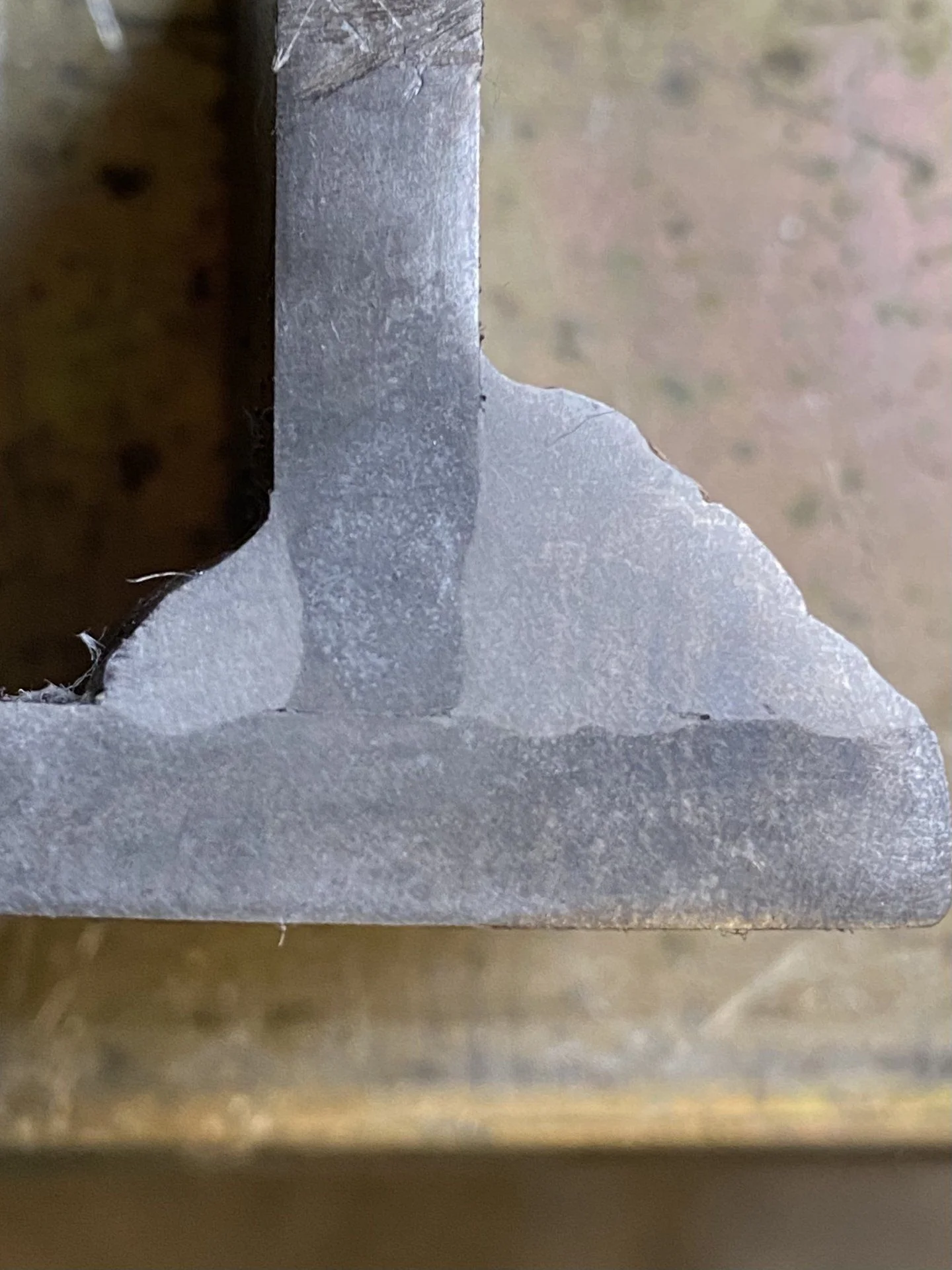

Also, just to see how I was doing with the welding I did some cutting and etching to see what kind penetration I was getting in 1/4” steel with my 140 Hobart.
In this image it is a single pass on the left and multipass on the right. The left looks pretty good and should stick. Multipass is marginal. One of these days I’ll get a welder with more power....but most of this job can be done with the 140. Was fun to play with the etchant.
The multipass weld issue is a technique issue only. The welder can do it. The single pass weld isn't great technically either, as you haven't fused the root at all, at least not in the etched section.
Get a better welder, or keep practicing! Preferably both :)
agree it’s not great, but with 1/4” plate I’m probably not gonna get much better penetration out of a 140 welder no mater what I do. Good thing is most of what I’m welding to is not that thick. The frame on the 60 is less than 3/16”
