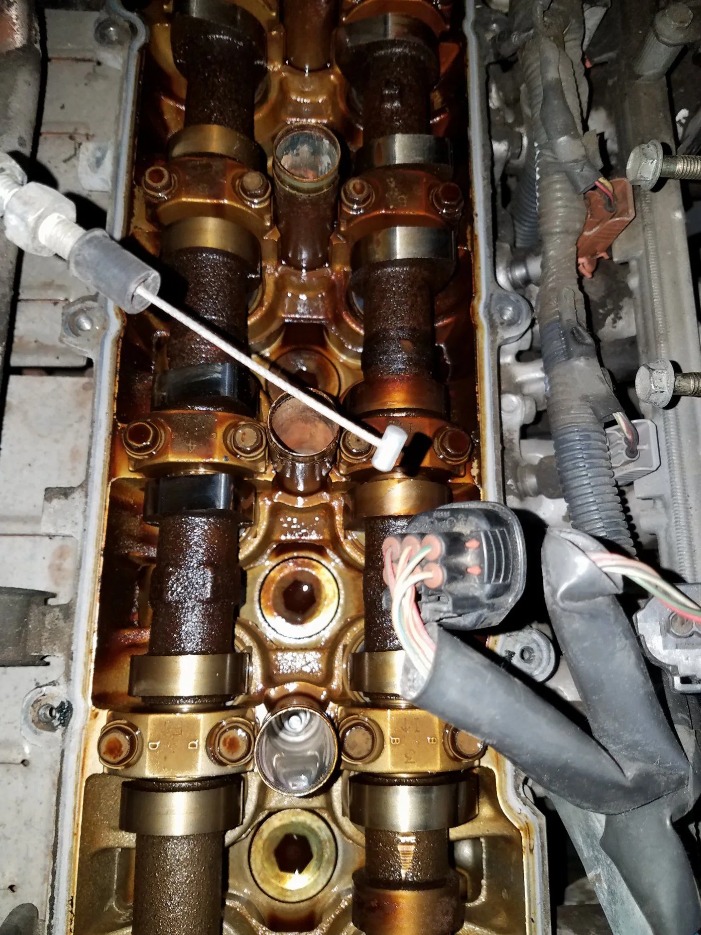

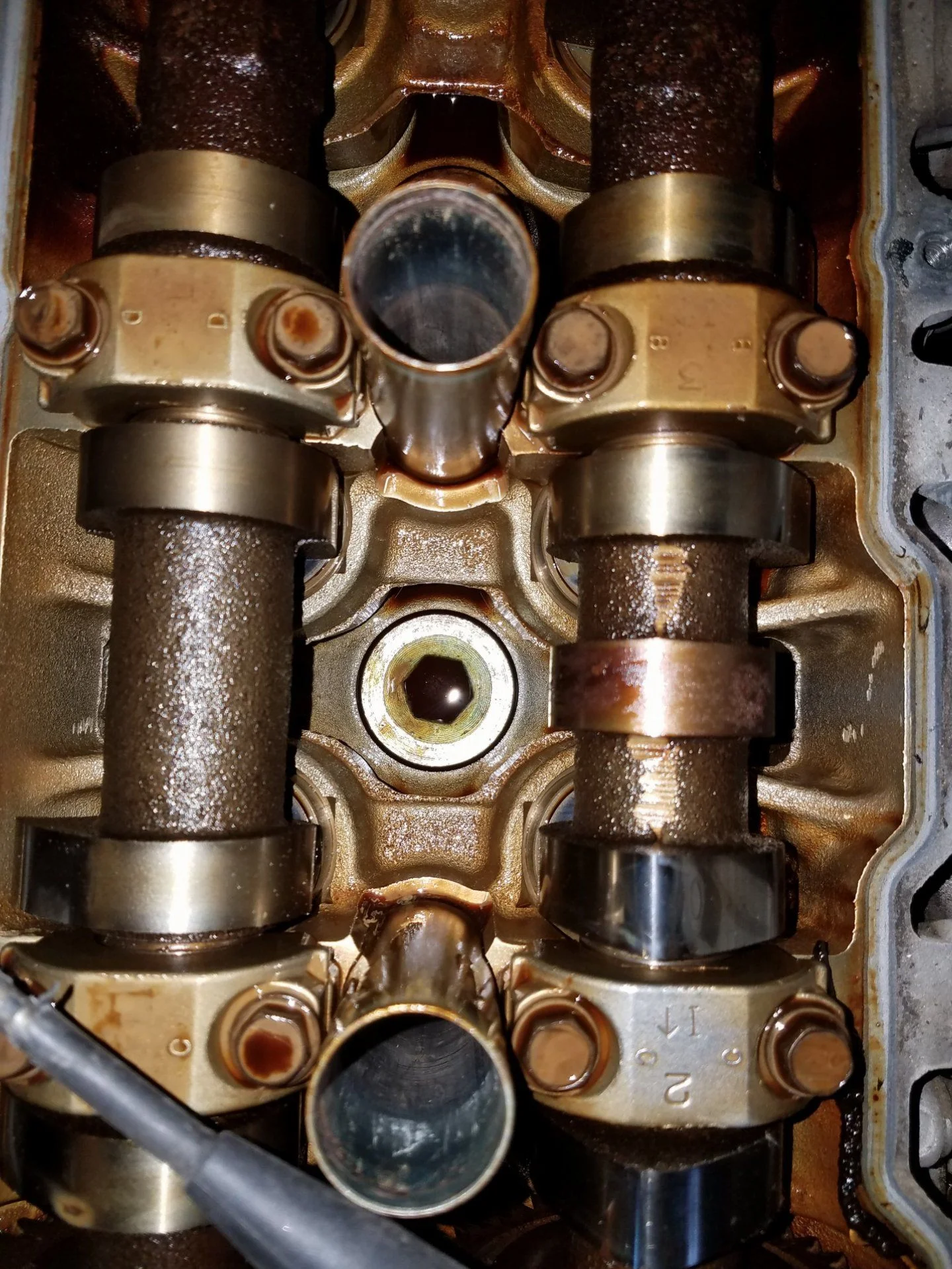

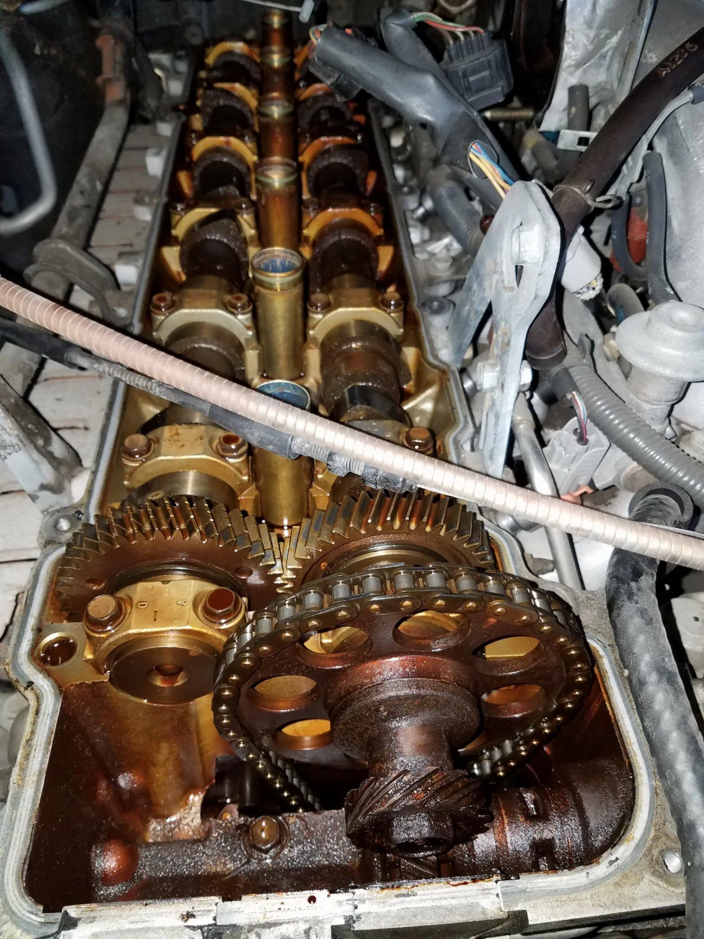

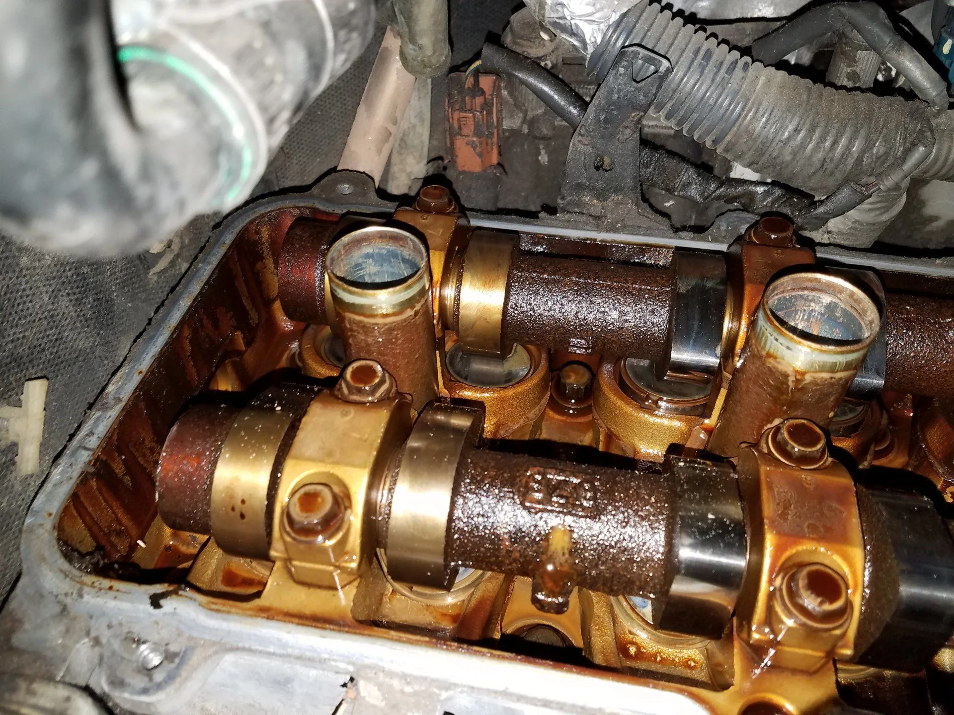

I just bough a 1997 Land Cruiser with 140k miles. The head gasket blew 2.5 years ago and has been sitting ever since. I drained the oil the other day and the oil wasn't all that brown and milkshakey, however there was coolant in the oil. I got about 12 quarts of oil/coolant out when I pulled the drain plug. Im on the fence about just fixing the head gasket and running it or going further and pulling the motor and have it all gone through. I know coolant can cause rust and eat the bearings, so I pulled the valve cover and I think it looked fine. The lobes arent pitted and where they look a little brown I am able to polish them like a mirror with a paper towel.
If I pull the LOWER oil pan would I be able to get to a main bearing and remove it to inspect a bearing? I really dont want to remove the motor quite yet or do I have the funds for a rebuild.
Any opinions on how this looks?
Those pictures look exactly like my top end did when I pulled my valve cover off to replace gaskets. I would suggest pulling the head to look at the cylinder walls. If you don't want to go that far find a bore scope and pull the plugs.
So from my pictures would you say your top end looked like mine does?
The top end of my running and driving 96 LC looked exactly like that when I pulled the VC to change gaskets 2 years ago. It did NOT have a blown HG when I was working on it (it was replaced 45K before I got it)
So yeah.....normal there.
But, you're going to pull the head and replace the HG anyway, so you'll need to dig deeper for that.......
Doesn't look bad to me.
