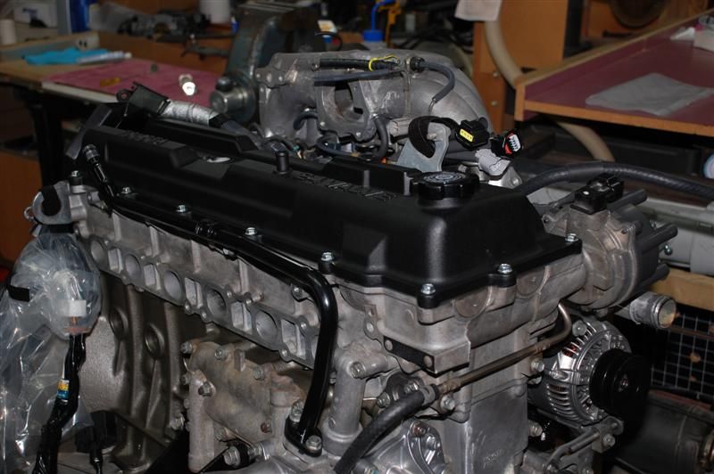

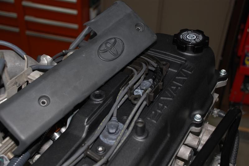

Valve cover installed

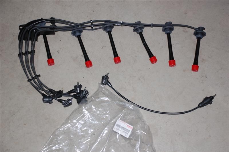

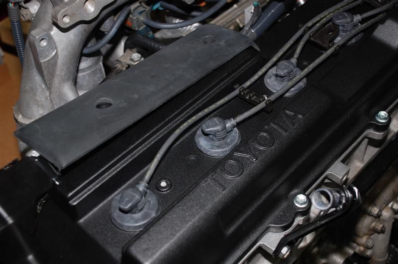

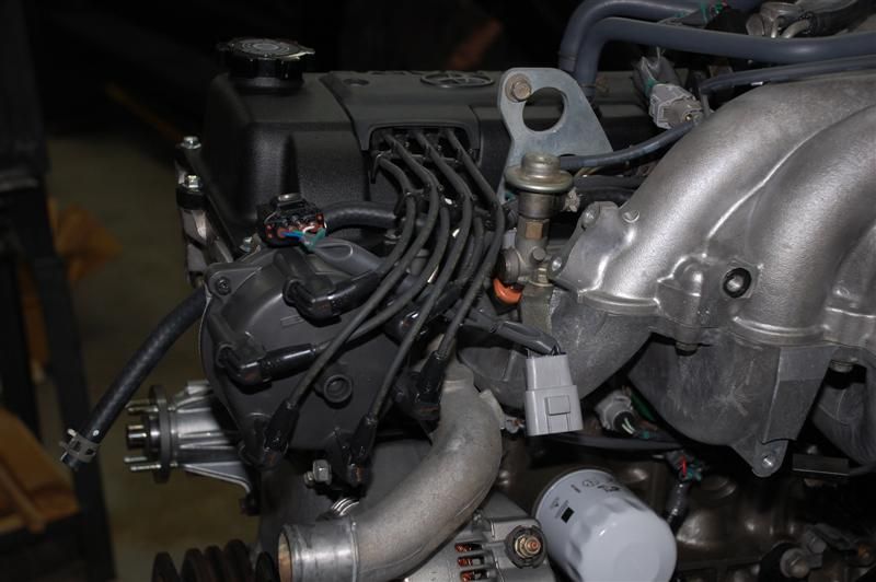

Spark plug wires. I am amazed how slick this setup is. Very well engineered. And you get it completely assembled. NO ASSEMBLY REQUIRED. I really liked that.

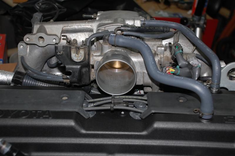

Here's the throttle body nearly all plumbed up. Ready for EGR crap.

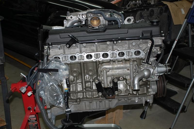

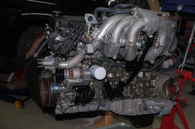

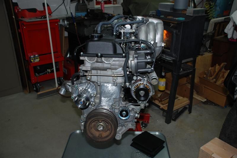

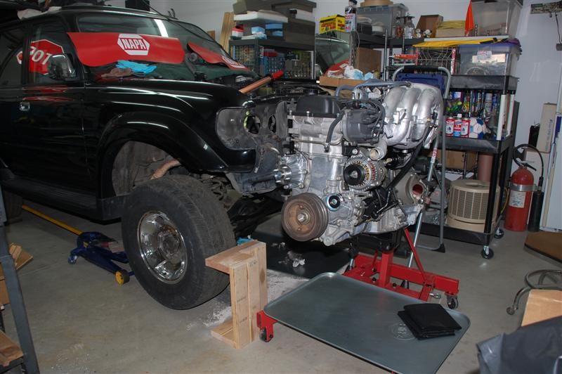

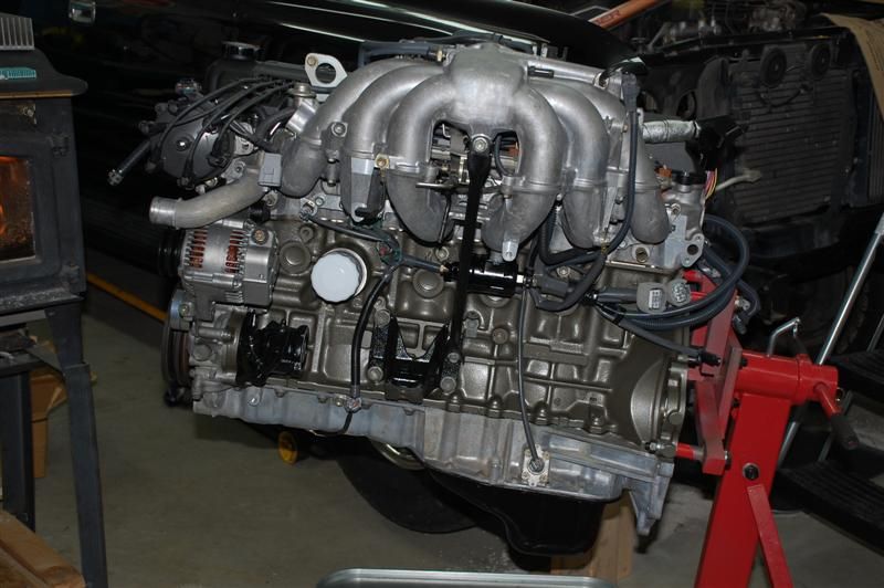

The left side of the engine

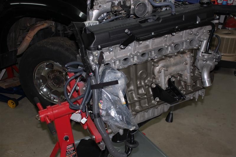

The right side of the engine

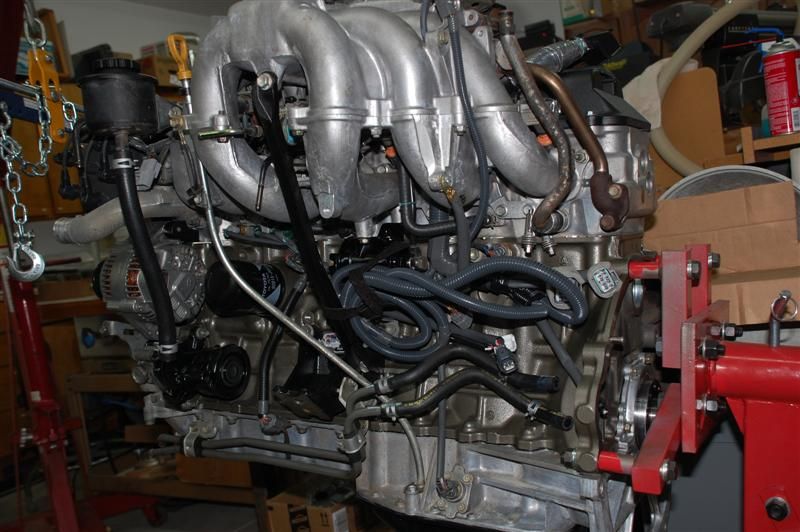

The view from the radiator's perspective

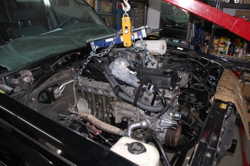

Update 12/09.
I installed the engine on Friday, Dec.7, 2012. Well, we did. Big thanks to pmccumber!!!

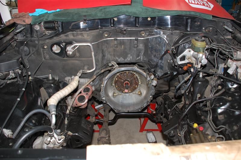

The engine bay was finally clean enough.
http://i43.photobucket.com/albums/e353/Rhoderman/1996 FZJ80/BlkPrj80 Build Thread/DSC_6192Medium.jpg

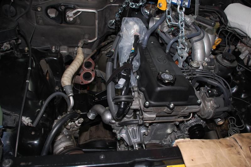

The engine is ready to be installed. I wrapped the wiring harness and tucked it under the intake bracket
http://i43.photobucket.com/albums/e353/Rhoderman/1996 FZJ80/BlkPrj80 Build Thread/DSC_6208Medium.jpg

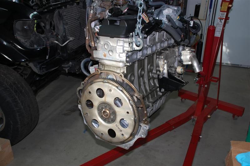

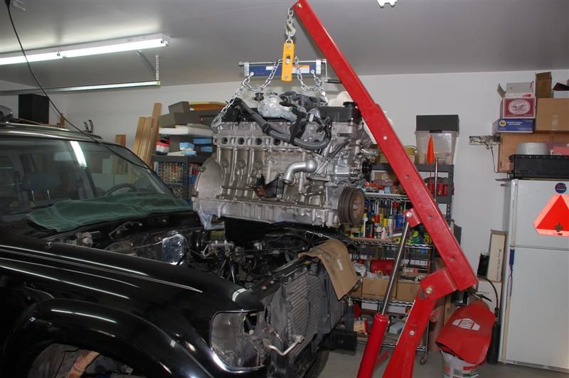

We transferred the engine from the stand to the hoist, scary for a moment when the engine tilted as the load shifted!
I bolted on the flex plate while it was in the air.
http://i43.photobucket.com/albums/e353/Rhoderman/1996 FZJ80/BlkPrj80 Build Thread/DSC_6232Medium.jpg

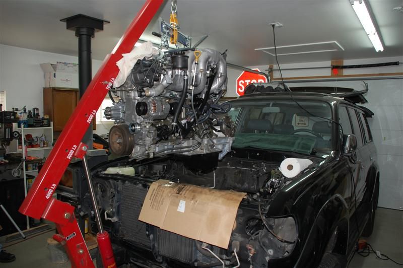

We raised it her up in the air
http://i43.photobucket.com/albums/e353/Rhoderman/1996 FZJ80/BlkPrj80 Build Thread/DSC_6233Medium.jpg
http://i43.photobucket.com/albums/e353/Rhoderman/1996 FZJ80/BlkPrj80 Build Thread/DSC_6235Medium.jpg
Then we raised the front of the transmission and lowered the engine into place. Getting the torque converter to align was a challenge, but once it all came together, it was worth the effort!

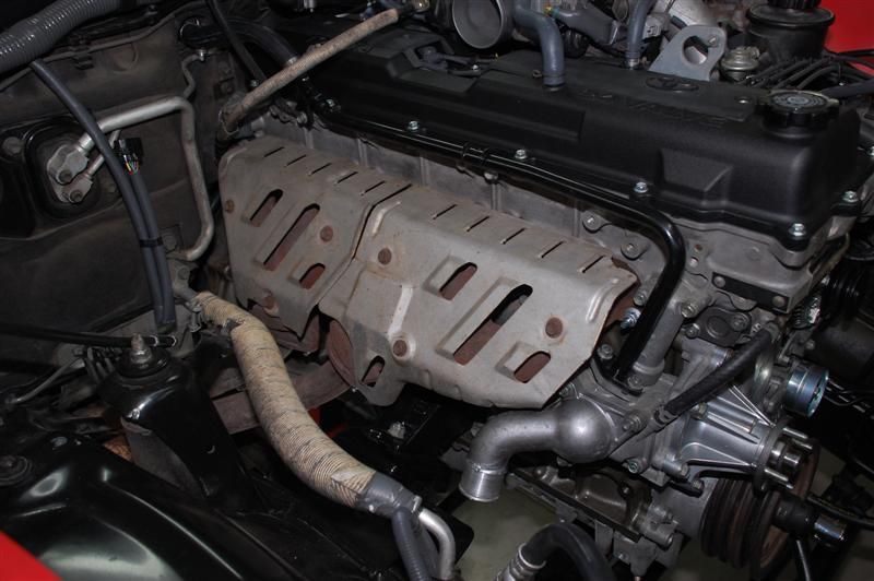

I hooked up all the exhaust.

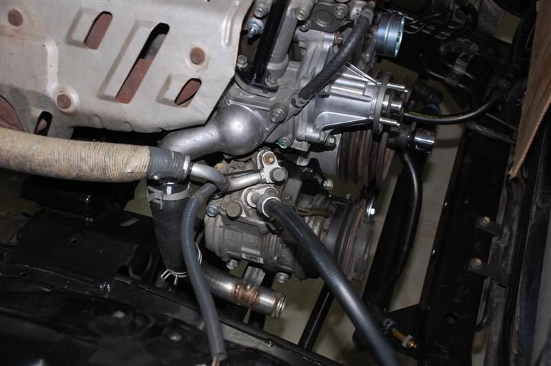

The A/C compressor is reattached (don't even know if it works...)
http://i43.photobucket.com/albums/e353/Rhoderman/1996 FZJ80/BlkPrj80 Build Thread/DSC_6261Medium.jpg

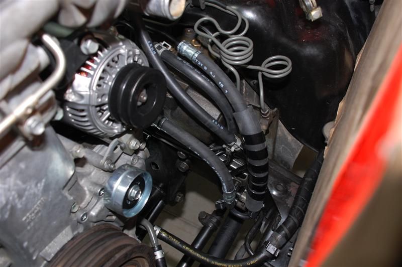

The new power steering hoses are all in place.

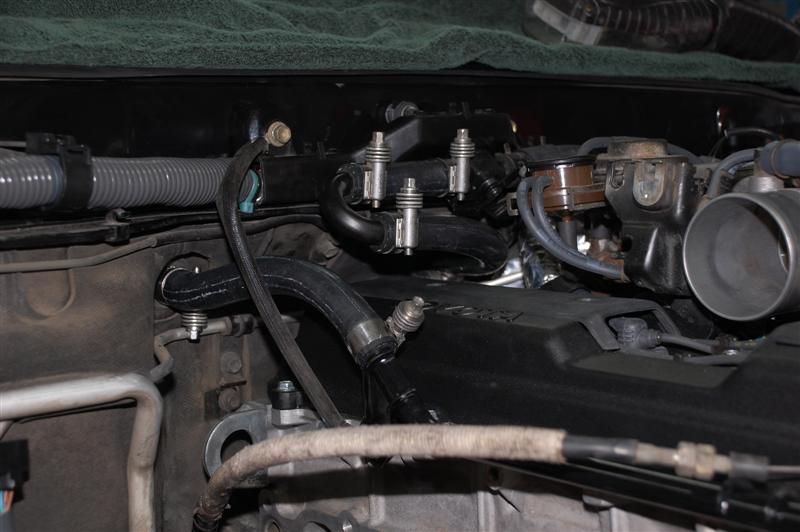

Today was the BIG DAY! It started, but I have issues. Cyl #2 and #6 are not firing, and I'm pretty sure it's the injectors. It is entirely my fault as I should have held onto them until I was almost ready to install them. I had them cleaned back in August, and installed them onto the rail/intake November 6.
She sounds very good for running on only 4 cylinders. Kind of shaky, but no bad noises from anything.

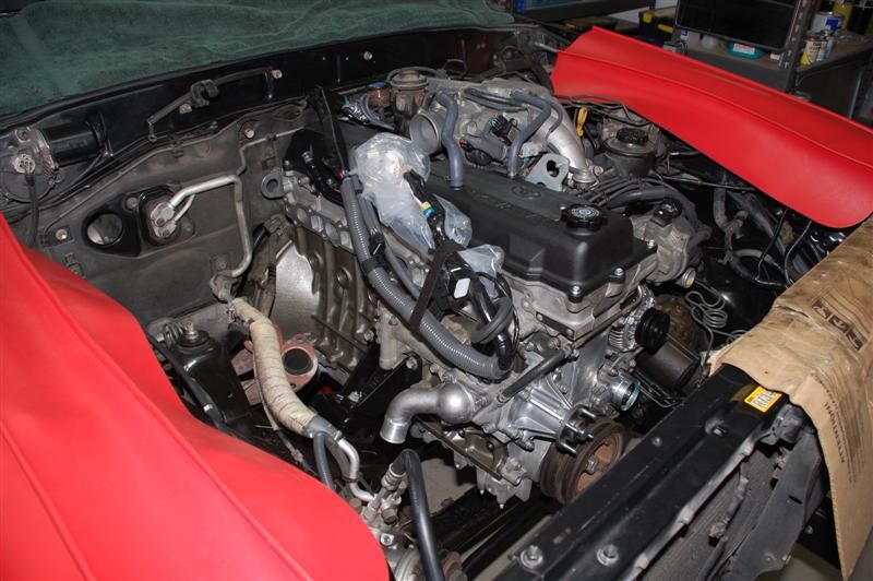

Here's a view from the right front of the completed engine installation.
Left front.
From above. Everything but the battery in this shot.
