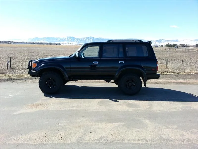

Here are a couple of pictures with the lift.
The lift is 2.5" OME, 850 / 860. I put on 285/75R16 Duratracs on some freshly powdercoated wheels that match my valve cover.
I've got all the basline fluids done I think. Next is sliders and armor and a back bumper, and, and... In reality, next is probably an oil change. :flipoff2:
