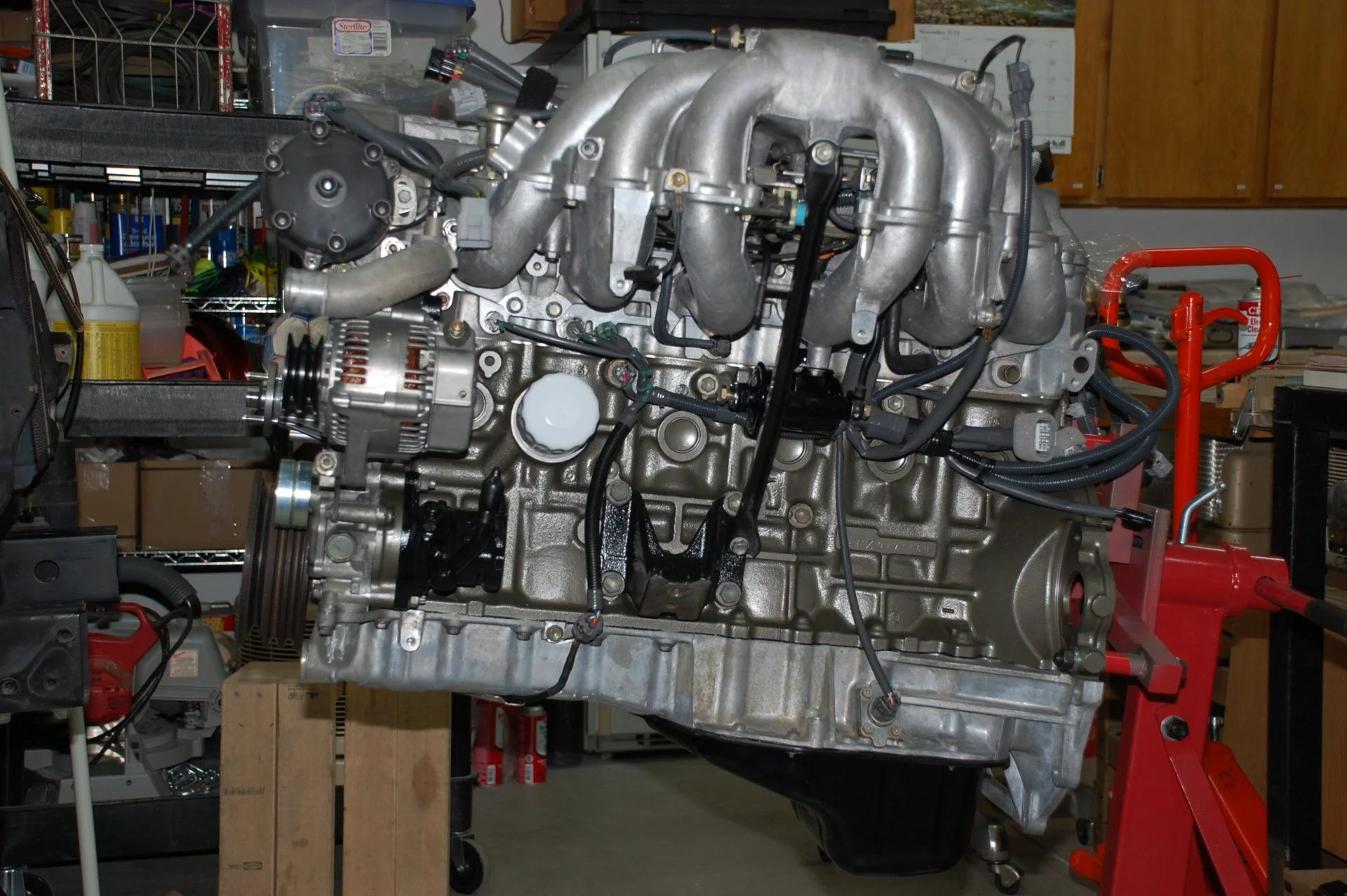

To start, here is a picture of my engine from just a couple days ago, and one from the day I bought the Black Project.

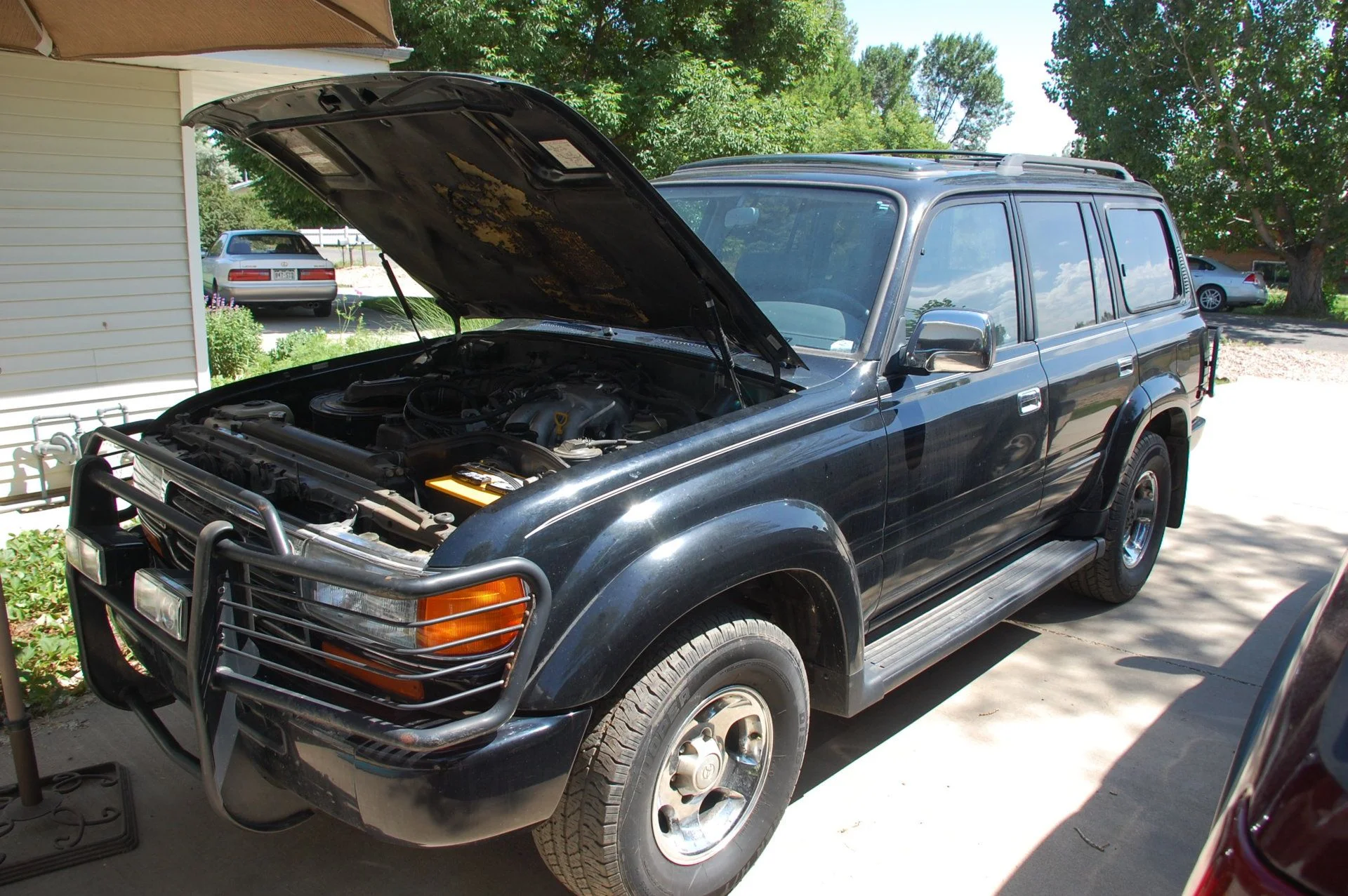

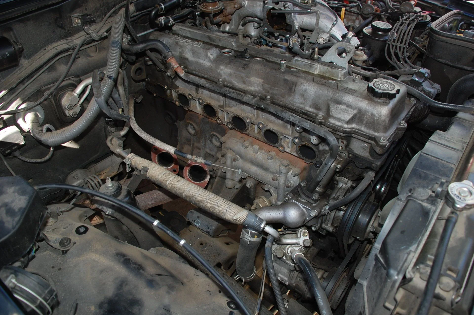

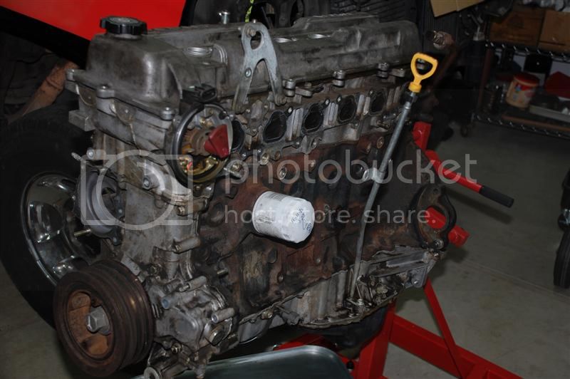

Here's what the engine looked like before I started tearing into it on the first day:

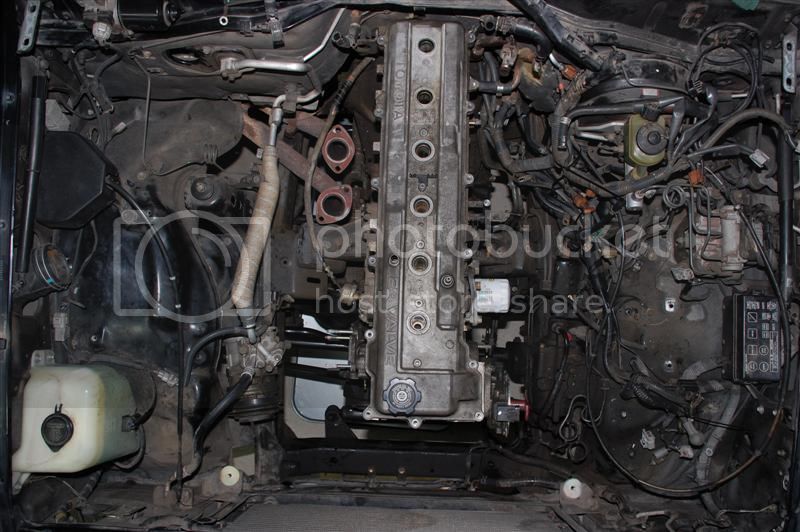

I pulled the exhaust manifolds:

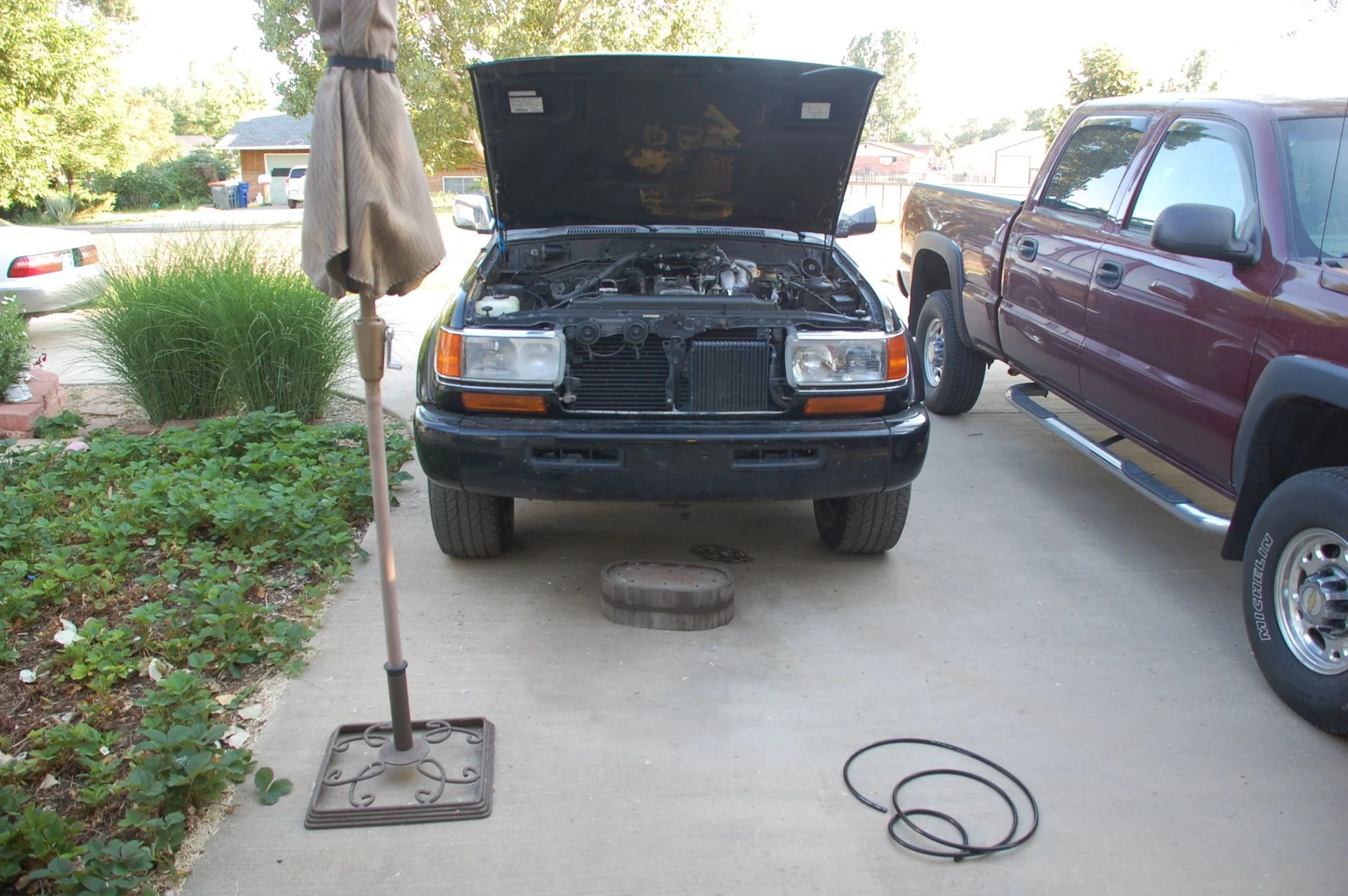

Working in the driveway in the sun sucks:

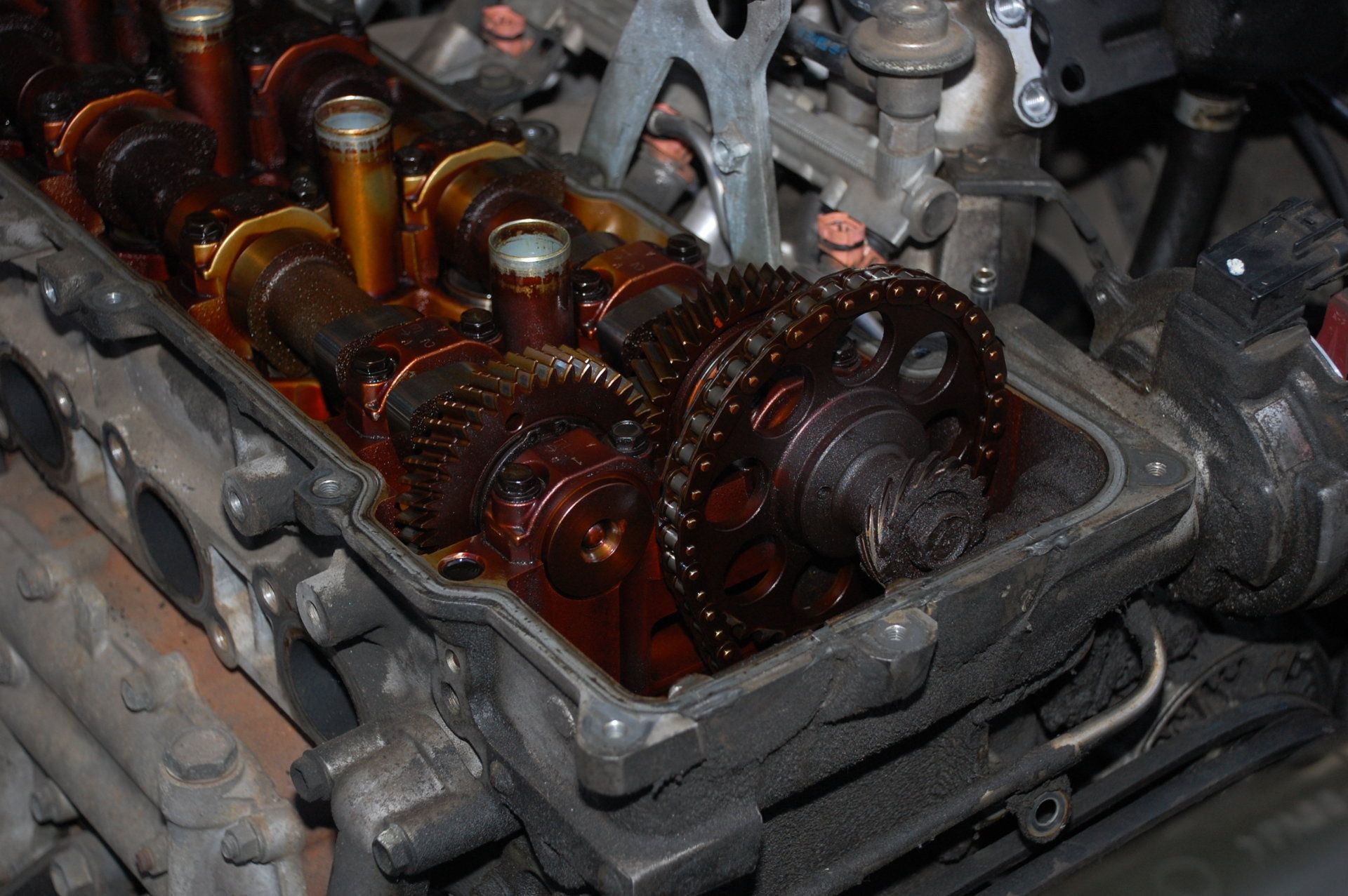

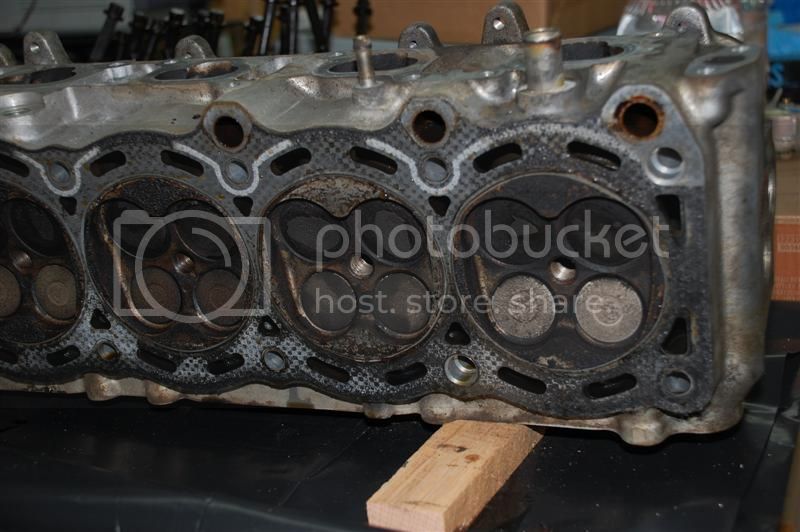

There wasn't any good news under the valve cover, in fact, just the opposite:

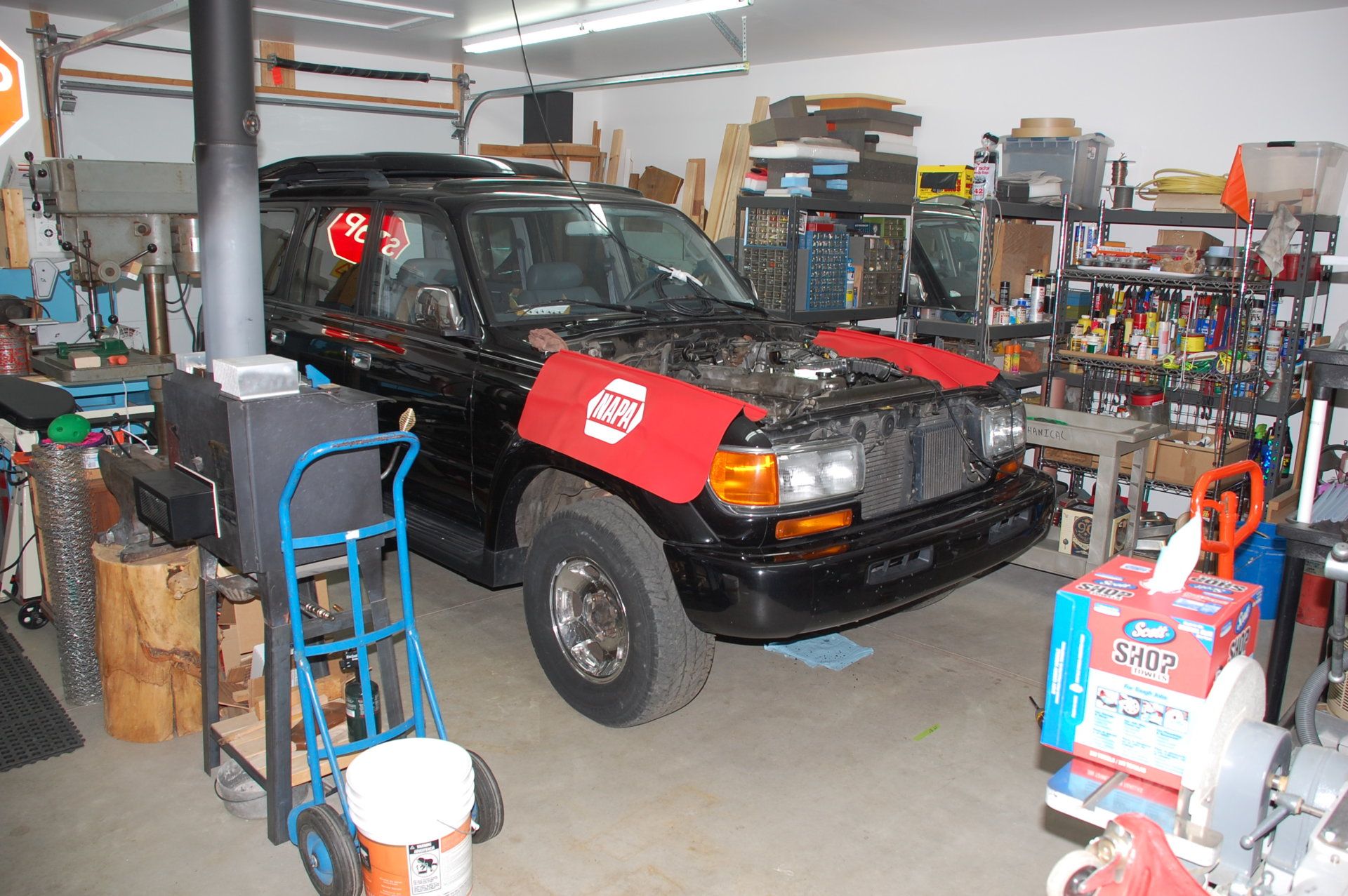

I gave up on the great outdoors and moved it inside. I miss the pinball machine I had to get rid of to make room.

This is with the intake removed, while the engine was in the engine bay. Not a good idea, and definitely not recommended. I was stupid to try this. But I succeeded somehow.

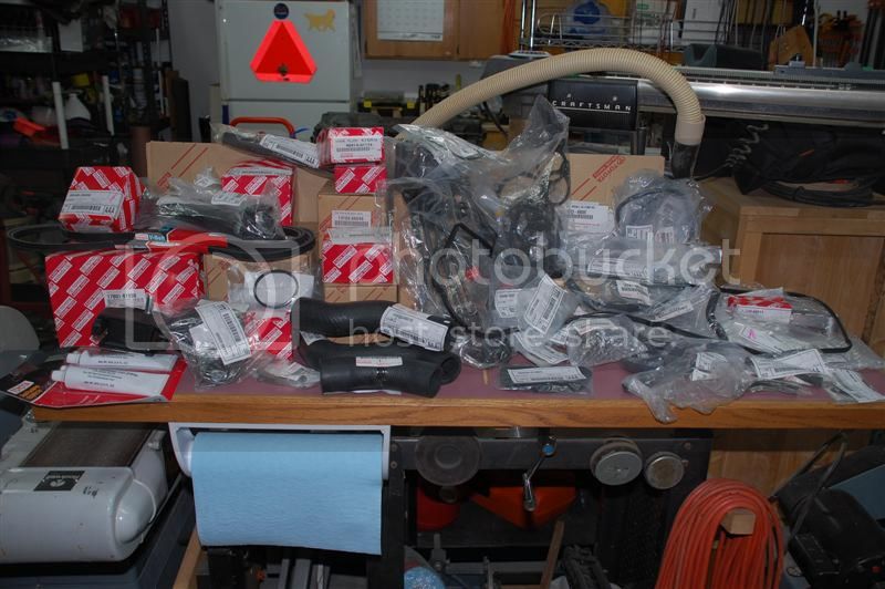

Parts stockpile in the back end:

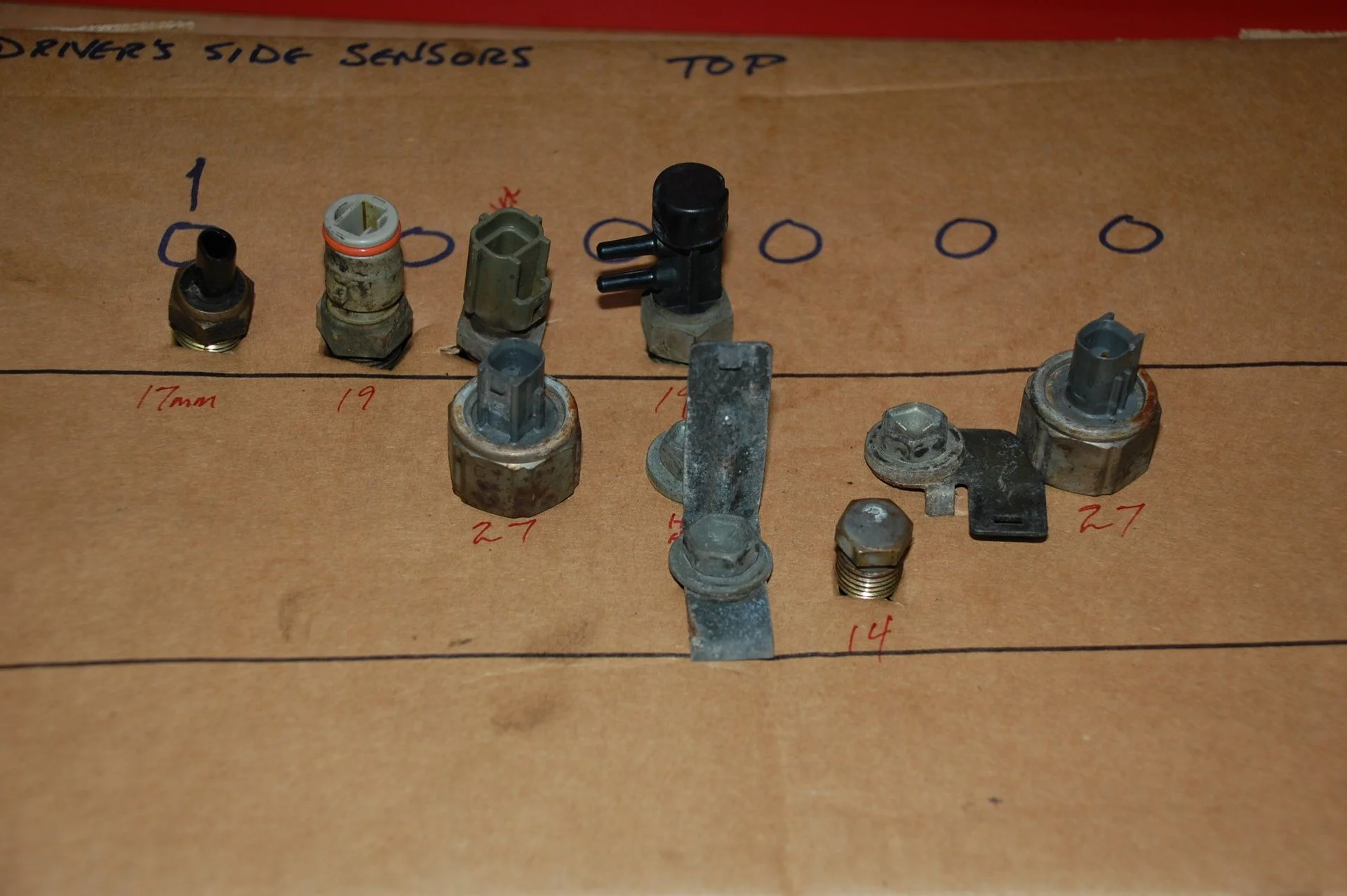

Junk from the left side, poked into cardboard:

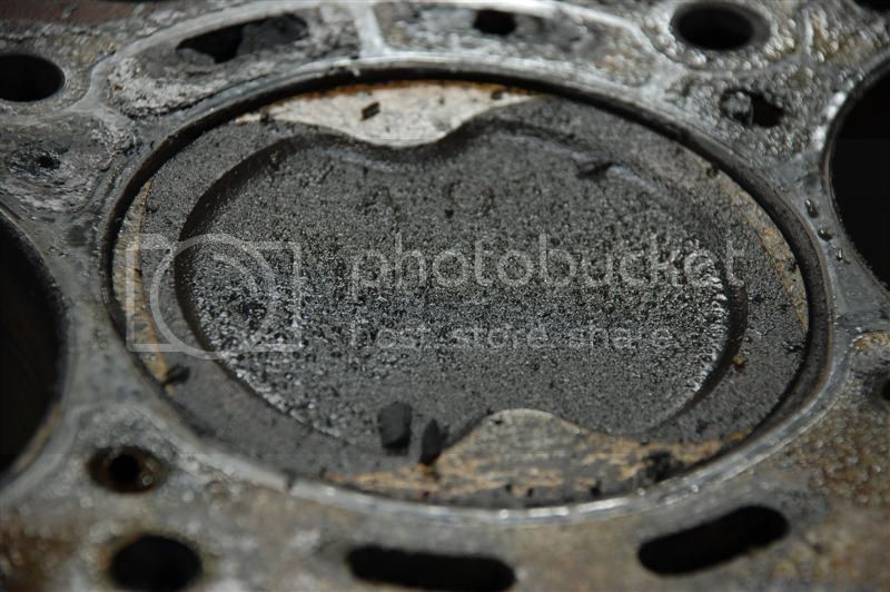

This can't be good (#5 piston was hitting head):

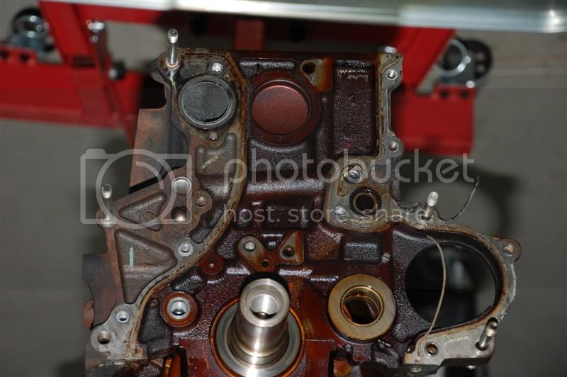

The front end looked about as bad as the rest inside:

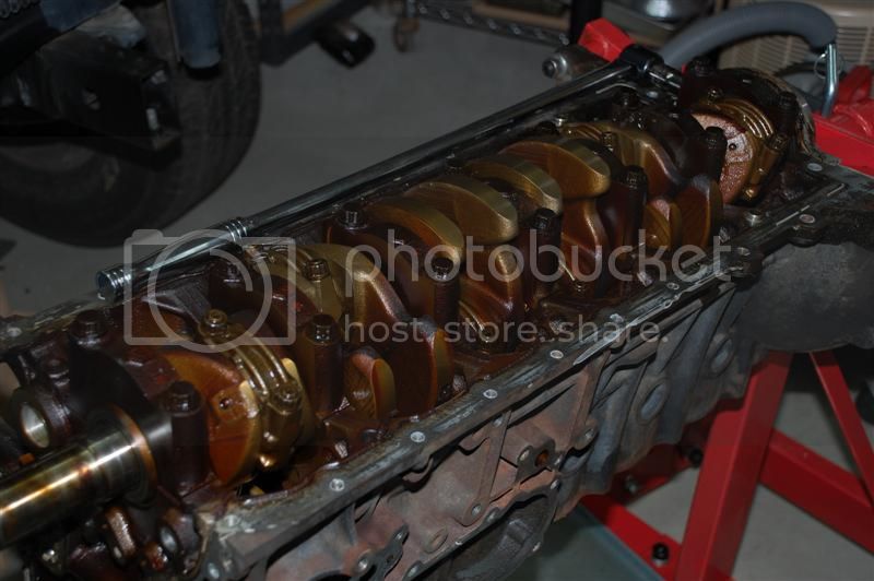

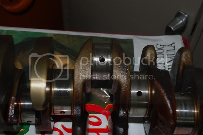

Crankshaft? Yeah, looked bad too. Turned out to be worse...
#5 rod journal was toast, and would not grind in by a mile (got a decent crank from Robbie though, thank God):

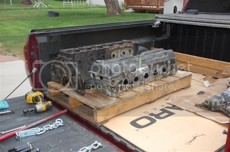

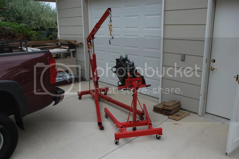

Loaded the engine block to take to the machine shop:
Block and head in the pickup, soon to join all the other parts for the "big ride":

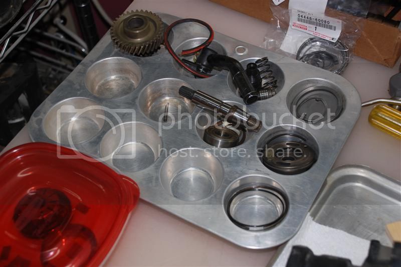

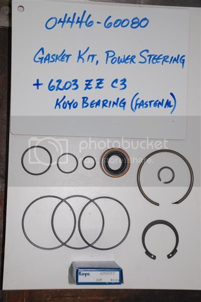

Parts from inside the power steering pump:
Power Steering rebuild kit from Dan:

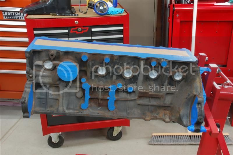

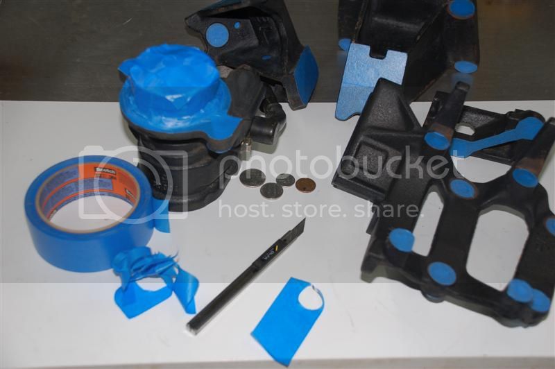

Masking parts for black paint:

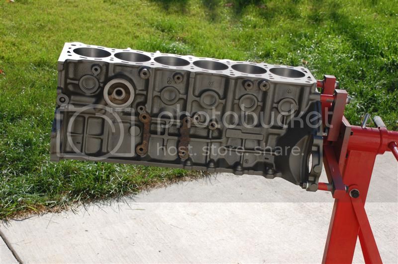

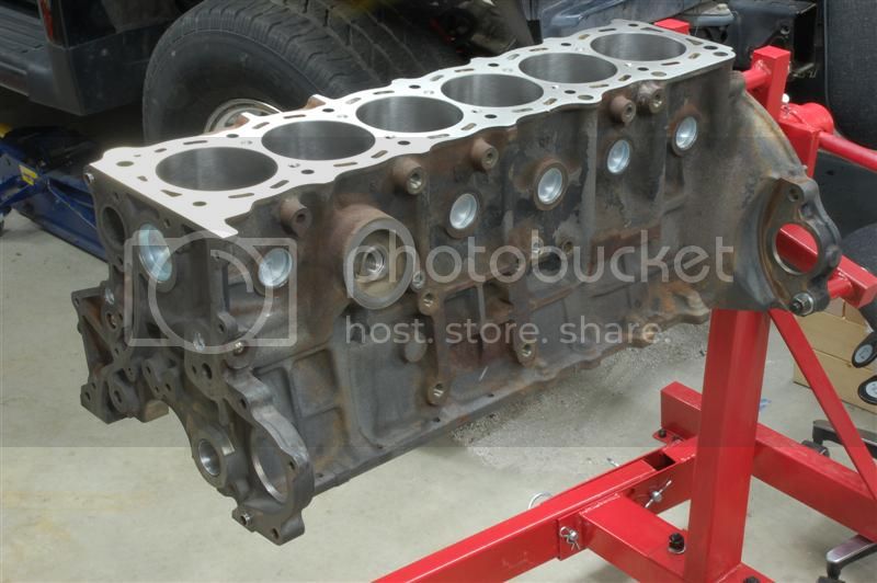

Block ready to mask:

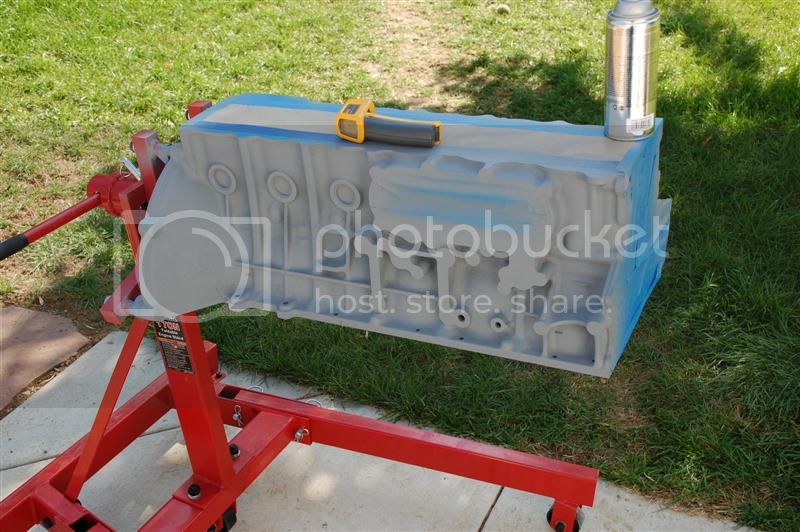

Masking the engine block:
Primered the engine block:
Painted the engine block iron gray duplicolor:

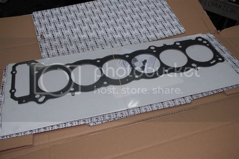

Got my Cometic gasket!

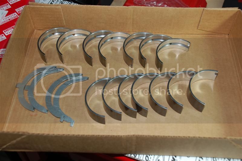

Main bearings:

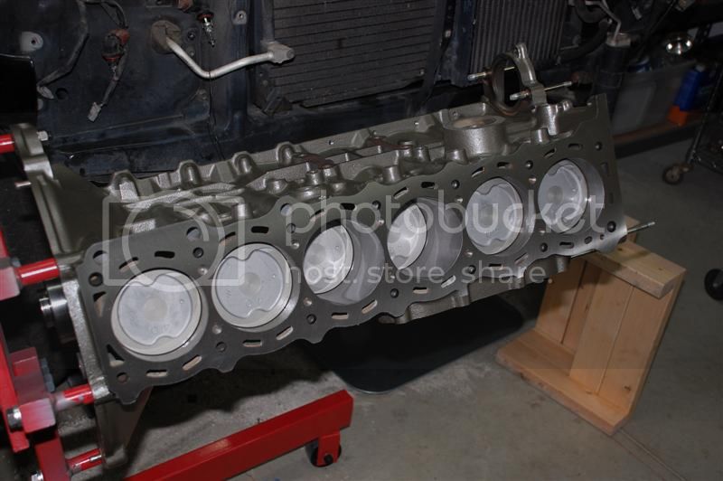

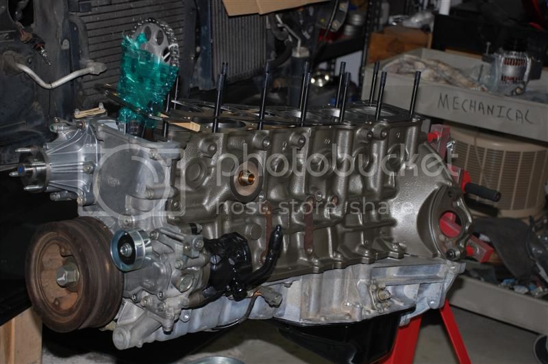

Pistons installed:

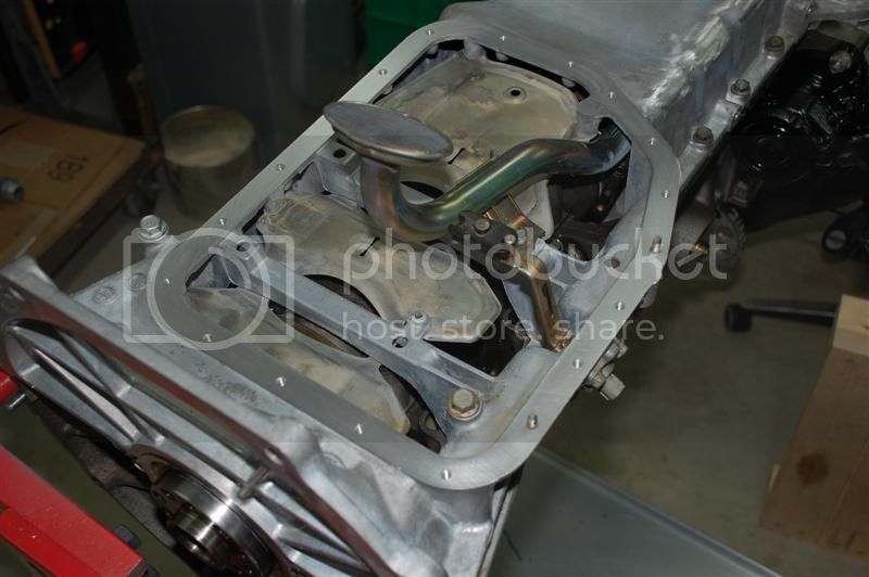

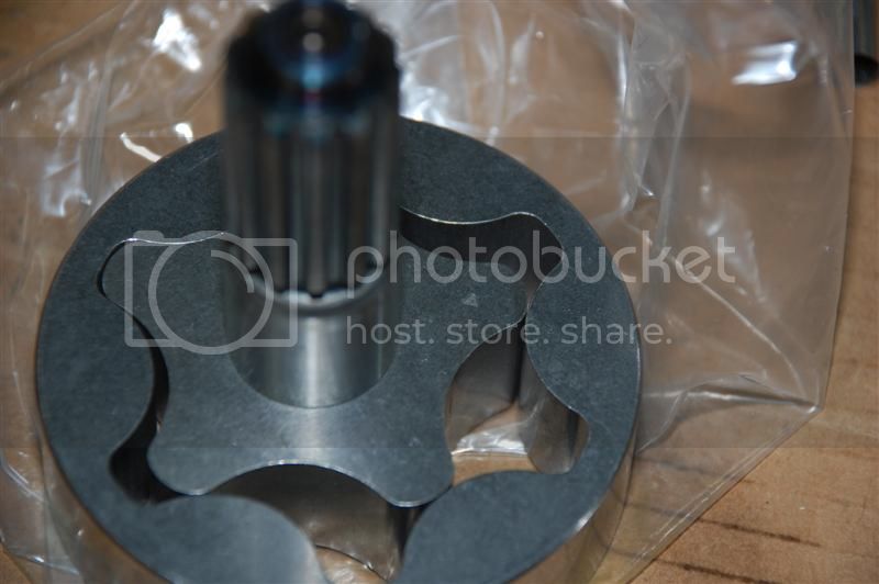

Brand new oil pump:

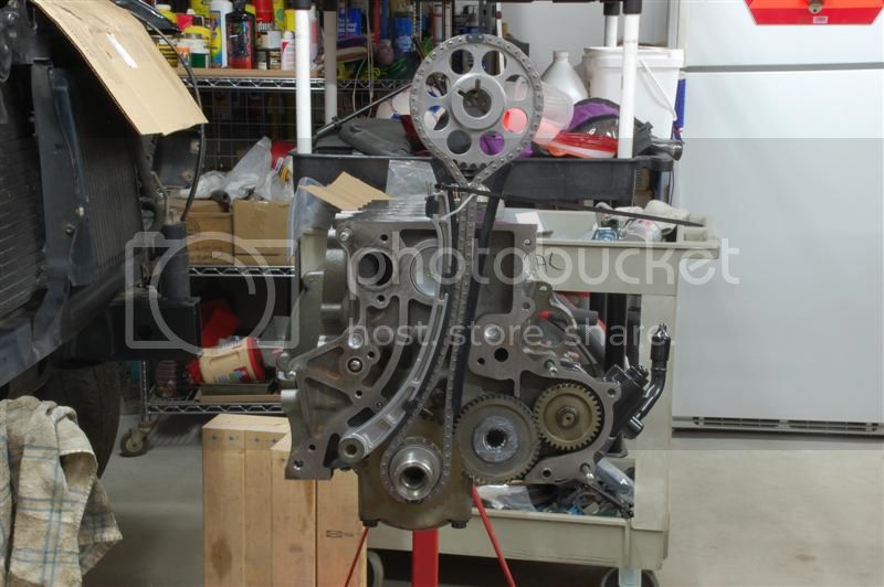

Front end assembly:

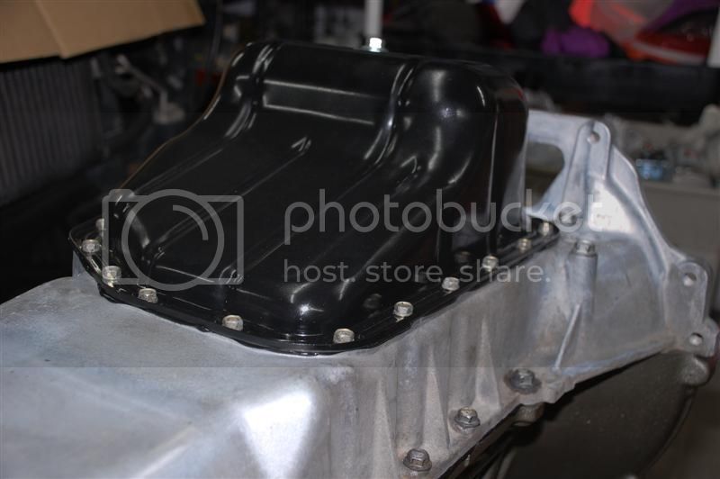

#1 oil pan installed:
and #2 oil pan installed:

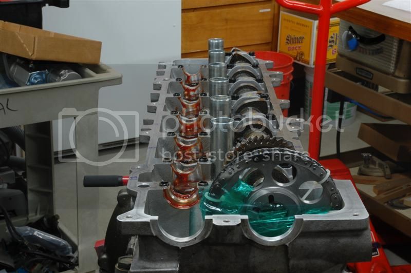

Ready for a cylinder head:

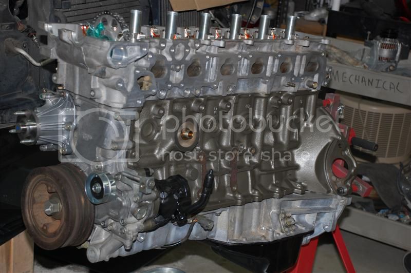

And cylinder head installed:

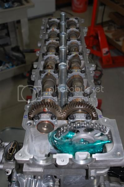

Intake cam:
Exhaust cam:

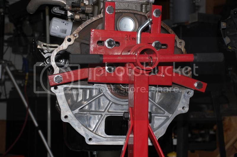

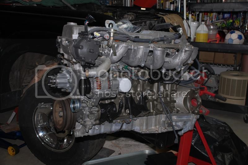

Here's where I centered my engine stand bracket. I looked all over and couldn't find anything for guidance on this.

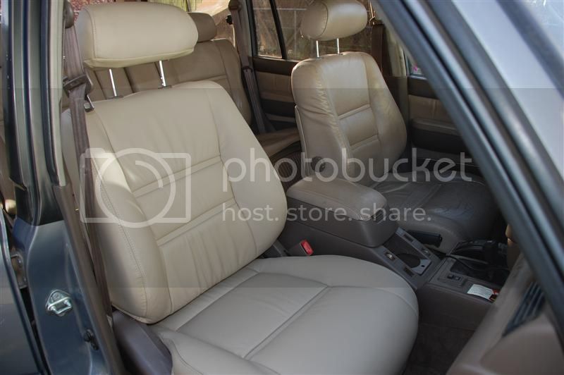

A buddy stoppped by and we did his passenger seat with leather from Shane's kit. We only did one due to time. I'm impressed. I hope to do the same to mine when I get the funds and time.

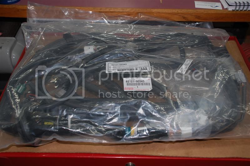

Here's a nice bundle of wire from CDan:

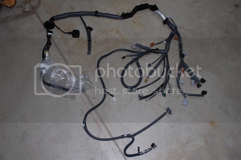

Spread out on the floor:

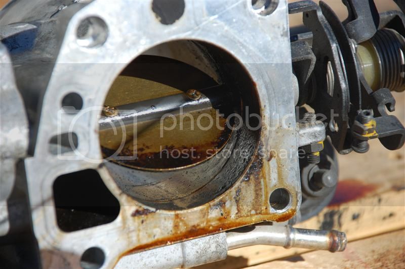

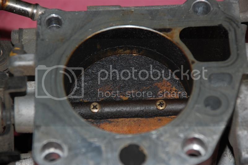

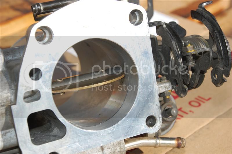

I cleaned the throttle body, it was bad:
But it cleaned up nicely:

looks great man! just out of curiosity what did that harness set you back?
Trust me fellas, this motor is going to be fantastic. It was my seat he helped (did nearly everything) me with. Jim is one of those guys that has every tool and is incomprehensibly thorough.
I can't wait to hear this baby fire up. But he has more leather to install ;)

RJ82, the new harness was around 450 from CDan.

pmccumber - I'm pretty sure your leather will be installed before this baby draws her first new breath. Now that you know how, you can do the work while I watch next time! I'll make sure you actually get the hog rings around the right pieces... :D

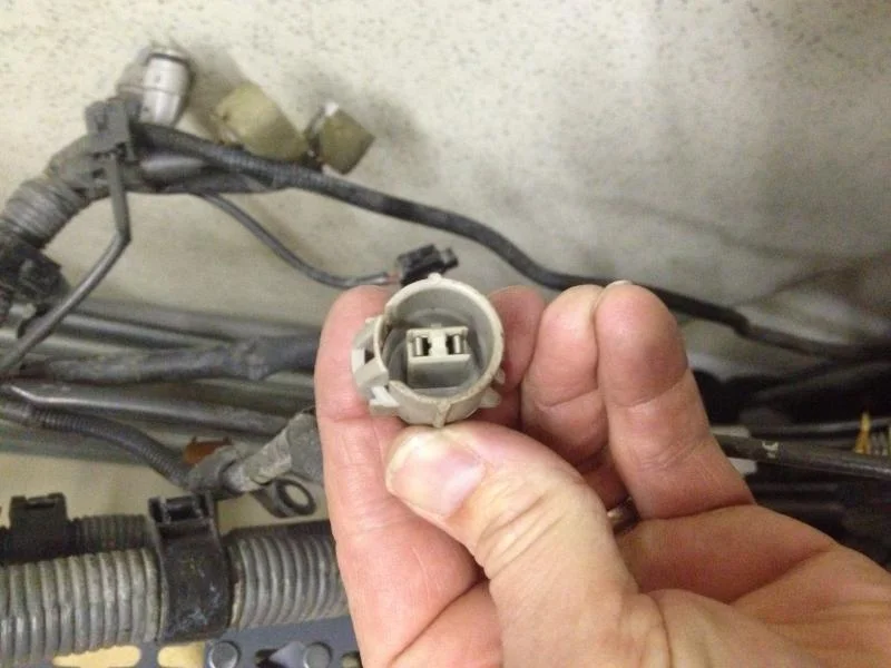

Every housing on there available except this one, can't find it anywhere.
It is the thermo switch on the side of the head. Not sure if OBDII trucks have it.
If you go to the 2nd pic on post #3 above, is it the sensor on the upper left?
