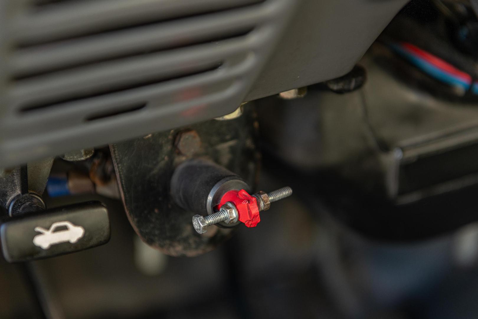

Images are attached. I'm showing the dash area where wires have been sort of jammed in. Also there's some rust on the frame I can see behind the tire. This thing is is North Carolina and I'm in Oregon. There's a good chance I would buy this without seeing it in person, I've never considered doing anything like this before and am for sure nervous. Any input or warnings here are appreciated!

2) cables on the Troopy are always jammed back there behind the radio, it's super tight on the metal-dash 70-series
