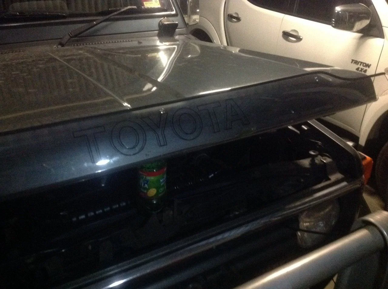

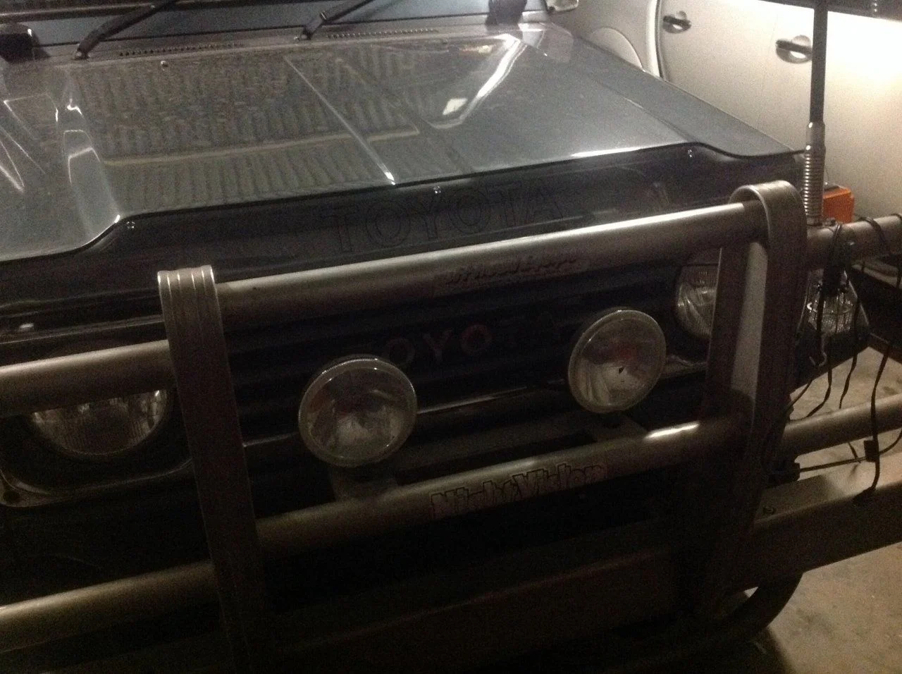

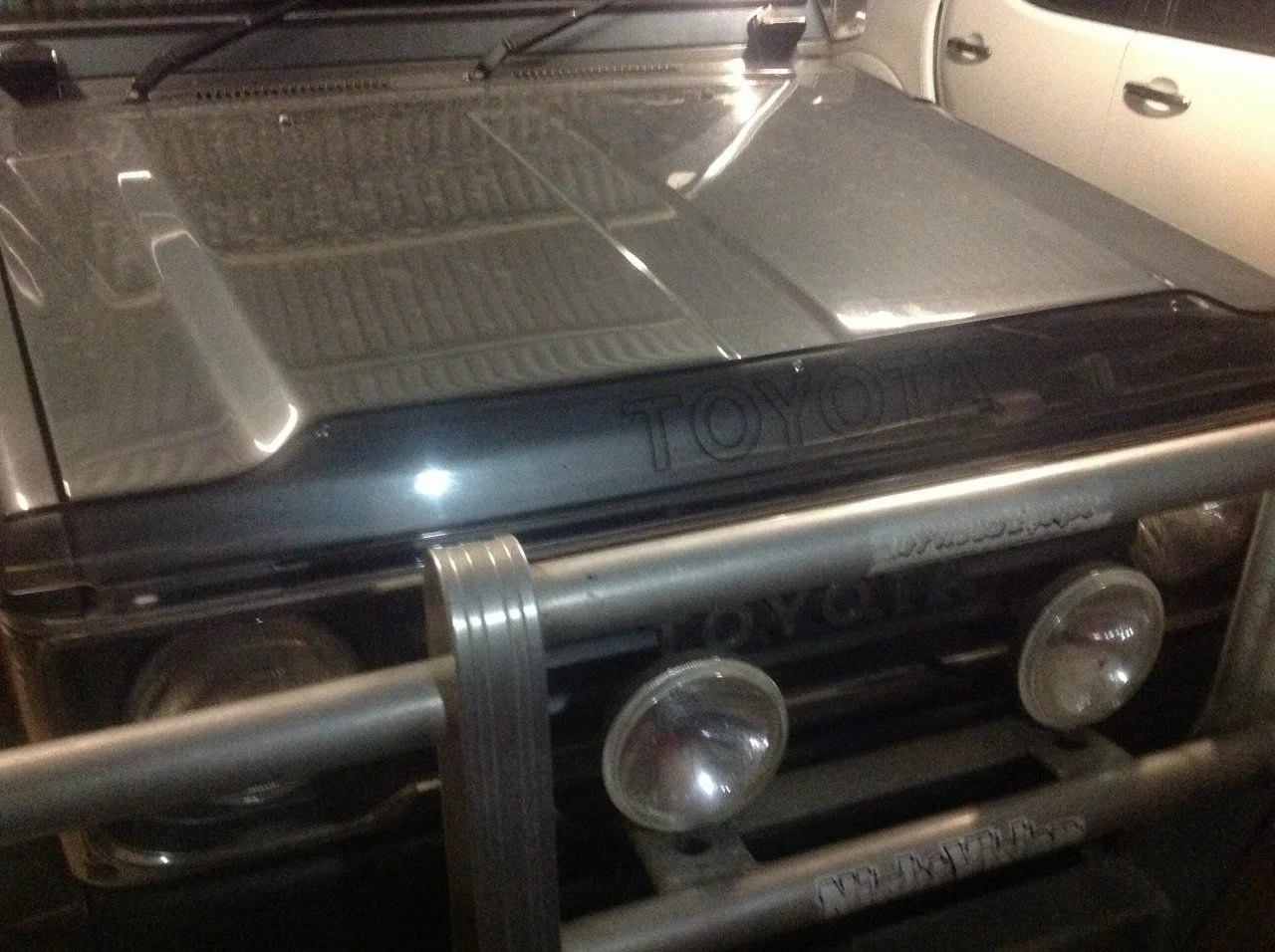

Unfortunately it seems you can buy a Cruiser easier than you can find a bonnet protector. I've been trying to find another one for nearly a year.
If you guys are prepared to ship from oz there is these ones available, clear OEM $120 AUD + shipping, let me know if interested I will organise for you
I agree. Might have to go with the 3M mask instead
Unless a vendor is willing to bring them into the U.S. in bulk thus spreading out the shipping cost, the final cost would probably be more than the average owner is willing to pay.

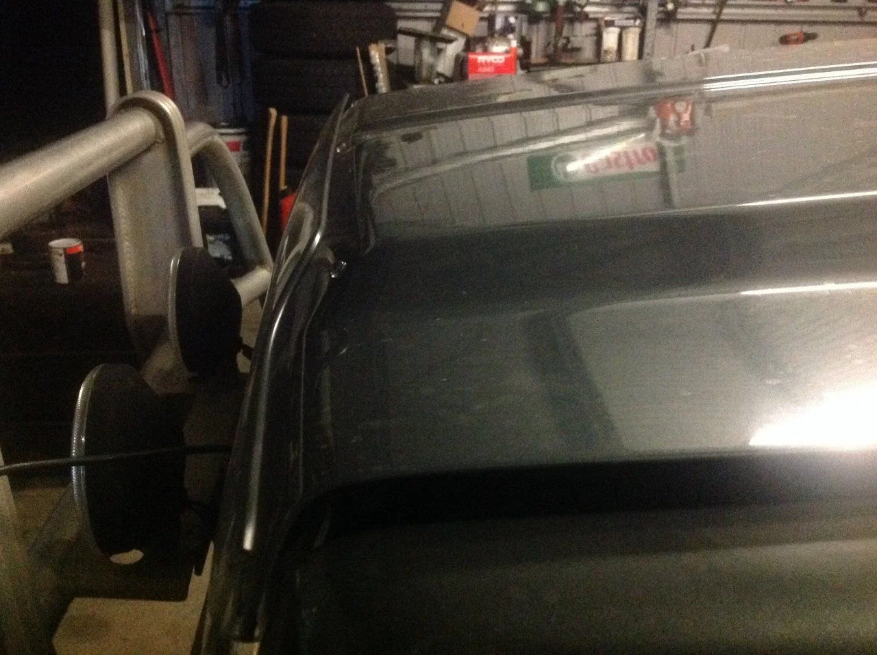

BTW i came across one of those Oz units, tint with LAND CRUISER in white across the top when i was cleaning up.
i REALLY like them.
I have one on little red and it does the job BUT make sure you add extra rubber bumpers as it does flex when driving and can wear through the paint.

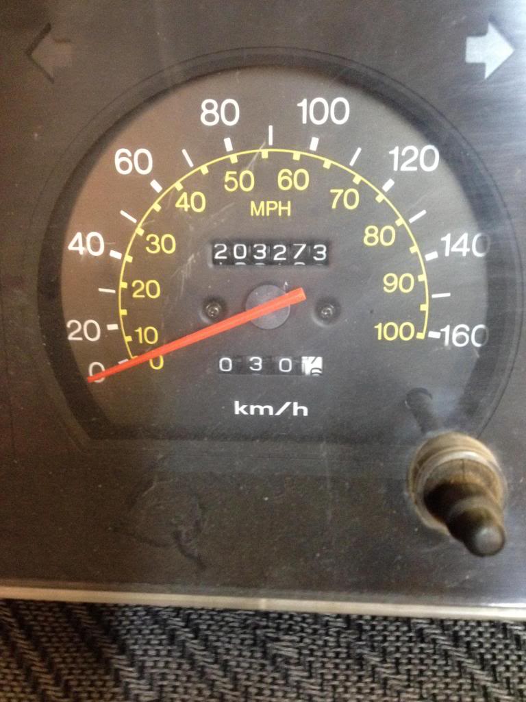

Does anyone know if that Canadian speedometer face can be purchased separately and, if so, have a part #?
No. It was serviced as a complete head only. Discontinued long ago.
If it is a matter of getting MPH on your speedometer, there are several companies that do custom gauge faces. I can't recommend any but here is the first one to come up on google. These aren't overlays but rather replacement components.
http://www.blackcatcustom.com/
