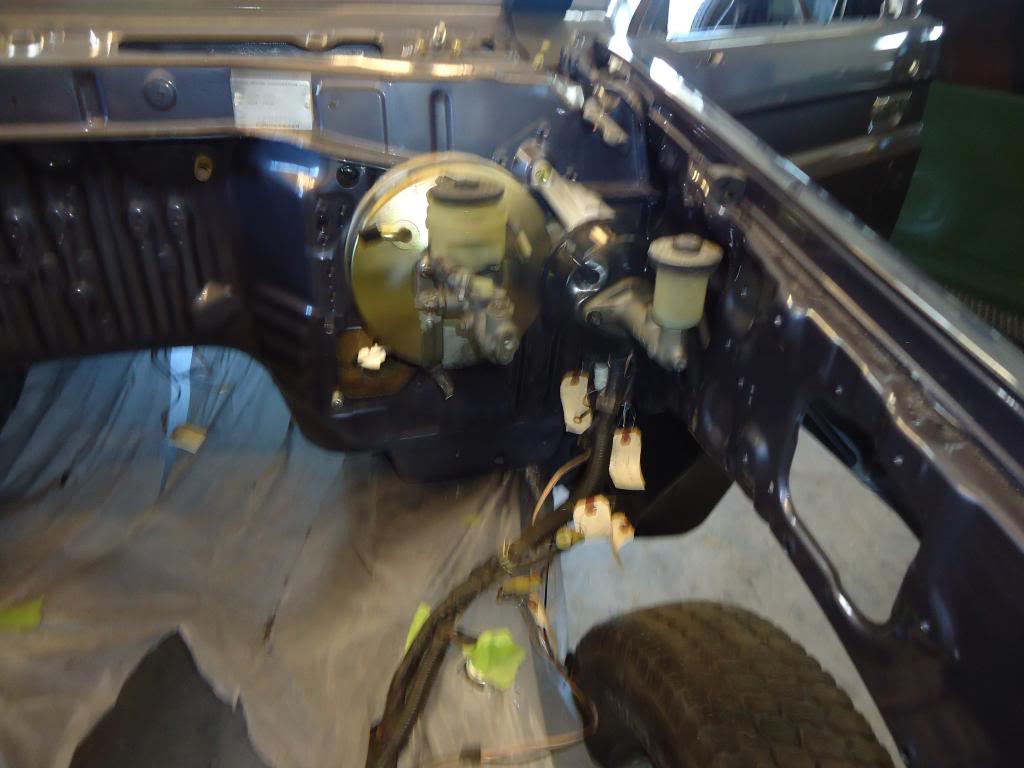

Got the pedals and boosters in.
The order for this is:
Brake Booster
Brake pedal
Clutch pedal
Clutch booster.
Any other order, and you take them out and start over. I did it different, and ended up taking things out more than once! Experience!

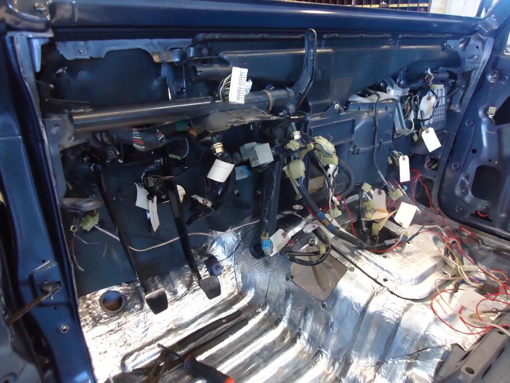

I finished most of the interior wiring. Under dash, the only wires I had to lengthen were the filter and preheat lights. I will post a pic when done. Still deciding on the radio, gauges
For the rear, I lengthened the harness just before the center heater and parking brake wires came out of the loom. Added 6 foot to get the rear wiring back onto the right side. This worked best to get the rest of the rear loom where it needs to be. Still trying to figure out the trailer wiring. A diagram would be very helpful!
