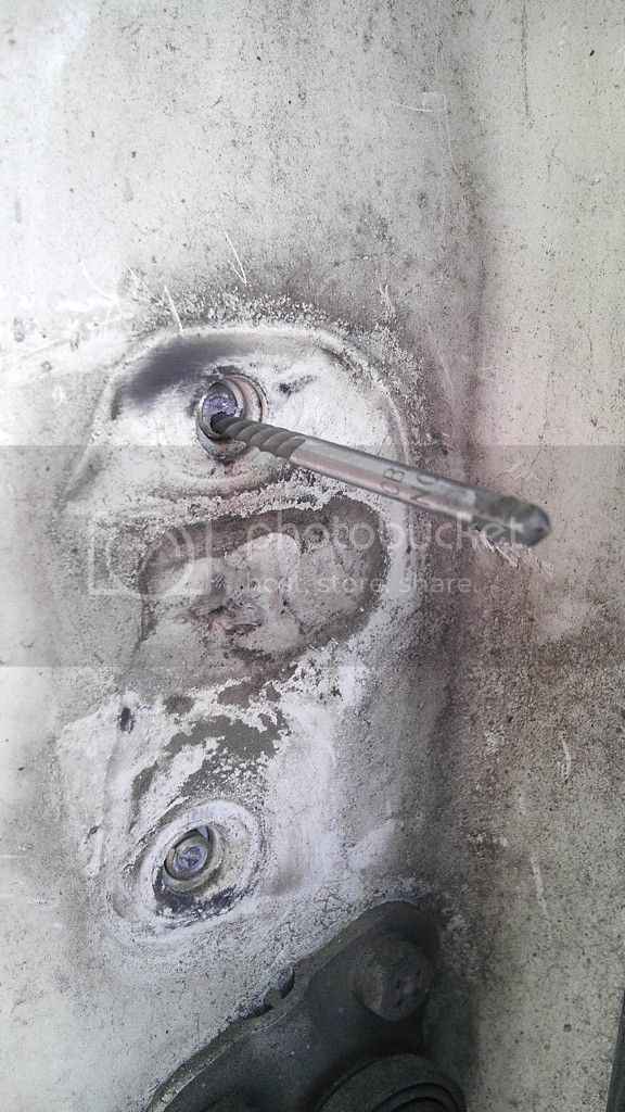

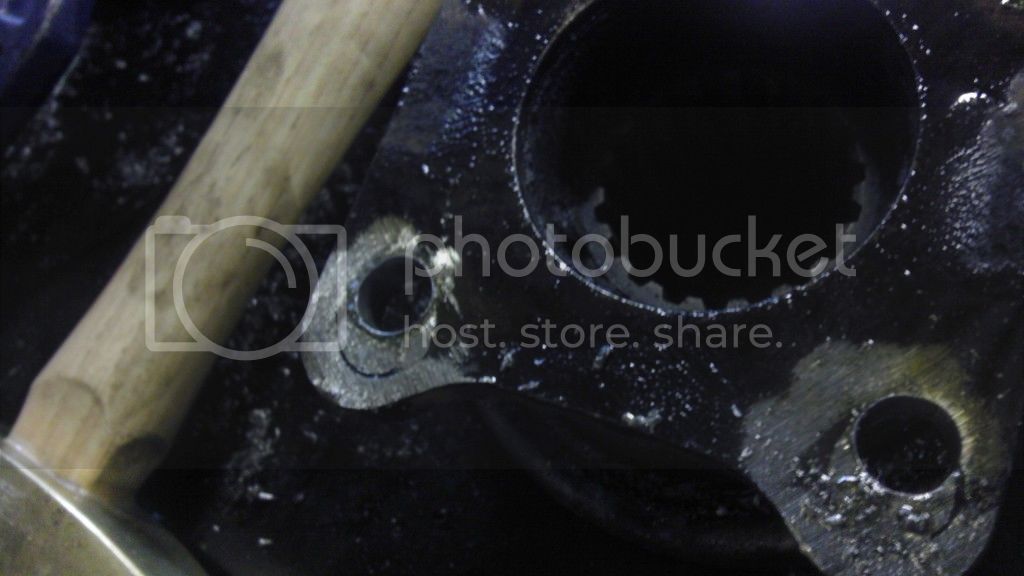

Well I managed to broke both bolts off the tail gate latch while trying to adjust it. So I had to drill it and use a out, easy enough. Then we built my front driveline and that was a bugger! first off the t-case flange and diff flange where both different. The splines were the same but the diameter on the outside was squashing my seal so I just fill welded my holes and then re drilled them to fit the mini truck ujoints.
... that took almost all day it was just one thing after the other, not my day:bang:. But we measured for length, cut, welded and its over now blah.:clap:

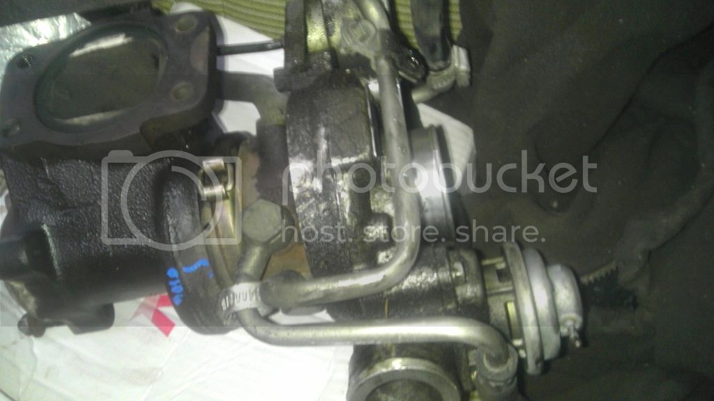

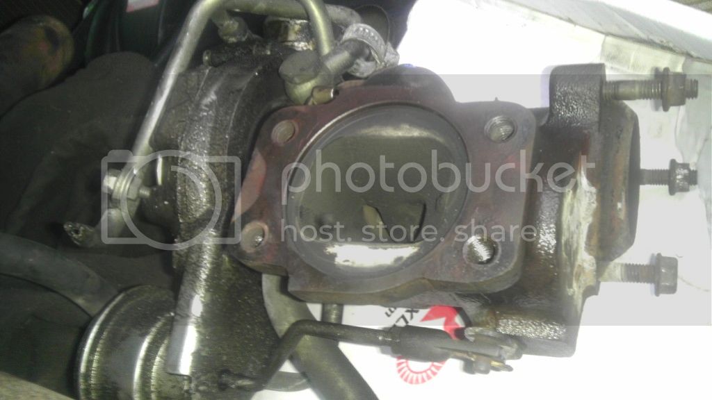

I also picked up this bad boy at p&p I just couldn't help myself. So there will be a turbo manifold build coming soon :cheers: go fast!:steer:

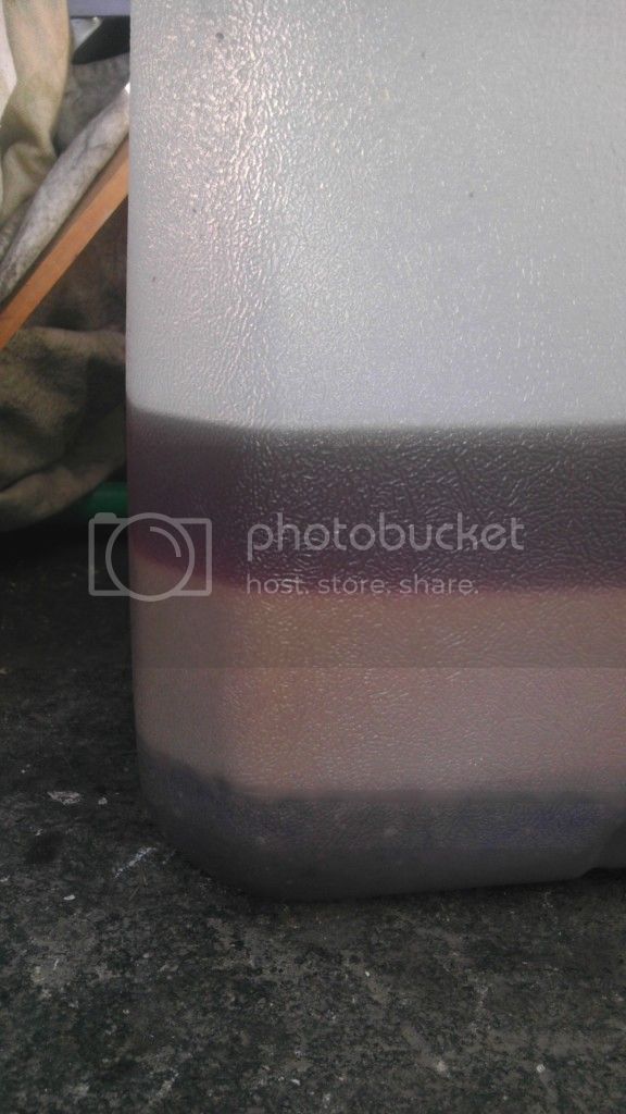

Here is a good (random) example of some wvo oil separation. Water on bottom animal fats and water in the middle, and pure (well not yet) energy up top. That was left in the sun for a couple days and its one of my drag cubbies. It takes maybe 7-10 drags from cubbies to fill one up then I poor off the top. That one for sure started with water in it though.
Some one seriously tried stealing them!? Thats horrible, and right out side the junk yard? He's got some serious cajones on him! But I digress...what kind turbo did you pick up!? I'm excited to know more!

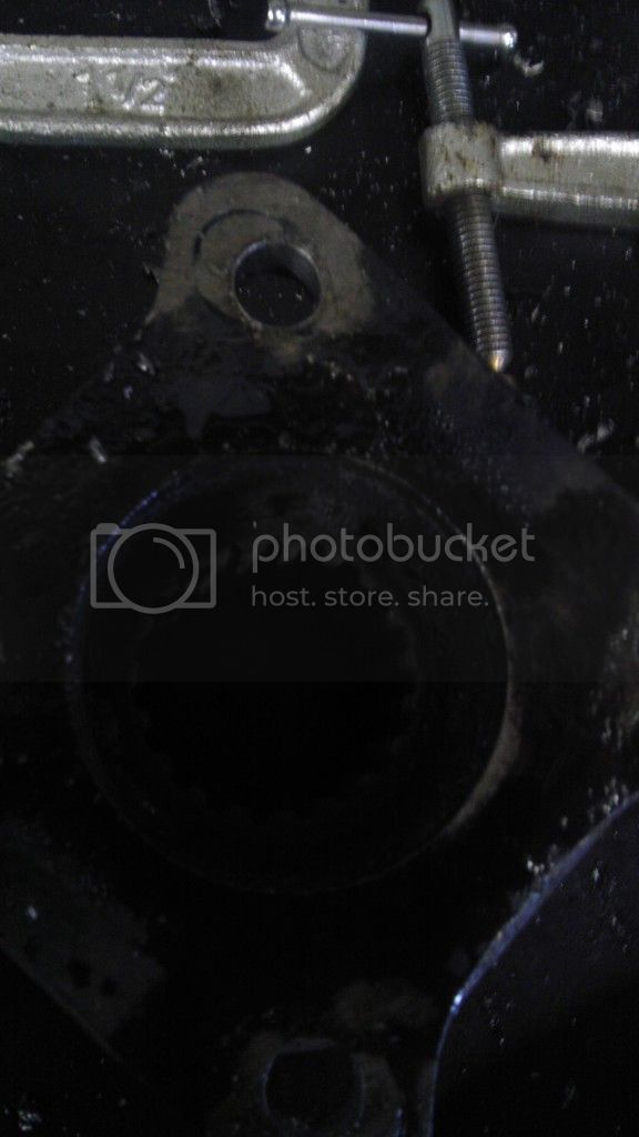

The turbo is a Mitsubishi td05-12b with a 6cm (41ish maybe 45ish) a/r. There is no map for it unfortunately but the compressor is good for about 350cfm @14psi so I think I figured it will start dropping off at around 3000rpm which is where I shift max usually. I hope it will work good in low rpms like I want it to, I will have to do some work on the waste gate. Everything seems to be set up perfect already though nice big oil drain right off the bottom I won't even have to clock it, and its water cooled as well! Seems like everything lines up just right.

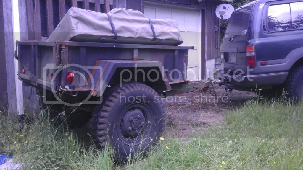

Man, I also forgot about this, A fellow mudder from our club sold me a rtt and gave me a m101 that has a partial build of a m416 look done to it. shouldn't be to hard to finish up. The trailer has the same STA super lugs I have on my truck to, what a score. Thanks Yovahos

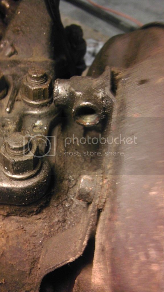

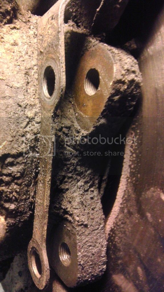

Well if you have done one before you know its a messy and somewhat drawn out maintenance. My lower turning bearing was stuck on the lower cap freaking wailing on that thing with the drift finally got it loose. everything else was going great until my front right brake caliper wouldn't tighten up. Resized it was striped out and judging by the surface had been lost for some time. How the heck someone strips out 3/4" of 12mm threads I have no idea. Then the brake hardline snapped. blah, ah well I picked up new hardline and tap as well as soft lines that looked like they were about to burst. A new bolt and I will be good as new I hope.
this is where the hardline broke

Air tools... that's how they strip out that much thread. I can't tell you how many times I've run across it on my stuff or someone telling me about it. They think they have the bolt started and grab the air wrench or impact...

I know, you are right! I should have just taking the time to throw some 4runner calies in but we are tight on money. Last pay period I only had 35 hours... for two weeks.

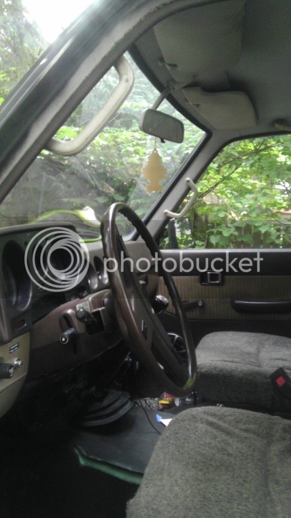

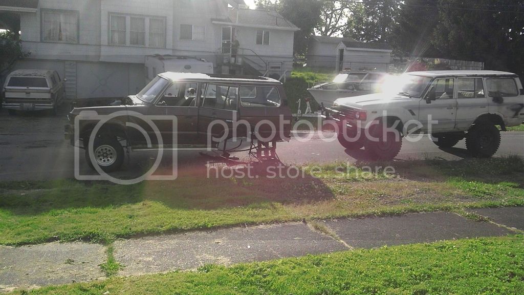

My little 11 y/o brother was with us for the weekend so he had his first :wrench:ing session. My pops doesn't do much with him so we called it early and went fishing. But before that I finally grabbed and used the rivnut gun today, man those things are awesome! Thanks J for that. I did mine and hers grab handles mostly to help her get in. She says she wants another one up higher too, luckily I have a few more but it will end up being kind of crowded looking but hey whatever the :princess: wants ;)
I also got rid of old rusty finally, she had been sitting in the back yard and now that we are renting that house out I figured we had better get rid of her. I think I took her for most everything she was worth, except the manual steering box, kind of kicking myself for not grabbing that. got almost all the glass, and I grabbed the front doors for you know what :lol:

farewell old rusty!

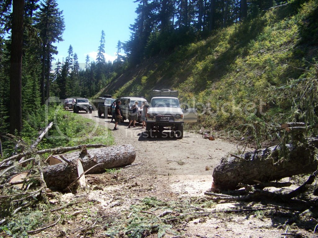

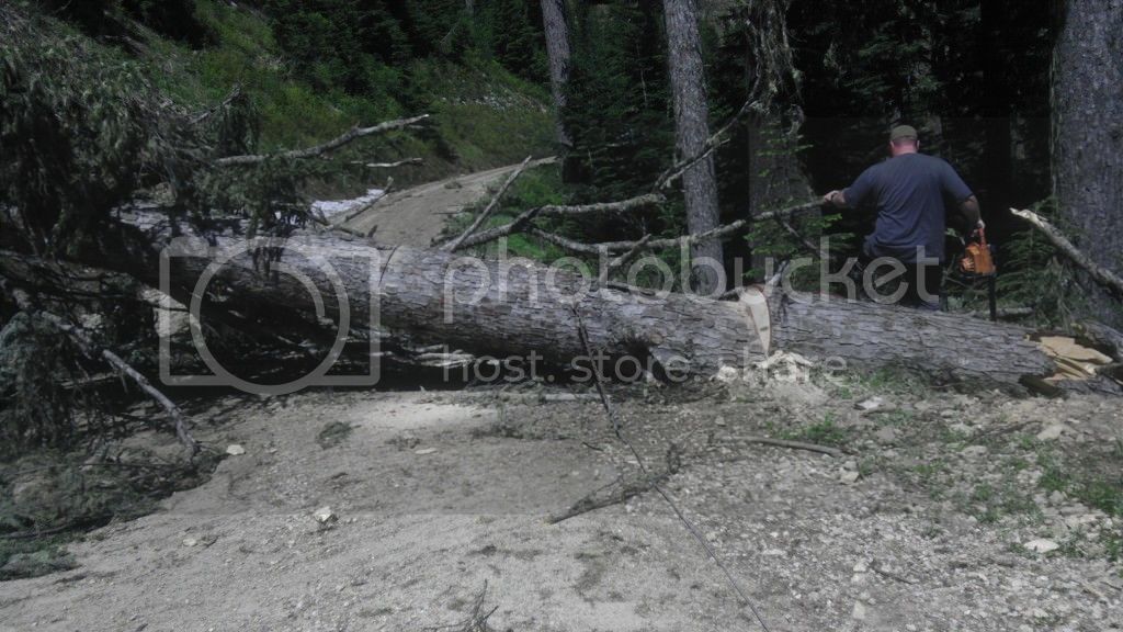

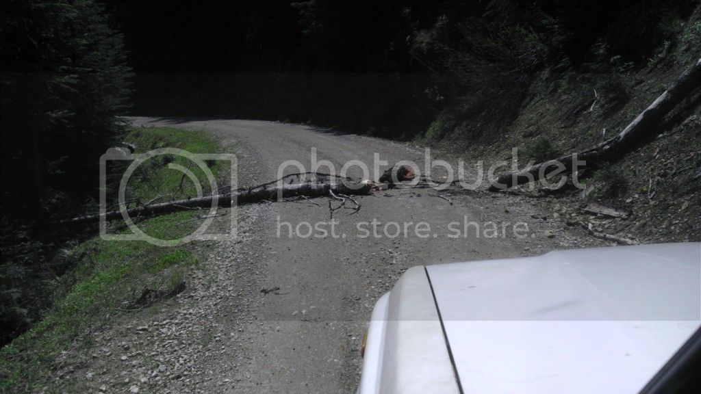

Next weeks camping trip we made quick work of this log to clear the trail.

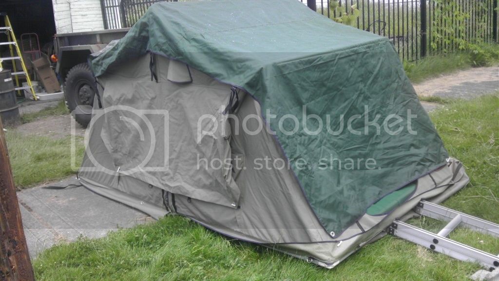

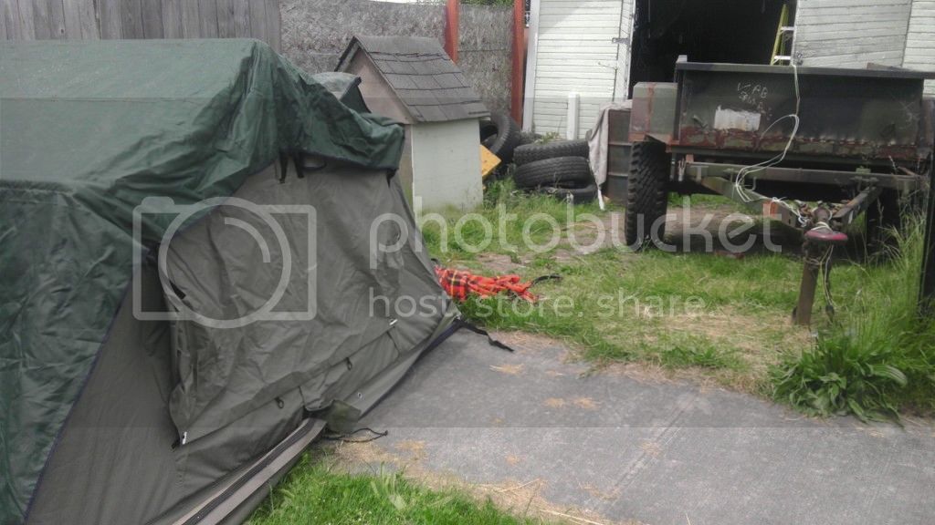

This is about all the work I have done lately, other then temping up the RTT
Not to fond of how the mounts set, but its practical so It'll do, Next on the list is the last chance zombie defense.
Hold me down mike!
We ending up getting followed by some heaps who would have turned around. Little did they know we cut the log just wide enough for cruisers but to skinny for those ungodly heap tires that stick out so far! haha j/k

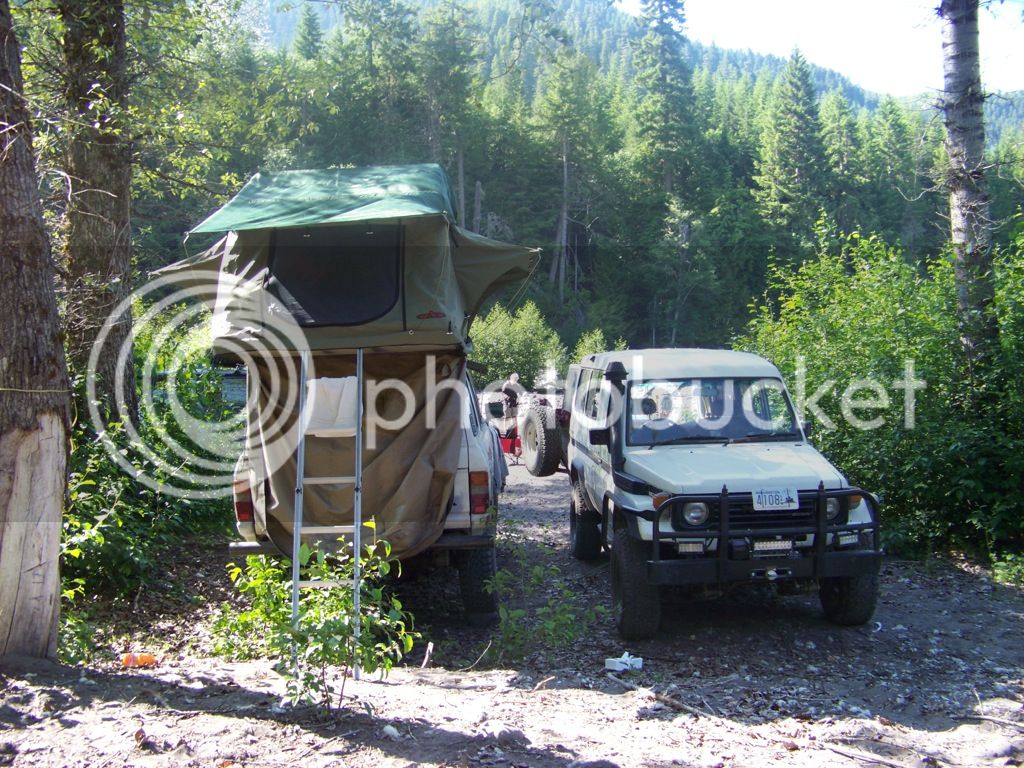

Ah home at last!
everyone getting settled in.
He is a little fish, this kick loves the water! rain, bath, river he don't care.
(this is glacier water too, only a few miles down stream)

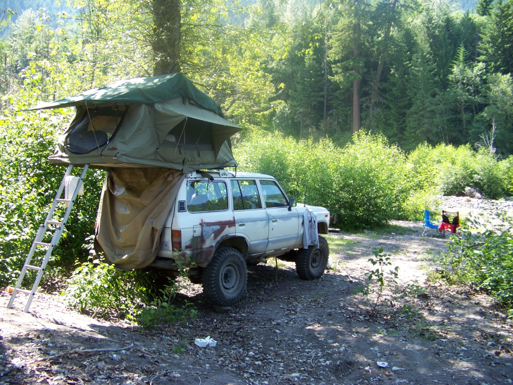

And he loves the RTT!!!
