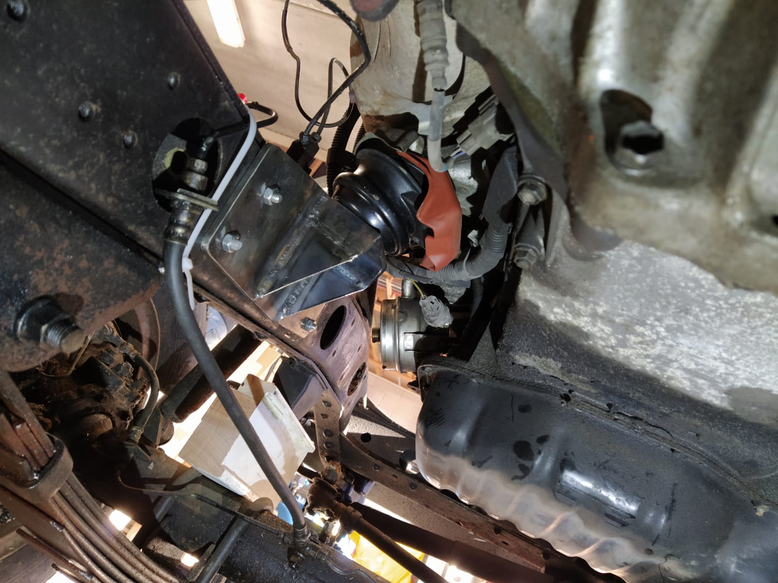

Today I mounted the Transfer case mount. I used the original Toyota rubbers. The mount is made from C-channel and is bolted to the frame with 4x M10 bolts. The distance from Transmission and Transfer case to the body is perfect. You can see the moutn here:

The transmission is tucked up into the framerails. I'll use the original gearbox mounts to mount some underbody protection. The Transfer case hangs below the framerails, I'll also fabricate some underbody protection around the transfer case. You can see the height in the picture below:

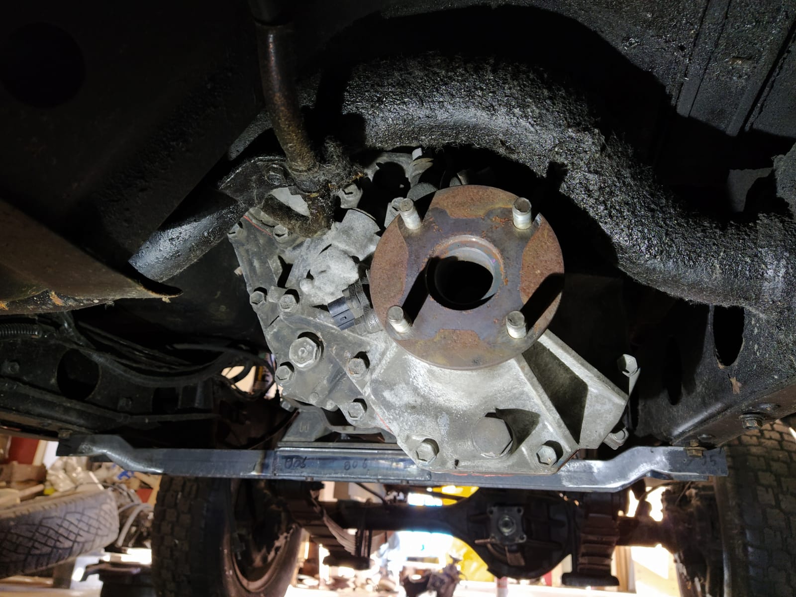

The transfer case rear ouput flange sits nicely in the crossmember:

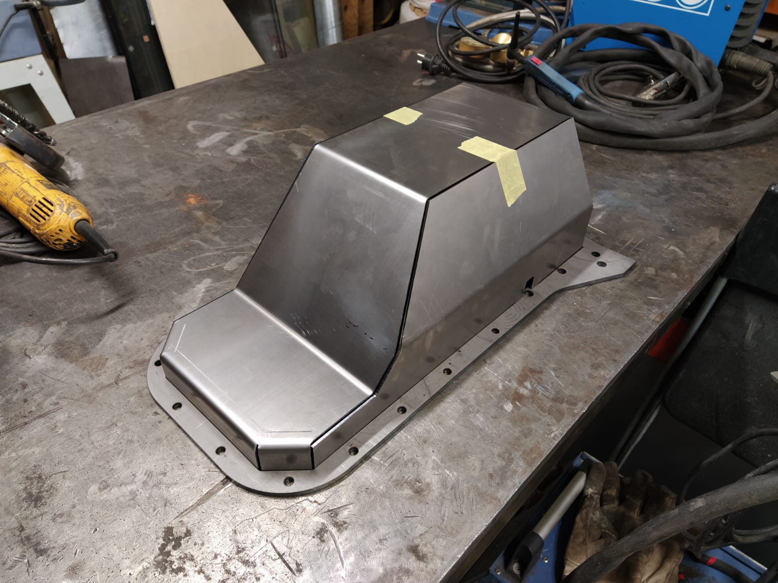

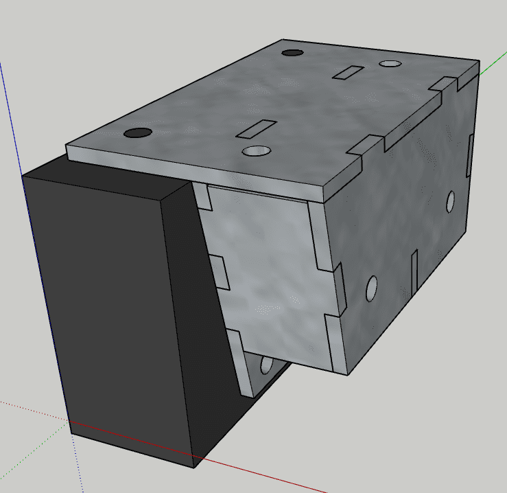

I also finished mocking up and drawing the oil pan. The capacity is increased form 5.5 to 7 litres.
The right / passenger side is angled so the front driveshaft won't hit the oil pan.
The oil pan is sturdy, really sturdy, 6mm steel flange and 3mm plate sturdy.
I still have the drawings and can have another one laser cut (and welded up) if anyone needs one.

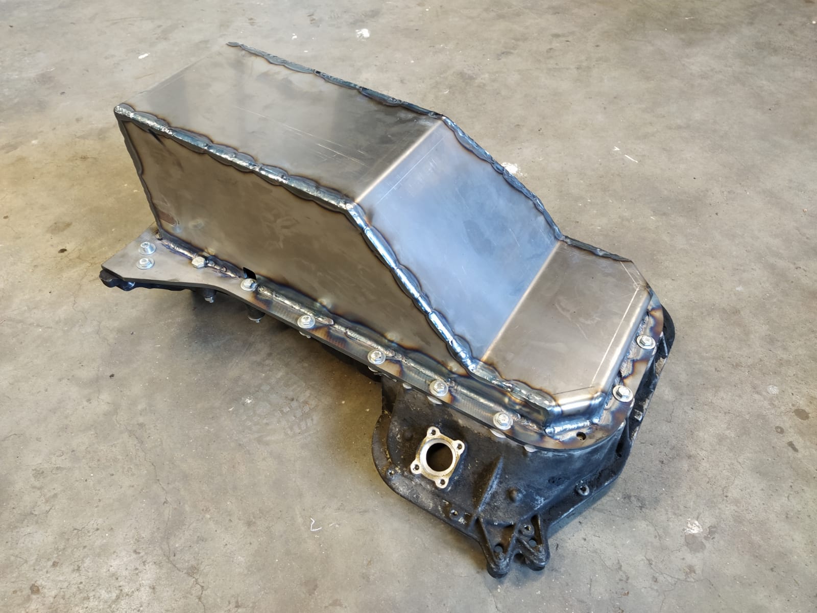

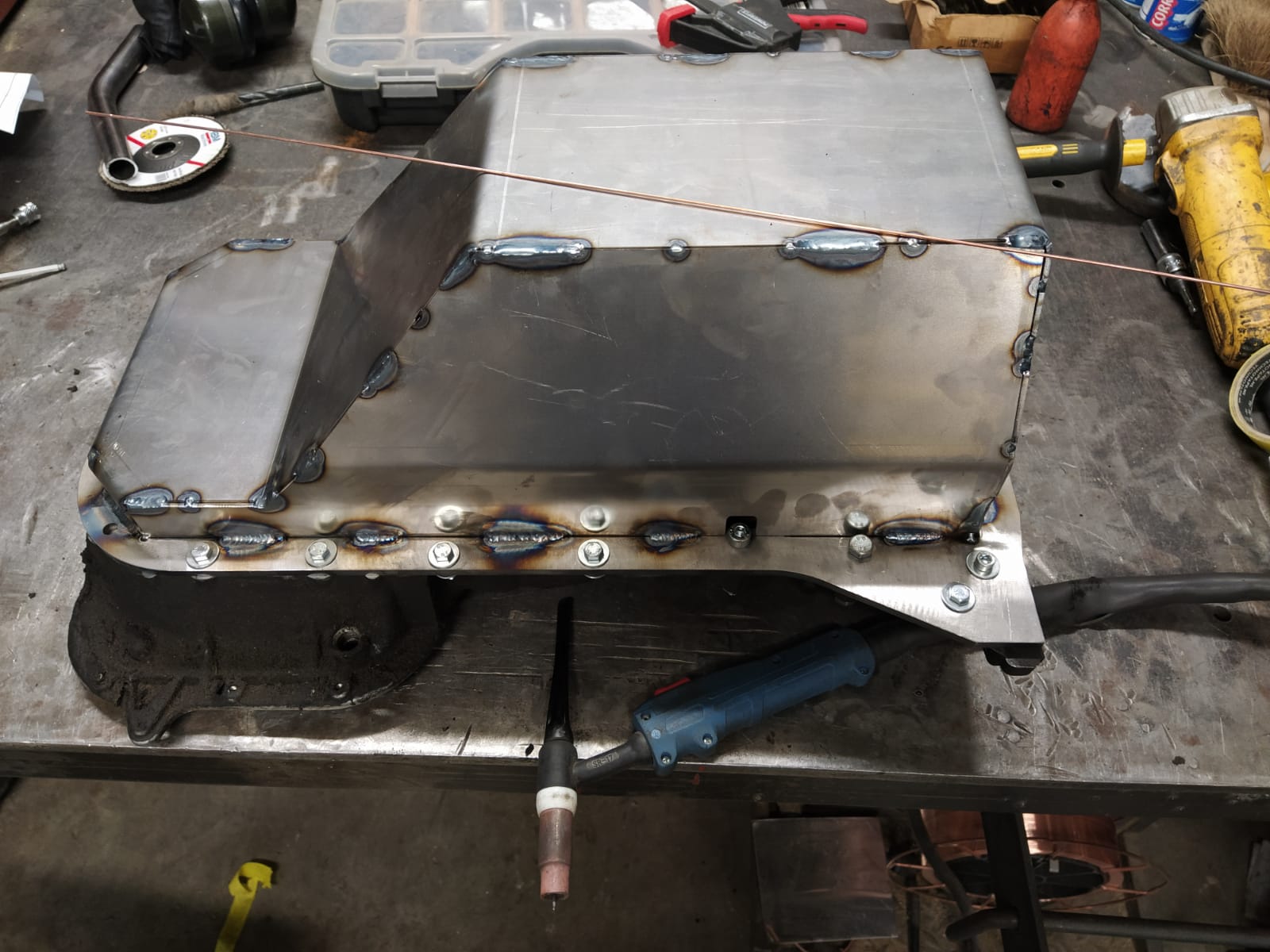

Yesterday I finished welding the oil pan, I bolted it to the old pan to prevent it from warping:
Fisished welding:
Now I will have to install the drain plug, oil level sensor and dipstick.

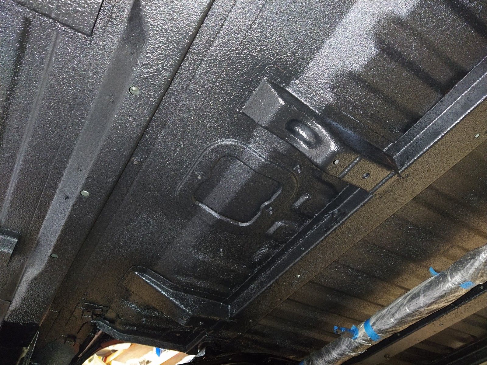

Then it was time to fix some rust in the rear wheel wells. There were some bad repairs form the previous owner.
Some were ok and some were bad. I cut out all the bad ones and put in new sheet metal.
I also found some holes under the sound insulation in the left/drivers footwell. Cut these out and replaced with some nice fresh metal. After that I wrapped the frame, cleaned, degreased, roughed up, primed and sprayed the underbody in a nice coat of black Raptor liner.
The frame and underbody:
Raptor underbody:

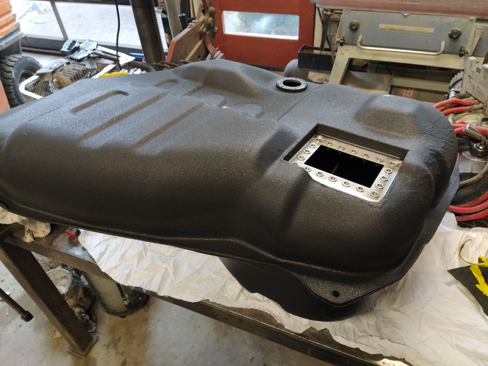

This weekend I finished welding on the fuel tank. I had a 2mm stainless plate cut:
And bend:
Cleaned the tank one more time and welded it in:
Closeup:
Do you think I used enough rivnuts...?
I'll have the top plate cut this week and hopefully leaktest the tank next weekend.

But I did wire wheel and spray the fuel tank:

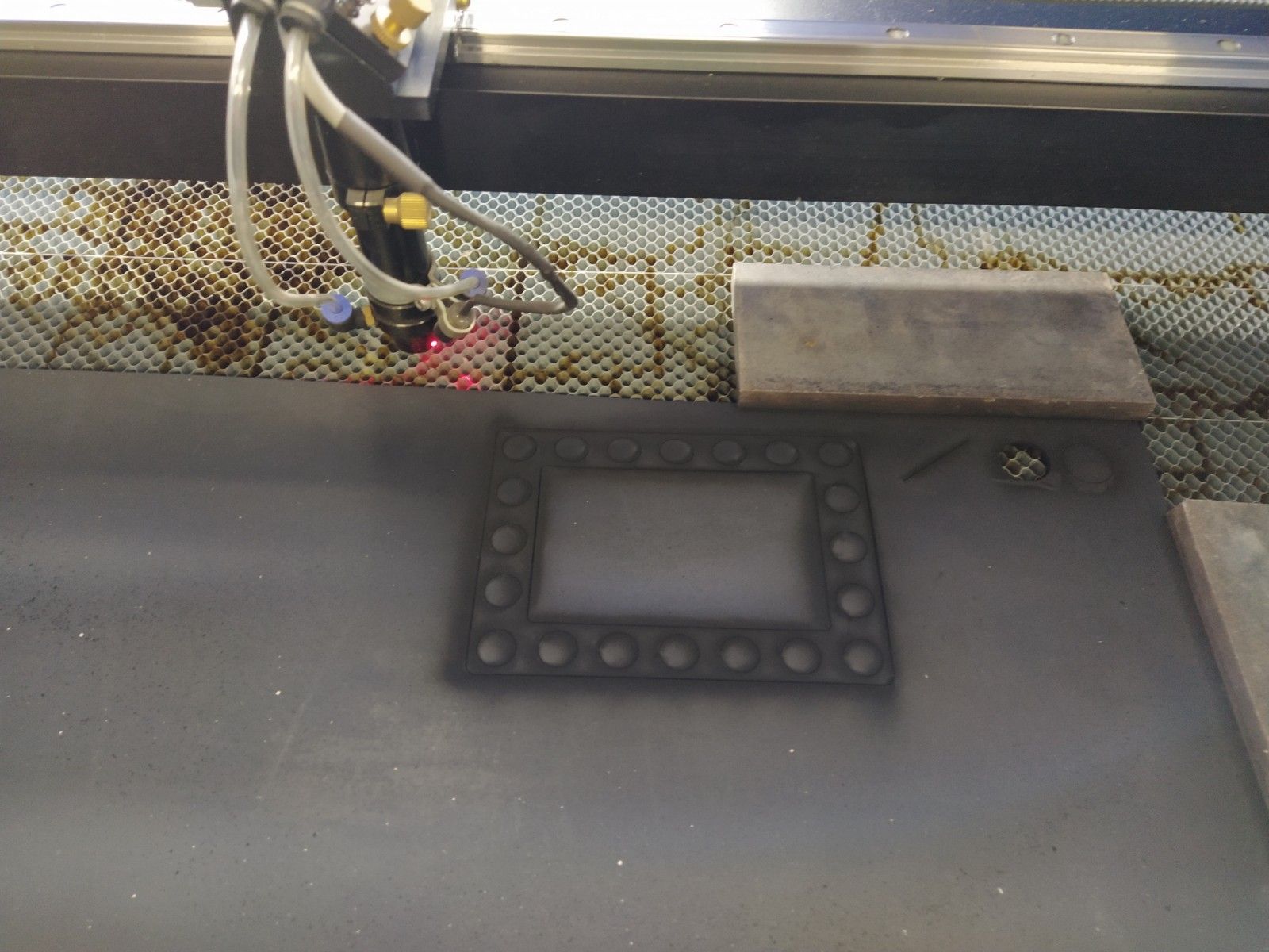

Then I laser cut a gasket out of oil & petrol resistant Nitril:
Perfect fit:
This week I'll have the top plate cut. Once I receive all of my AN fittings & lines the tank can go back in.
I did plug a few pinholes in the bottom of the tank and welded in this top plate. I still need to coat these welds on the inside.
What would be a nice coating to apply?

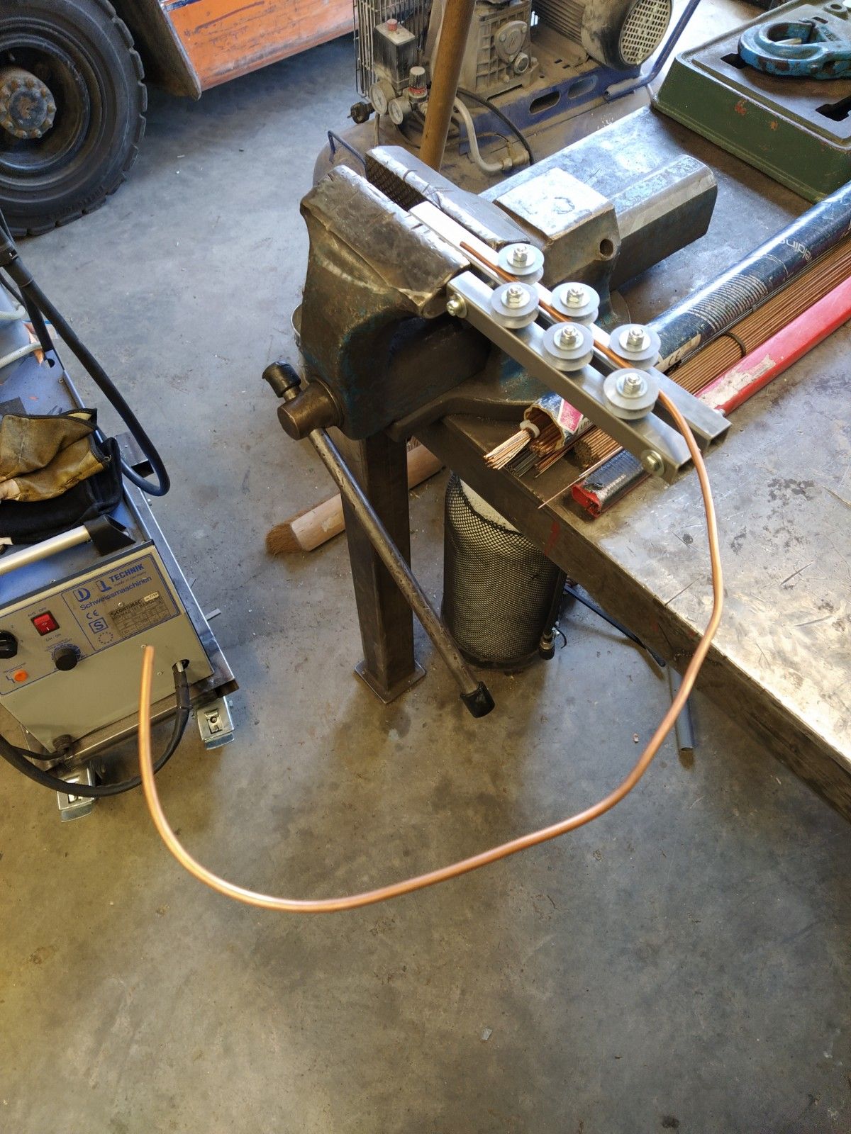

I also received copper brake lines and mounting clips. It comes in a roll and is hard to get straight by hand. After a bit of searching online I drew up some rollers, 3D printed and bolted them to some stainless scrap tube.
It works really well:
You have to push it through and pull it back a couple of times, but works perfect.

I've straightened coiled tubing using pvc pipe. Find some small diameter pipe, insert the tubing and pull through a couple of times.
