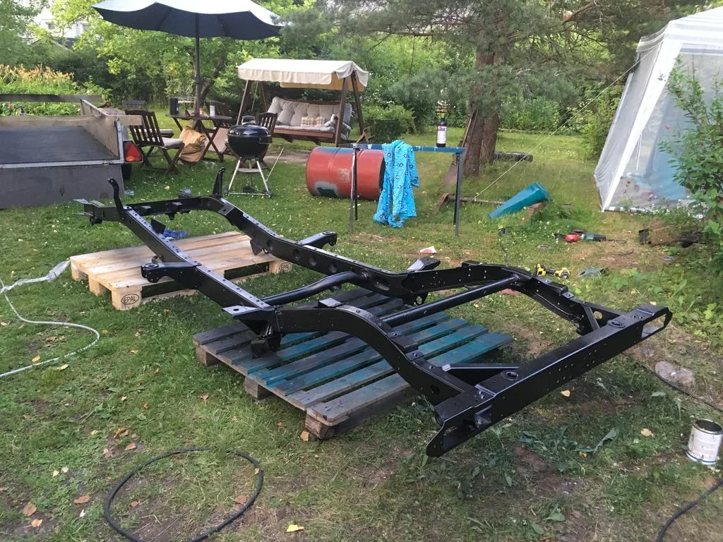

Frame painted too:

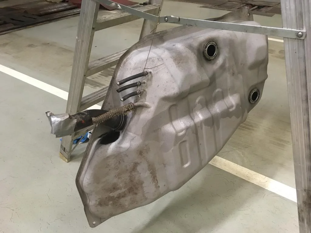

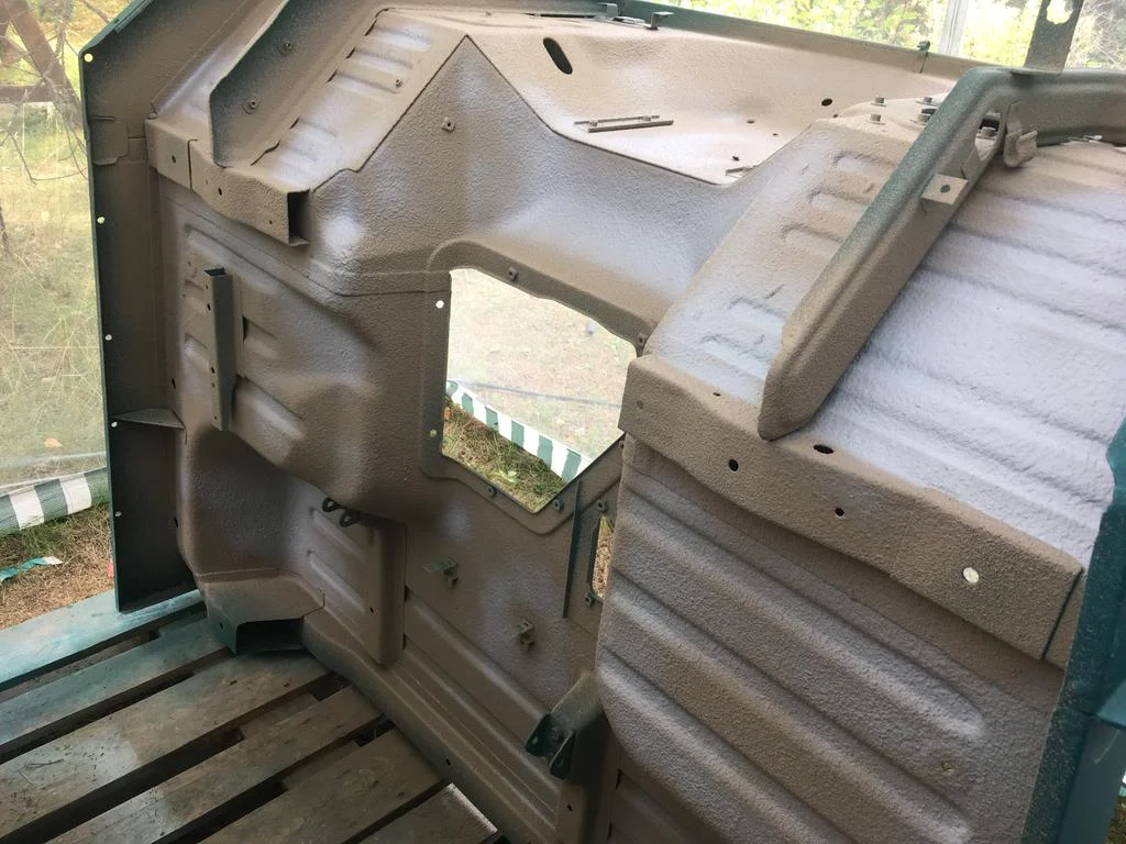

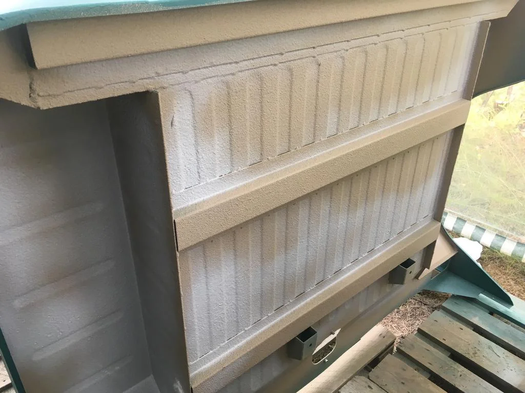

Sprayed Noxudol 3101 noise killer stuff to the tub:
White is still wet.

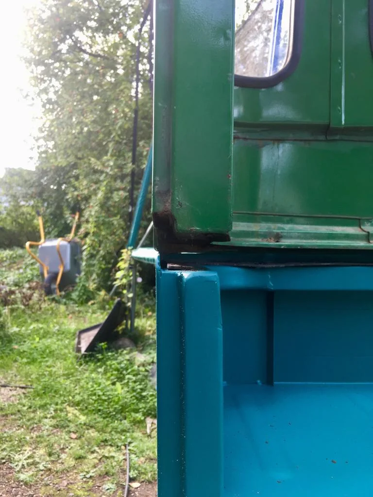

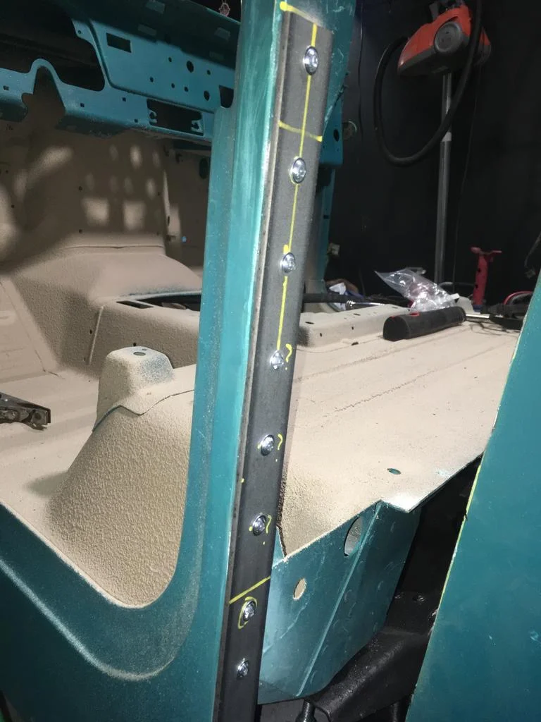

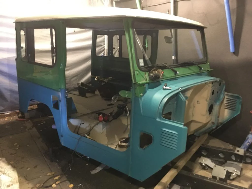

Test fitted the Teseven 1/2 tub:
Almost, few millimeters too long:

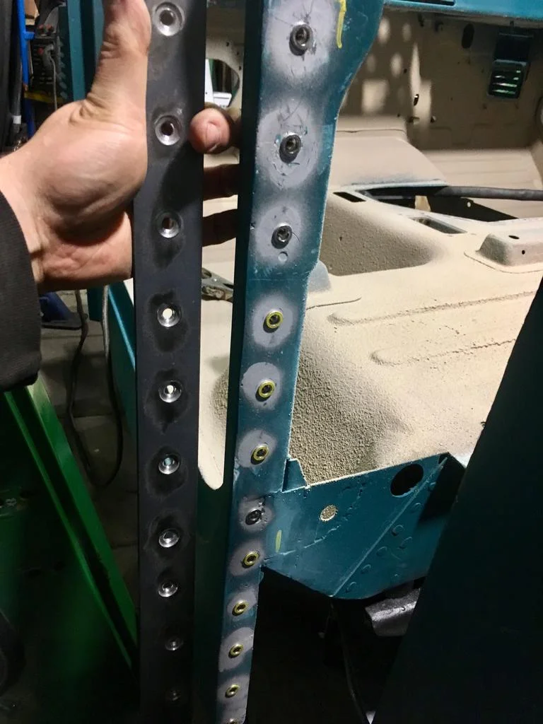

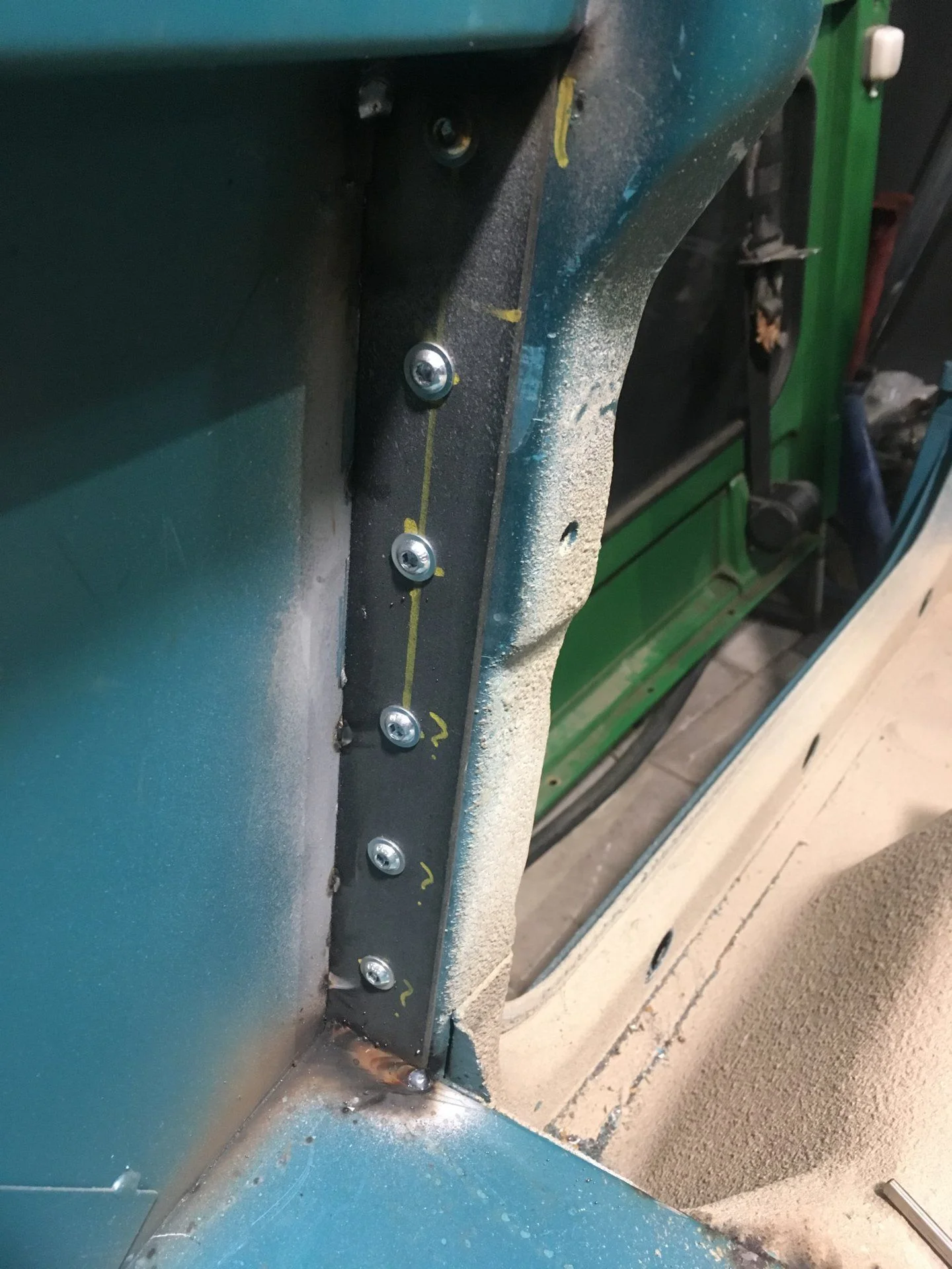

Rear tub mounting redone, this is how it was:
Cut the edge off and made new:

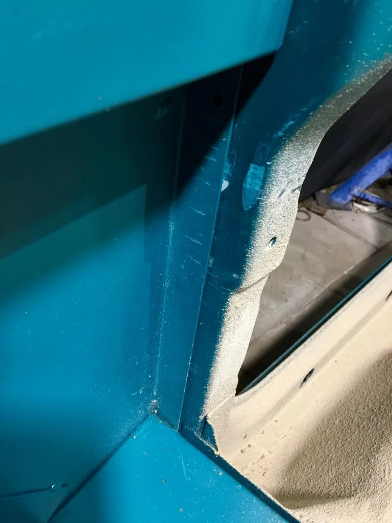

As you can see I am bolting the 1/2 tub with M6 bolts. So it is removable in the future if needed.
Now it fits ok:

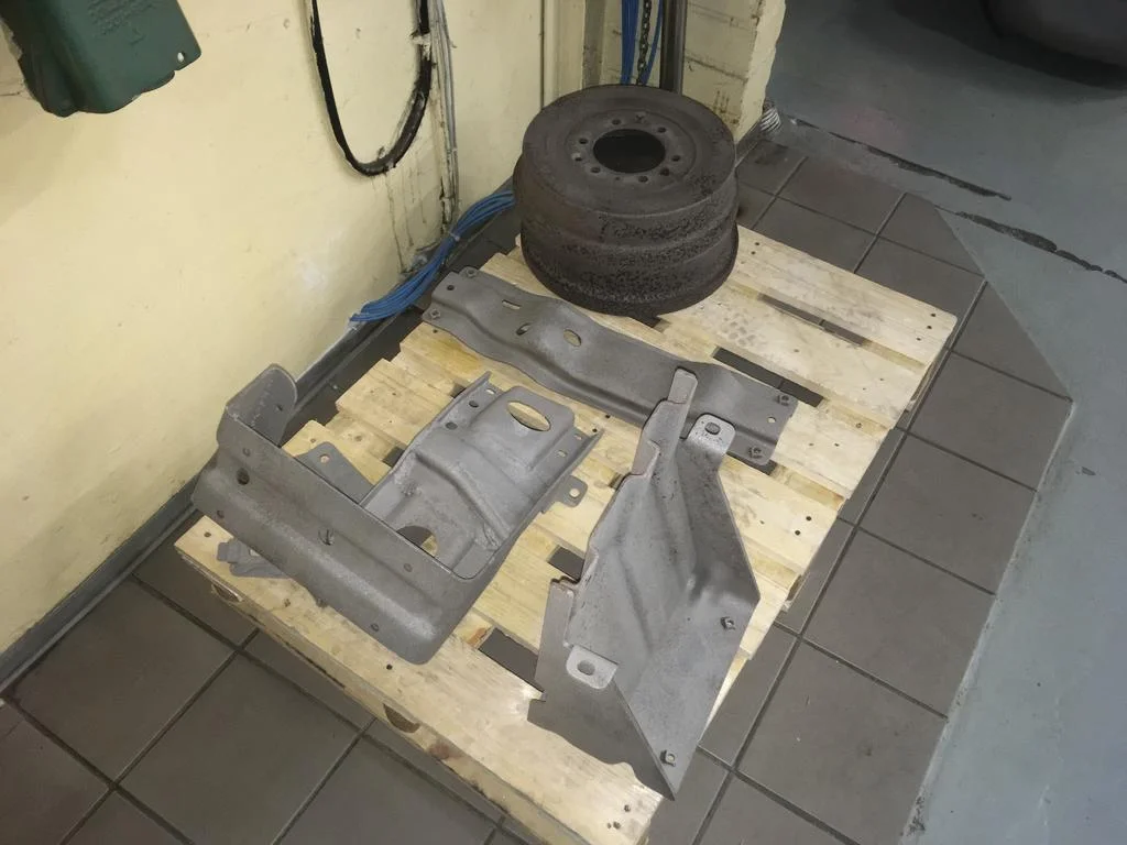

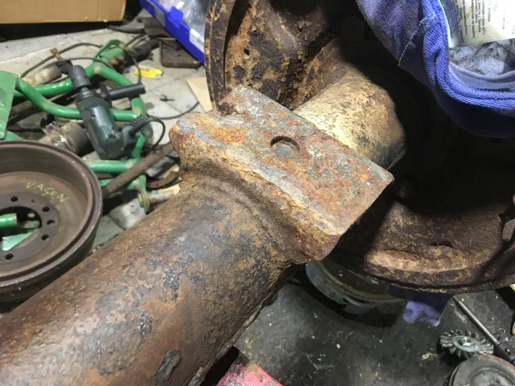

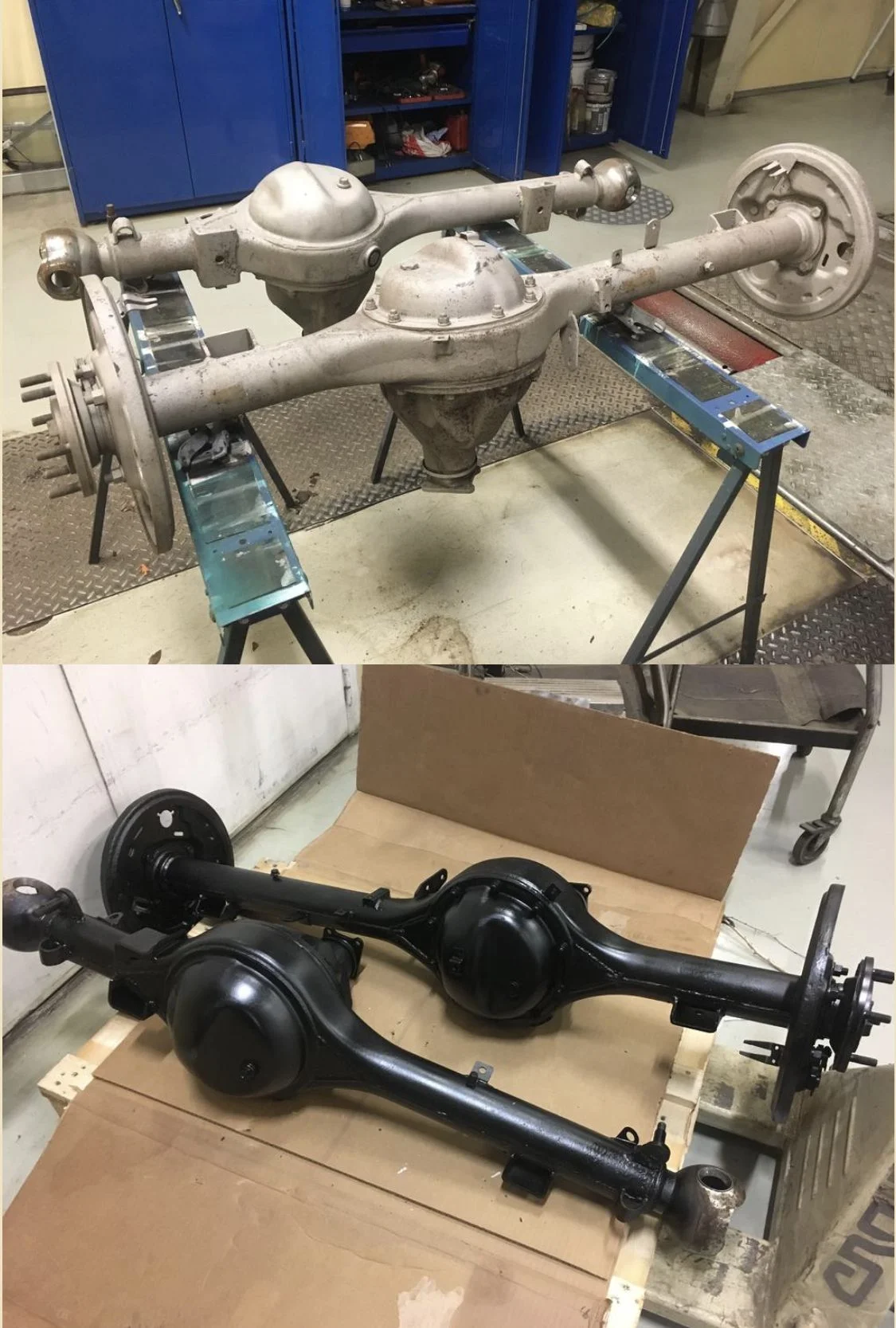

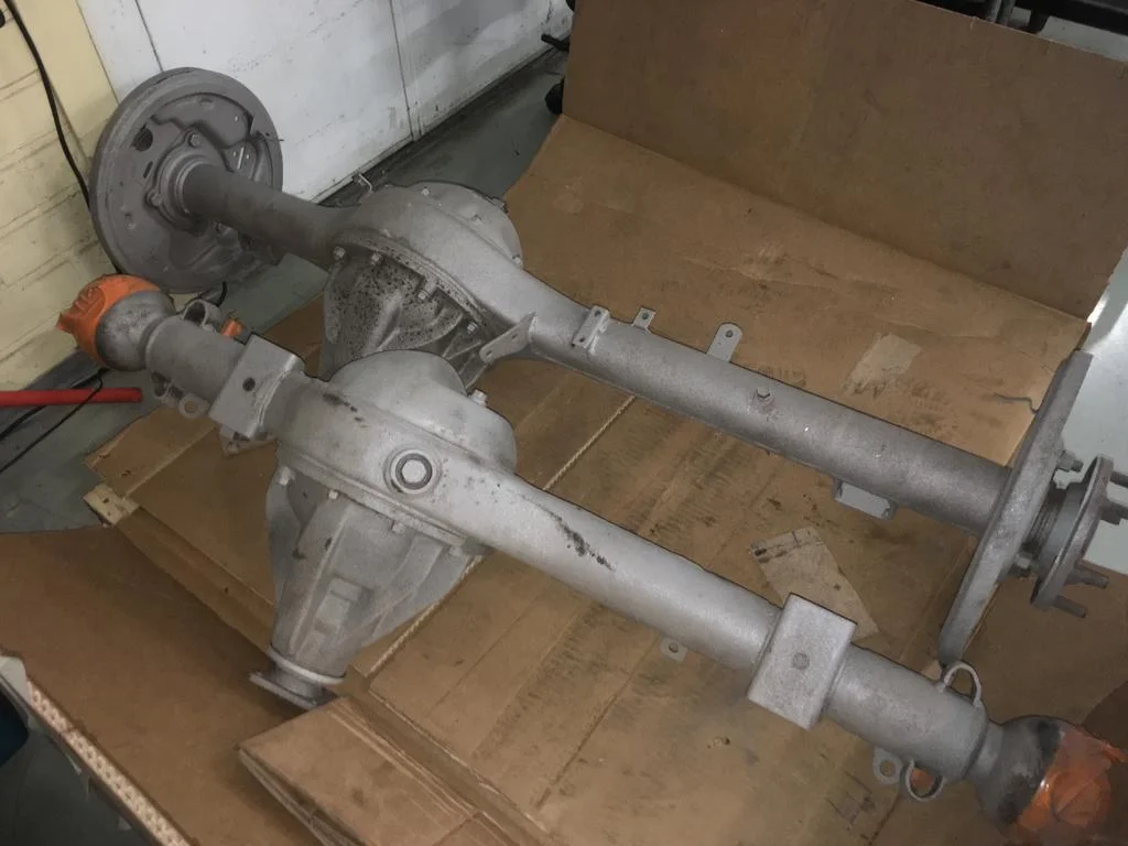

Axles and other stuff is blasted too:
A lot of painting is coming...

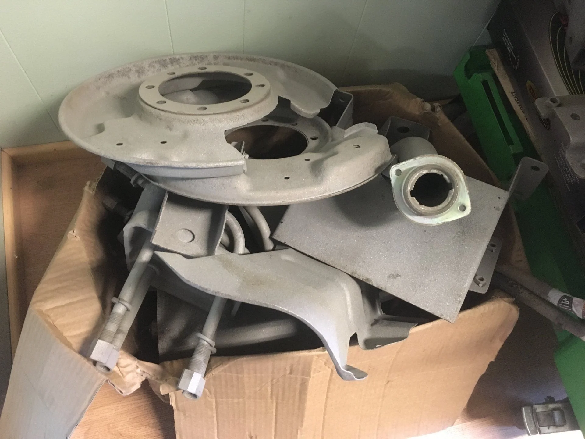

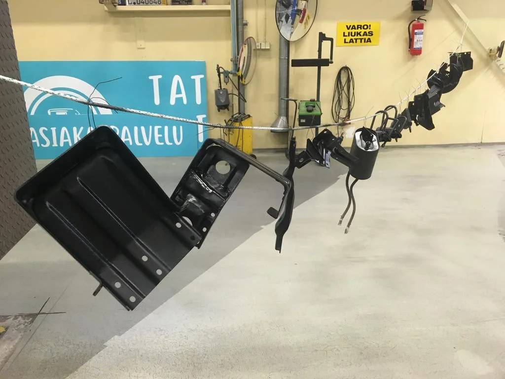

Some parts painted with black epoxy:

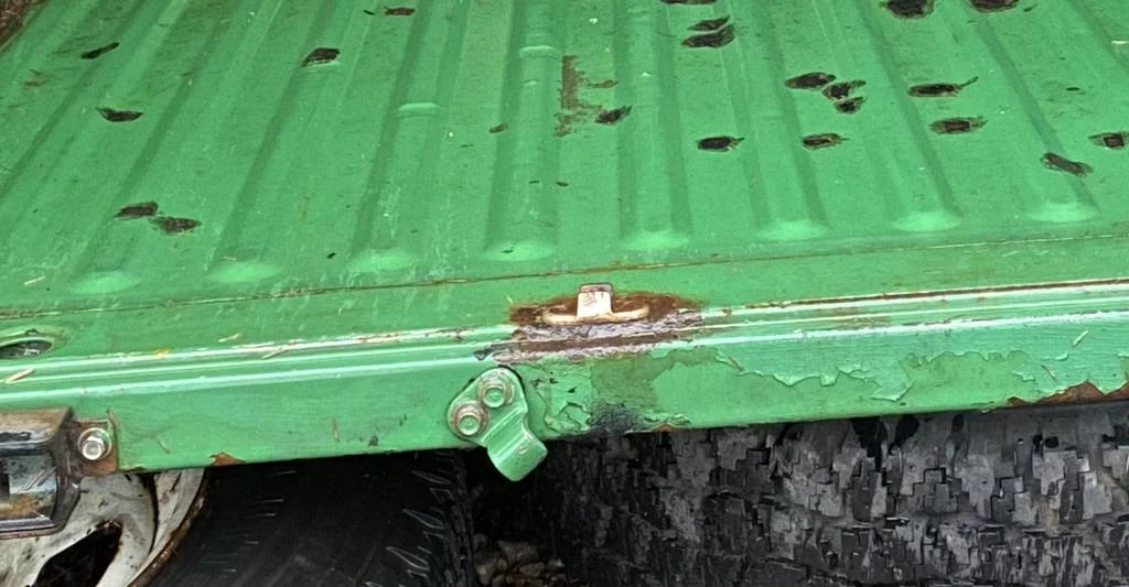

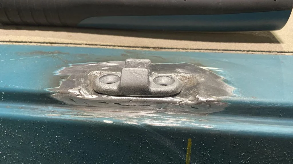

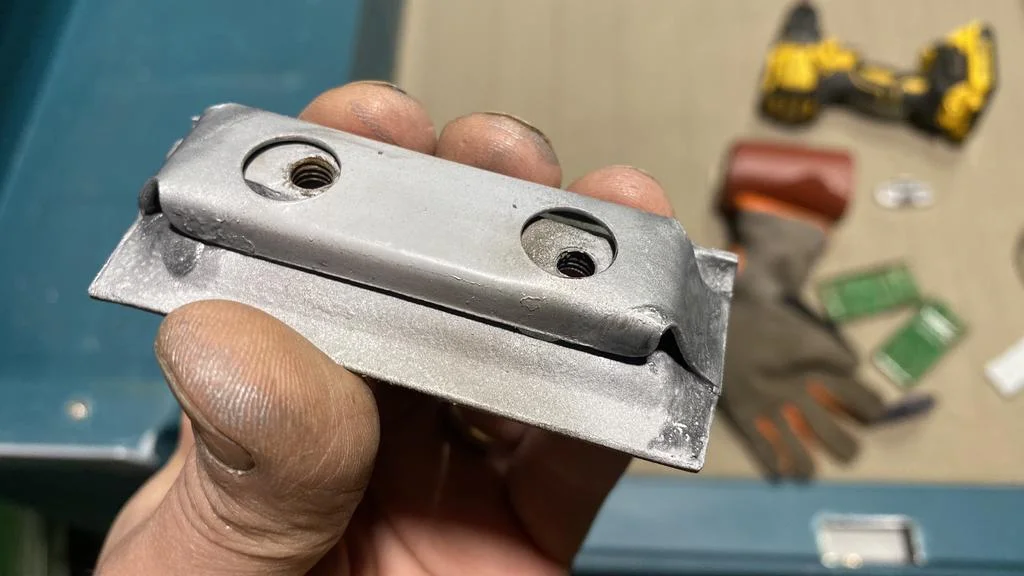

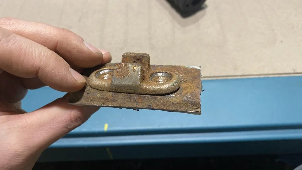

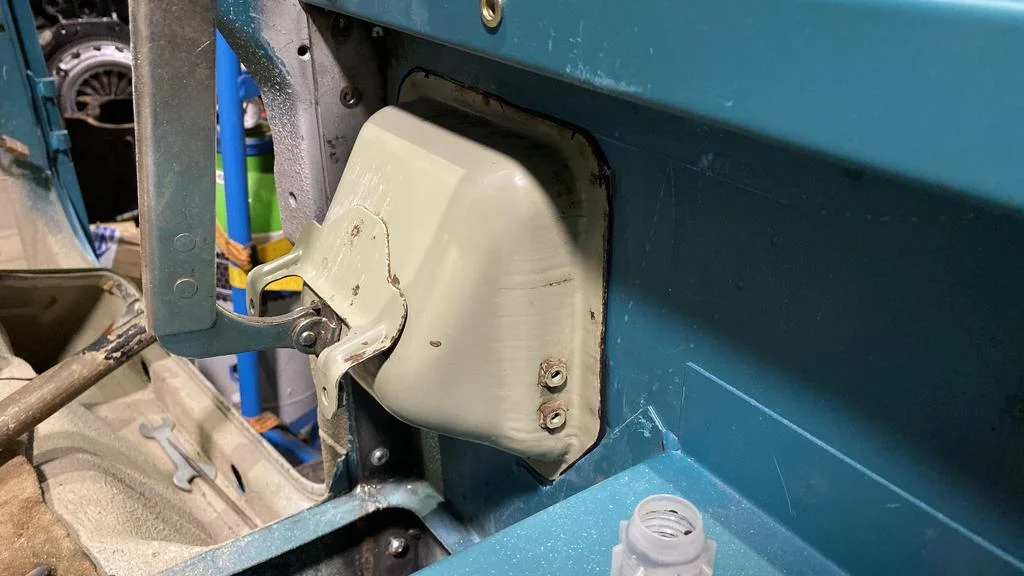

I have to take some parts from the old 1/2 tub, the ambulance door striker:
Some acid bath first

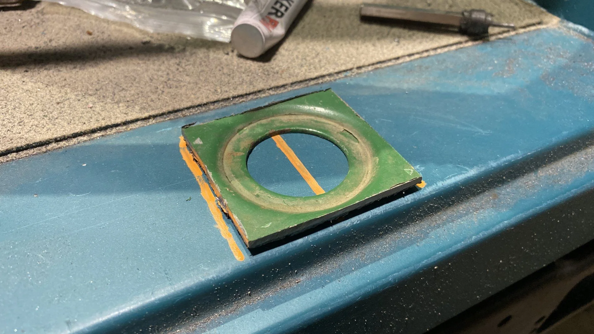

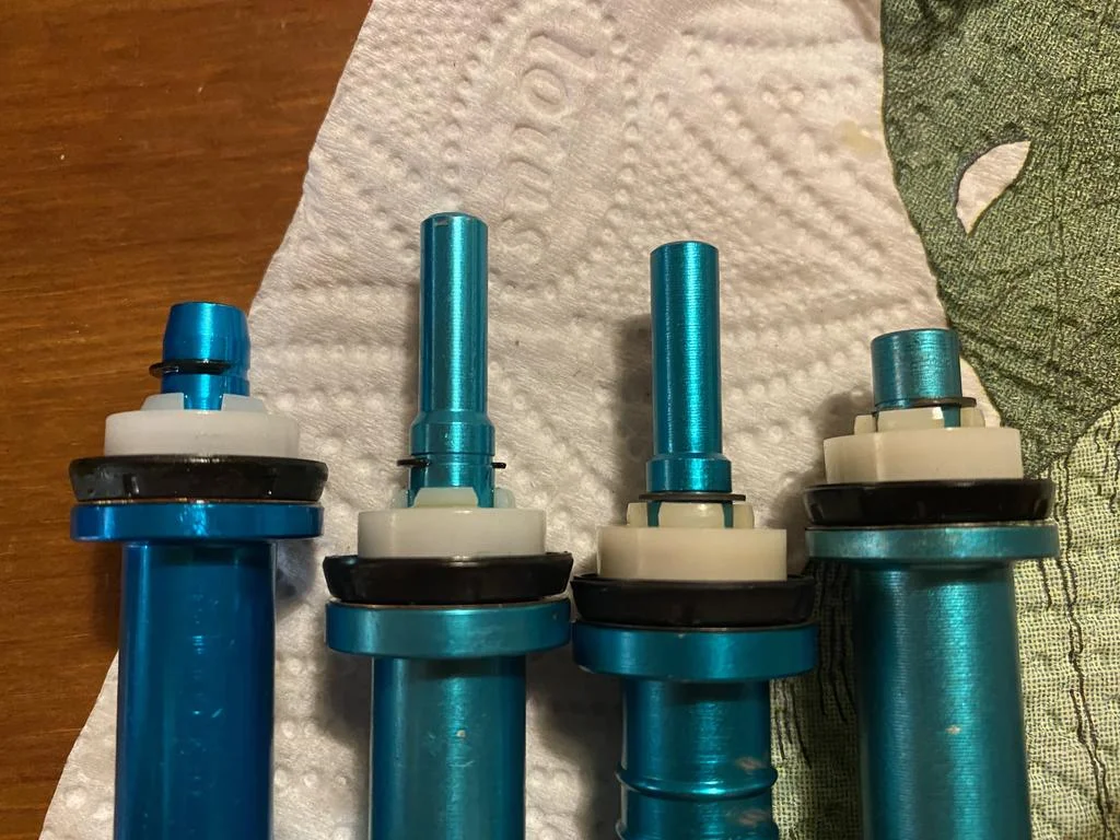

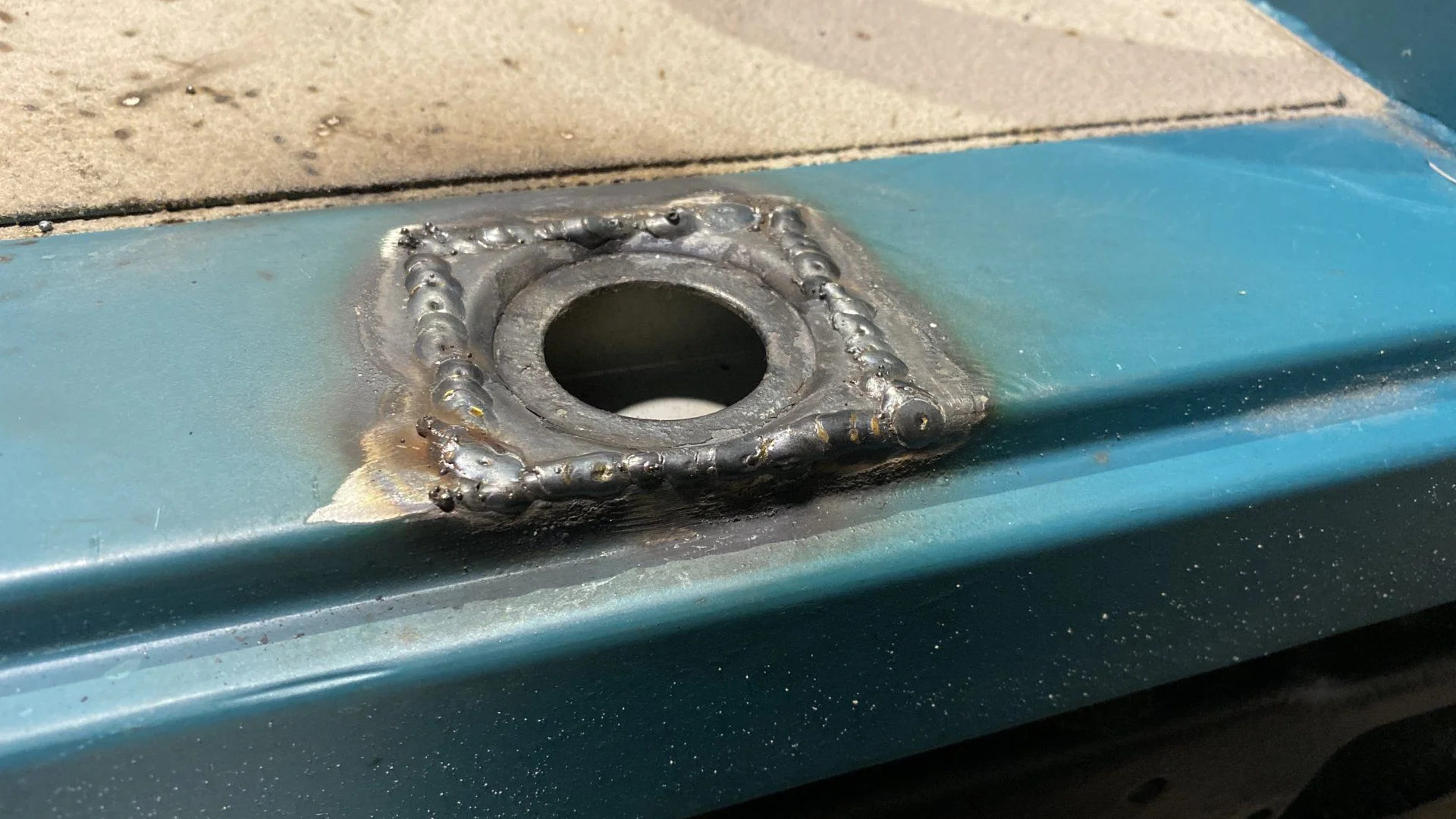

Fuel filler neck cup, what ever... clued at it’s place:
...and it’s cover:

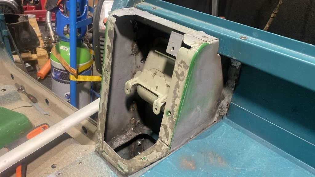

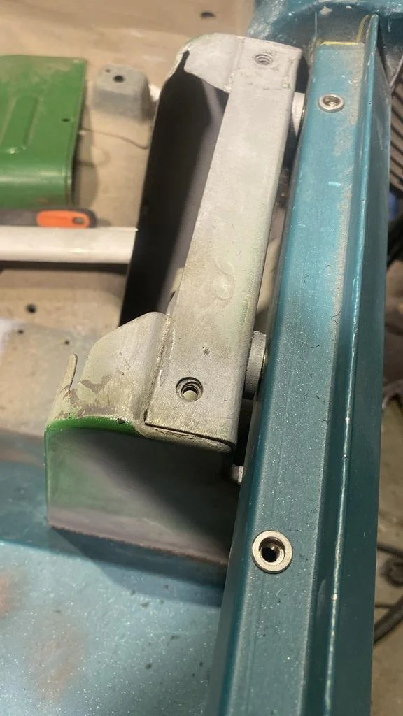

Teseven did something not so original, the upper edge is narrower than original, so that’s why there is thick washers between:

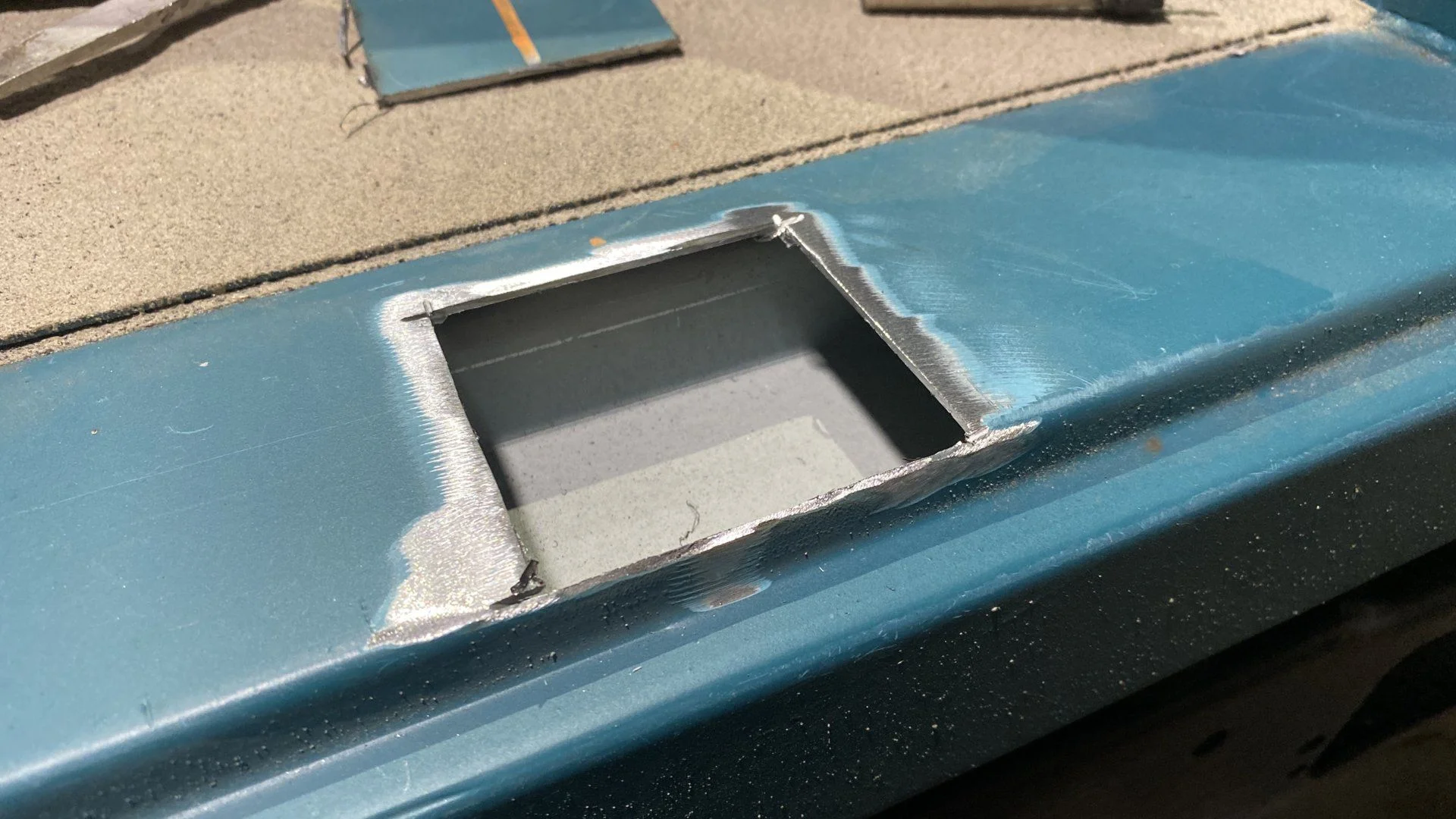

The ambulance door hinge’s back plate didn’t fit too, had to cut the lap seal to get it straight and how else to do it...
...than from outside:

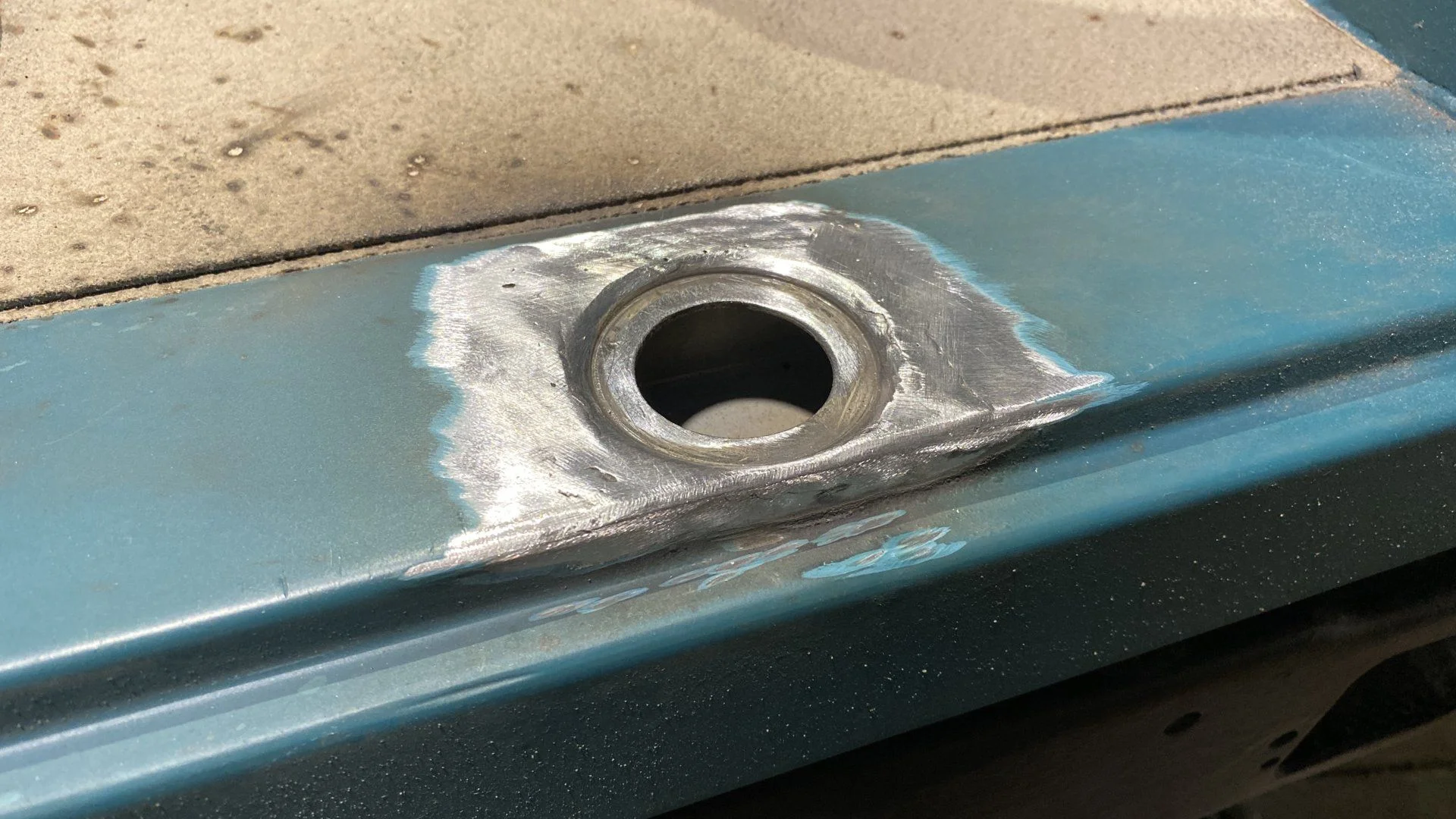

Next the spare tire carrier pin fix:

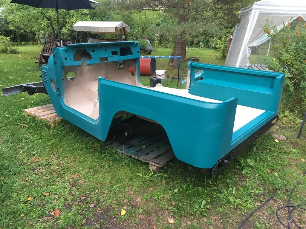

First topcoat paintjob ever with a paintgun. The body is grinded only with 120 grit paper, the paint is thick. I like.
picture.php

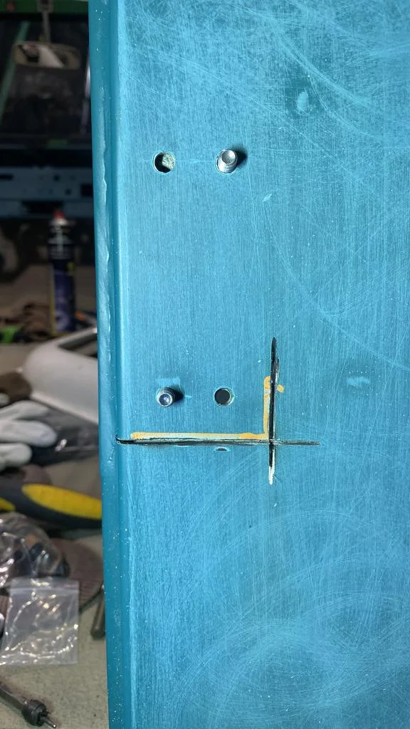

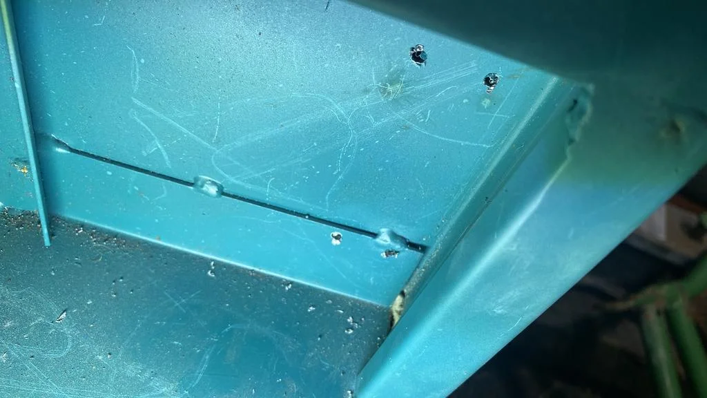

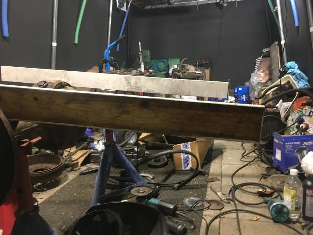

The Teseven´s tub is not straight, I had to press it about 1 cm:
picture.php
And the rear panel was not straight too, it was folded forward. I used aluminium putty to fix it. Filled also the too deep weatherstrip grooves.

And again some misalignment done by Teseven:

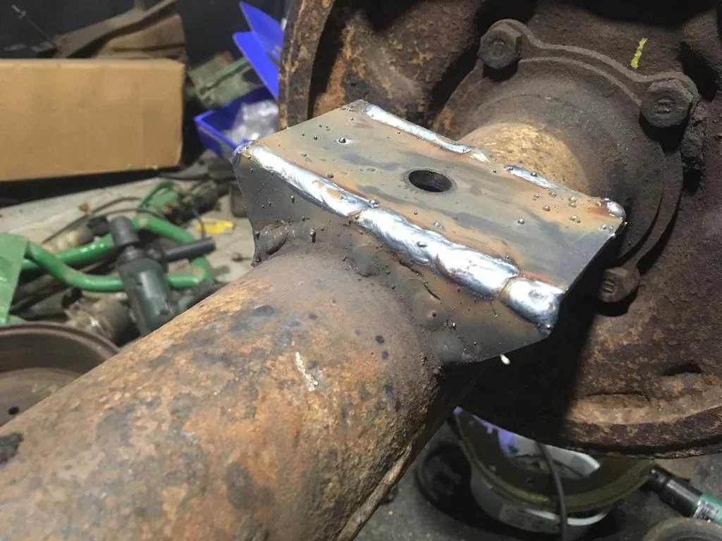

Stainless steel muffler (Walker 21337) installed with flex joint:
picture.php
picture.php
Selfdesigned bracket for it, SS too. Do not stare at the welds, the spool is not turning right, the wire is wound incorrectly.

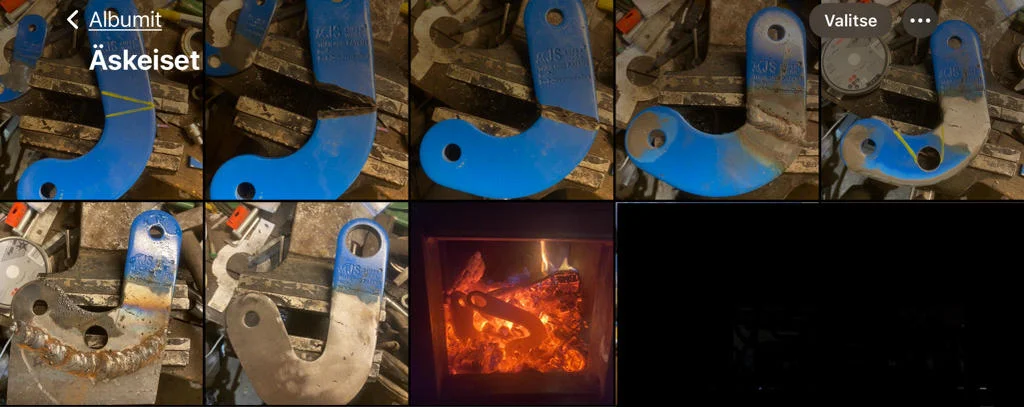

Then the rear shackle modification to ball beared:
Ready except the painting:
picture.php
These are the parts, thanks to my friend Rafu for the milling.
picture.php
Installed:

The tank straps mountings had to modify, thanks again Teseven. I don’t know what is thought.

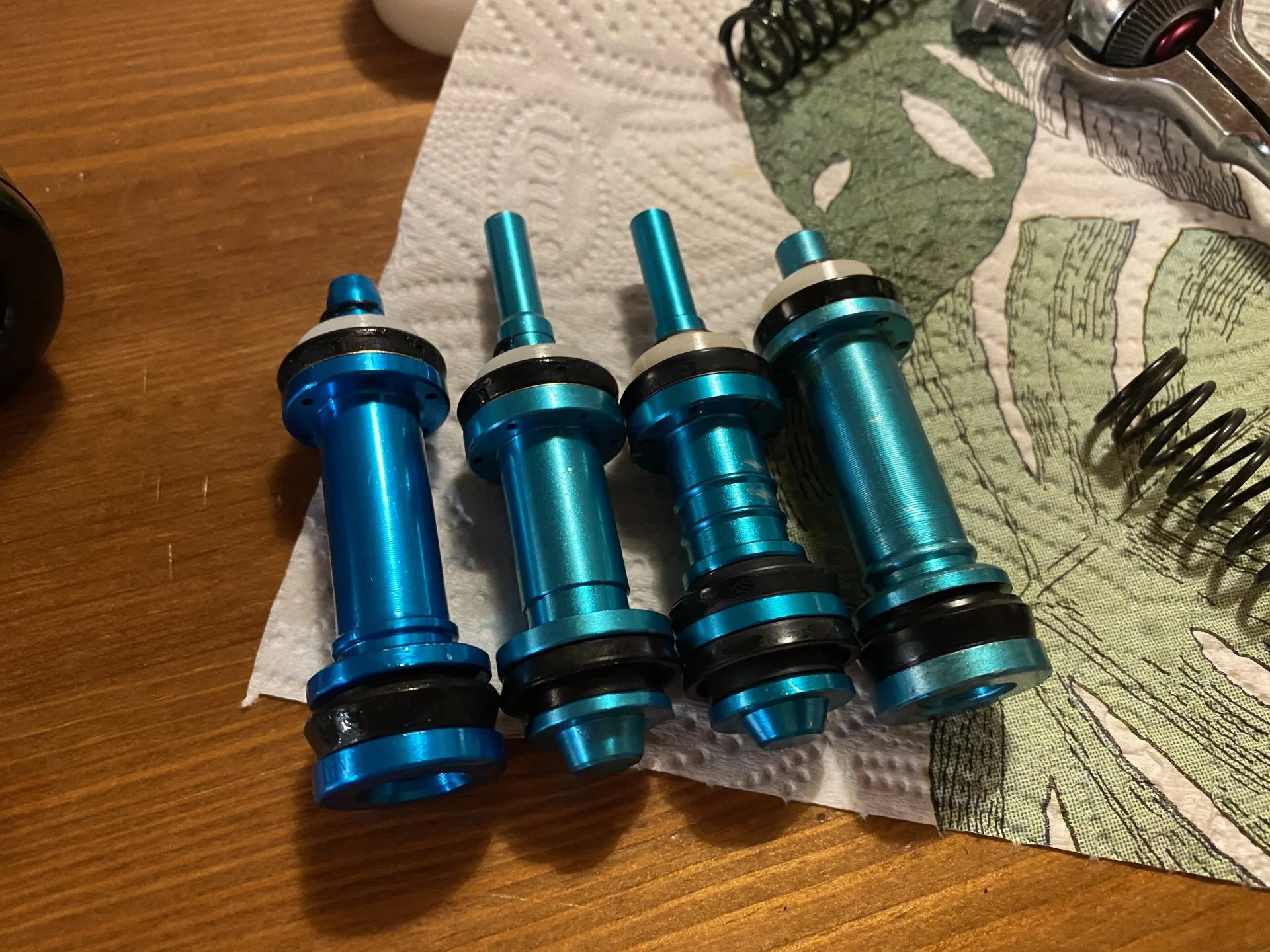

New Aisin clutch master cylinder from Rockauto.
picture.php
Brake master needed some TLC:
picture.php
picture.php
The original was a little too much gone inside, I honed it, but there still was some corrosion.
So, I bought new aftermarket one and dismantled it. There was few differences, look at the caps between the C-clip and plastic (left new, right old):
Also one seal was missing, not even place for it:
Also the valves missing:
