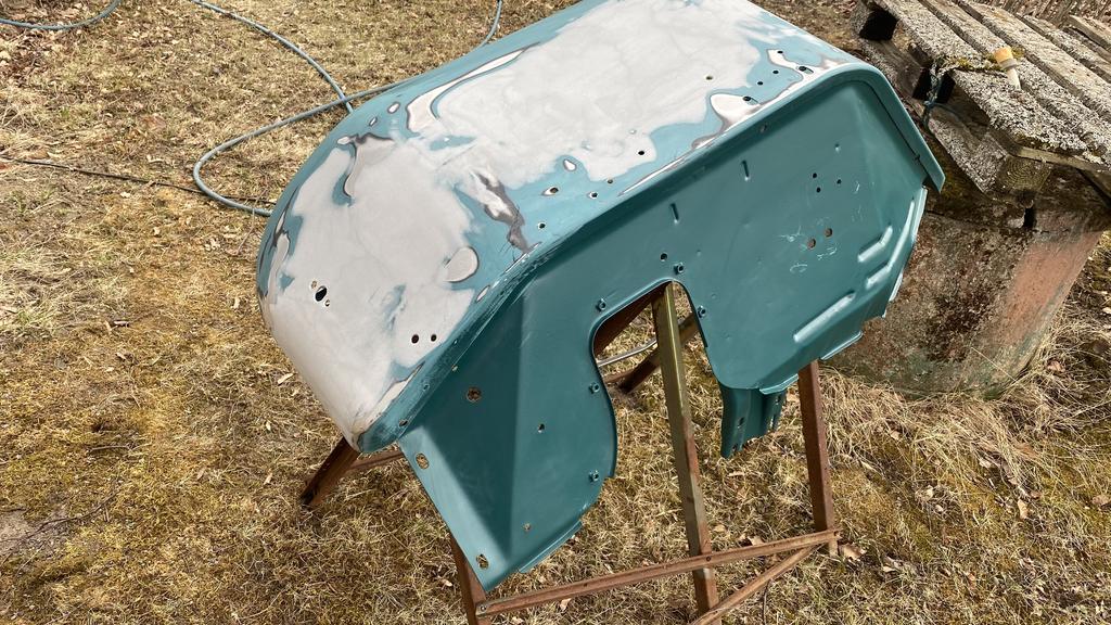

New OEM fender sliced:
picture.php
picture.php
picture.php
... to get it 2" wider:

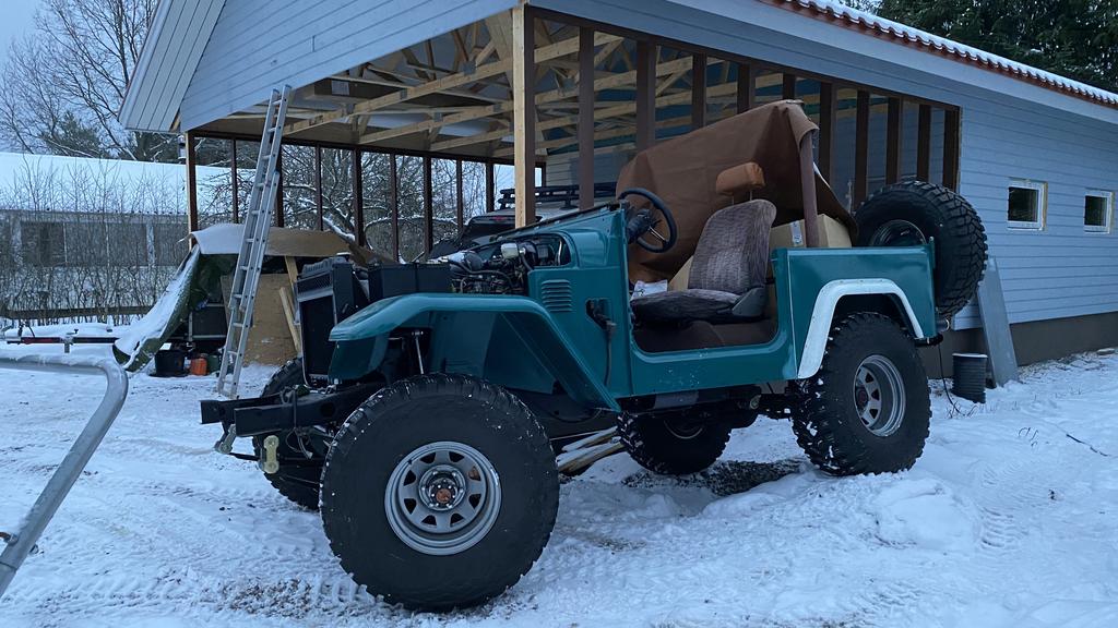

This is how it looked at October 2021:
picture.php

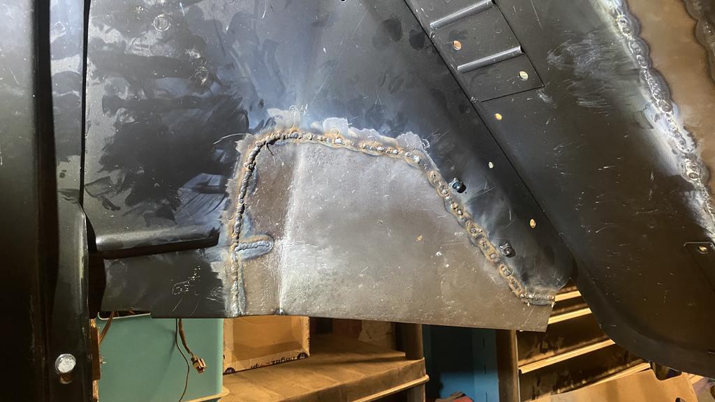

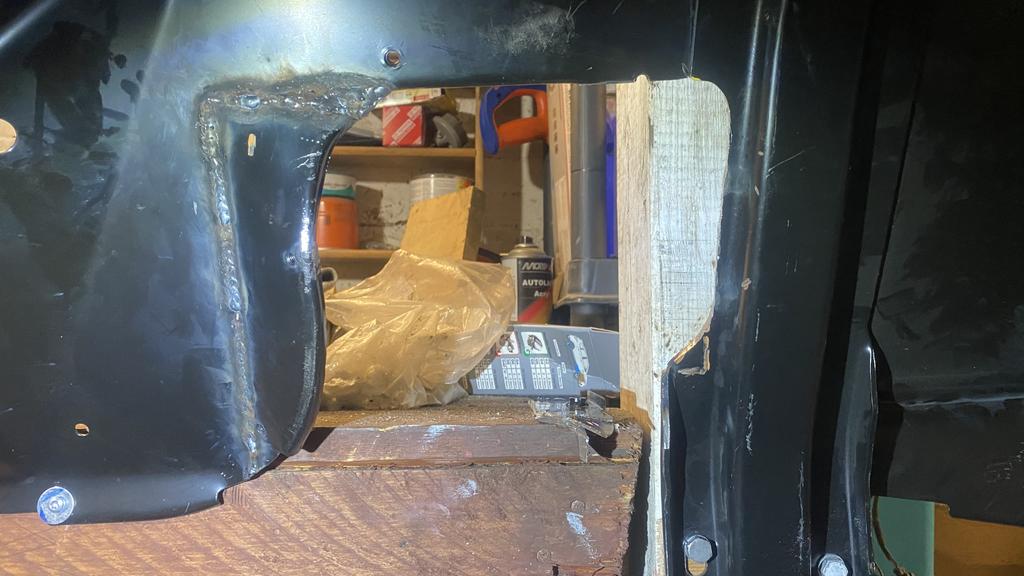

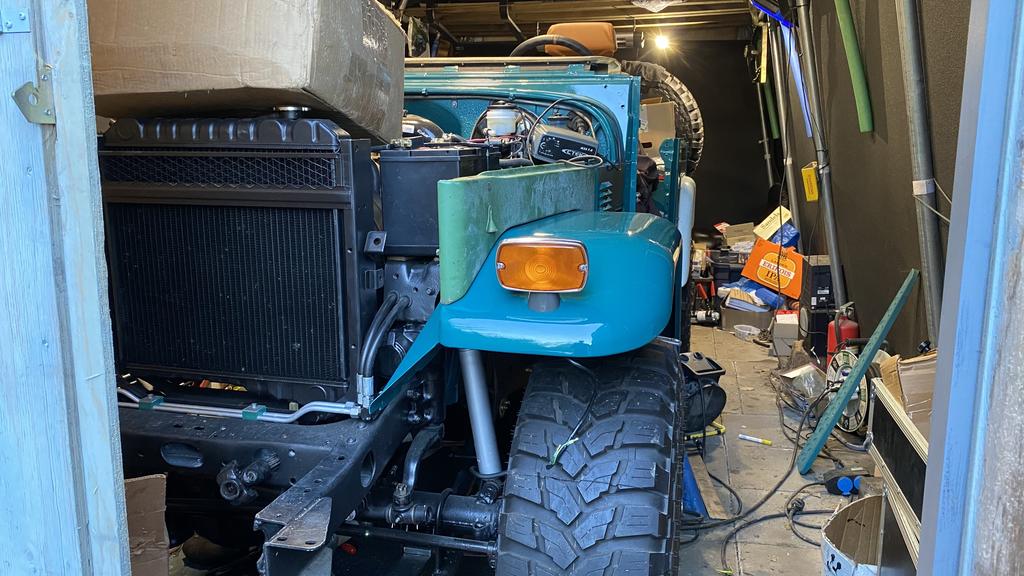

Some updating, this is happened 2 years ago. The front fender modifications. First some patching for the steering box opening:
And room for the HJ61 steering box:

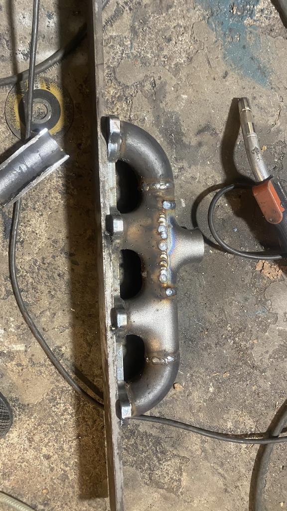

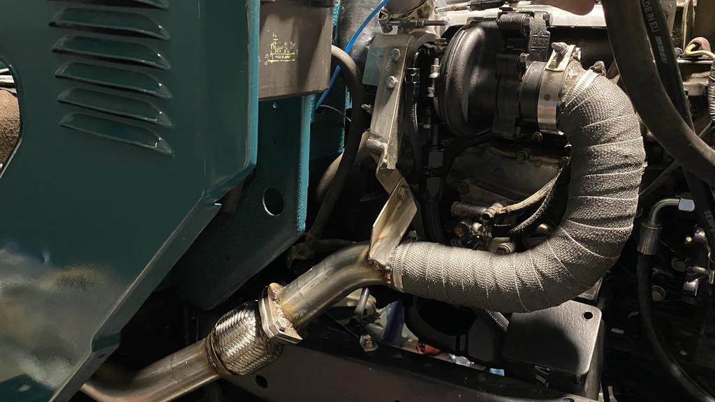

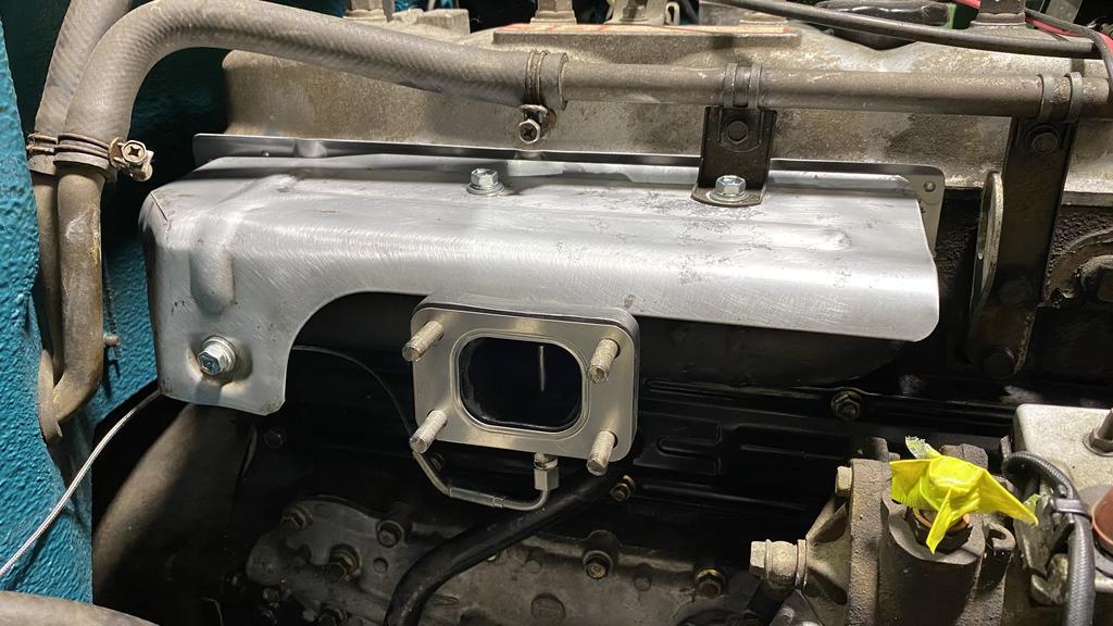

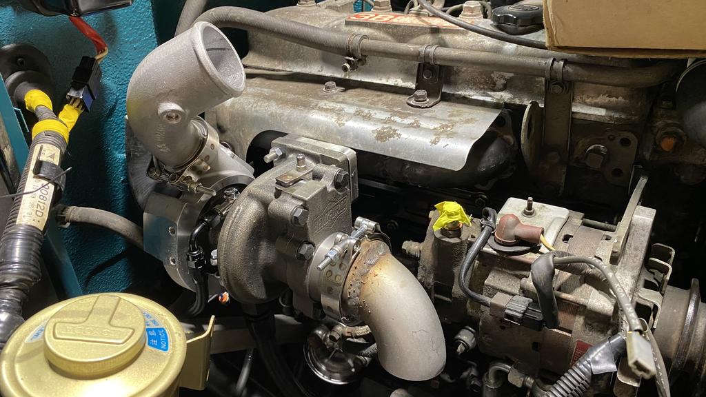

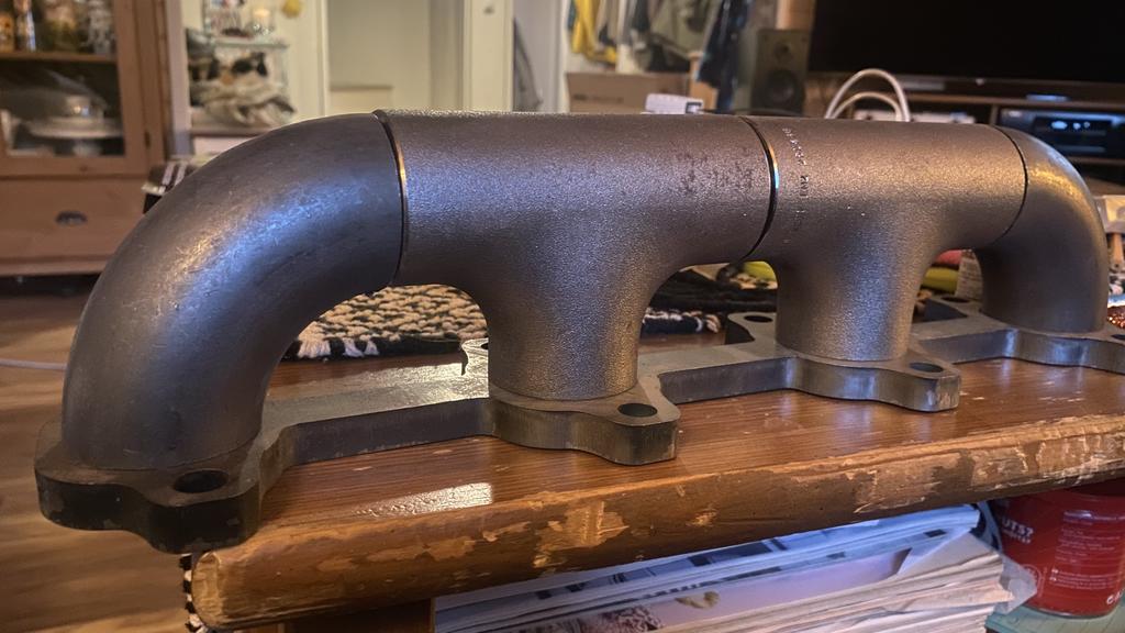

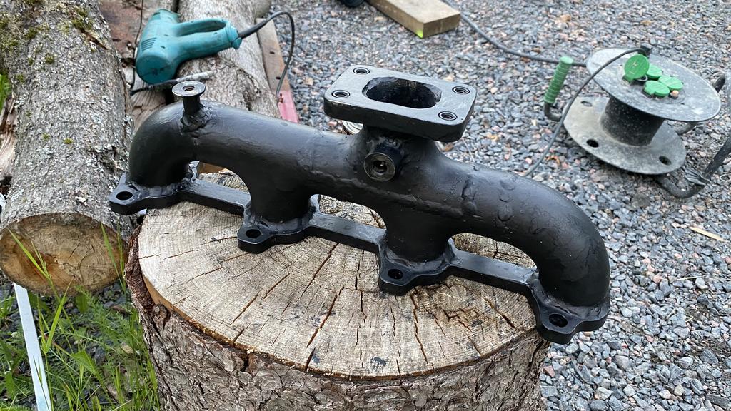

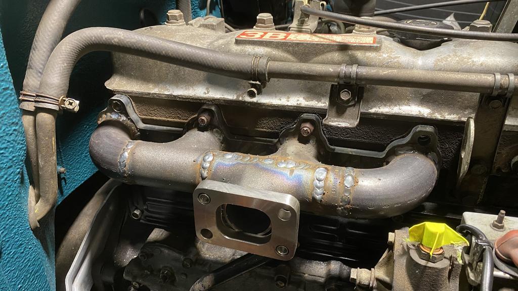

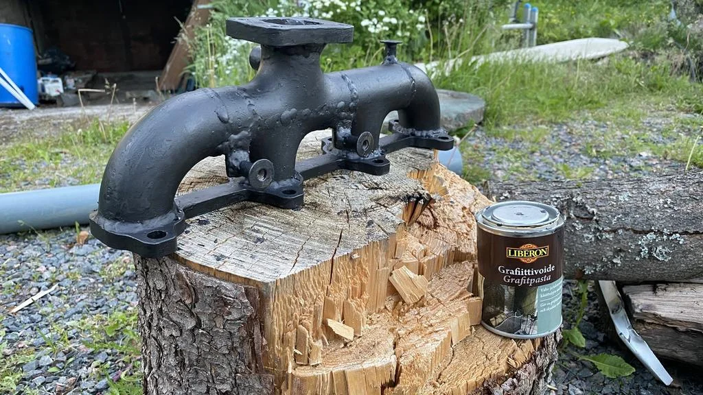

Then I bought a turbo (Holset HE221W) and started to make an exhaust manifold for it, it was surprisingly easy to do:
And there it sits ”backwards” along with the OEM heat shild:

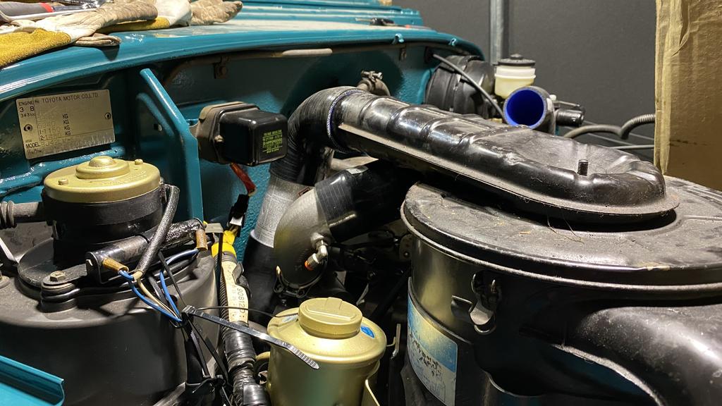

And the OEM air cleaner fits also without any modifications:

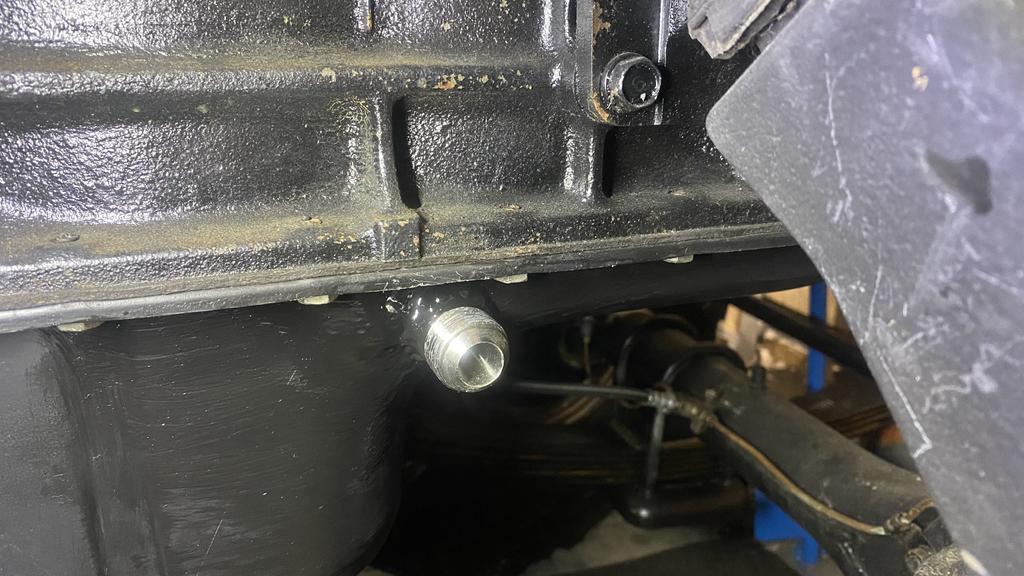

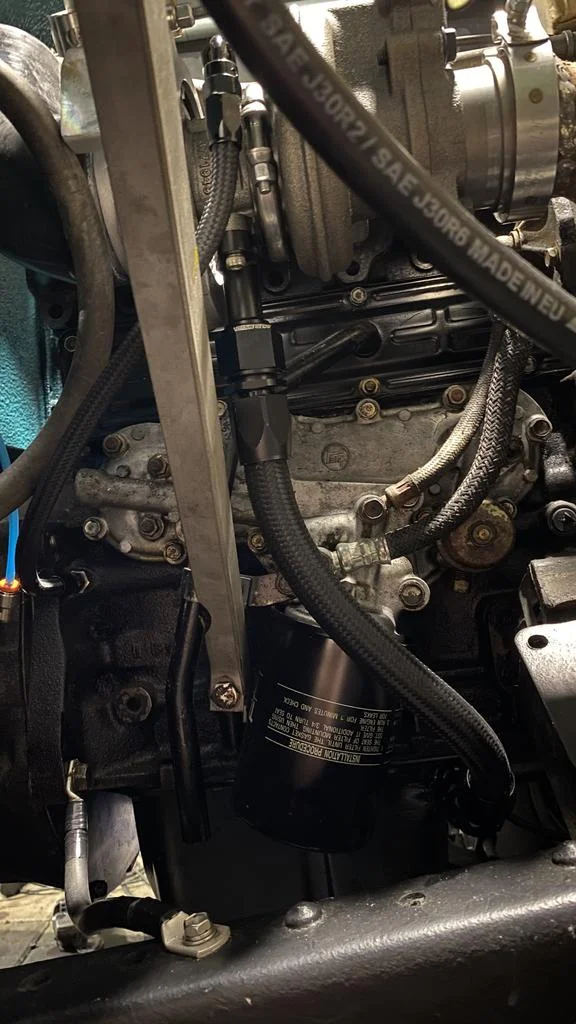

The oil drain plug (AN12) is welded to the oil pan:
And the pressure line is also installed with AN4-fittings. I also made that support bar between the engine block and the compressor housing:

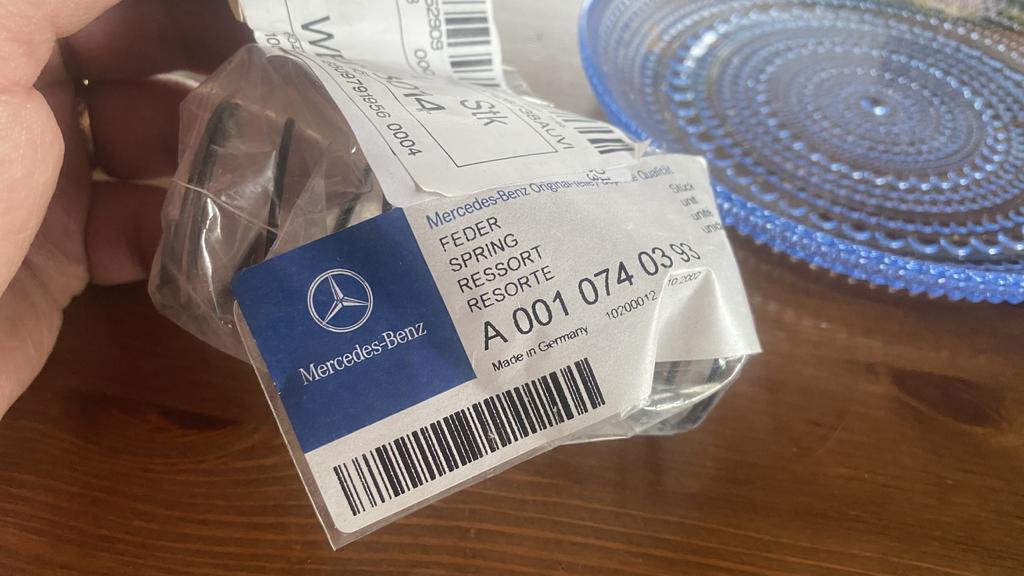

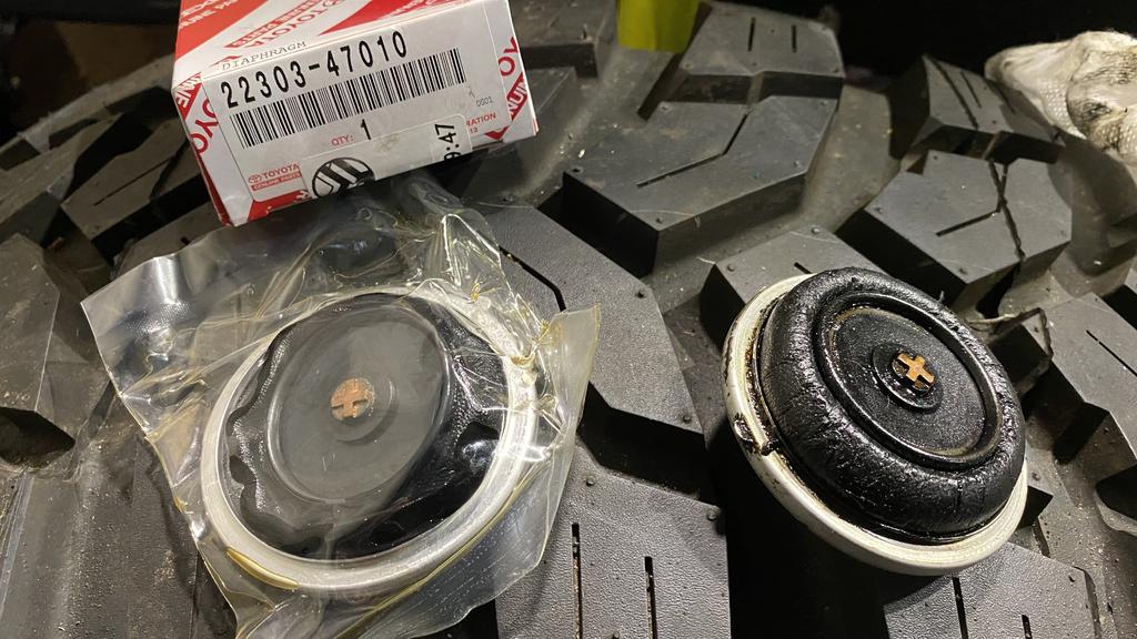

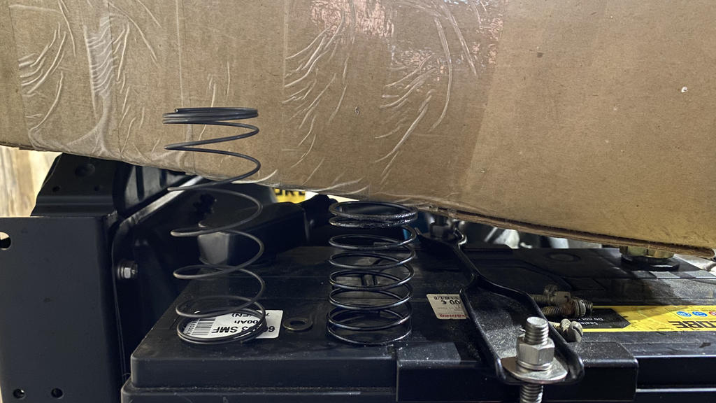

I changed the injection pump’s diaphragm for sure:
Along with the Mercedes W123 240D spring:
But this made the engine too sensitive, hard to keep steady throttle. So, I changed it back to the OEM.

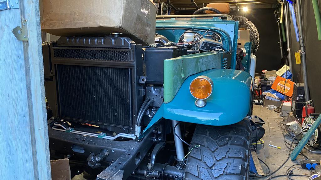

Then back to the front fenders:

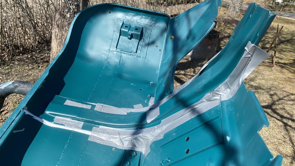

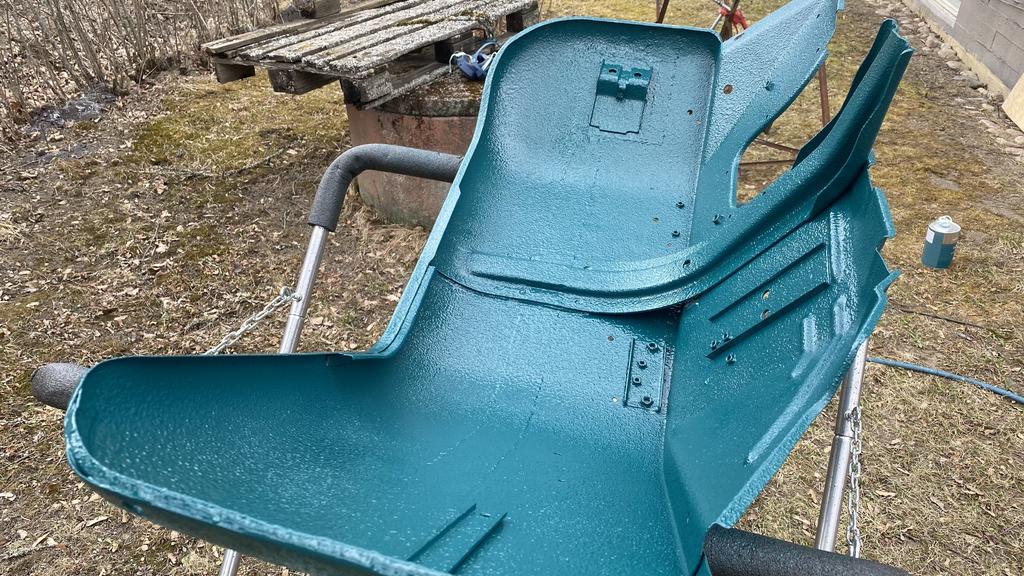

I taped the front channels and first poured them full of epoxy:
Then sprayed the insides of them with tinted Troton Rangers (similar as Raptor bed liner):
I still don’t know which blinkers I want to install:

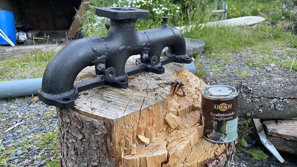

Then back to the exhaust manifold. I brushed it with that graphite stuff:
It was good stuff:
The the heat shied and an exhaust gas temp sensor installed:

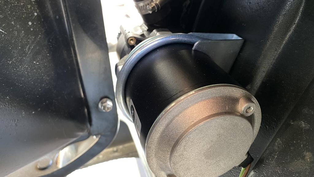

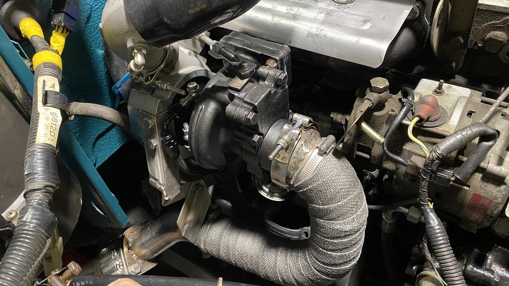

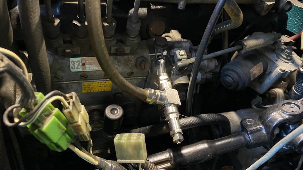

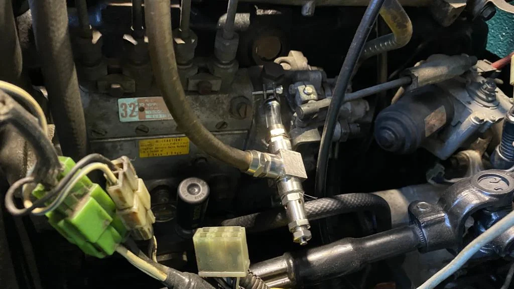

Then this chinese bleed valve (0.1 to 1 bar) to the injection pump hose:

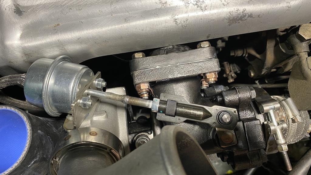

And the wastegate actuator with a softer spring (6-20 PSI). I had to clock the compressor housing:
And some insulation on the stainless 2.5” downpipe:
Some support bracket between the downpipe and compressor:

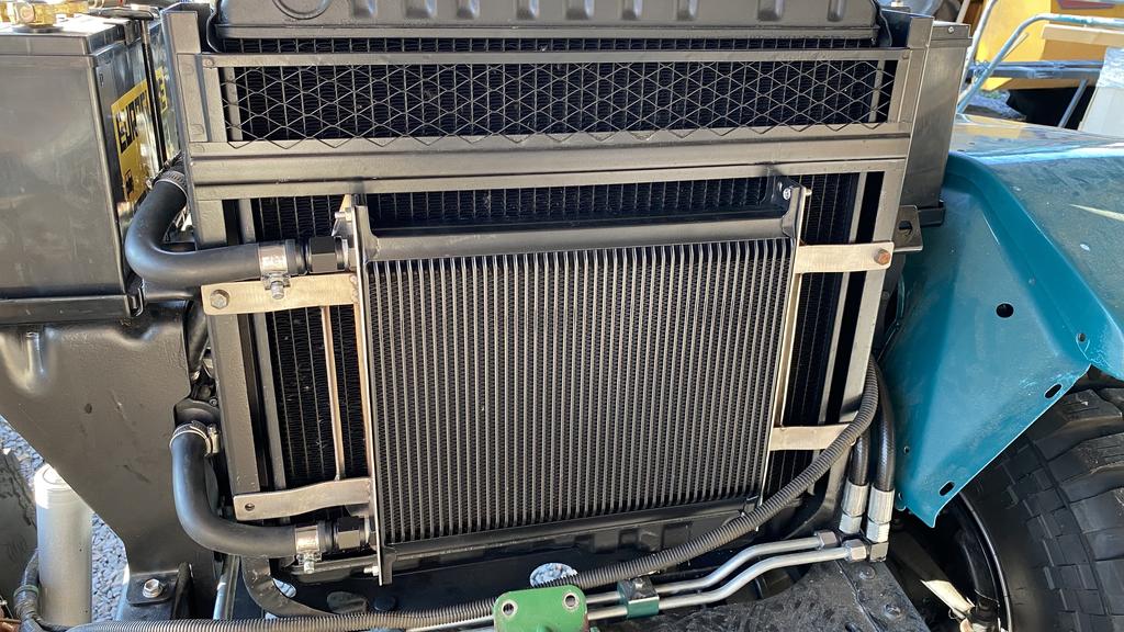

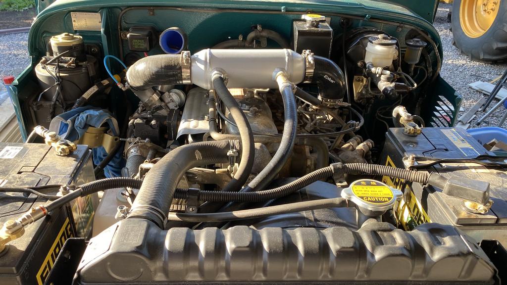

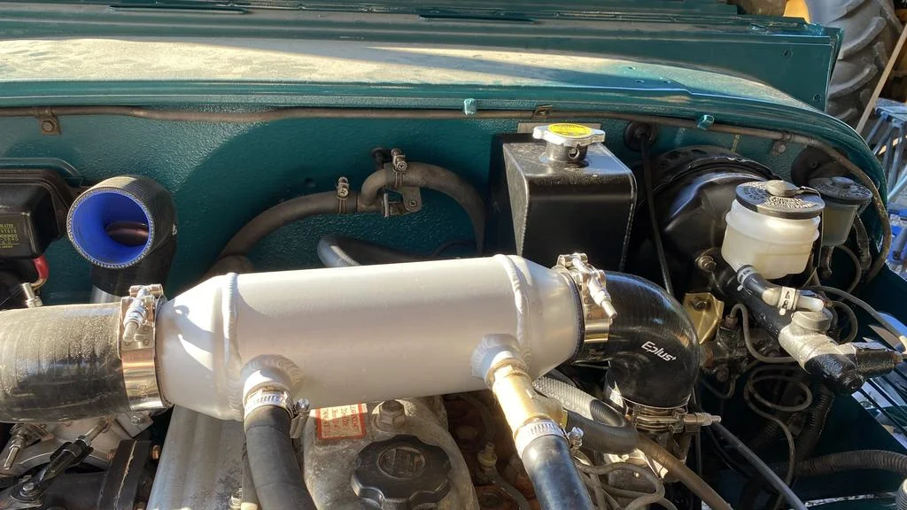

Then I thought I’ll need an intercooler, water intercooler. First the 24V pump (not so easy to find):
The barrel (8x4”) and the reservoir from Aliexpress (chinese stuff):
Then, because of the very limited space, I choosed that 44-row oil cooler for radiator for the intercooler:
