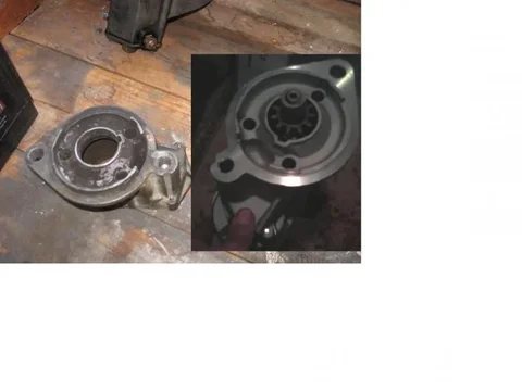

I've just made up an image that has Gizmo's BJ42 starter nose alongside your 56111 remaufactured nose and I can see differences. - Although I don't know whether they are "vital differences" - or even whether Gismo's nose SHOULD be the same as your nose (considering the fact that your cruiser is "without EDIC" and his is "with EDIC" and the fact that the two cruisers are different models within the 40 series). But here is that image:
Edit - shortly after posting this. :hhmm: Now looking at these images again I see the two noses side-by-side do indeed look identical. It is just that Gizmo's is so dirty and it is hard to rotate the noses into alignment inside one's head! So I really don't know what your problem is Albert. If you still have your old nose, perhaps you can do a nose-swap just to prove beyond doubt that the new nose isn't responsible for your problem. I'm as lost as you are here really. (If that remanufactured starter does turn out to both fit and run then I'll certainly add this information to my "B-engine parts interchangeability thread".)
..What do you think about 'jumping' the solenoid as suggested above? I do not want to do any damage but it sounds like a quick way to test my starting system.
It sounds like a good idea to me.
But reading Gizmo's posts I get the impression that the nose-swap (swapping the "alloy nose castings" between your old starter and that new remanufactured starter) should also be easy to do and could be all that's involved in getting your new starter to work properly. And Gizmo says (if I interpret correctly) that apart from that alloy casting - many different starters are identical!
:cheers:
PS. I guess your "remanufactured nose" could still be slightly shorter that your old nose because this wouldn't show up in the above photo-comparison. But this shorter dimension could still prevent the solenoid from achieving "full-travel". But then again, in saying this, I'm probably "just clutching at straws to try and preserve my theory that your new nose is wrong!!!! (And reading posts in the non-diesel forum tells me that petrol cruisers enjoy "quite widespread starter-interchangeability" so why should our diesels be any different?)

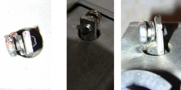

So I uncovered a possible source to my problems after the failed jump test. After looking at the new starter more carefully, I realized the gromet around the 50 terminal had partially broken off during shipping as I found small bits in the box. I must of missed this when I installed the new starter, duh. See picts below. The last picture is of my repair kit. New 2ga battery cable, high temp gasket maker, JB weld and a plastic washer. I was thinking of using the gasket maker to seal the 50 terminal at the starter housing. ( the broken gromet allows the terminal to move side to side and possibly touch the housing). Using the plastic washer as a mold, I was hoping to place JB weld inside the washer and try to form a gromet that will hold the terminal in place and prevent it from possibly touching the housing. I wanted to NOT have the JB weld adhere to the housing so I was thinking of placing a plastic film below the plastic washer and in between the gasket maker and the washer.
So a brief summary of what I was planning:
1. remove the starter and inspect the contacts side
2. compare the nose of the old and new starter
3. use my repair kit to fix the 50 terminal
4. install new battery cable
5. try to hand turn the engine at the crank nut
6. check that the alternator spins freely without the belt attached
7. try to start with the ingition key
This plan assumes the replacement starter was the correct PN and that the 50 terminal somehow caused a short every time I tried to startup the vehicle. If this is not the problem, I'm leeaning towards the alternator repair I made prior to this mess. Maybe there is a short in the alternator causing a problem with the starter??? assuming the alt can do that to the starter of course.
thoughts welcome please.
Wow. Great photos Albert. If I'd seen those before I doubt I would have developed the idea that your new starter-nose could be wrong. (The noses certainly look identical now but I'd still double-check this with callipers or similar now that you have them out together.)
........After looking at the new starter more carefully, I realized the gromet around the 50 terminal had partially broken off during shipping as I found small bits in the box. I must of missed this when I installed the new starter, duh.........
Lesson learned Eh?
Parts are always at risk of damage during shipping.
If that terminal took a hard knock (and was perhaps pushed-inwards some distance - It is quite possible that there is "hidden internal damage" that is preventing your solenoid from pulling in fully (which would explain the "clack then silence").
I wonder whether you can "make a claim against the shipper" or something like that. (Although normally they would expect an item to be checked thoroughly BEFORE it was ever attempted to be used. - So they may not be prepared to help you now. And if you put yourself in their shoes - You can't blame them.)
If you can't make a claim or get the supplier to accept responsibility for the shipping damage (or aren't prepared to try), then I'd want to look inside the solenoid to see the extent of the damage before trying to fix it. (I'm guessing you're intending to do this anyway.)
I'm not familiar with "JB weld". Here in NZ I would probably use "Araldite" to hold that terminal in its correct position permanently and away-from-metal. (I know that Araldite doesn't conduct electricity.) - But perhaps "JB weld" is a better product? (Of course I have a lathe here so I could perhaps instead turn-up something in nylon if I was in your shoes.)
I don't see the purpose of the "gasket maker". I think I would just "stick the whole terminal to the alloy" and be done with it. Then, if I wanted to take it apart in the future, I would probably just scr#pe away at the Araldite/JB with a sharp scriber or something like that. (But the method you have in mind may well be better than this. - However don't go overboard sacrificing "permanence" for "ease-of-dissassembly".)

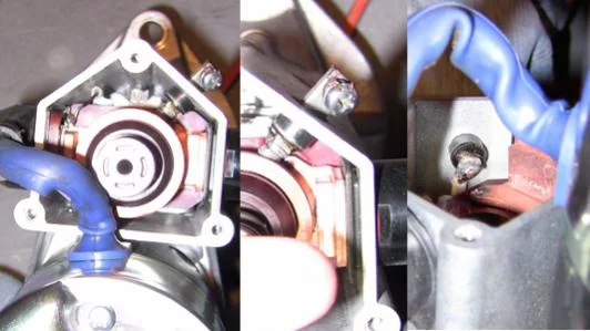

I just returned from the bench test and was unsuccessful. Given the proximity of the 50 terminal to the starter housing, the terminal touches the housing as soon as the starter engages and nothing more happens. So after several tries, I was only able to get the starter to pop but not spin. See picts below.
I returned home and opened the punger side of the starter. The inside of the 50 terminal interfers with the operation of the plunger, so I think. Comparing the old and the new starter, the old 50 terminal is shorter on the inside (post 21 picture). I placed the plunger back into the starter and pushed down on it and it will not go down towards the contacts without touching the insde of the 50 terminal. Could this be??? Am I just unfamilar with this or is it possible that this starter was never tested properly?
I would like to use JB weld to hold the terminal where it was based on the inside position of the plastic housing around the 50 terminal on the inside. I could then try another bench test BUT, if I were to do that, should the plunger be below or above the 50 terminal? House does the plunger work? Does it need to touch the contacts to move up or down or is it a magnetic thing? Seems odd that someone would put this thing together and it would be worng. Can someone give me some insight, I have to NOT know what I'm talking about here.
Regarding turning the engine, I have not given it another try. I'm hoping I can't turn it because it requires more force than I can muster. I will purchase a shorter 1/2" ratchet to see if I can give it another turn. Also the ratchet I was using interfered with the fan blades because I was only able to use it with the handle facing the passenger's side pulling UP on it until it got close to the fan blades. My tool would not fit in any other position.
Thoughts please....

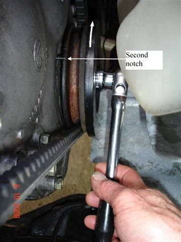

I dropped the starter and am now trying to turn the engine at the crank nut. So far, not even a budge. My half inch wrench handle is a bit too long so I'm off to get a shorter wrench and and test the starter. Judging by the amount of force I was able to put on the nut with the tools I have, I think the motor is seized. I'll post what the starter does when I return.
Well I can turn my engine relatively easily just by using a ratchet and socket like this Albert:
And a seized engine together with a damaged "50 terminal" would explain all your symptoms.
But what would cause your engine to seize up without you being aware of it? Are you sure your gearbox is in neutral? (Perhaps you should try turning your engine over via a rear wheel as I described in a PM to you. Then you could check that your gearbox is shifting properly at the same time.)
