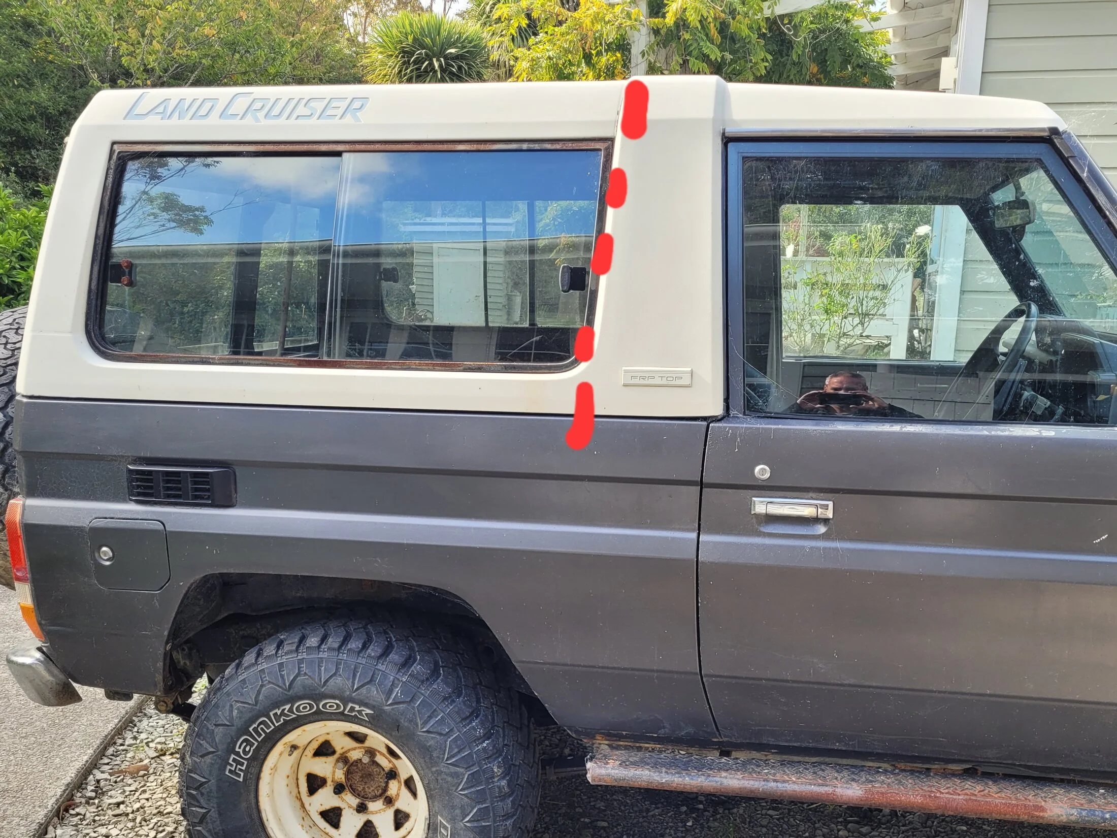

I think Ive finally settled on the outcome. However, it requires an interesting modification to the FRP top. Basically I want to chop the back half of the FRP top, enclose the cabin and turn it into a ute.
The FRP top has a natural cut line, (red dotted line) but the question I am pondering is enclosing it by moulding a fibreglass panel into the remainder of the FRP top.
Anyone done something similar.

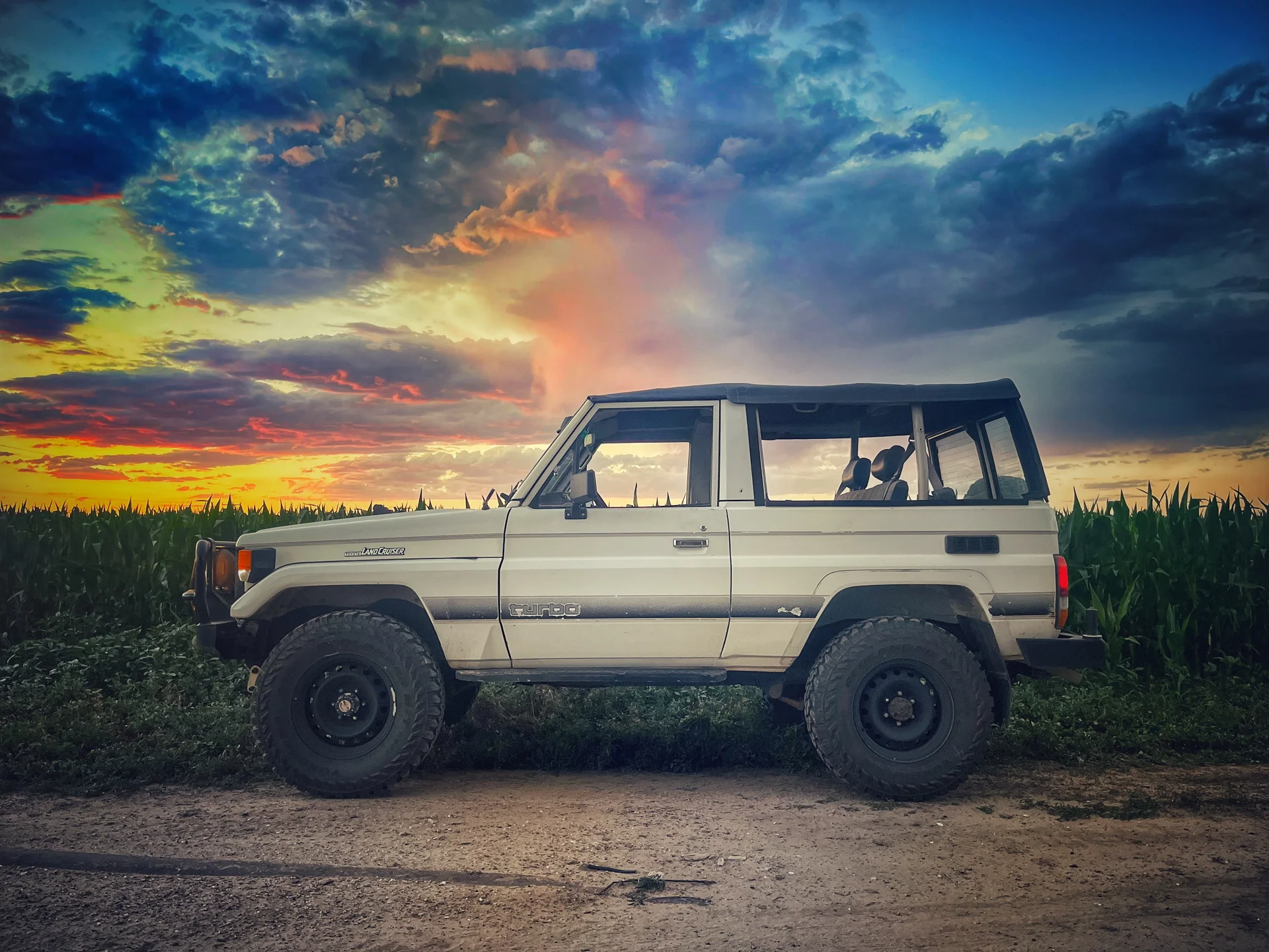

I run aftermarket soft top from April to November, although this year im just changing it today.
I wouldn’t cut up a good FRP top. They are super rare to find a replacement. I’ve seen people pull windows to have tarp in sections and even tarp on the top.
This is how I run 90% of the time. I can have the sides on and weatherproof in a few minutes.

I get what you're saying about the FRP top. The other problem I have is that the window frames in the top are rotten. The only replacement I've been able to find are those solid gull wings. $1k a side, plus I don't really like them being solid.

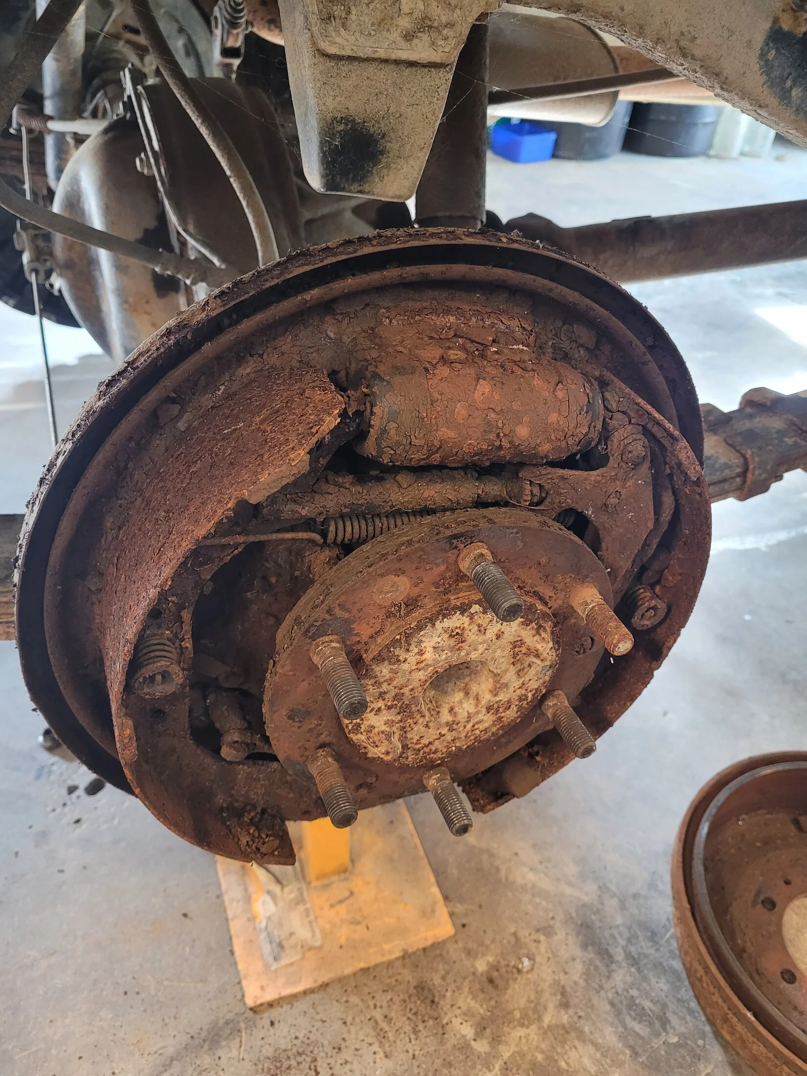

Well I've been wading around in pools of grease and oil. Well it seems like it anyway.
What was just an exercise to get the brakes working again has turned into a full brake, bearing, seal rebuild. Diff oil was escaping into the wheels bearings, there was crap everywhere.
Pulled one caliper out and the brake pad lining just disintegrated.
So finally stripped everything out, cleaned and cleaned and cleaned. Have it in a nicely arranged layout and just checking everything over for wear.
The wheel bearing washer has some wear in it. Not surprised as the preloading of the nuts was pretty low and the diff oil through them doesn't help. So the bearings would have been spining a bit....in the wrong way. Stub axle looks ok though. Seals are not great in the calipers, rotors very worn, knuckle bearings stuffed, seals....well what seals.
I must say, that design with the brake lines from the diff to baking plate, to caliper is weird. That right angle joiner mounted to the backing plated is odd why not just go flexible brake line from diff, directly to the caliper. It already has a nice mounting point where the steel line joins the flexible on the diff axle housing. And undoing it was a right pain in the ass.
Anyway, Merry Christmas and Happy Birthday truck. I bought you new seals and bearings all round, new rotors, calipers and pads. Have it laid out now and cleaned. Will put my OCD into overdrive and paint all the components up then reassemble.
Once it actually has brakes, I'll finish changing all the oils out and be looking forward to a drive to find out what is next in the drivetrain.
Rear brakes done, new shoes, cylinders, seals and a bloody good strip down and paint. Before and after...yes there was zero lining on those shoes.
