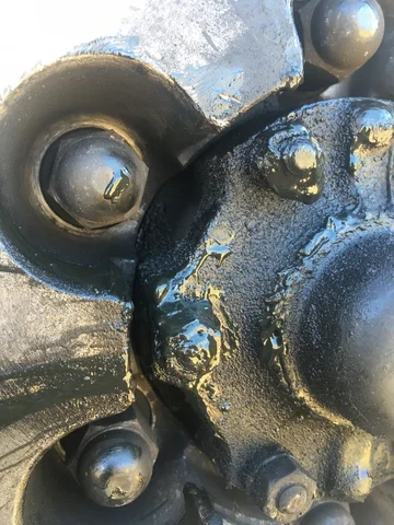

This is my front passenger hub. I had noticed moly grease starting to leak. From what I am reading on here, it is at least an inner oil seal. Once I get it tore down enough to replace that, it seems to be a good idea to do some other maintenance while I am in there.
My questions are:
Should I totally stop driving until it is addressed or will it be okay? If I drive it like this, is there a chance of a catastrophic failure? I ask this because snow is forecasted where we live before I will have a chance to get all the parts. Wondering if this can wait any longer - maybe when it is a bit warmer in a month or so, but I don't want this to be my first and last post in one.

I'm no expert, but my reading on Mud is in line with your post. Yes, it looks like you have a bad axle seal. I don't think catastrophic failure is likely, but the longer you drive on a truck with poor axle lubrication, the more likely something will wear out. My passenger birf was leaking when I bought my truck 2000 miles ago, and I haven't gotten around to rebuilding it, but certainly know I should.

Yes you need to do the seals. But it isn't something you have to park it until you get it done. You can add moly grease to the knuckle via the square plug on top of the knuckle (towards the front behind the wheel). It is easiest to do this with the wheel off but you can do it by turning the wheel all the way to the right (or left for left wheel) and reaching back in there. A size 13mm open ended wrench will open the plug. Take a zip tie (or lawn mower line or whatever) and stick it down in the hole. There should be grease up to about 1-1.5" from the top (3/4 full).
I use the Valvoline moly grease in a tub from AutoZone. It is labeled as for Ford/Lincoln/Mercury. Take a ziploc freezer bag and turn it inside out. Put your hand in the bag (like you are going to pick up dog poop) and scoop out the grease from the tub in to the ziploc. Then unfold the ziploc to turn it back right side out. Squeeze the grease all down in to one corner. Cut a small 1/4-3/8 hole in the ziploc corner. Then squeeze the grease in to the port on top of the knuckle. Use the zip tie to occasionally push the grease down in the hole. Put the plug back in. Drive a few miles and then check the level again. Add more grease as necessary.

My hub was leaking bad when I bought it, had to keep adding gear oil until I rebuilt the axle. Drove about 2k miles that way. I used the marlin crawlers full kit. Didn't see the warnings about their seals until after, so what can I do. Its a good idea to do it all while you have it apart. Bearings, seals, gaskets. Parts aren't that expensive and you'll already have it apart, so why not. I needed brakes and rotors too. Put the 100 series front pads on the front, theres more pad surface and they're a direct replacement. Only been about 1k since I rebuilt, so far so good. Drives great. Took me two leasurly days, plenty of beer breaks and double checking the how-to's in this awesome forum. If I were to do it again I can get it done in less than one. Very dirty, greasy job.
